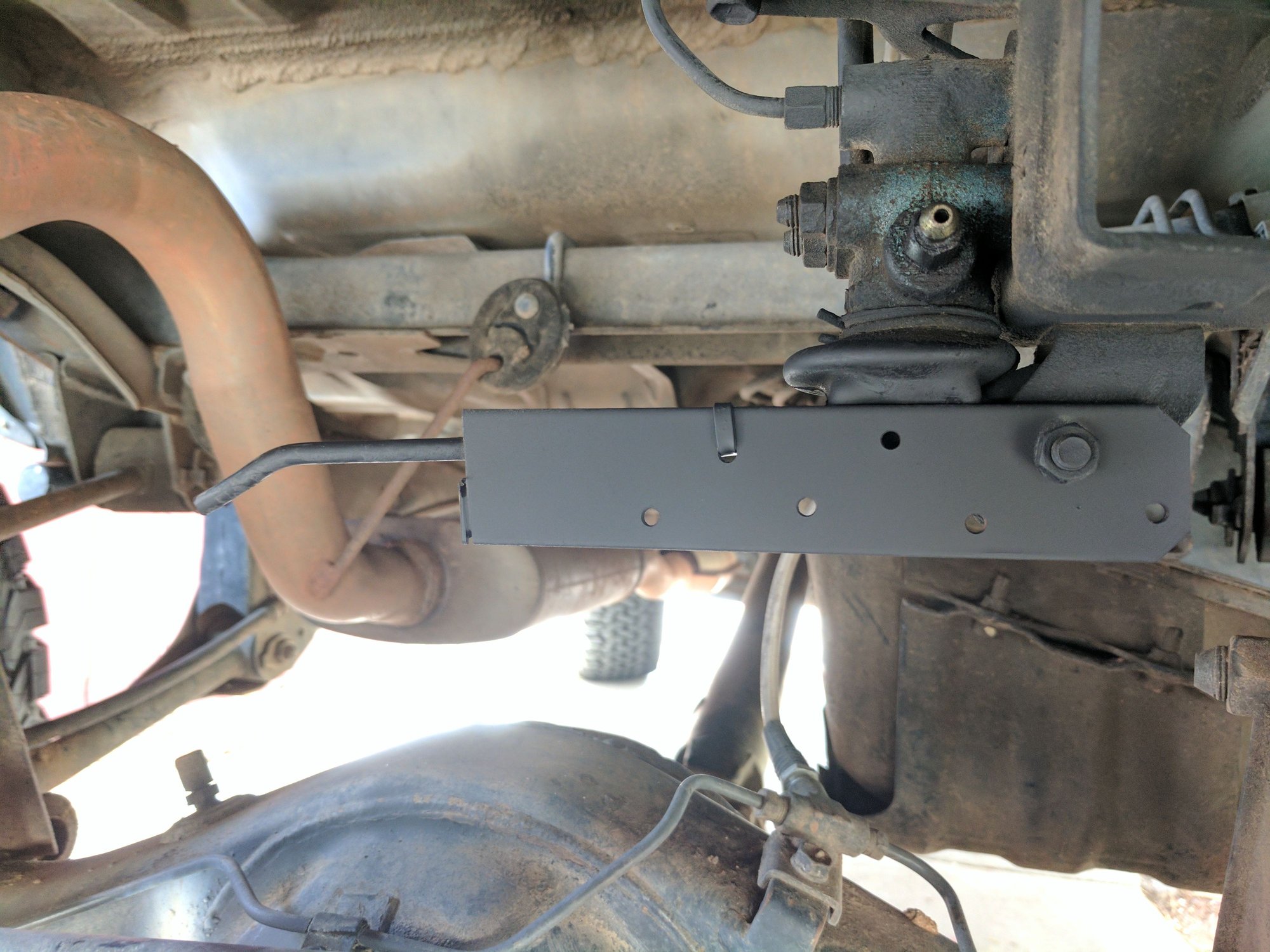

Here is my adjustable LSPV valve bracket. Quite simple and very effective. Since this pic I replaced the zip tie with real fasteners. Was able to dial the rear end braking power in just right.
