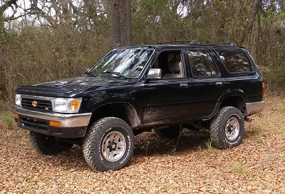

Our 4runners are brothers.

jday, but mine is 1991, your front end looks like post 1992? Close enough though
