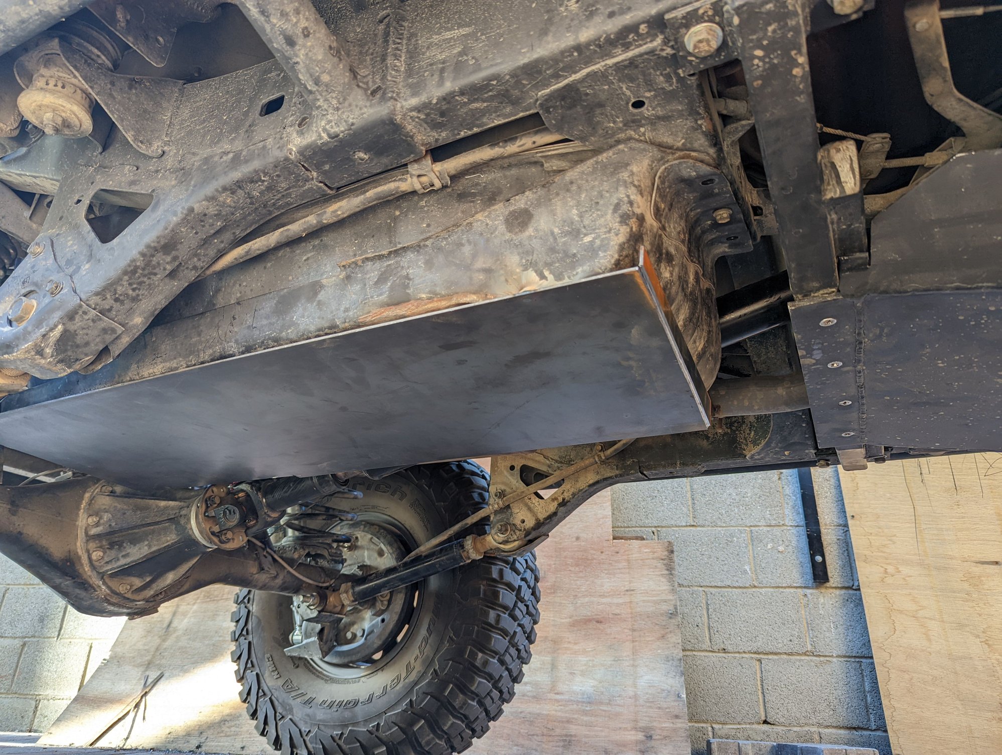

Then I removed my gas tank skid plate to start the long path to making a nice one out of aluminum. But realize, the skid as it is will NOT survive the next offroad trail. My tank is already got some minor damage trough the skid.
Oct 3rd I will be hitting the rubicon trail. So, the gas tank skid is not a risk I can take. Decided to throw something together. That's as far as I got last night.

Hi COMTB,,,, so I am not in love with the gas tank skid I am building. It will definitely function good enough. When I have more time I will change this whole thing out with an aluminum skid. I hope to lift the gas tank up by 1.5 inches, equal to my body lift. Looks like it is an unfriendly job though. lol.

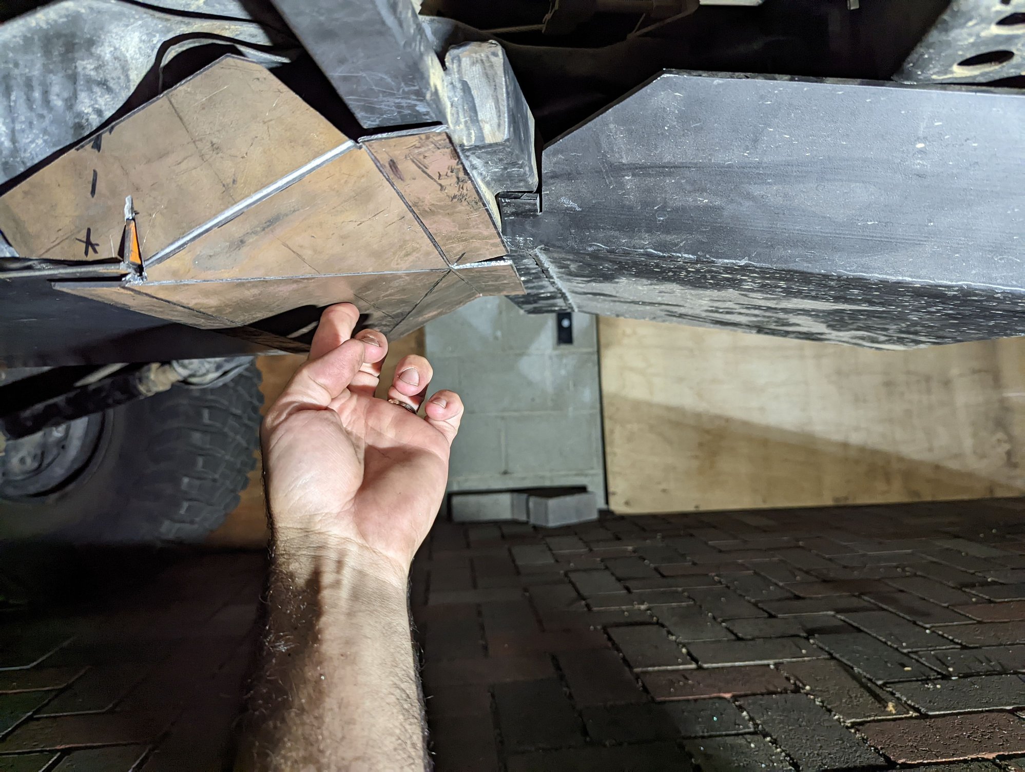

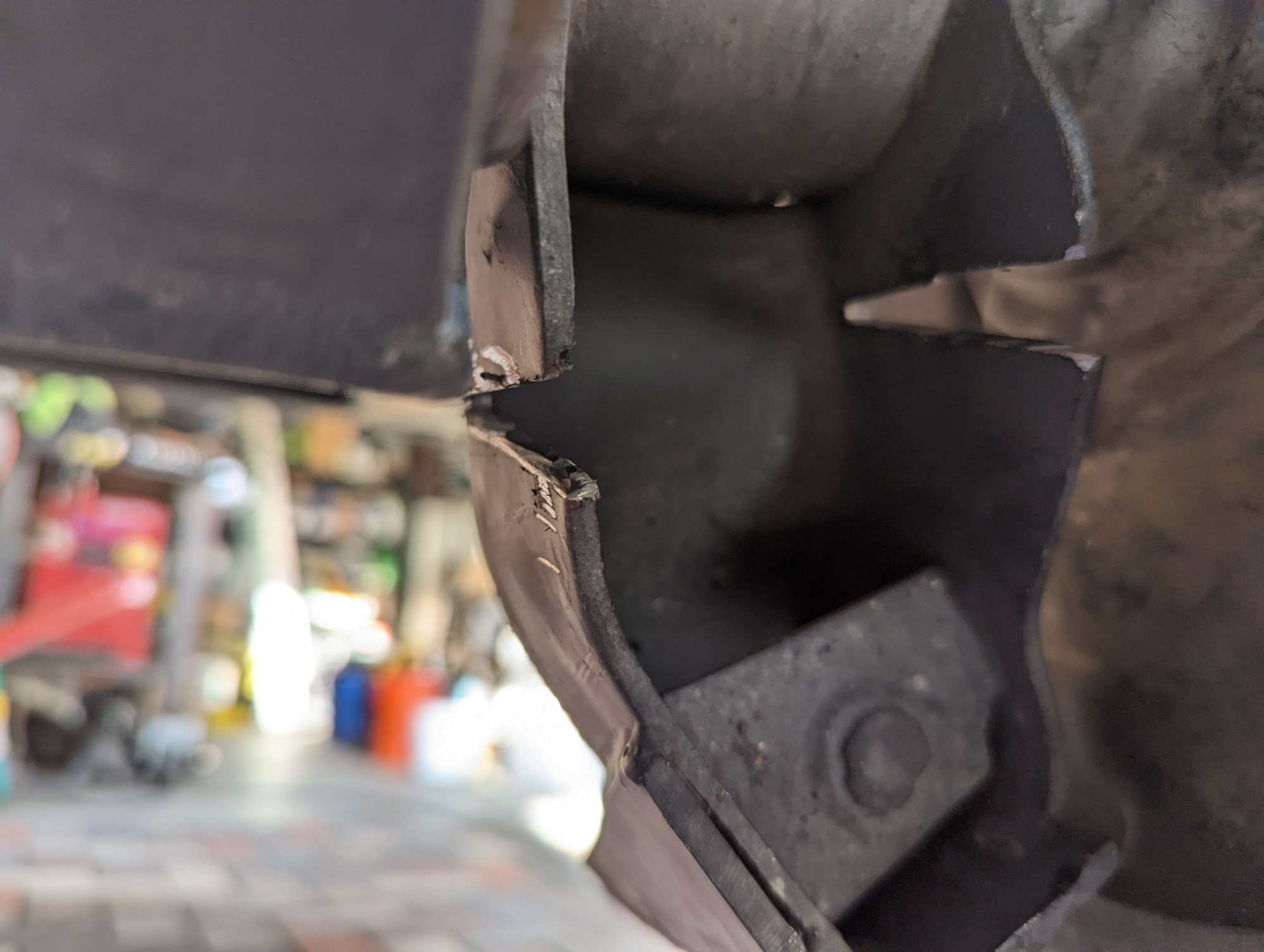

Here is my progress in pictures. I decide the gap between the gas tank skid and the belly skid I have built is gona be a problematic anchor point, so I went through the excercise of filling that gap to. lol. If I can get the tank to go high enough, I have make a nice flat tank and belly plate.
The welding
THe complicated shape to fill that gap
the gap!

Because the geometry of the mounting points for the gas tank skid are a bit complicated, I need to take my time to build a nice alu one. and, less room for error cause alum is 3 times more than steel. lol. Steel plates are way to heavy for the 3.0 auto And overall offer more resistance to get up and over obstacles.

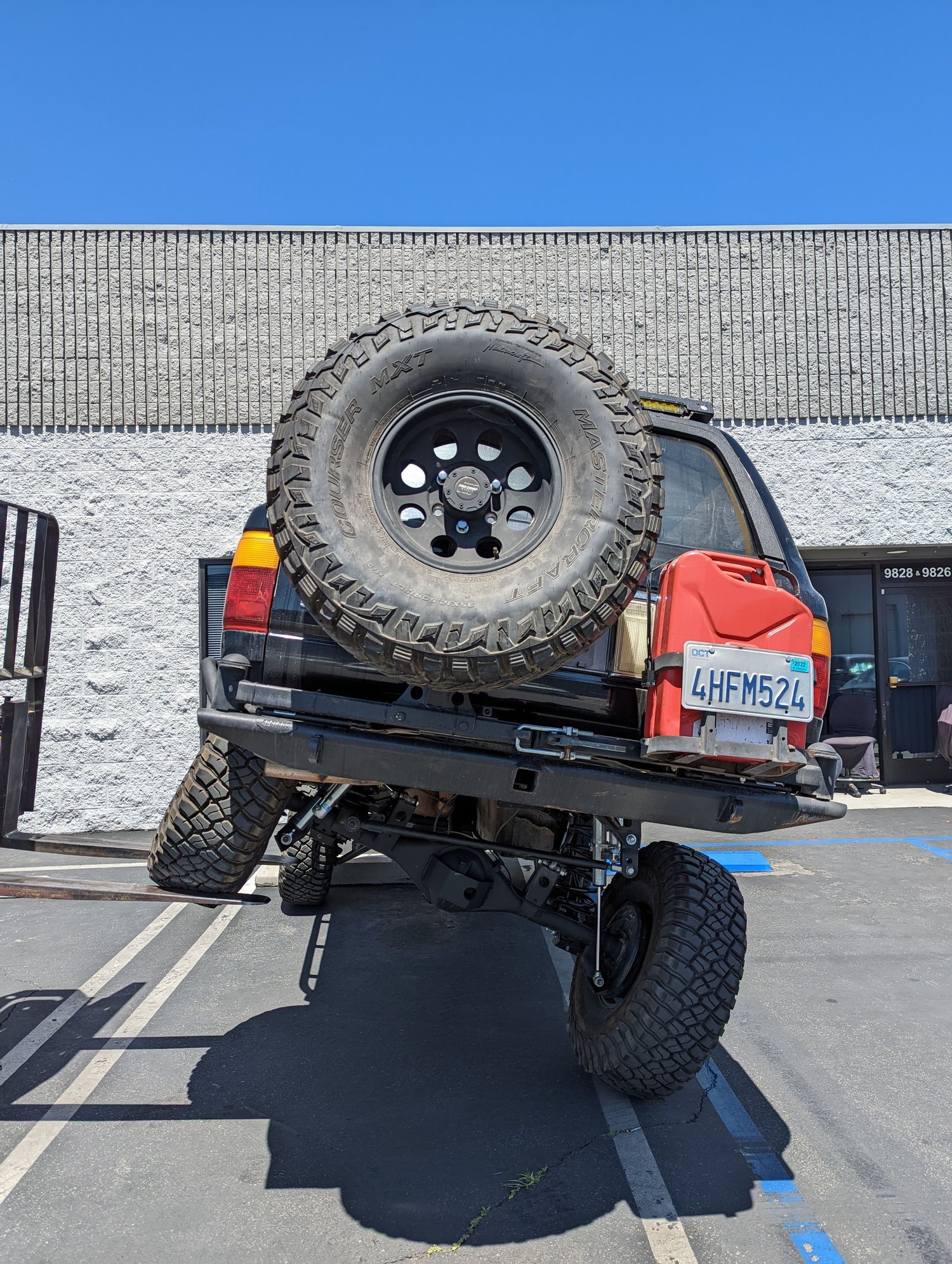

My rear end has 2 new custom control arms. If you dig through the posts you will find how I used offset heims to get a lot more travel from my upper control arm hitting the gas tank on full droop. The major driver was strength and flex, but I used the opportunity to drive my rear axle backwards about 1.5 inches, and rotate the diff upwards for more clearance. That made it necessary to get a double cardon driveshaft though. lol. rabbit hole .. I found that one of the biggest hinderance to travel/flex in the rear was the joints themselves. Heims and such provide much more movement for the joints than stock did.

SO these are the shocks I got. they have the best length ratio which gets me the most travel. The shock mounts absolutely needed to be redone. I didn't want to go into the rear cargo area, that was my limit. After struggling for a while, I thought of this. I was too lazy to take my axle off and do the cuts properly, so the edges are pretty ugly. lol. SUper hard area to do this work in. I did a TON of research before I settled on the springs and shocks. I get very good articulation, see pic below. I never mind answering questions. I lurk on all the build threads for inspiration and ideas all the time and ask questions too

Nice, those shocks have a good amount of travel and the collapsed length is only 4in longer than my current "OEM Plus" Bill 4600's. I definitely have flex envy, that photo is awesome! The 4600's have been great but they're in need of replacement and I was installing my 4crawler panhard drop and I realized I was losing significant travel in the rear with the shocks extended length being so close to factory. The coils weren't even unseating when my rear brake line became the limiting factor (shocks disconnected). So I'm going to pick up a stainless rear extended brake line and then articulate the rear to see when my UCA on the pass side starts getting into the tank (and maybe go with he offset JJ like you did to compensate). I'll wait until the winter to do the shocks and probably let the axle drop to get in there to work although I hate having to get it back in and lined up to be honest. I don't have any bumps back there but I threw some air bags in there which have been great when it's loaded down for long camping trips so technically I guess I have air bumps now? haha
