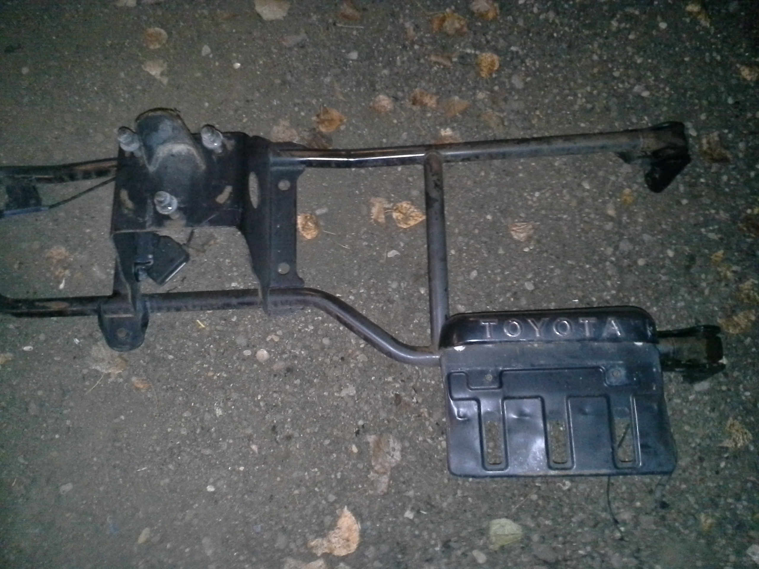

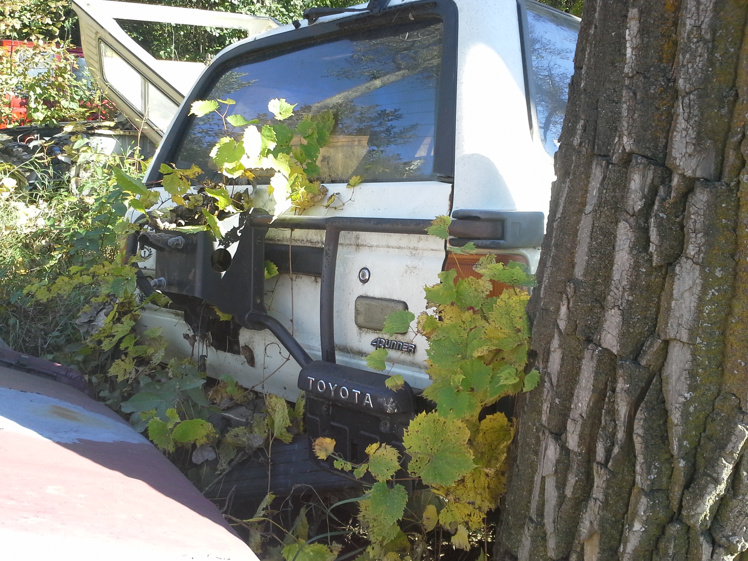

Here's a tire carrier I found on a 4runner out at the junk yard, so my friends and I decided to get creative

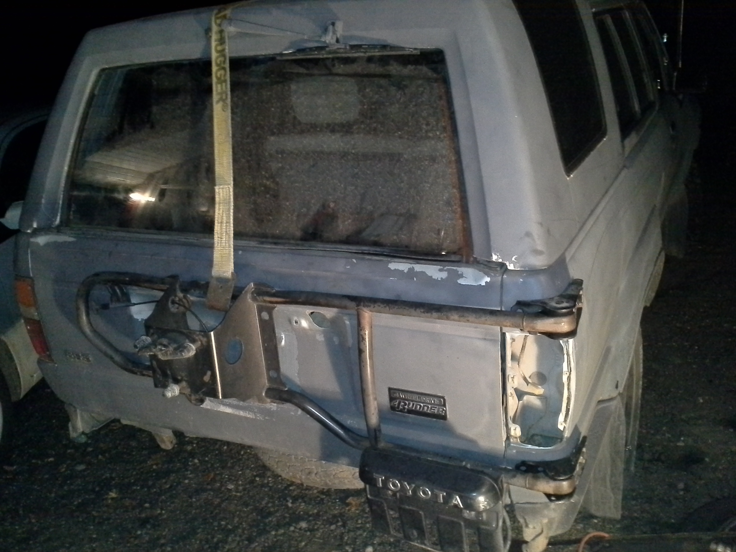

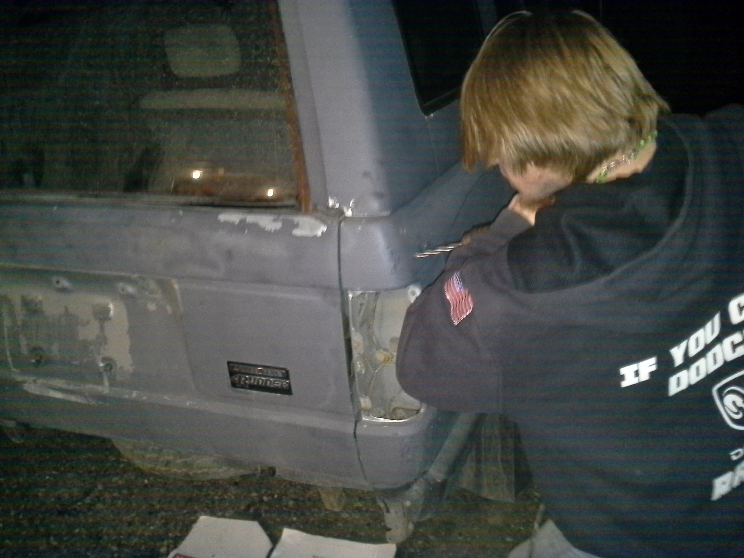

So we removed the tail light on my rig and began mocking it up, marking the holes, drilling them, and cutting out pieces of metal to use as braces inside the tail light hole for the bolts and nuts to hold onto for more leverage and support.

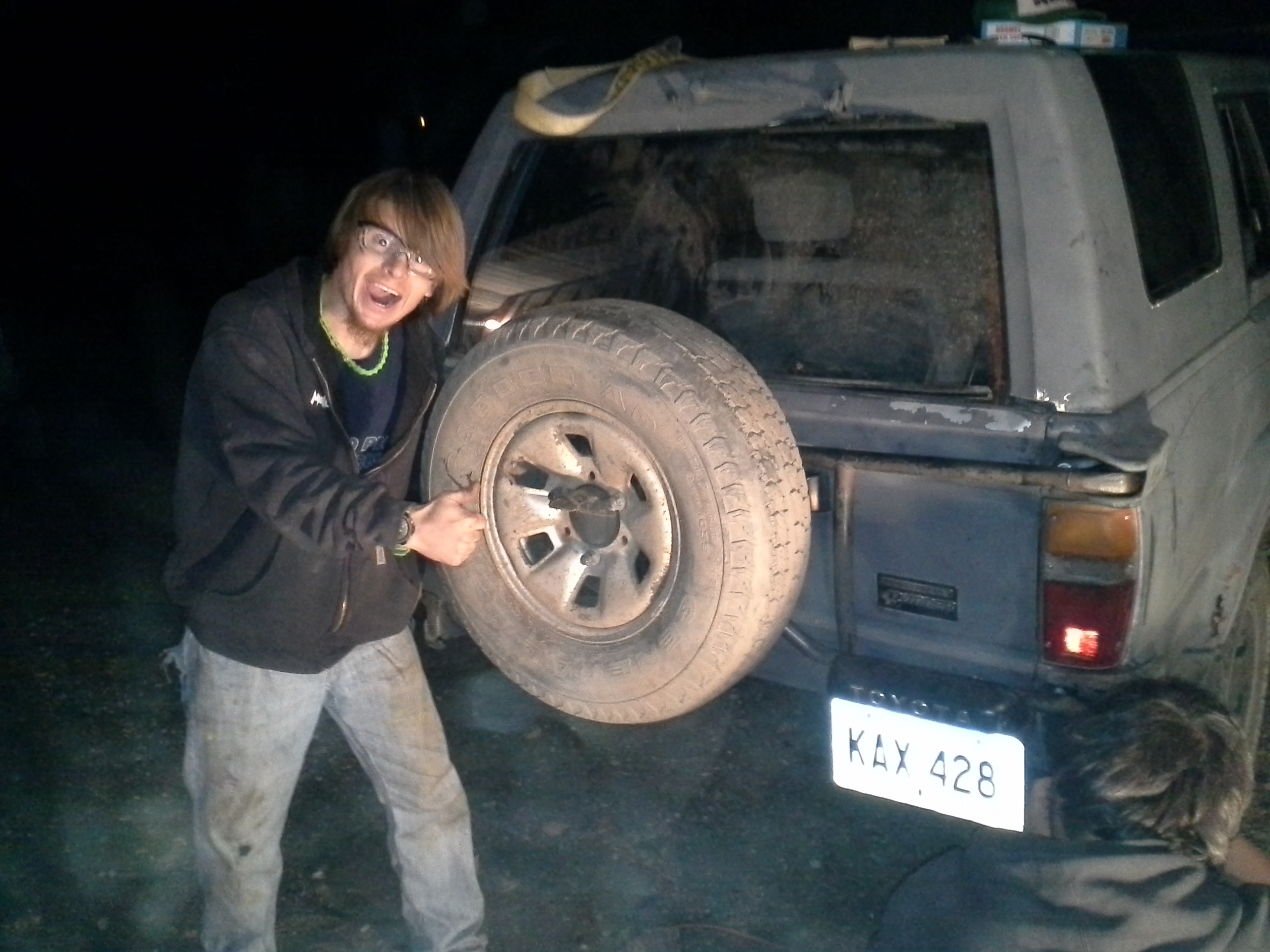

Had one buddy wire in the license plate lights to the parking light in the taillight wiring.
And my other buddy posed next to the finished project.
If you want any advice on how to make it work, go ahead and ask away.
It was rather easy and straightforward
