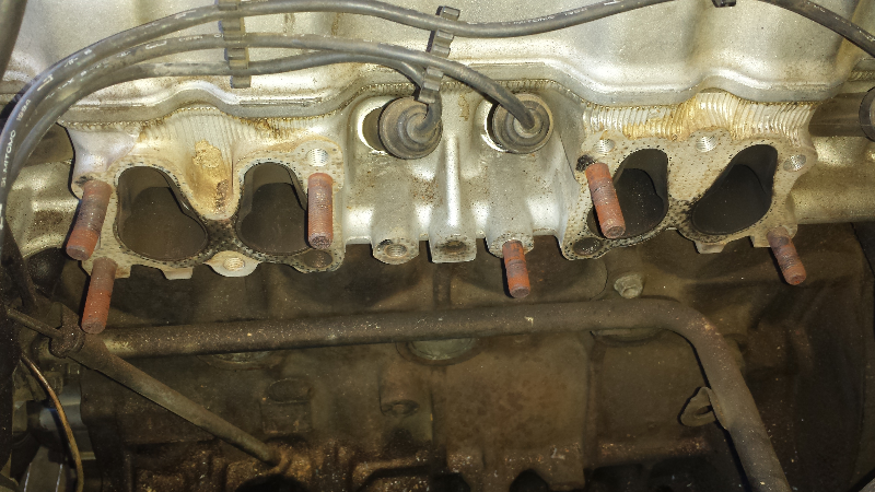

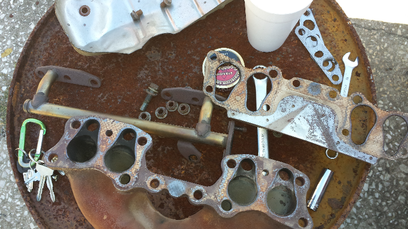

I am new to yota tech. I recently bought my truck. It had 200k on it when I got it. I've done some upgrades like tires, shocks, add a leaf, camper shell, torsion bars, timing chain, water pump, oil pump, and new plugs. But I need some advice. I developed a leak in the exhaust manifold. Found that someone has messed with it before due to a stud being replaced with a bolt. One other stud is bent and another missing. Now that I got the manifold off should I go ahead and go back with a header? The original manifold has nothing wrong with it. If header is really worth it then which one is the best for the money?

Thanks for the advice. I was looking at the lc's. Heard the Thorsleys are the best. Don't know if I can cough up that dough yet. May just put back on the stock manifold and start saving.

I'd suggest hooking it back up stock. If you really want a header then save up some money. Not only will you have to buy a header but you gotta do the exhaust to!
