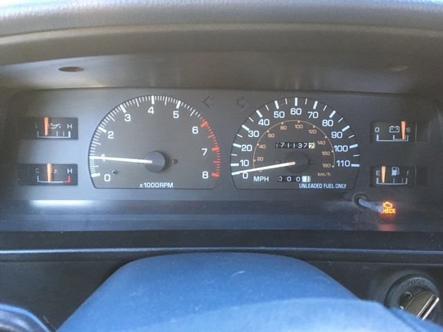

Andddddd.... I turned the key and she survived the heart transplant! "New" vehicle at 171,137.7
Check engine light is on and throwing a P0505 which is interesting considering my idle in the above pic is approximately 1k rpm. I suppose it's a little high but I need to check vacuum hoses. I took the IAC valve apart and cleaned it. Still throwing the code.
Regardless, pretty happy she fired right up Should be an easy fix. Pics of the window from safelight
