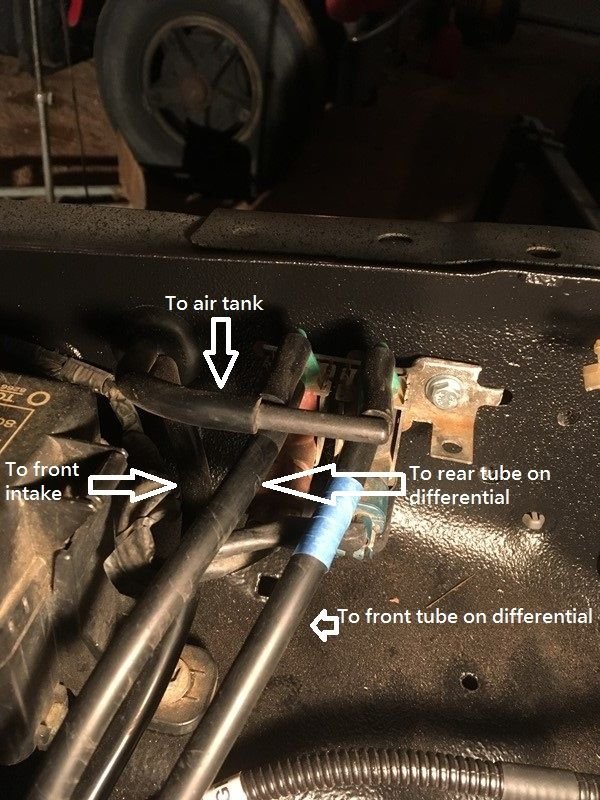

Some vacuum hose pics. Needed some more of the smaller vac hose and it came in the mail. The ADD soaks up a lot of length…
Hoses to the airtank
VSV and hose octopus goes away with the swap which is nice. Just need these 2 for the ADD.
Leave the VSV and go to the front port on the intake manifold and the front differential
Front differential tube layout
I routed the vacuum hoses using the clips shown. Worked well

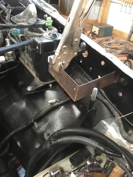

That top vac line from previous pic utilizes the throttle cable bracket. I accidentally plugged it into the wrong port when I took the pic.

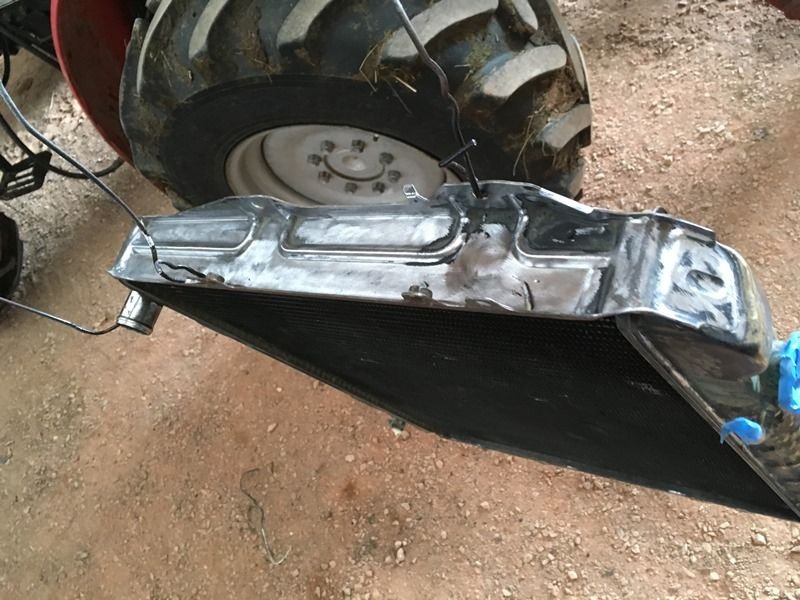

Wire wheeled the radiator a good amount to take off the rust and roughen it up a bit for paint.
Soaked it in some CLR for a few hours but it didn’t really seem to take out much of the scaling inside. It was worth a shot. I went through 2 bottles for this at 50/50

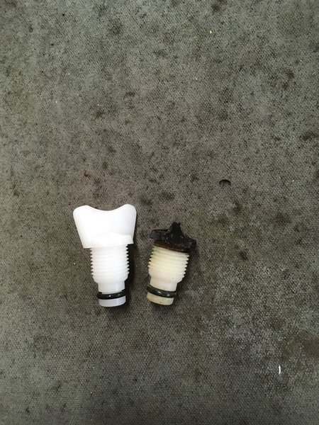

My stop cock was broke on the radiator so got a new one with a o-ring
Stop cock – 90910-09054
O-ring – 96711-19007
Radiator ready for install

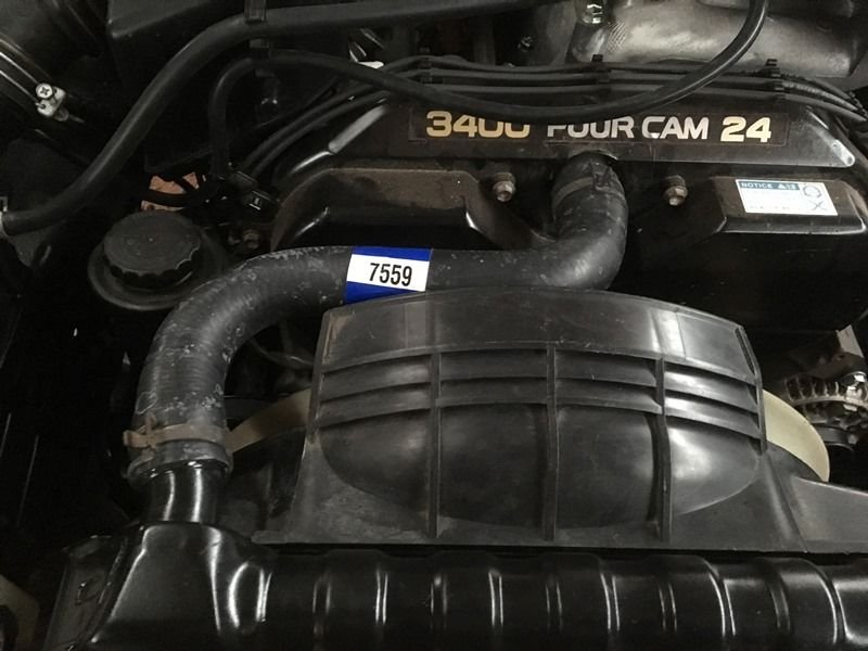

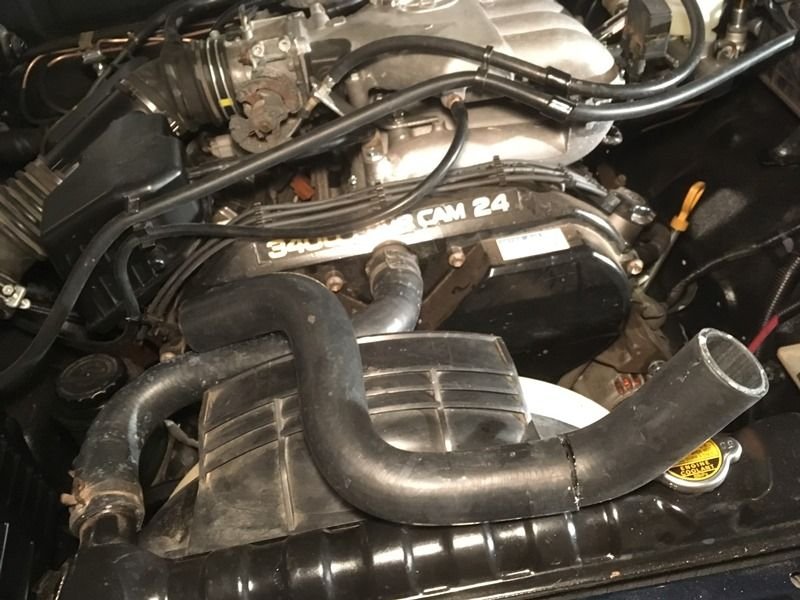

Lower rad hose – Napa – 7559
Upper rad hose – Napa – 7571
Upper installed with lots of room. I did cut a very small amount to get the fitment so it wasn’t rubbing on the fan shroud.
I thought I mocked everything up properly but I cut the lower hose too short… I’m wondering if I cut the wrong side after I cut the large bend out of it. Tube rubs on the power steering lines when installed. Need about an inch or two for it to work
Going to head to NAPA or another store tomorrow to try and find a hose that will work… Doubt I can get the same one to try again as I needed to order it. Was hoping to turn the key soon but really want the radiator setup before I do.

Here’s a pic of the scaling in the radiator after the CLR treatment. Like I said, not much improvement. As yota dude said, probably should have used a better treatment.

NAPA surprised me with a hose that I think was nearly identical. Seems to be exact replica
NAPA - 8965
Cut the new hose this time with plenty of length for the bottom radiator side
Plenty of clearance from the factory PS hard lines! It doesn’t seem as rigid as the previous one. You can see some cobra head in the hose but the constriction shouldn’t be problematic. Many report the coolant running cold anyway.

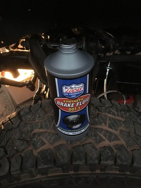

Dumped fluid in everything. Put Valvoline DEX/MERC in for power steering. Still need to bleed that.
Lucas DOT 3 for clutch and brakes

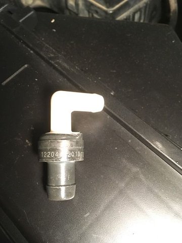

Toyota - 12204-62010 (For the 5vz)
Dropped in new hoses for the PCV to the catch can… I also put in aluminum billet hose clamps to secure the hoses and I ordered the hoses from ebay. Go the ebay route if you want these clamps as they were MUCH cheaper than going through other established online vendors. At least from what I could find...

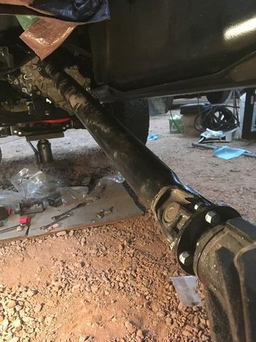

New hardware for the driveshaft because I lost the old ones…
Put the driveshaft on so should be ready to roll!

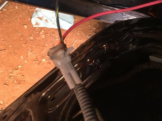

Now the engine harness is going to be an absolute PITA to split apart. You will need to disassemble the entire dash if you go this route. Cut as little as possible. Some will be unavoidable because there are quite a few splices throughout. Pic below is for a ground splice...
I cut around 7 wires. When your done your spaghetti bowl should look similar to this with the green door control module

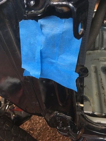

Taped it up to protect the paint… Or at least try to protect it. Sprayed it with some primer afterwards.

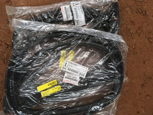

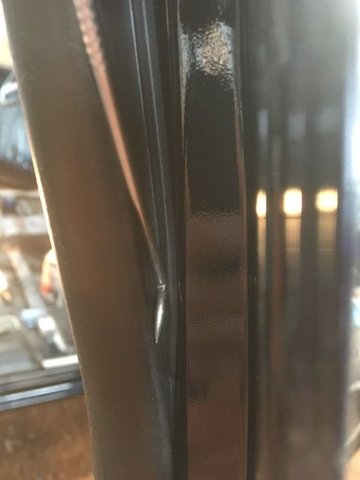

Now doors can be mounted up. I bought all new weather stripping for around the doors. I bought these a long time ago
Toyota – 67862-35010
Toyota – 67861-35010
A curved pick helps install the weatherstripping where it needs to get behind the metal lip of the door.

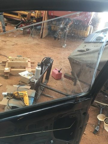

Use truck battery and some spare wiring to position window for removal.
Remove power window regulator
