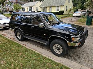

As the title says, I bought a 1995 4Runner for $350, though I initially bought it for $600 but the seller gave me back $250 when the brakes totally gave out shortly after leaving. Apparently keeping the brake fluid topped off had worked up until then. I had tried to sell it back to him for $400 just to be done with it, at which point he gave me $250 back bringing me to $350 for the truck, plus $80 for the unexpected tow. According to the owner it had been sitting for 7 years due to an engine problem (a misfire) and he had driven it periodically in that time when his other truck was broke down. When I bought it I knew it had the misfire and that it needed new rear brake lines, a good amount of suspension work, some exhaust work and all the regular maintenance due from 7 years of sitting (fluids, pads & rotors, etc). On a positive note, the tires are basically brand new.

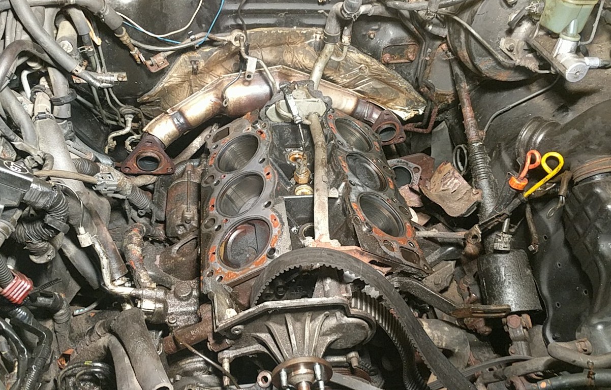

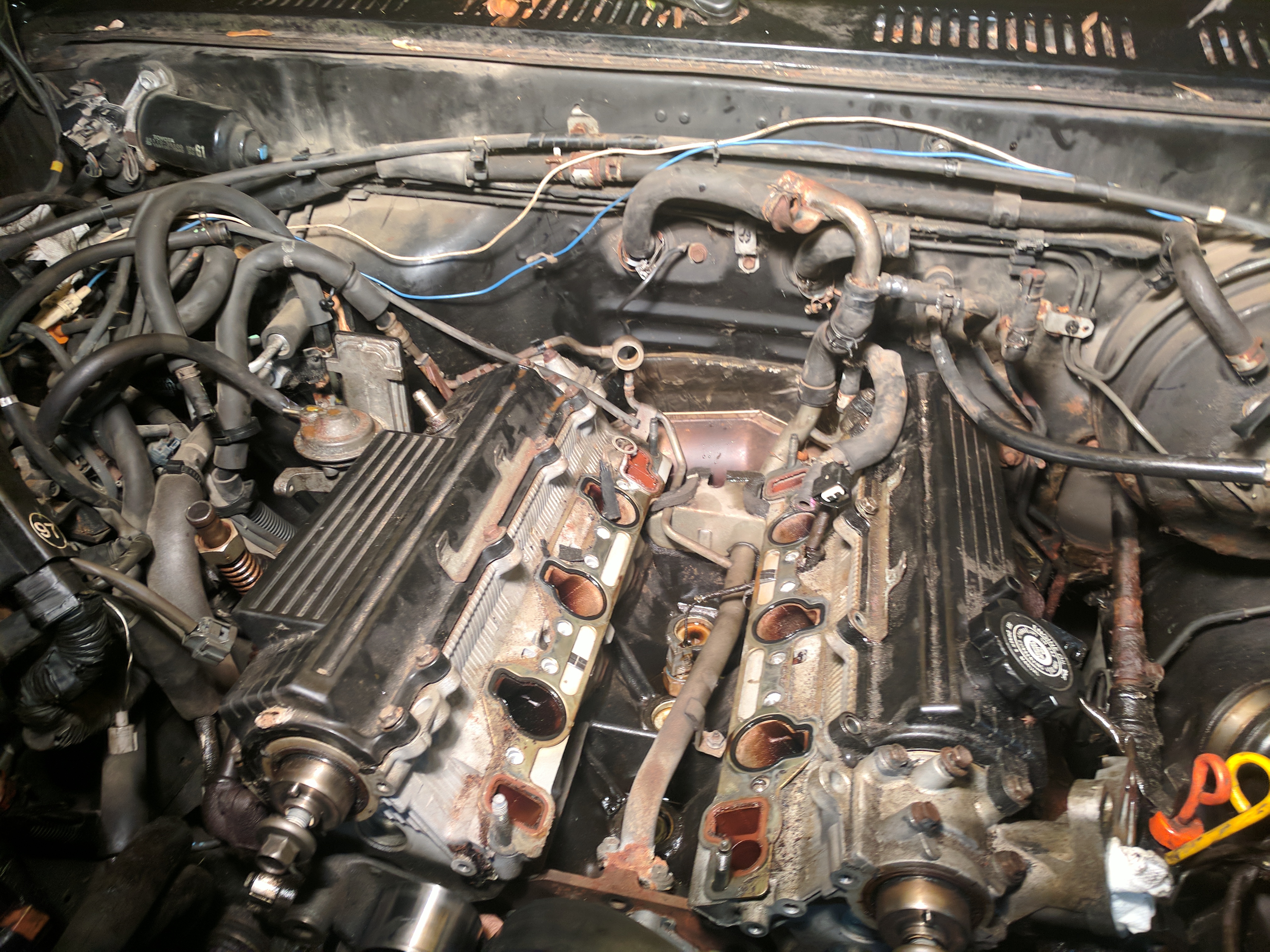

The first thing I did was drop it off to a mechanic relative to replace the rear brake lines as I didn't have time and would have got the lines bent by someone else anyways. I had him bypass the leaking proportioning valve for simplicity's and cost's sake (is it ok to bypass the proportioning valve?) After that I took it to a mechanic to diagnose the engine problem, they found no compression in cylinder 6 then ran a camera down and found a burnt valve. I hesitated to fix it as I've never done anything deeper in an engine than a valve cover gasket so I put it on Craigslist for all of a day then changed my mind and decided to go ahead and pull the heads off.
Everything came apart surprisingly easy, I probably have a little less than 10 hours in on the teardown. I'd like advice on getting the crankshaft bolt off though, I tried an impact wrench, a breaker bar propped against the ground using the starter motor and finally a piece of angle iron bolted to the pulley (the angle iron and bolts bent). Anything else I can try short of a stronger impact or a stronger steel pulley holder? I took the heads to a local machine shop for the valve job, I got them back and put them on earlier this week (I got the Toyota "engine overhall gasket kit" if it's worth noting). I also bought a set of ebay stainless steel headers/cat bypass that I put on today, they seem to fit well except that I'm going to have to move what I assume is the transfer case cooler. I also have a problem in that one of the bolts that holds the heater core line to the top of the block is stripped.

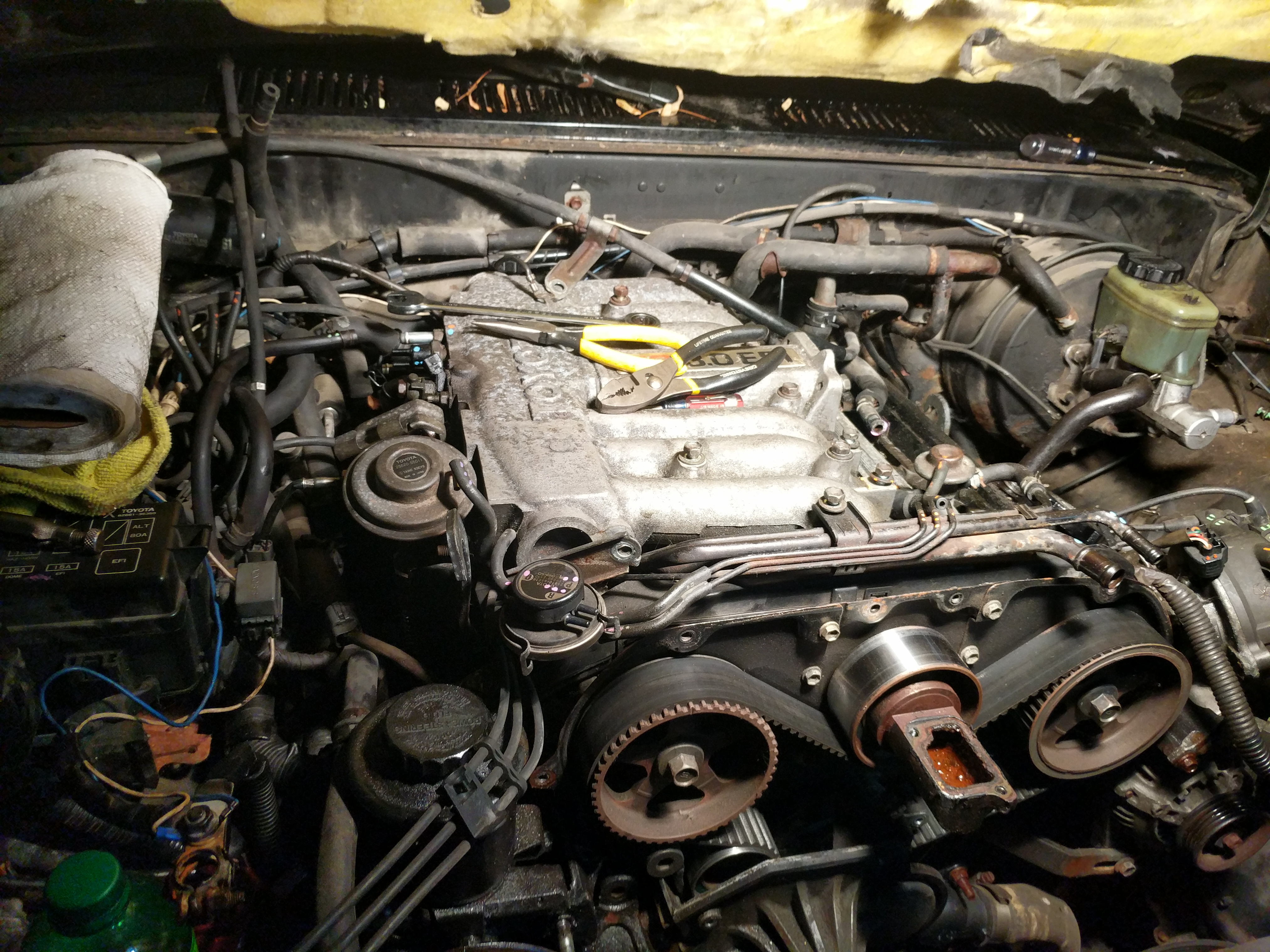

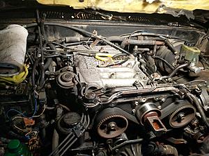

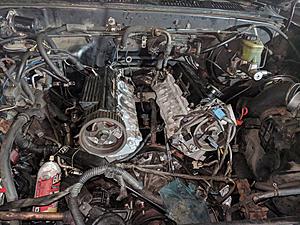

As the engine sits now:

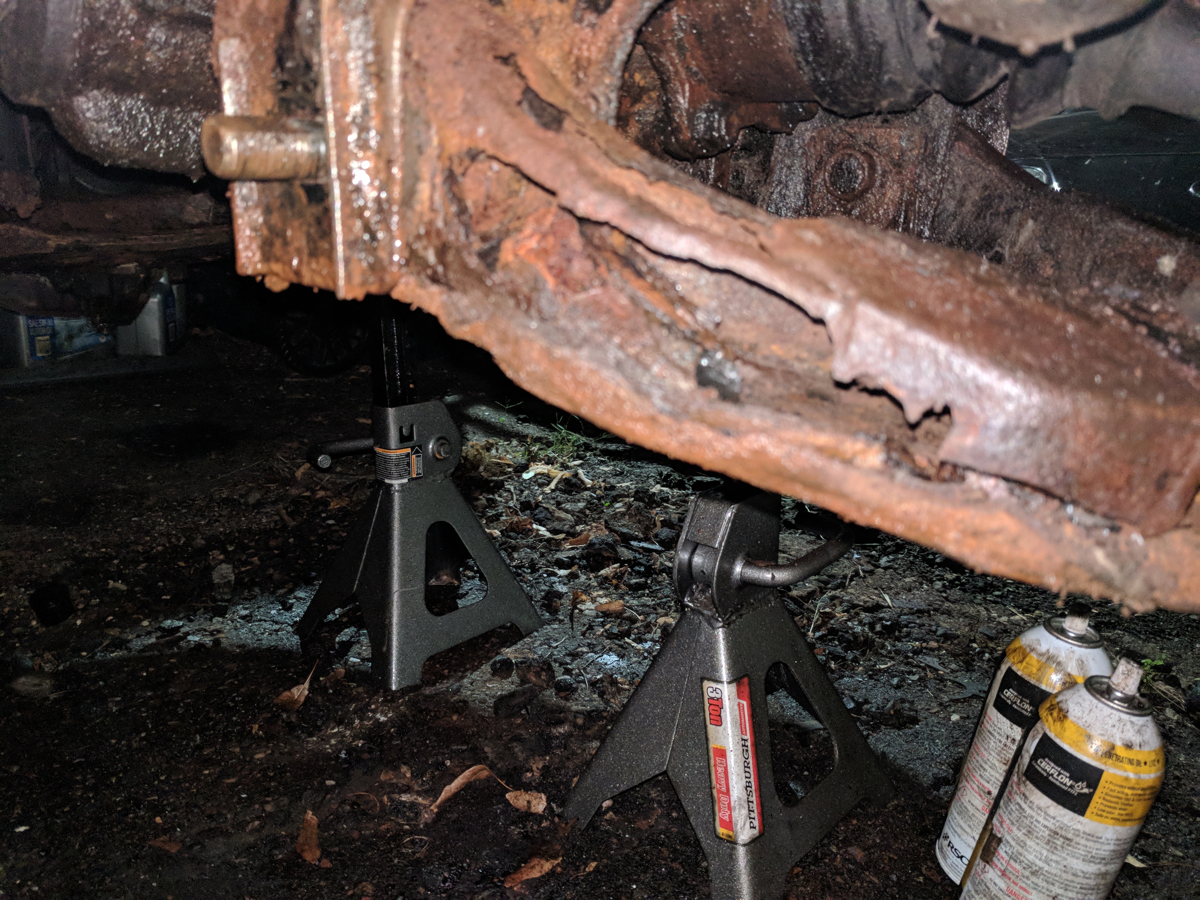

I finally got it jacked up and the wheels off today to begin replacing rusted lower control arms, the passenger one is barely holding together. I'll also be checking all the suspension components while I'm there, I haven't dealt with torsion suspension before so any tips/tricks/warnings are appreciated. So far in the suspension I know I need to replace both lower control arms, struts all around, rear springs and who knows what when it comes to ball joints, tie rods and sway bar links.
Rotted lower control arm:

So as of now I'm roadblocked from assembling the engine by a stripped bolt in the block, I can't do my timing job until I get the crankshaft bolt off, can't finish my exhaust until I move the transfer case cooler and I probably wont be able to get any body work done this year because of my lack of a garage and the cooling weather. Sorry for the long first post, I do want to give a general thanks to the community here as your posts have helped me along the way.

Wow that is some crazy rot on that control arm! For the crank bolt, I have read that some people use a Dremel to cut relief cuts in the flange of the crank bolt. I've never done it, but seems like it should work. The starter method has always worked for me, but maybe in the rust belt the bolt seizes to the crank.

I cut reliefs in my bolt. The flange acts like a lock washer, it's concave and cutting reliefs in it allows it to flex away from the pulley. After i cut reliefs in mine it only took a minute to pop off. Of course doing this requires replacing the bolt.
Thanks for that tip. I'm going to borrow a more powerful impact from someone and if that doesn't work I'll probably try your method.

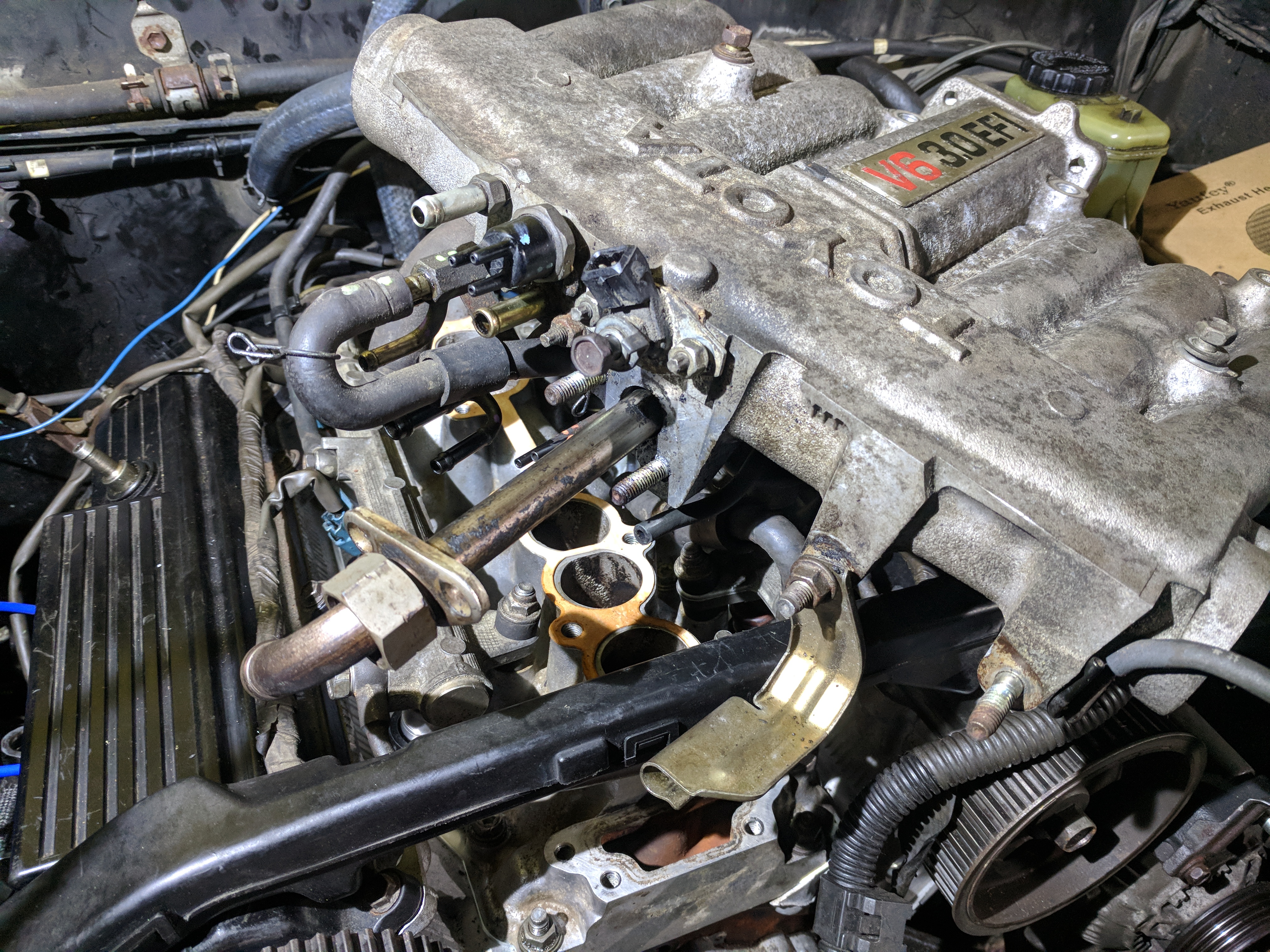

I don't think so, the tube going from the EGR (I think it's from the EGR, see pic below) into the intake plenum was completely clogged with rock hard carbon build up for about 3-4 inches at the end where the two holes are. After reading up how oil in the intake often relates to the PCV valve I took that out and it does seem a little oily at the outlet. I ordered another PCV valve just because it's cheap and I have easy access. Would the burnt exhaust valve have caused oil to blow into the intake through the PCV? I'm just hoping my piston rings aren't bad because I did not check.
The tube that was clogged is the one pulled half way out at the middle of the intake plenum:
