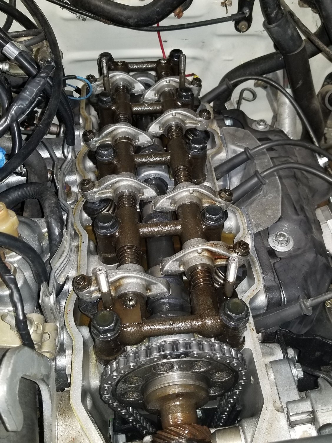

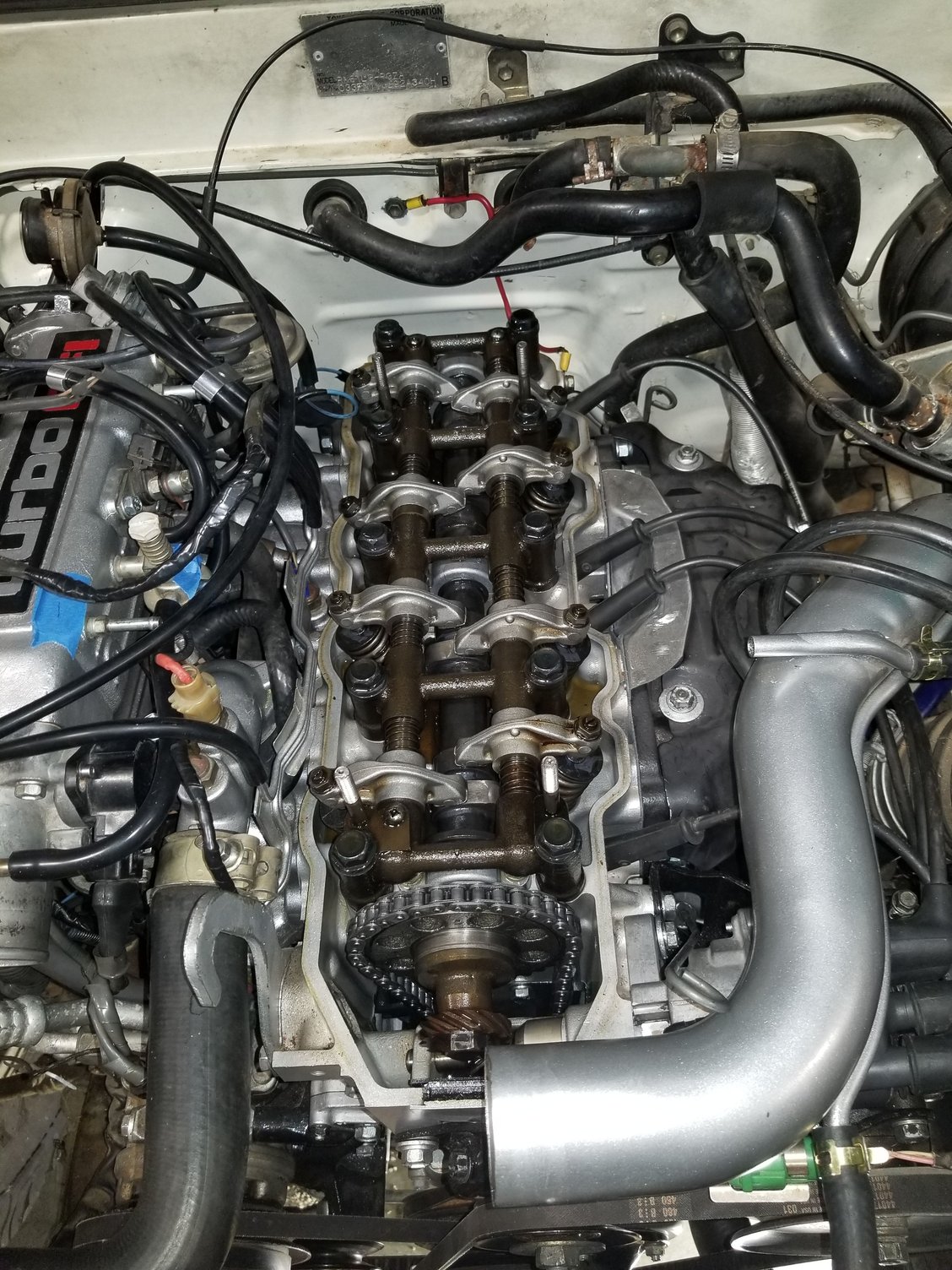

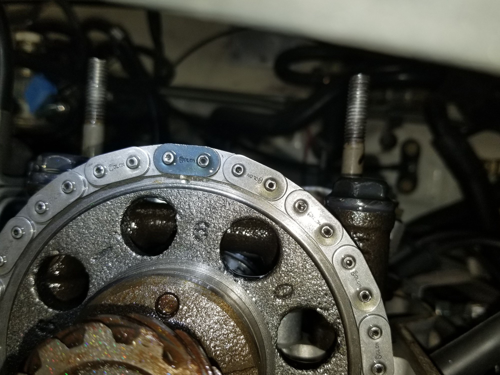

Is your mechanical timing one tooth off? For some reason i thought it was supposed to be slightly left of the very center, yours looks slightly right. Pictures can be deceiving though.
i looked at 4 crawlers page, his appears slightly left, i remember mine was as well. Although i had .010 mild from the head and block so. 020 in total
That was my thought as well.

in the pictures, they were taken at 0* TDC. these trucks are timed at 5* BTDC. thats probably why youre seeing it off a bit.
