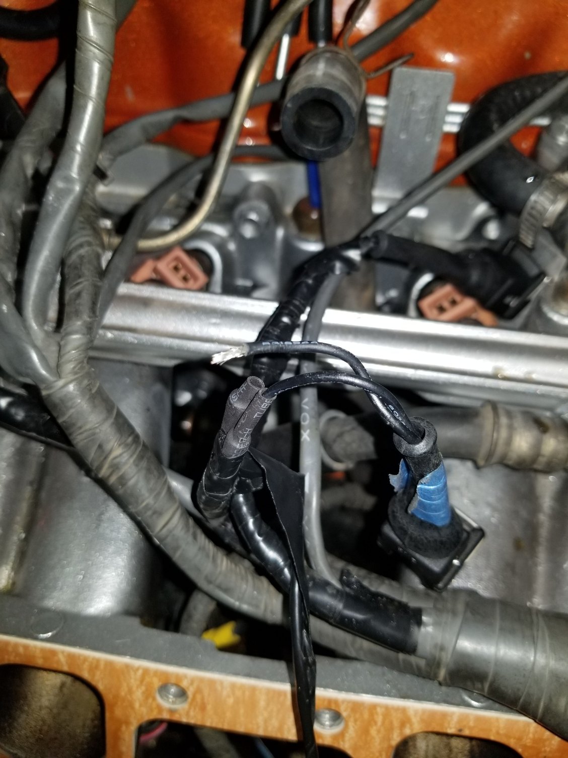

ok, maybe it WAS the fact that the injector pigtail I crimped on had pulled loose and was just being held in place with heat shrink. Which makes sense since every time I tested it it had a good connection, you lift up and it forces the tail to touch the connector, but you plug it in and the angle it bends caused the tail to pull out a bit.

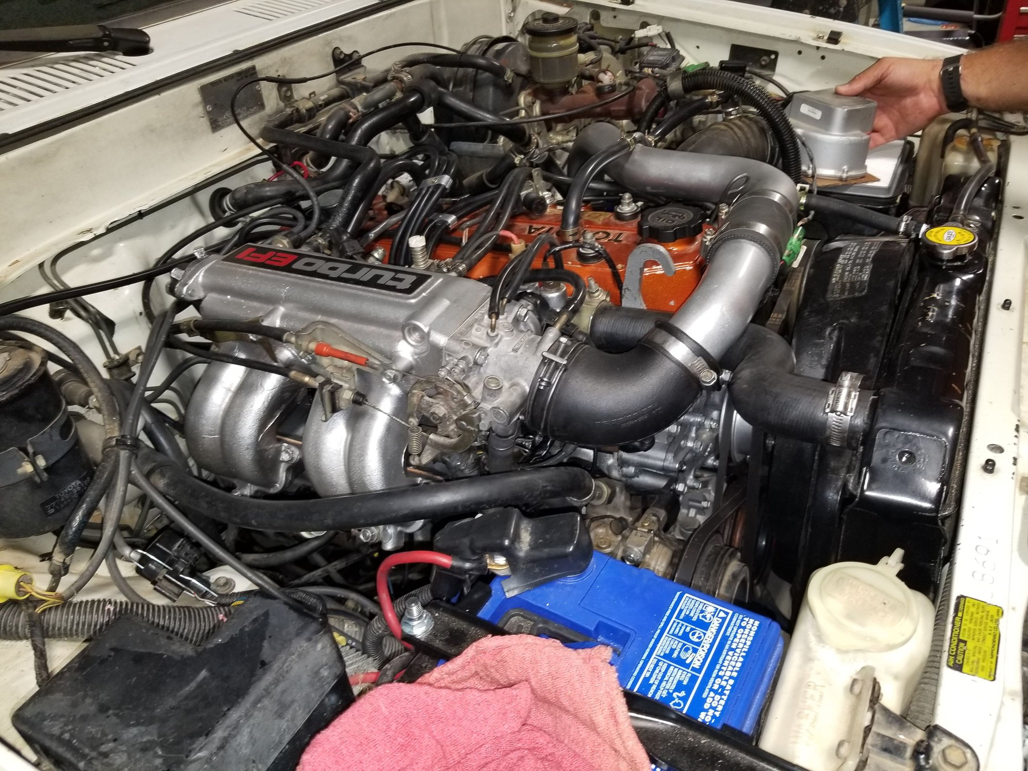

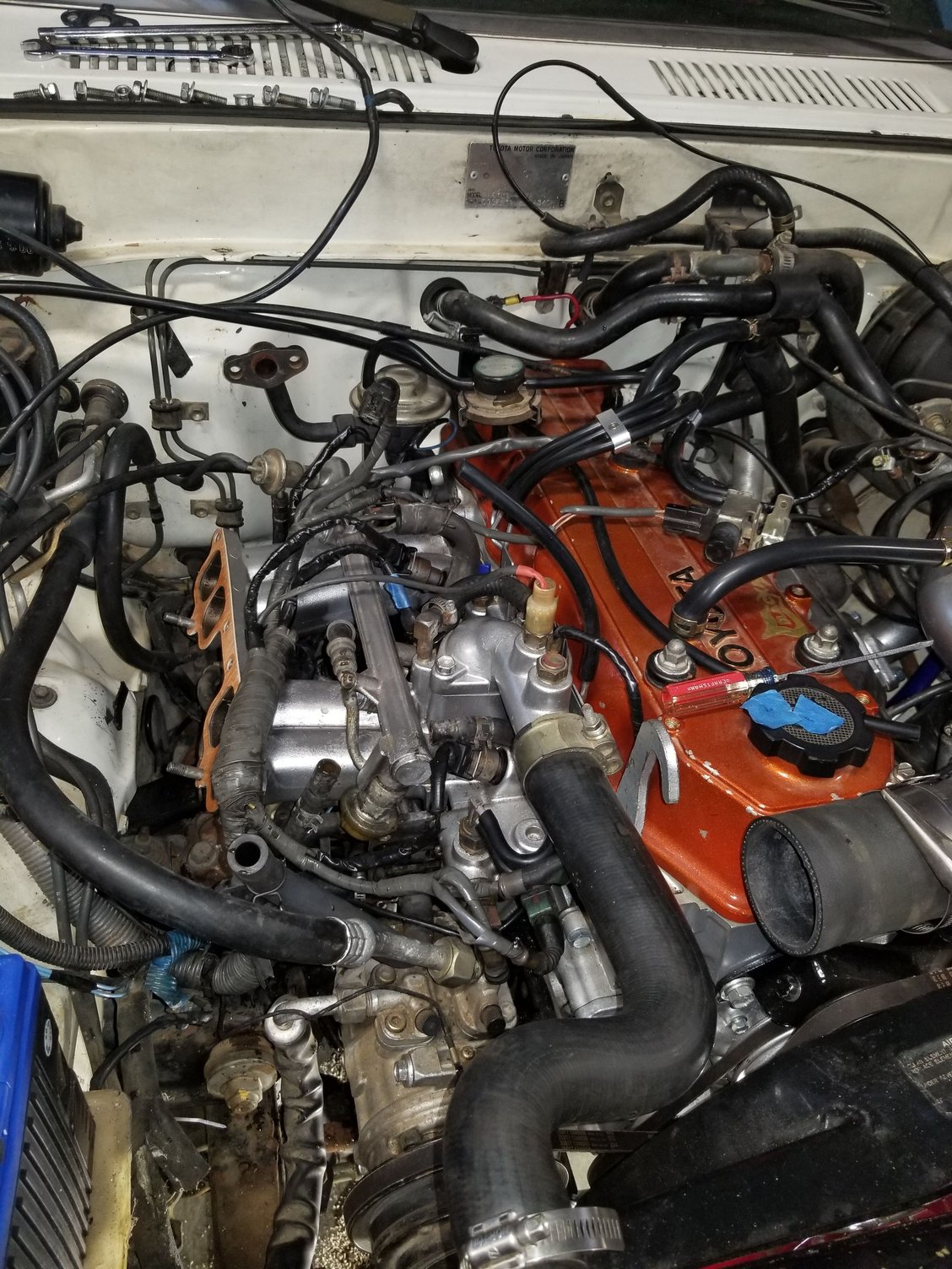

pics and videos as usual.

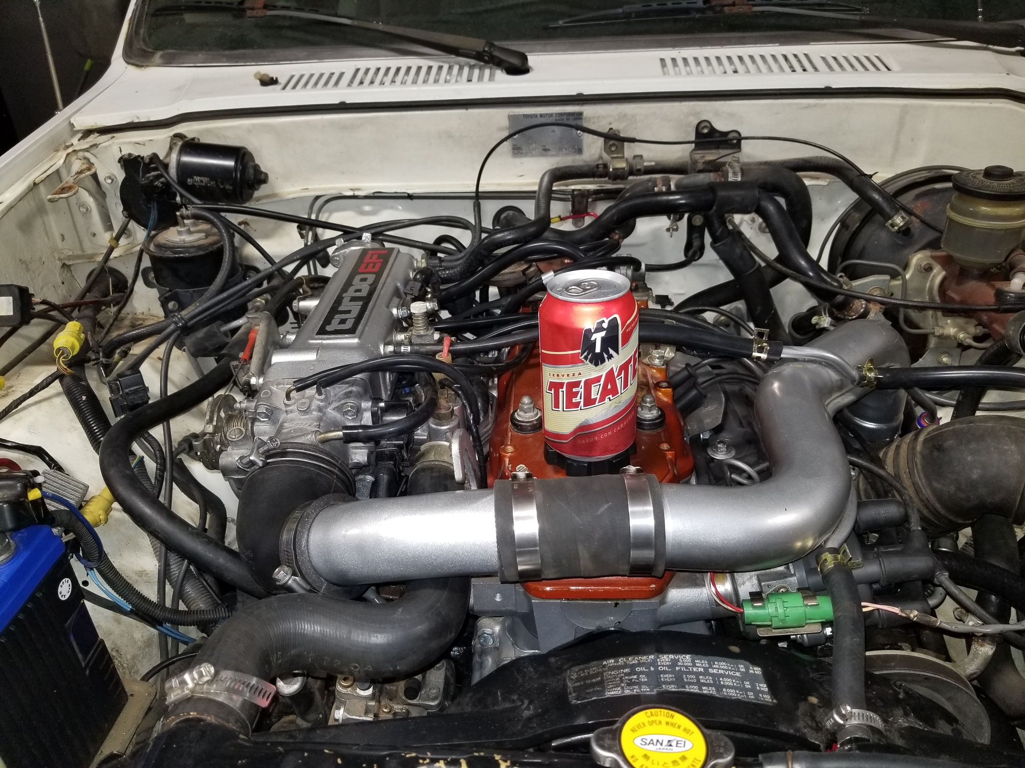

hopefully this is the last time I take this intake off. You can see the hose I forgot to re-attach between the thermostat and the #1 injector.
This is what greeted me when I removed the electrical tape. I thought I had done so good before!
All back together.
And a success beer! Well, it's a tecate, so it still tastes like failure, but it's what I had on hand in the shop.
Video showing that timing is spot on.
video showing the miss as of right now. Where should I look for it at?

I hate loose connections, they test good most of the time unfortunately.

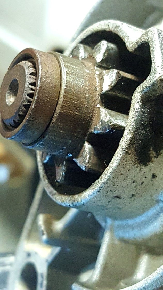

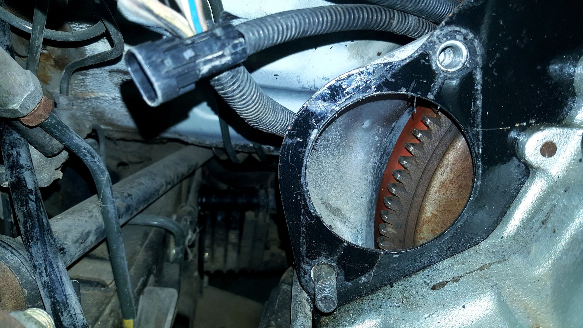

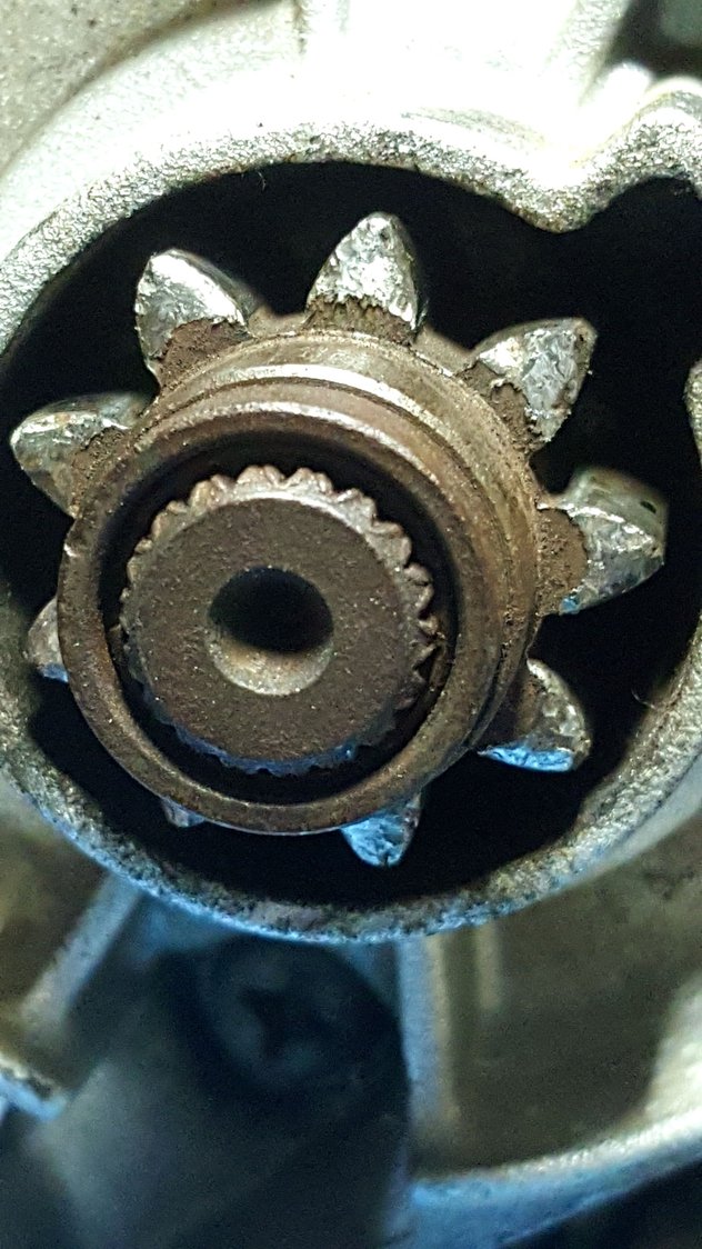

Kinda upset right now. Started out the night by getting the drivers wheel off and tightening the turbo oil line. I think that's cleared up, so no more leaks there. Got the water refilled in the radiator and got the oil topped off. Did a complete all-around of all lights, signals and electrics in general. Everything is good except for the front passenger turn signal. Need a new bulb.
next step was going to be checking the ATF since it did leak a bit out. So with the truck running, I had doomy put the truck in reverse with her foot firmly planted on the brake. Yea...the truck didn't like that. Engine started bucking real bad as soon as the RPMs dropped and as soon as she put it back into park, it died. Tried to start it a few times and it just sounded horrible. Like a deep metallic thunking noise. And then......the starter spun up but no engagement on the flywheel. Just a whirring noise.
so, either I munched the teeth off the bendix, the bendix isn't engaging, or I stripped teeth from the flywheel. Gonna wait for the motor to cool enough to pull the starter and have a look. If the starter is shot, I've got a brand new one ready to go in. If the flywheel is shot...its game over. I will have to tap out and rush to get the Honda registered and drivable(I hate that car).

If it's the starter, what worries me is, what caused it and will it happen again.

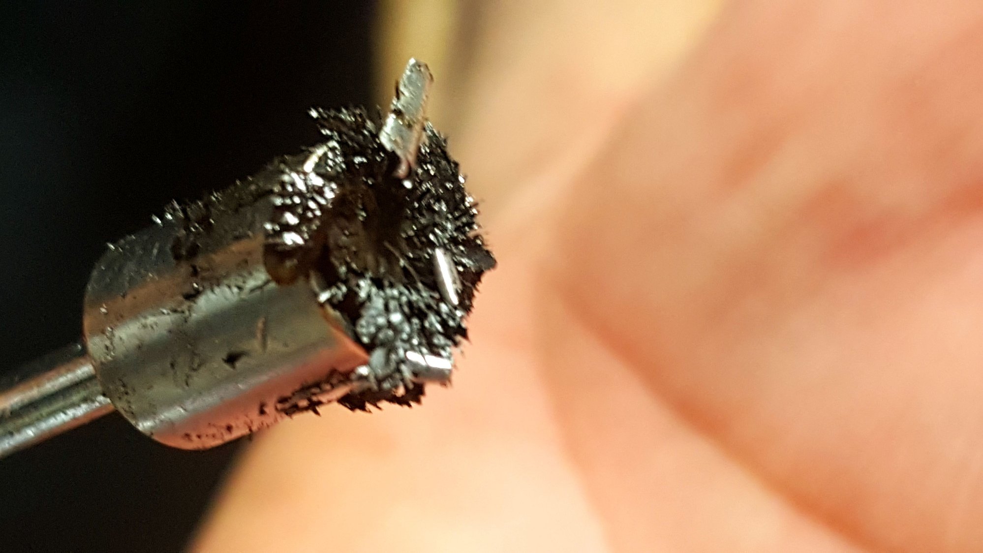

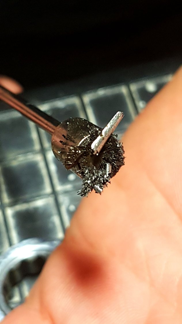

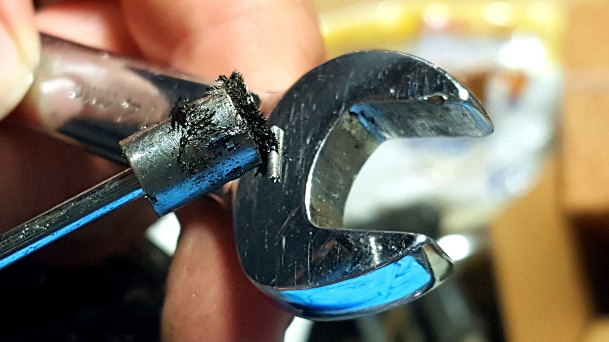

Well, this is extremely depressing. I don't understand what's caused this. I'll let the pictures speak for themselves.
