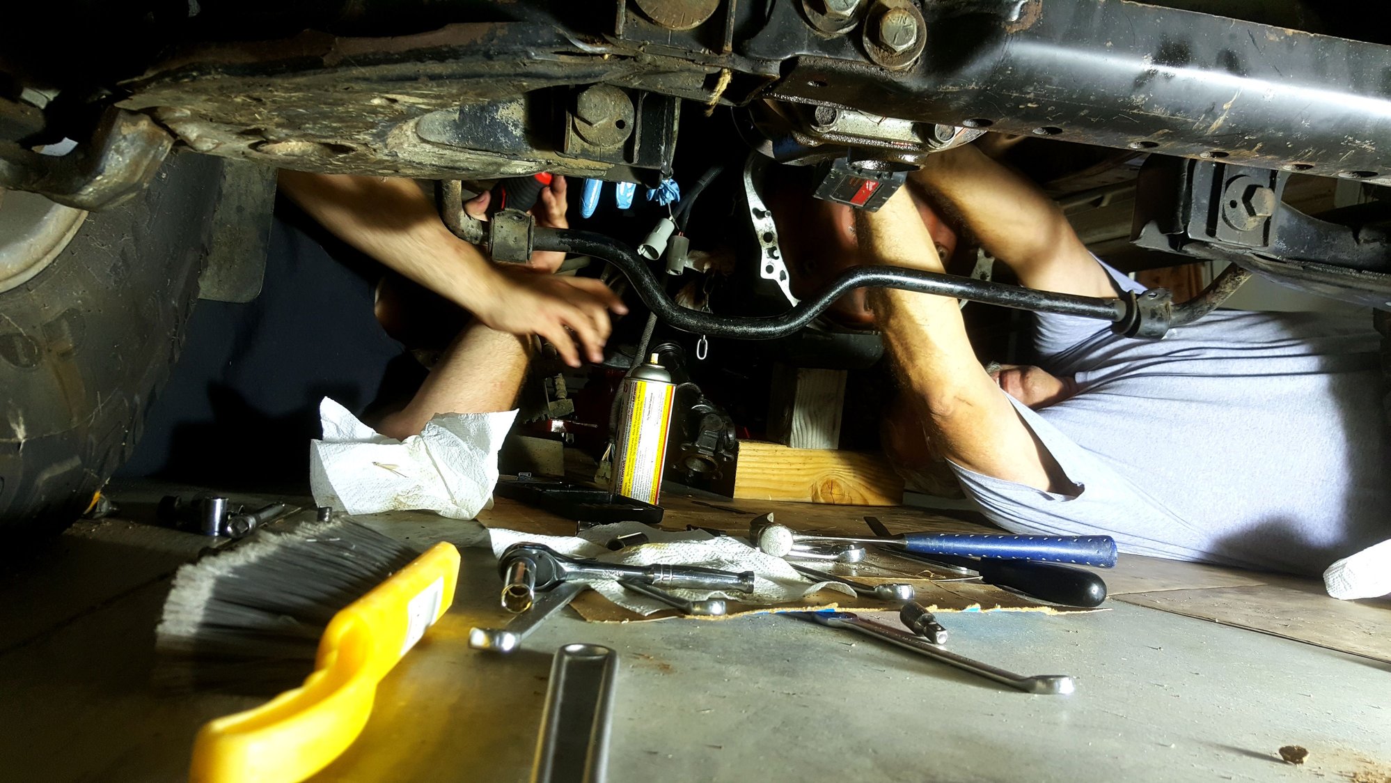

Last night I was able to leave work exactly on time and was able to get to harbor freight about 5 minutes before they closed. 9 bucks later and I was jetting home. When I got there, my dad gave me a hand drilling and extracting the broken bolts. Other than the fact that we broke 3 el cheapo especial drill bits, we had no issues. After getting them out we determined that there was only 1 really bad hole but it could be saved with a thread repairer. Unfortunately, toyota used an M11x1.25 threaded bolt for this, so I didn't have a thread repair bit that would fit. Went on Amazon and the only cheap ones they had were Chinese junk and wouldn't be here for a week. So, I utilized my prime membership and overnighted an ARP bit. It cost near $50, however, considering the time crunch, I'll eat it. We also tried to straighten the nose cone thing on the TC, but it popped off with a light hit, so...cesta vie?
tonight was my oldest daughter's first back to school night. I ditched out on work early to go meet her classmates and teacher, and to see her interact with other kids. Truly an awesome feeling. After that we came home and I headed to the shop with my Neely acquired restorer. Took me about 40 minutes and what seems like half a can of oil, but I got all the threads cleaned up. The one that was truly bad was a bit rough and took the longest to fix. But I finally got it. Lots of junk metal removed, but it is now butter smooth with how it turns. Then i had doomy get to work with a file to get rid of the burs built up on the crank. It is nice and smooth now as well. My dad wasn't able to go by the wreckers to get the flex plate, so I will be doing that tomorrow after I drop my girl off for school for the first time.
so, tomorrow, take daughter to school and get the flex plate. Then back home to get it installed. I think i will be torquing to 80lb ft this time and maybe go overboard with the blue loctite. Then pick the girl up from school. Gonna take some time to hear all about her day. Then back to the shop to get the trans installed.
my dad is allowing doomy to drive his old work truck until we can get the runner registered and all good to go. It gets 10 mpg, has 330k miles and the rear dif, I'm pretty sure, is bone dry, but it's faithful. Been sitting for a year in one place. Gonna throw a new battery in her and she'll come right to life. That thing has never really let us down.
anyways, pics as usual.

Didn't get many pics from yesterday. Spent all afternoon in the shop working on the runner. Darkfairytales came over and lent me a hand and without his help, I wouldn't have gotten as far as I did.
so, whay did I get done? Well, new flex plate is in with gobs of blue loctite. Trans is installed. Trans is refilled. And, good news, no more knocking noise!(go figure, fix the problem and the noises go away). Shortly after Keith left for the night, I was able to back the truck from the shop. Put it in gear and drove about 100 feet where it shut off. When I tried to restart it, the fuel gauge was just flashing. Crank, but no start. After about 10 mins of cranking and looking, the fuel gauge stooped flashing, but still no crank. I even swapped out to my replacement COR I got and I can now hear the relay click, however still no start. So tonight, for the first night in over a year, the truck sleeps outside. Hopefully we can get it started tomorrow and drivable enough to take to the shop.

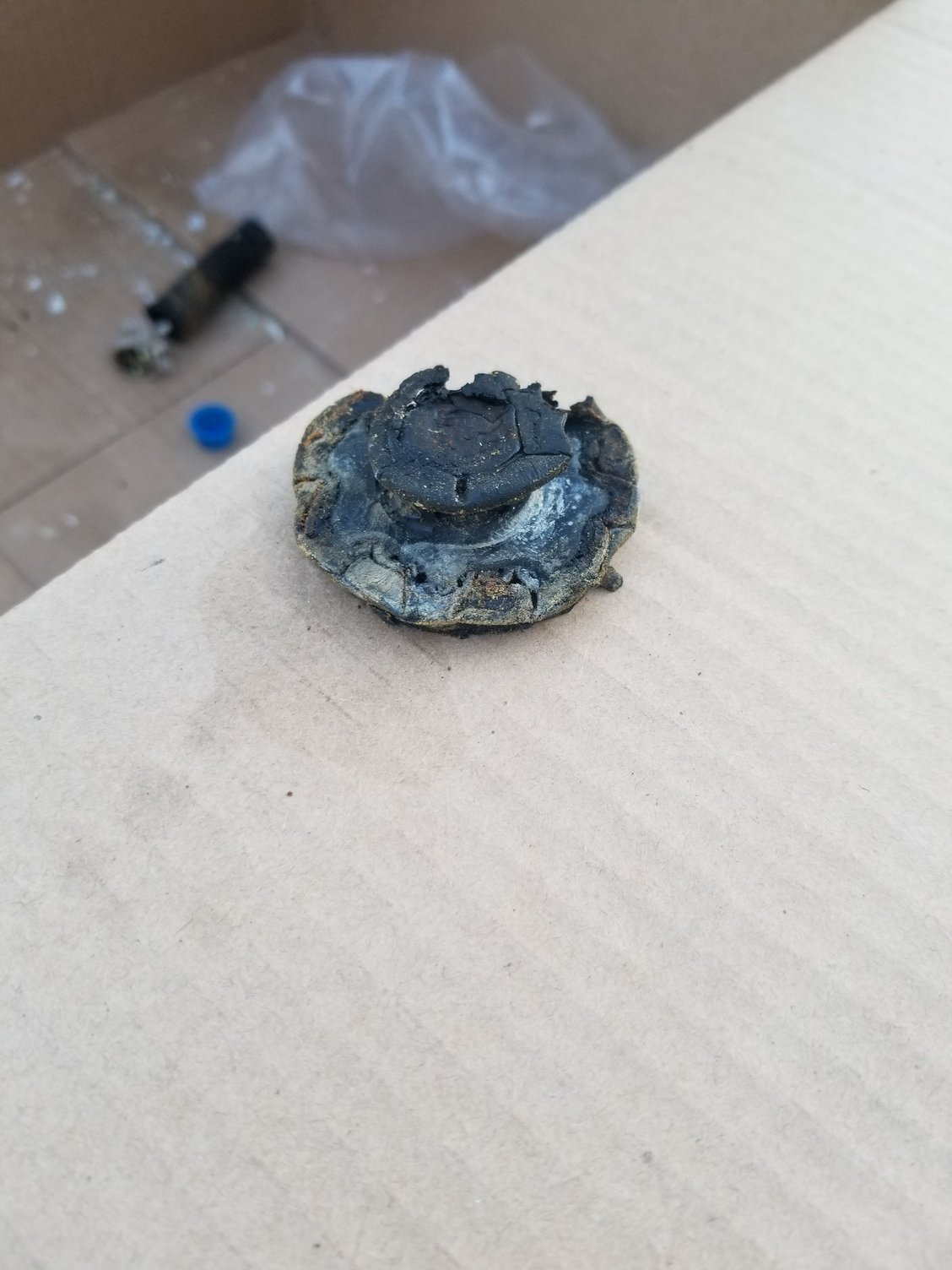

Figured out why it wasn't running. Fuel pump gave up the ghost. Interesting timing... anyways, ordering a Denso pump would have taken me 2-3 weeks, so I grabbed a Delphi from autozone. Pulled the old one out and realized that the strainer was shot. So had to run back into town to get a strainer. Oreileys was the only store around who had one so we grabbed it and headed home. By the time we got home, sun was down, but we got the pump assembled and installed and took the truck for a spin. First time out in the big bad world and it was......underwhelming. it's gutless, but idk omif that's because of the misfire or because of the 4.10s and 32s. Basically, I couldn't get it up to 40 in a quarter mile. Lol. But she drives! Like a real vehicle! Under her own power.
I expect the 4.88s to really wake this truck up. I hope, at least. This week, we need to wash it, get the lugs swapped out and have the tires aired up, get the bumper and the hitch installed, stereo in, speakers in, and the list goes on and on and on.
so thankful toyota made these easy to get to.
all ready to pull.
30 year old fuel pump. This thing is nasty nasty nasty.
Corrosion, rust, jellies fuel, and deteriorated rubber everywhere.
The strainer was so packed with bad fuel and debris that it sucked the filter clean off. It was k my attached on 1 side each.
This is the rubber isolator that the pump sits on. Either it melted, or the fuel had gotten so bad that it melted it. Either way, I had to scrape it off of the pump with my fingernail.
