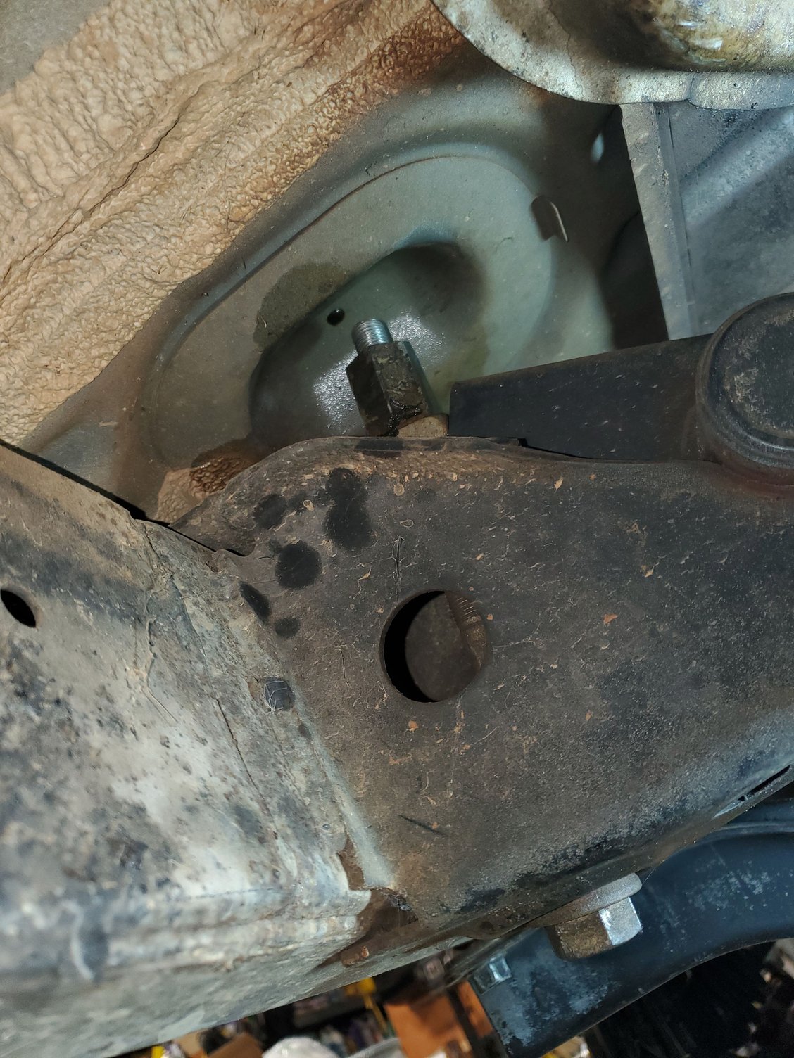

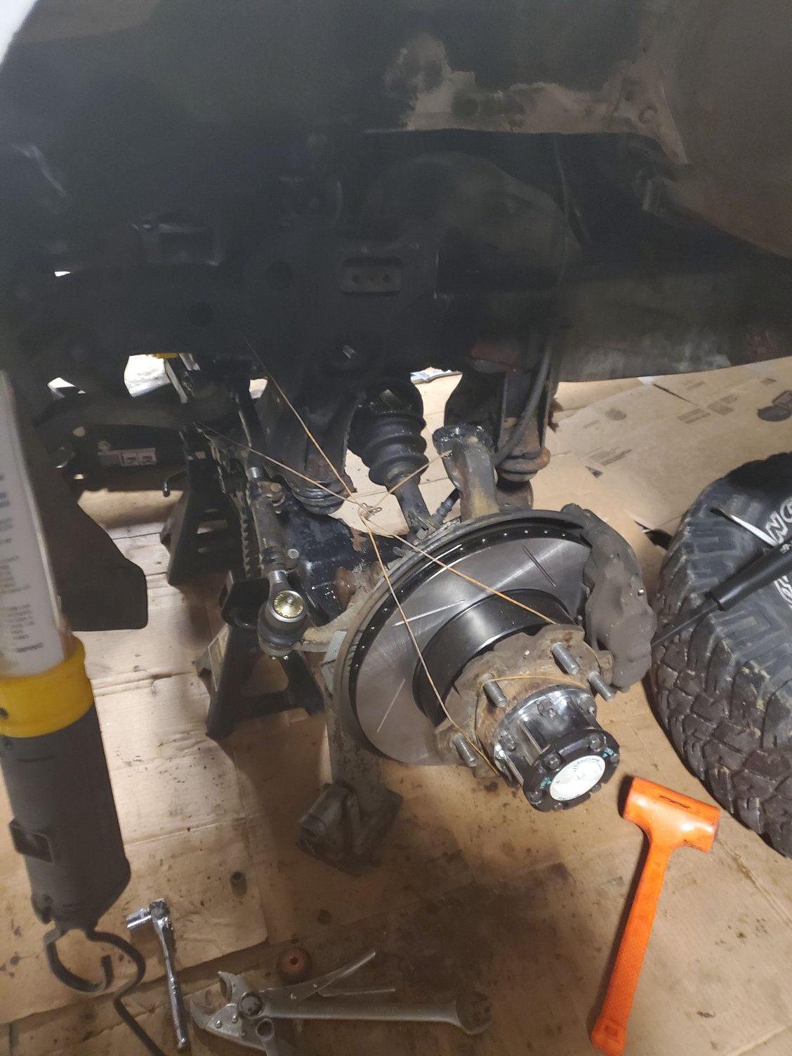

Last nights activities were successful. Ended up getting the T-Bars out very easily(i was worried about those snapping, but they look almost brand new and no rust), the UCAs out pretty easily(The top 3 bolts were a pain but nothing the big miluakee impact gun couldn't fight through), and the bushings all burned out of the UCAs. surprisingly, the drivers side was still pretty tight. passenger side was waaay roached. so, some torch work and a screw driver, and we were able to get the UCAS stripped and ready for their cleaning and modifications for the bj spacers today. Do a little bit of chop chop, a little bit of paint paint, and slap all the goodies in. The LCAs should be a breeze. @MaK92-4RnR gave me a set that was torched off a rig for IFS many many many years ago and , thankfully, i havent thrown them out. so, those will get the busings burned out tomorrow and same cleaan/paint routine. they will go in after the uppers are back in and holding the spindle. I think the thing that im most nervous about is trying to get the new sway bars in and indexed correctly. Oh well, we have until sunday to get this buttoned up before the sloooooooooow drive into town for the alignment.
Pics as usual
T-Bar jamb nut just popped right off. kind of confirms my theory that these were already cranked up when we got it.
Toasting the marshmallows for the smores.
My dad going to town with the screwdriver on the crispy/melty bushing.

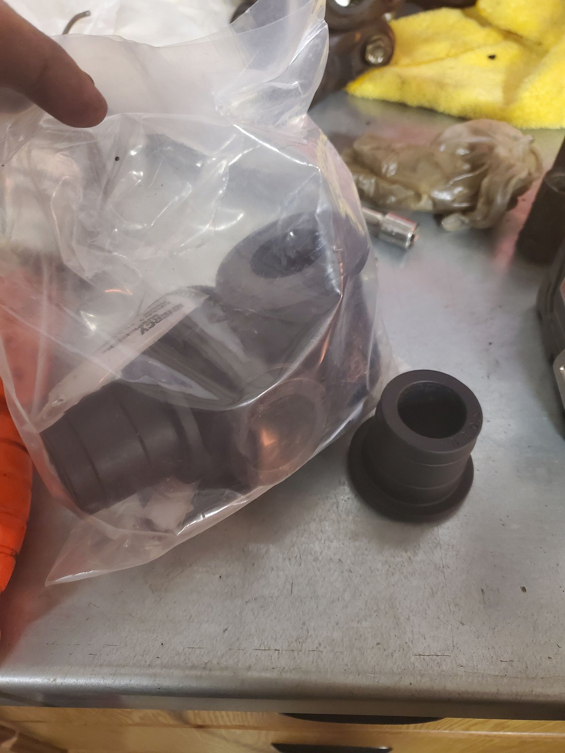

Brand new Energy Suspension Poly bushings ready to go in
How we left the spindles hanging so that they dont separate the CV. My dad jokingly commented that this truck is officially being held together with duct tape and bailing wire... :rolleyes:
Box-o-parts ready to get doused in superclean, scrubbed with a rag, and pressure washed. Its gonna be nice putting this back together and not getting covered in grease.

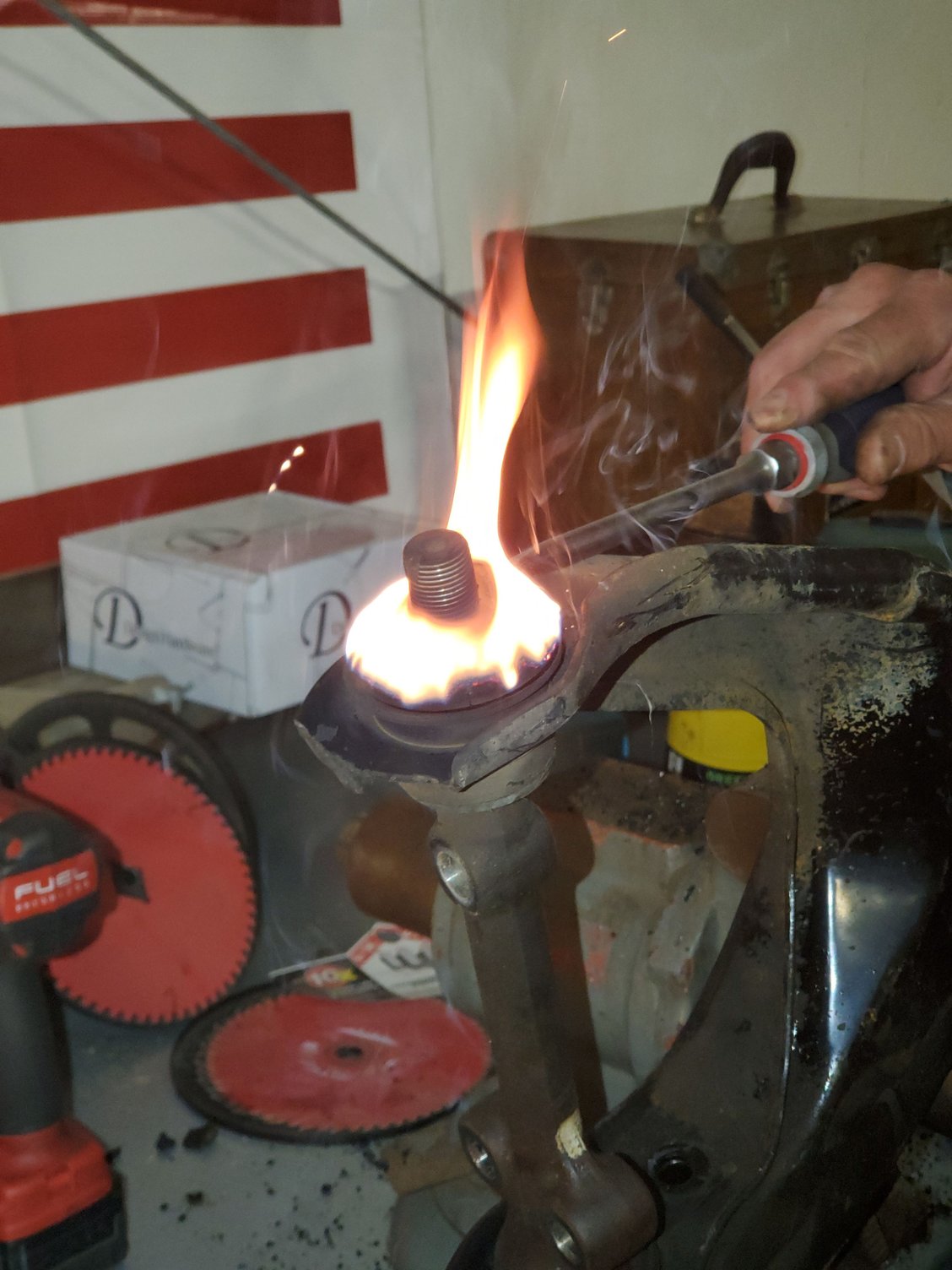

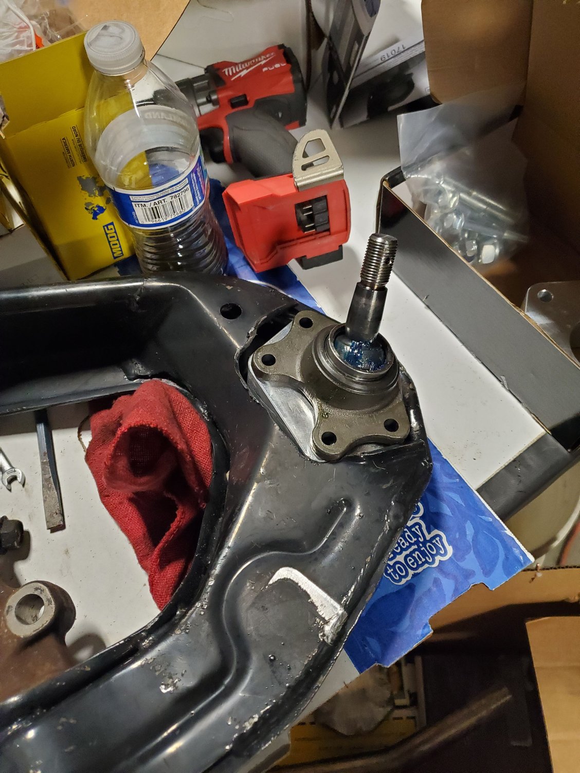

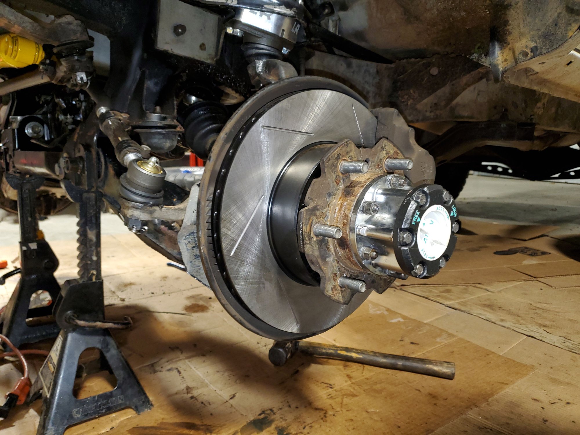

finally making a bit of progress and, of course, there's a bit of backwards momentum, but its the little victories, right?

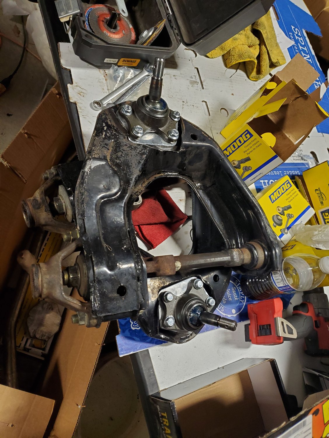

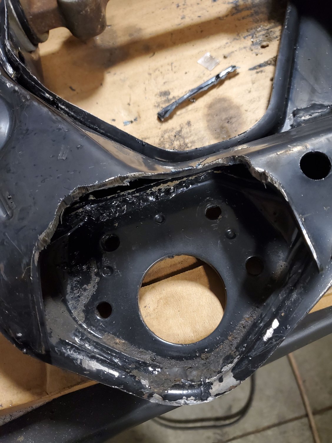

on Friday night we got the control arms cleaned up, the lower bushings cut and then burned out. we also got the new Poly bushings wrapped in Teflon and greased with that gorilla snot they call lube. stuff is more like contact cement. anyways, since we were kind of at a stop waiting for the Sway A Way T-Bars to show up, we grabbed the cutoff wheel and chopped the upper control arms to fit the BJ spacers in. First one took quite a bit of time to get right, but it finally went in. the second arm i did isn't as clean because i cut what i thought was the correct amount, but i cut off a tad too much in the corner. oh well, it fits snugly anyways. after slapping in the upper BJs and putting some paint on the cuts to prevent rust, we called it a night. it was late and the T-Bars didn't show up. We decided to wait until the next afternoon to give them time.
Saturday afternoon the T-Bars still werent delivered so i made the choice to install everything anyways since i had the appt for the alignment at 1pm on sunday. the UCAs went in pretty smoothly and so did replacing the stock T-Bars. The only thing that gave us a bit of an issue was forgetting that the passenger T-Bar needed to be installed before the UCA got bolted in. After that, we tackled the LCAs. those were a little more of a pain in the butt, however, we still managed to get them all in and installed. pro-tip, do NOT tighten the torsion bars until you have the LCA installed.

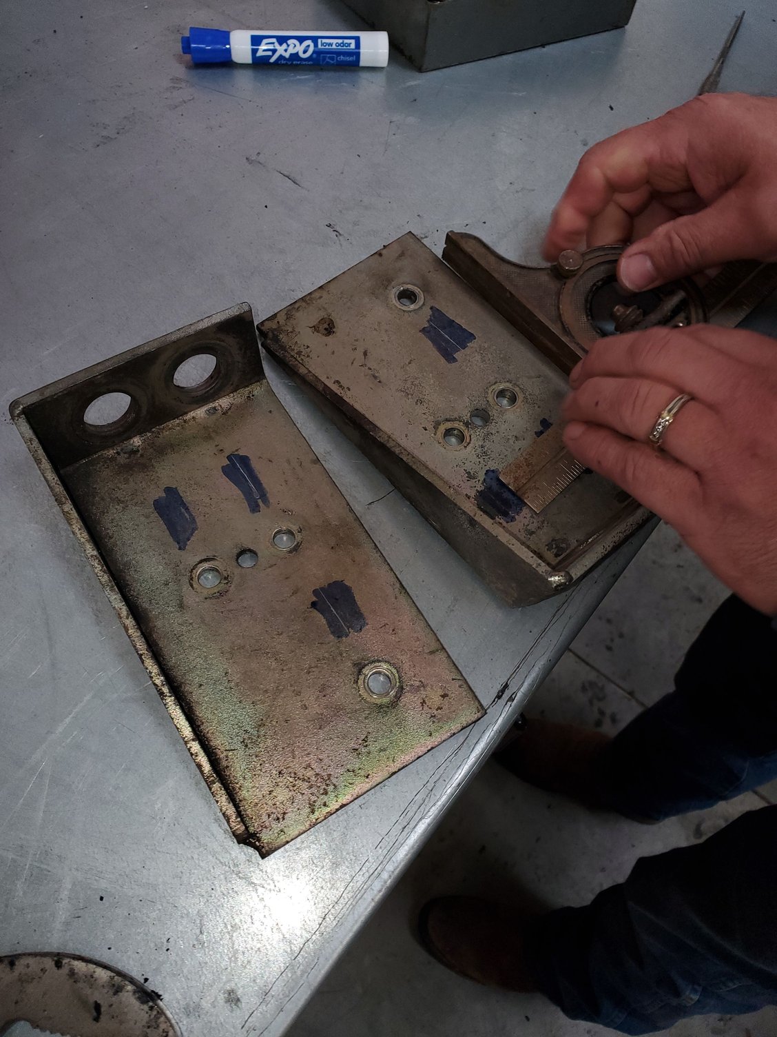

After getting everything in place and tightened for the control arms, we moved onto the shocks. here is where the first major snag(besides the TBars not showing up) reared its head. i knew that in order to install the Downey double shock kit back in the day, the previous owner had to cut off the upper shock tower. Instead of actually measuring the shocks, i just assumed that they were stock length shocks, which was a bad idea. they were not. The shock tower was moved about an 2" higher than factory. So the shocks that i got that were 1" longer than factory were a good bit away from working. It was late saturday night by this point so we decided to call it with the plan of me getting shock extenders(yea, i know, eew, but it would work temporarily.) the next morning as soon as the parts store opened.
Sunday morning i get up at the crack of light and head down to the local parts store(15 miles south of me). they do not have the shock extenders contrary to what the google machine told me the night previously. the closest store that had them was 30 miles north of MY house. so, i hop on the freeway headed north and called several other chains to see if they had them in stock. no luck. so i drive to the way north to the hood, get my part, luckily i dont get mugged in the parking lot, and head home. once home i get to work fitting the extenders to the upper bolt and.......theyre the wrong thread pitch. it never dawned on me that shocks could have different threads on them, i assumed they were all standard. So, plan B(that should have been plan A) was to take some measurements and move the bracket holes on the shock tower up an inch and a half, thereby lowering the tower down. once we didt that, we fitted the shocks, got everything all greased and tightened, and threw the wheels on. Man, i cant win for trying. everything looks great except for the Cen Cal pre runner squat and the fact that the front tires are rubbing the UCAs. This issue was easily fixed by pulling out the original 29" street tires that were on this rig when we bought it. they are a little aged, but becuase ive had them inside on my shelf for the past 6 or so years, the dry rot is pretty minimal. best part is, NO RUBBING!
All of this was completed with just enough time for me to change my shirt and wash my hands before driving VERY slowly the 20 miles of back roads to the Firestone. we made it there with plenty of time before the appointment. After they were done, they let us know that the only issue was that the drivers adjusting sleeve was seized(odd since i had just rotated them) and the front passenger camber bolt was partially stripped and wouldnt hold the specs tight. So, ive got a little more work to take care of and some more parts to order to completely fix the issue. but, shes aligned, tracks straight, rides pretty smooth, and i dont have to worry about the front end falling apart anymore.
Now to move onto getting the 63" chevys that i need for the spring swap, getting new tires that wont rub anymore, and getting the front T-Bars tuned correctly(theyre a little high right now and i want to change to the newer style hardware.).
On to pics, as usual.
Not pretty, but it works. i cleaned it up a bit after this.

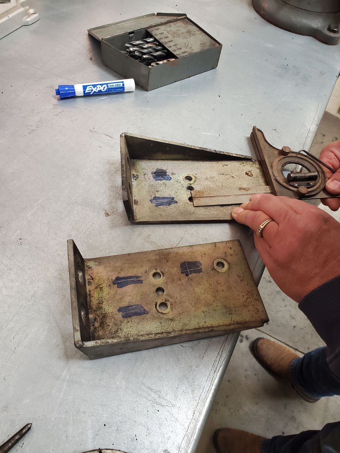

Doesnt look like it, but the balljoint actually fits pretty snugly in there.
Got a little carried away with the second one. the bottom right corner was cut a little deep because i got the angle of the cutoff wheel wrong.
Installed and ready for shocks.
Shock towers getting scribed for new holes to be drilled.
Getting the center of the holes.

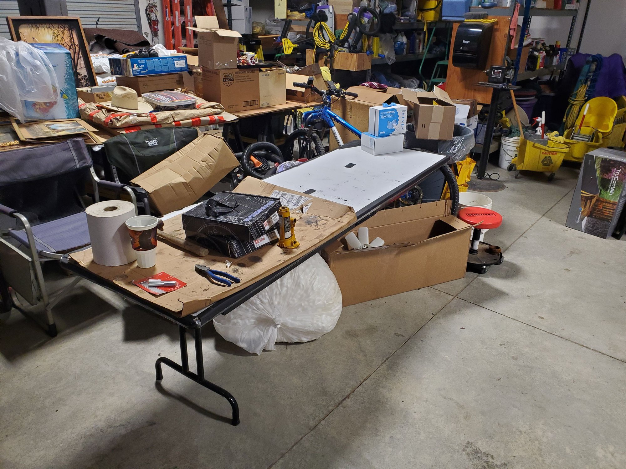

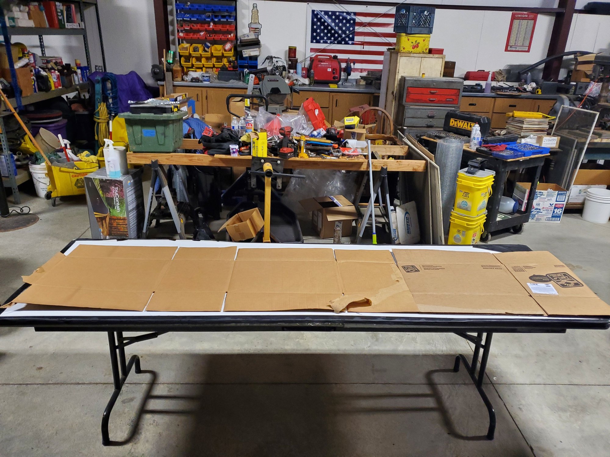

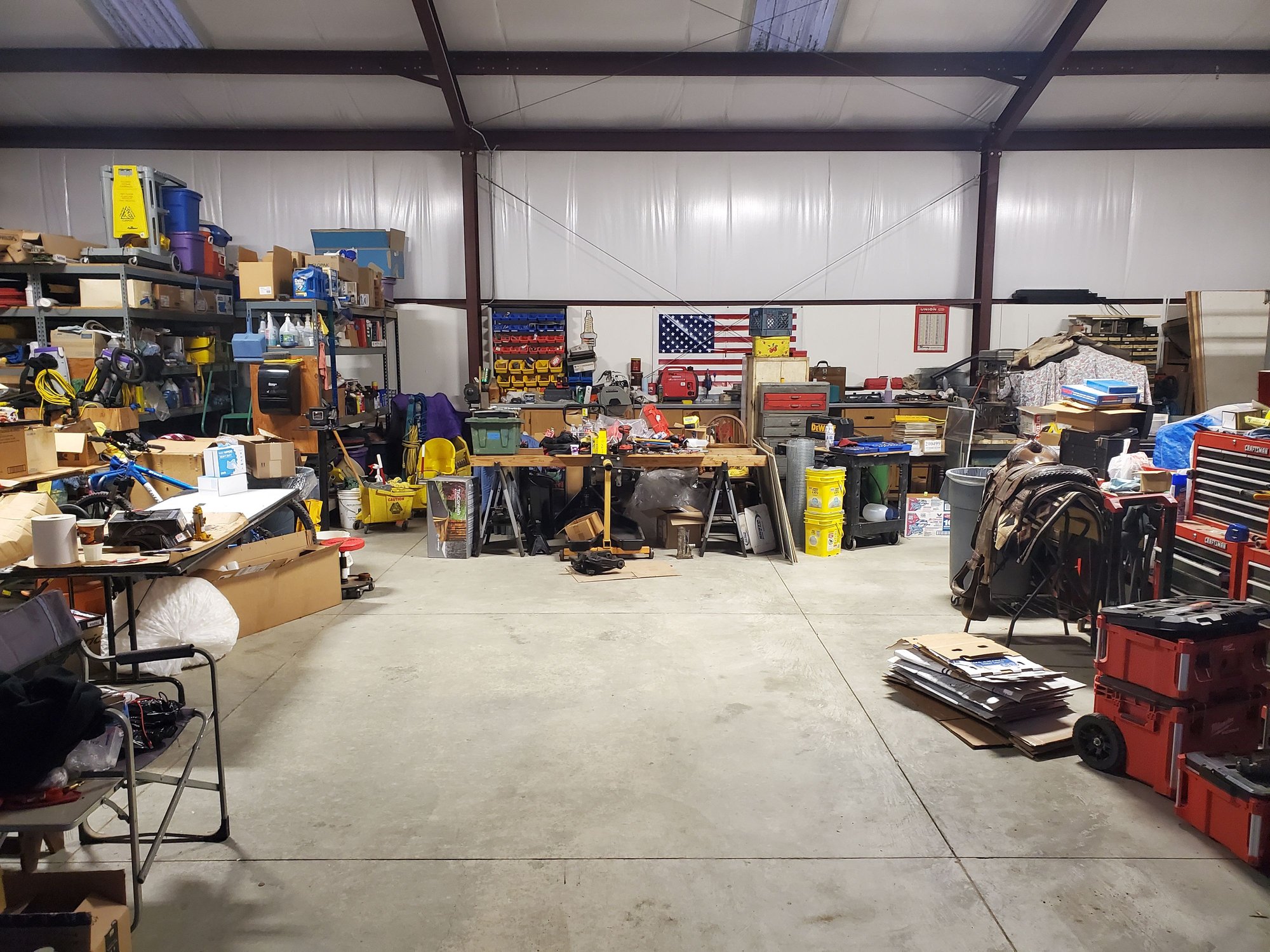

Back home and starting to clean up the shop. There is a LOT of stuff in the shop right now because my grandpas wife finally sold the house they had. He passed away about 6 years ago, so we had to bring all his stuff and stage it in our shop to be sorted through for the family.
Looks empty without the 4runner in here and all the cardboard cleaned up.

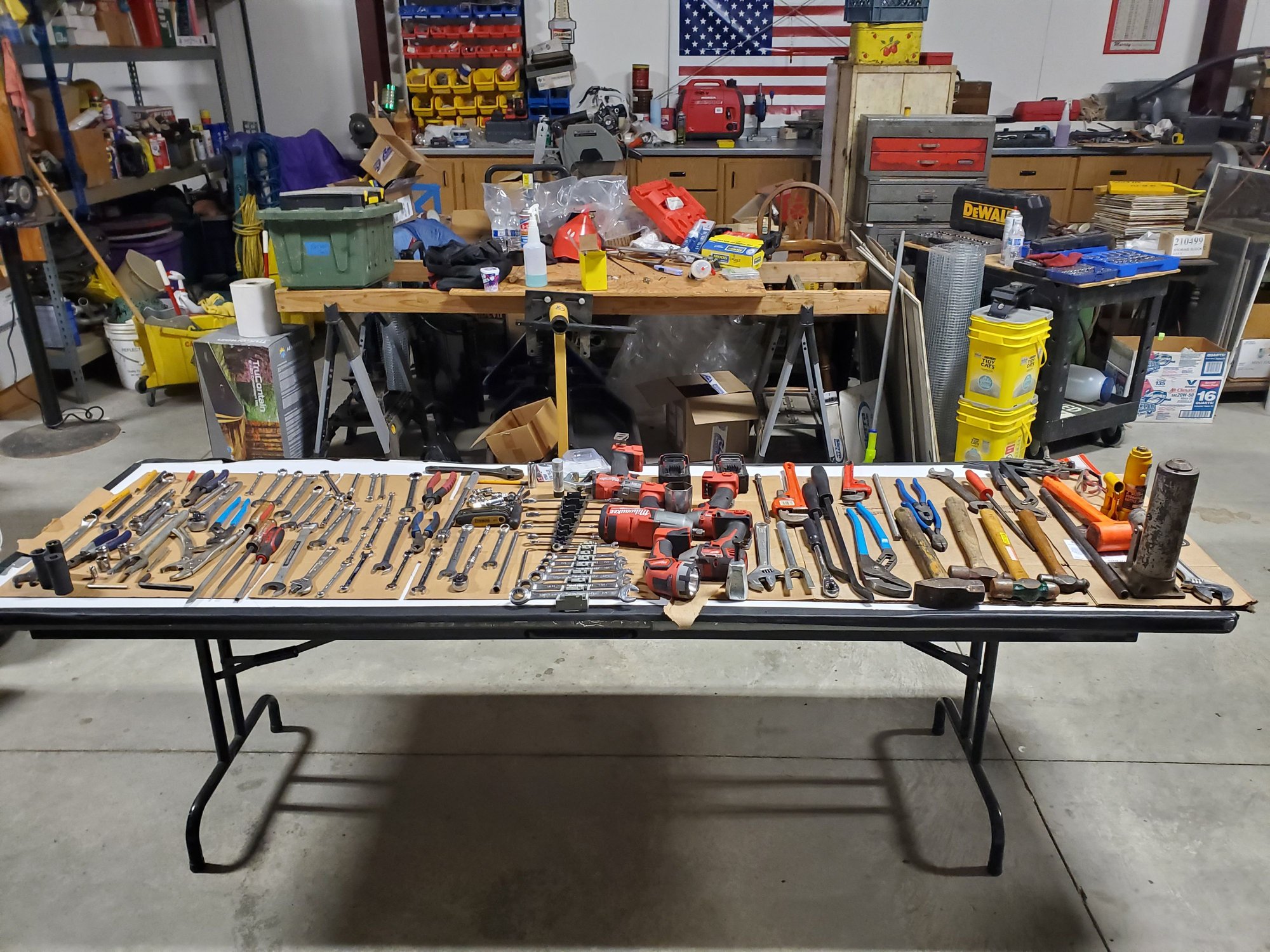

Portable table cleaned up and ready to clean tools
How many tools did we need? eh... probably did NEED this many tools, but we had access to em.
