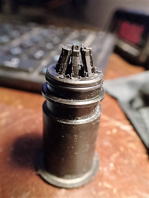

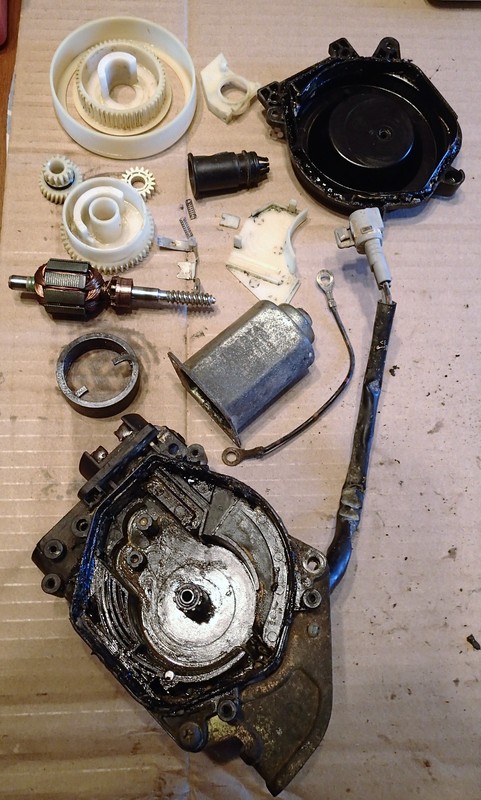

Last night between job 1 and job 2, I got a little more work done. Well, WE got a little more work done. And by little, I mean, almost nothing. But we operate ed a bunch of parts that arrived!
eh...anyways, doomy got to work ripping out the fender liner and pulling out the power antenna since we got the new mast in to replace the broken one. First off, the fender liner had a bolt that was held in by, no joke here, a smashed jaliscos cap as a washer. There's a crack where the bolt goes in. So, I guess this worked like a large washer. Still...smh. anywaus, Doomy gets the antenna out and.......it looks completely different than all the writeups I've seen on replacing the mast. Uh-oh... Google the part number on the motor and it comes back as a 3rd Gen 4runner or tacoma. So now I have a motor with no mast that doesn't belong in the truck. And a brand new Mast with no motor. If anyone has a motor they'd like to donate or sell, please let me know! I need one!
while Doomy yanked the antenna, I got to work fixing my mess of a wiring job for the starter relay. It still needs a 30 amp fuse, but I'll add that as soon as I get my order of connectors in. I think it looks pretty good and unless you look real close you can't tell it's there. My dad didn't notice it, and he's pretty observant.

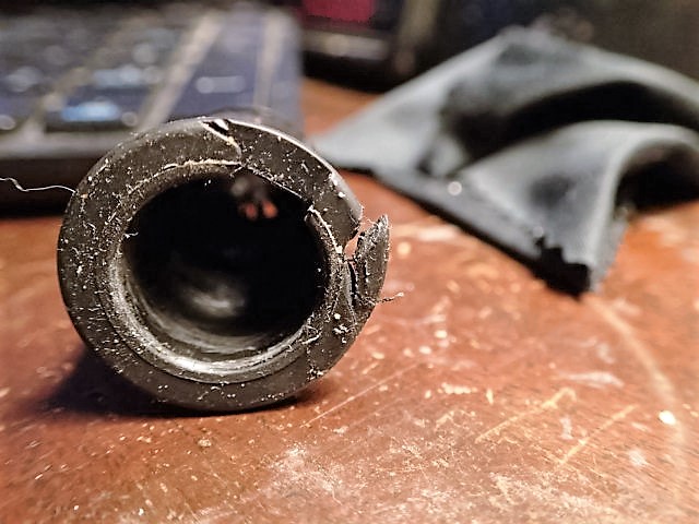

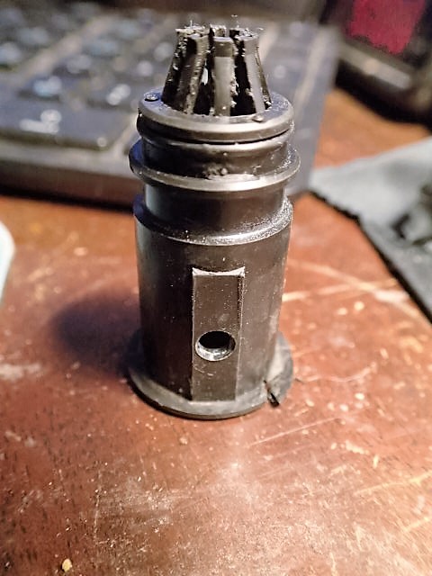

The motor in question. I don't even know if it works.
Power antenna? Meh... More parts to break. I deleted mine and replaced it with hidden one sandwiched between topliner and fiberglas roof. Decent FM reception and so-so AM reception but less to worry about.

Glad I've been able to find antenna motors in the junkyard. The last one had a bent mast so it was $5. I used the innards to refresh my worn gears.

Which reminds me. I never throw anything away. It's annoying. Would this be all you need to get your antenna going? It's off a 3rd gen antenna motor.
