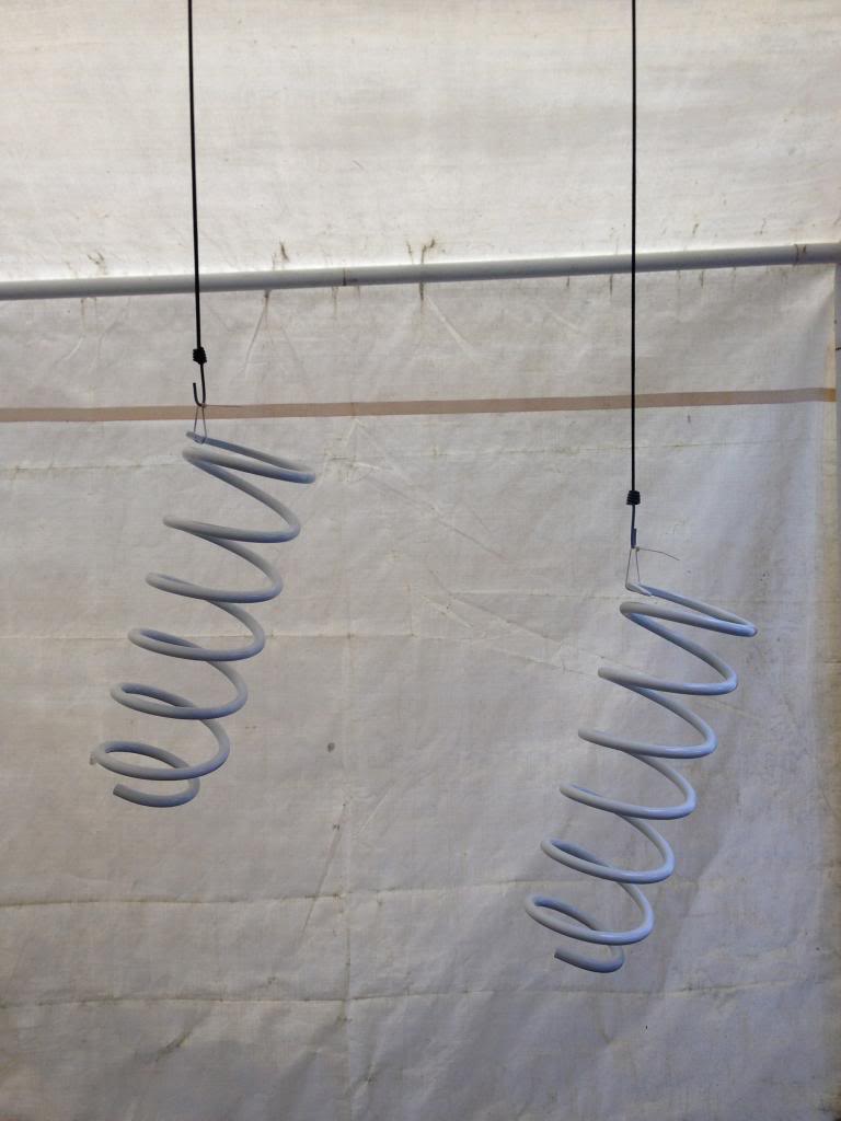

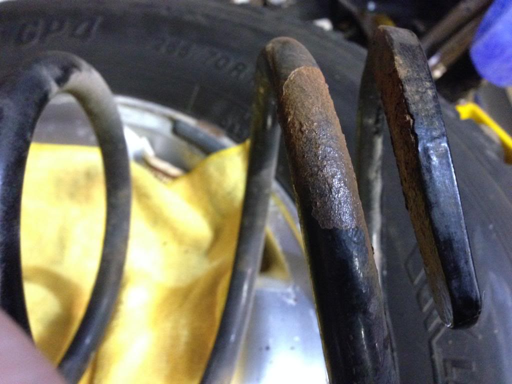

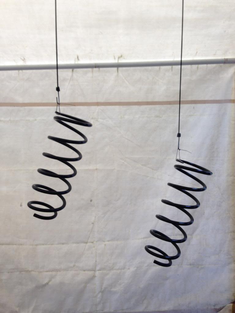

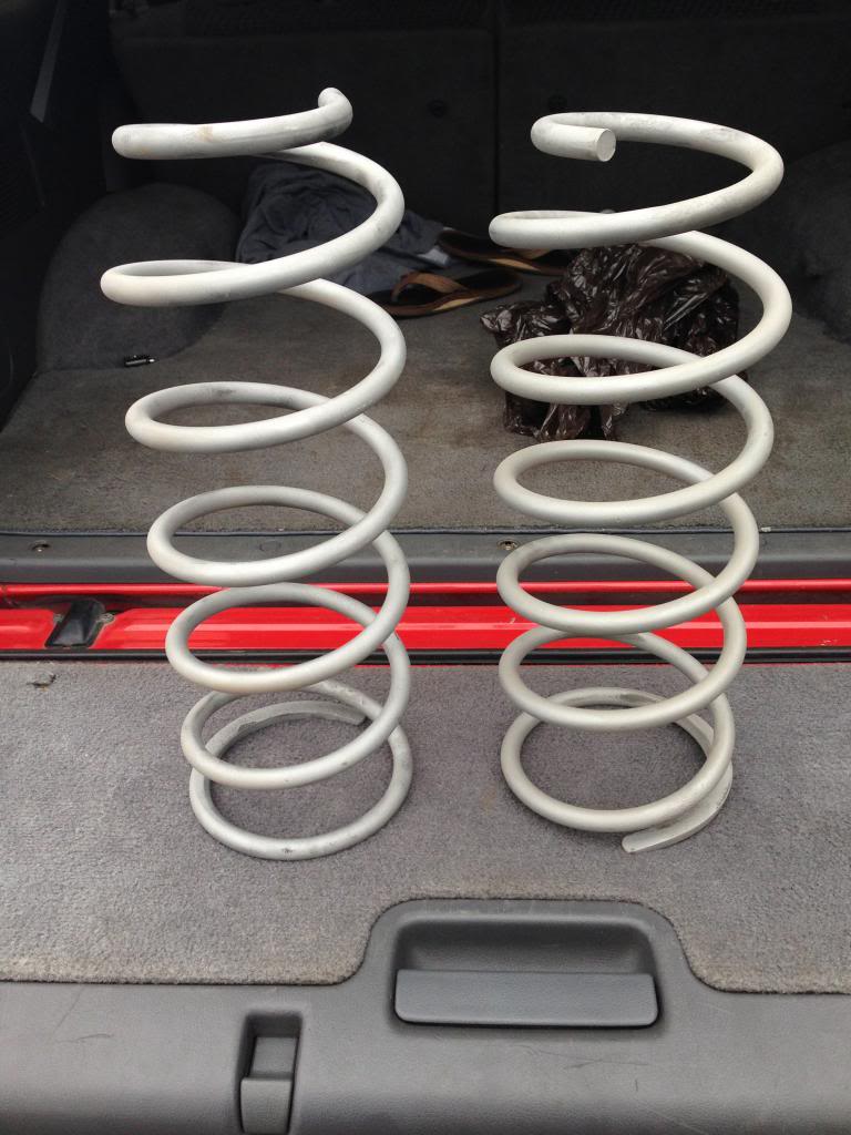

Landcruiser coils sourced by TORFAB Name:  IMG_0103_zps44c862a1.jpg
Size:  75.4 KB I went and had them media blasted by a PC/FAB shop down the road. No more rust, I opted out of a powdercoat after a bit of research, plus paint is cheaper. Name:  IMG_0113_zpsca915bd7.jpg
Size:  97.9 KB Then I brought them home, cleaned, primed and painted them exclusively using Rustoleum Name:  IMG_0117_zps47745720.jpg

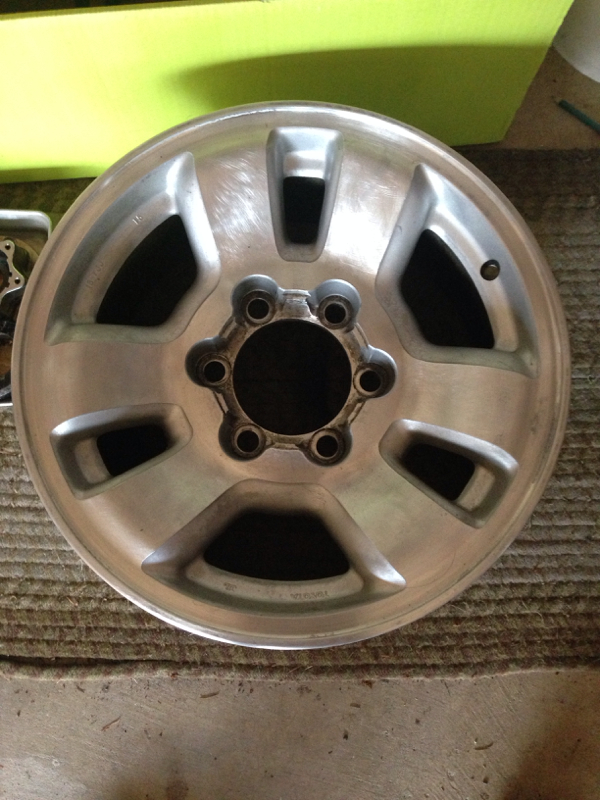

Set of 3rd gen wheels Name:  IMG_0122_zpscba28c43.jpg

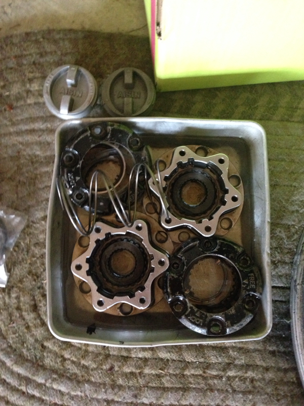

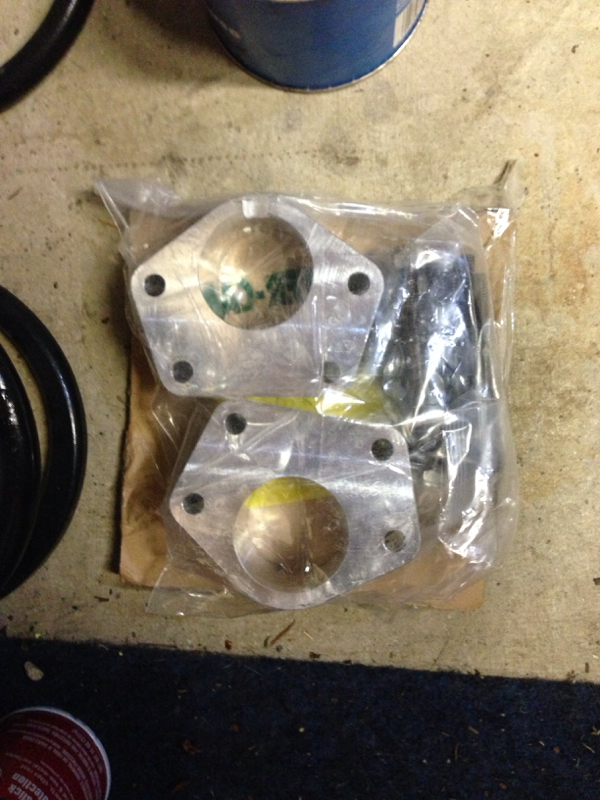

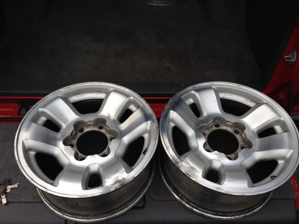

Replaced the moonroof switch and added a garage door opener. Rebuilt some manual hubs that I sourced on ih8mud. Made some progress on the wheels. Ordered some bj spacers from 4crawler. Also had a clutch kit come in and put in. Pulled the running boards and changed the oil as well.

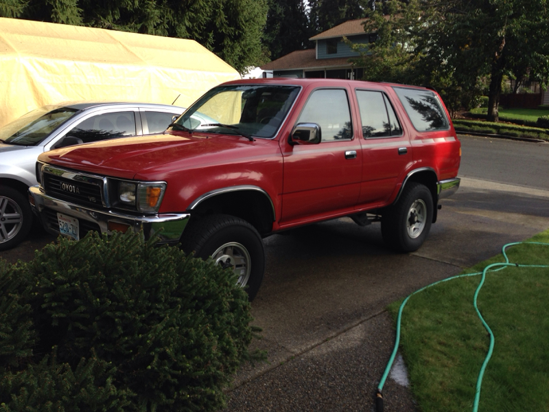

Removed chrome wheel well trim and peeled off the body side graphics/removed all corresponding glue.

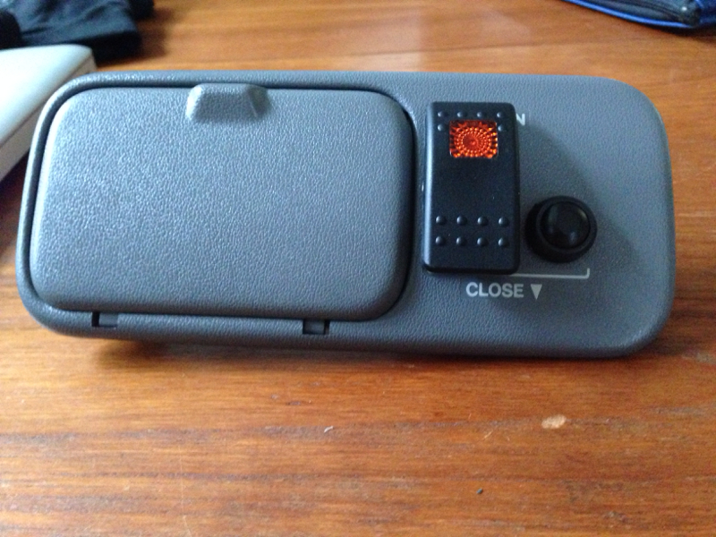

The final stage of the moonroof switch cover, with garage door opener. The oem switch was out, and the replacement would have cost more than I wanted to pay. So we replaced it with a Carling style DPDT mom/off/mom switch with red LEDs that stay lit while the vehicle is on. The button to the right is connected to a modded garage door opening unit that I just placed in the headliner.

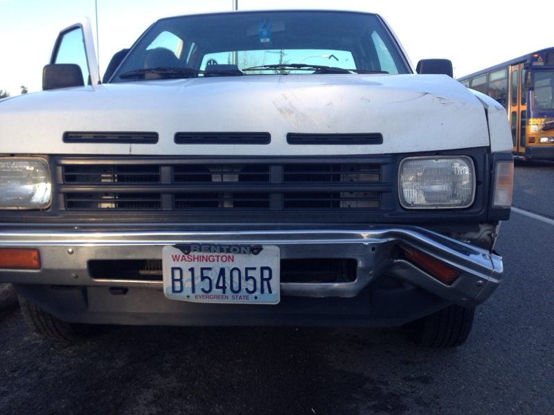

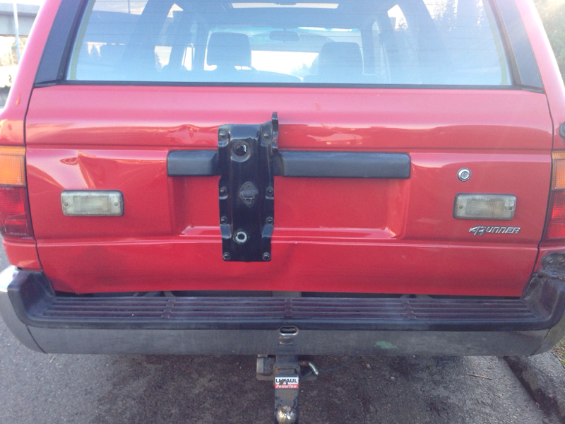

Was hit on the way home from work yesterday, I was at a dead stop, he hit me doing 35, rounding the corner of the on ramp onto i405 South. Toyota envy from the 2WD Nissan.

Originally Posted by d21cruisa
Dang, that sucks!!! I assume you'll be getting it fixed?
I'll probably just replace the tailgate and call it good. Bedlining the entire truck was in the plan, so I'm not worried about color matching.

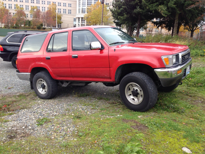

Threw on my third gen wheels prematurely, my current tires were about done. Mounted Bridgestone REVO2 285/75/16. Installed Cardone remanufactured CV halfshafts. Installed Aisin manual hubs. Couldn't complete BJ spacer do to frozen Torsion bar bolts.
