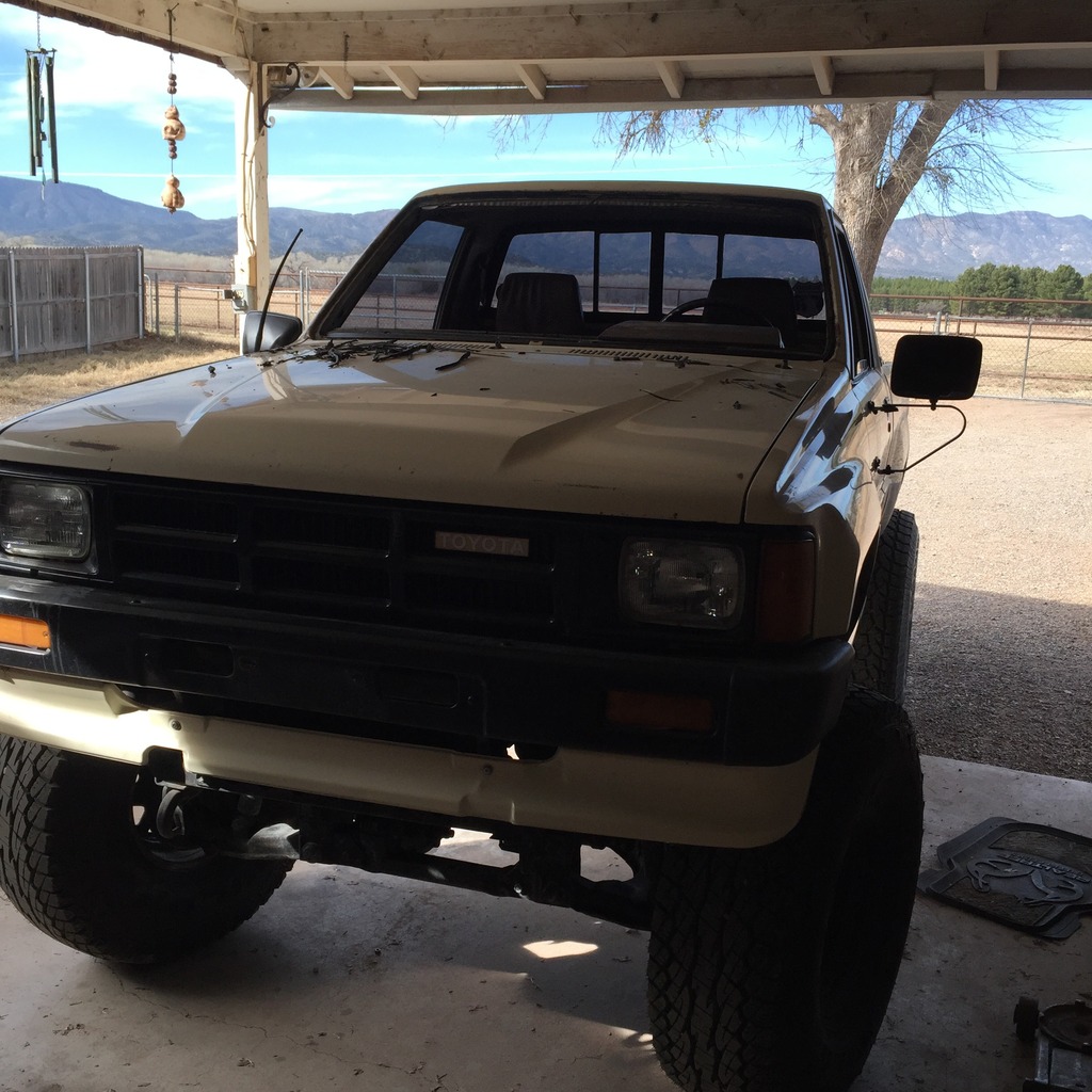

It's an 86, 4wd, 22r, 5 speed, IFS. When I bought it had three 35s and a 36 up front. Gearing didn't seem right for 35s, hesitated at higher speeds (55+) and of course living in AZ it had a cracked windshield. It had 3" lift blocks and cranked torsion bars. There is also a 2" body lift which in not crazy about. The clutch also was going out in it. Of course on my test drive I decided to stop at a light on a hill, some guys pulled right up to the back bumper and I had to drop the clutch pretty hard not to hit them, a little embarrassing.

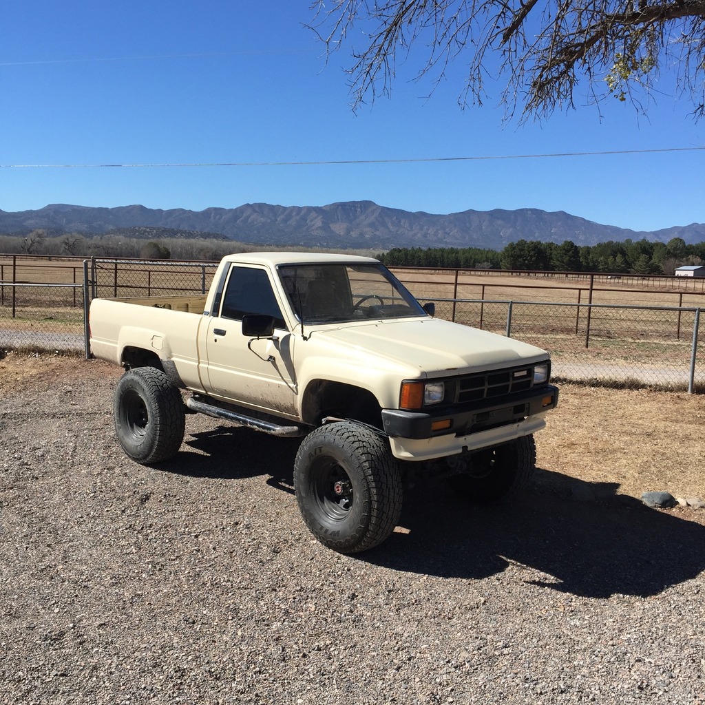

While Everything was apart I took out the 3" lift blocks in the rear so it's not crazy stink bug anymore. People may hate it but I do love the front end sitting up a tad higher than the rear. Personal preference I guess.

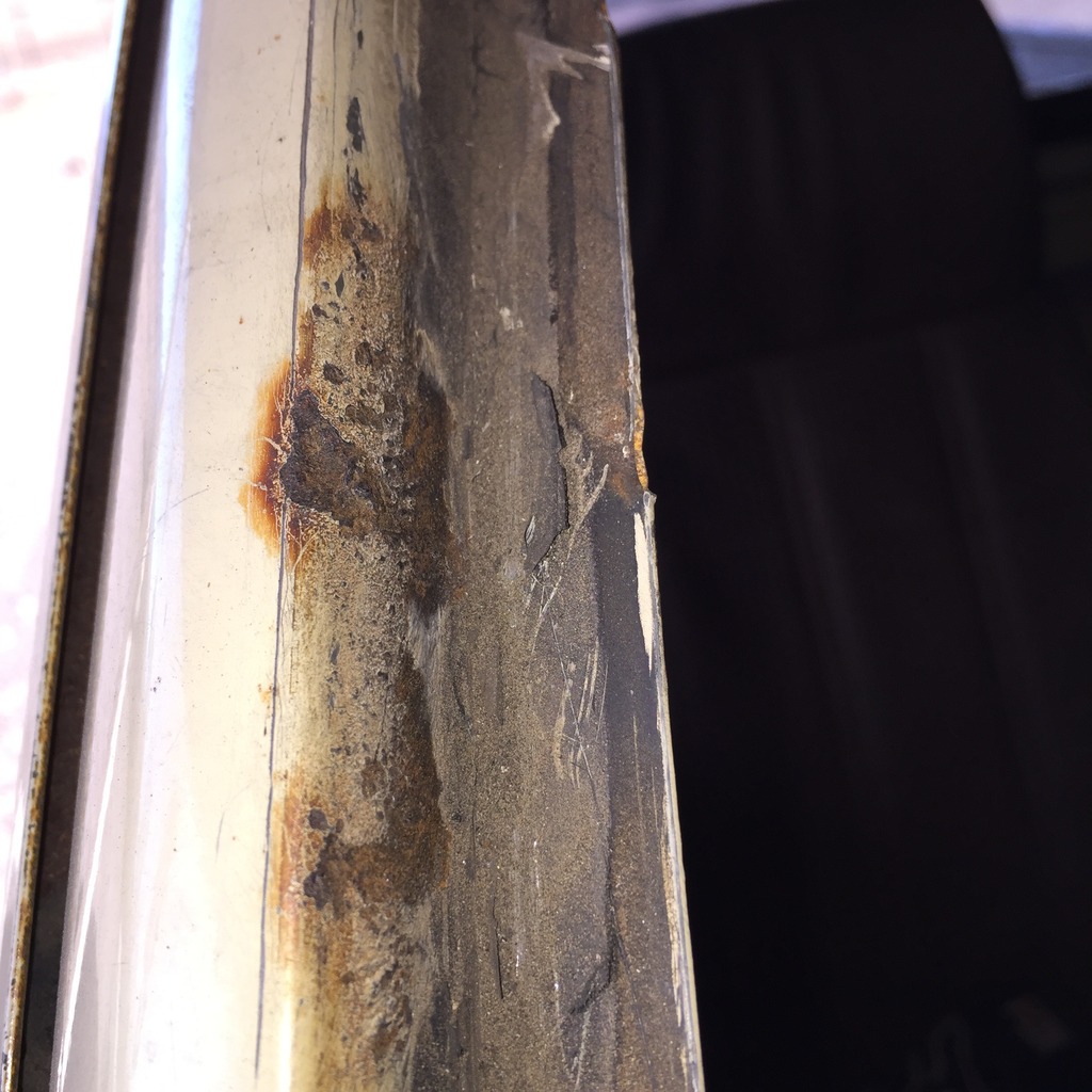

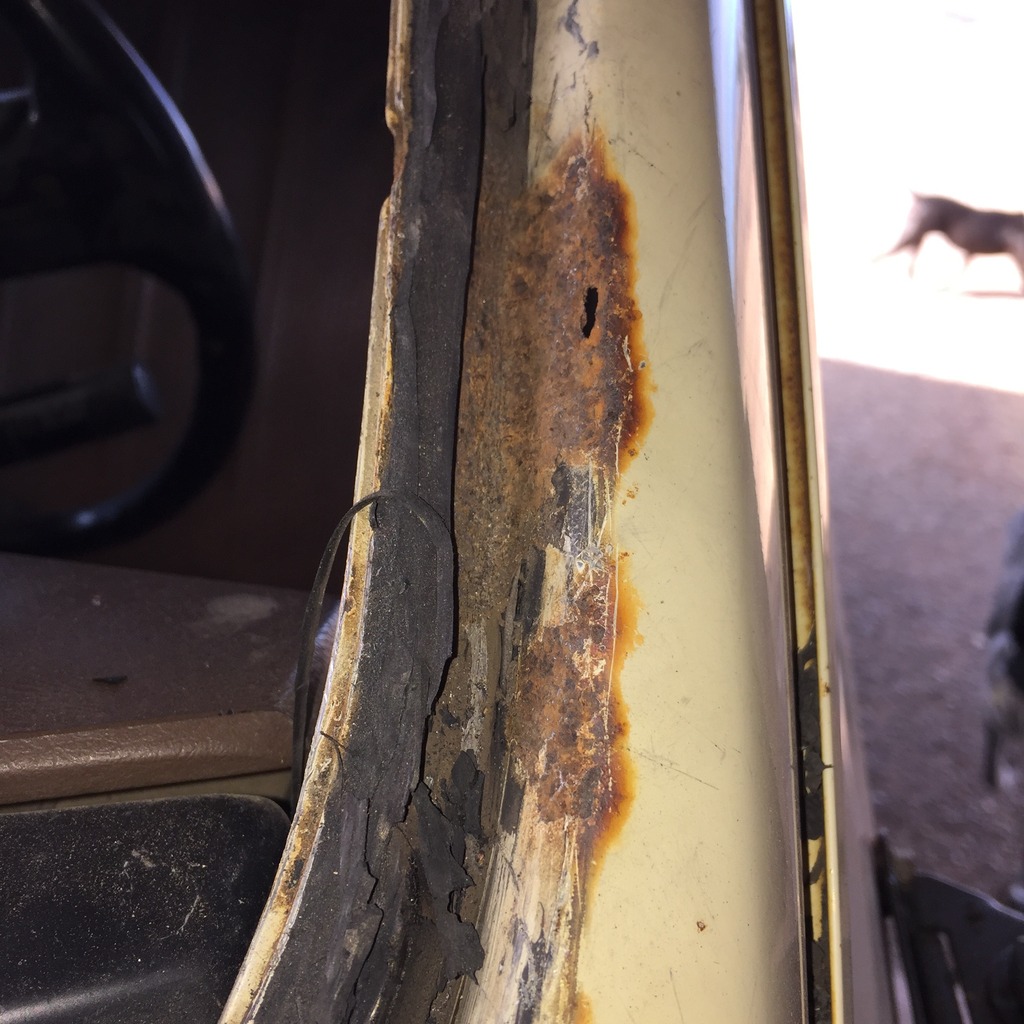

The rust spot he was worried about
You can see it a bit above the middle of the side of the windshield in the next pic as well

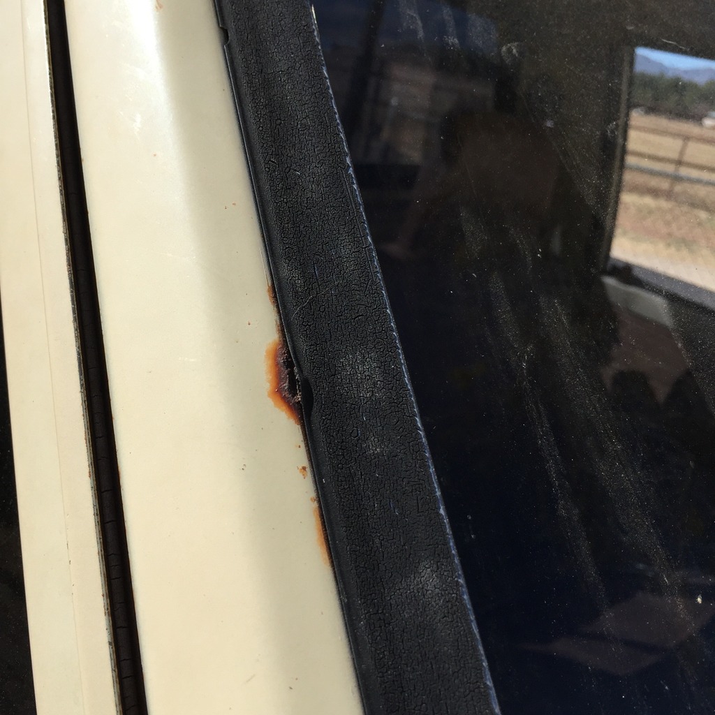

That spot ended up not being as bad as he made it seem.

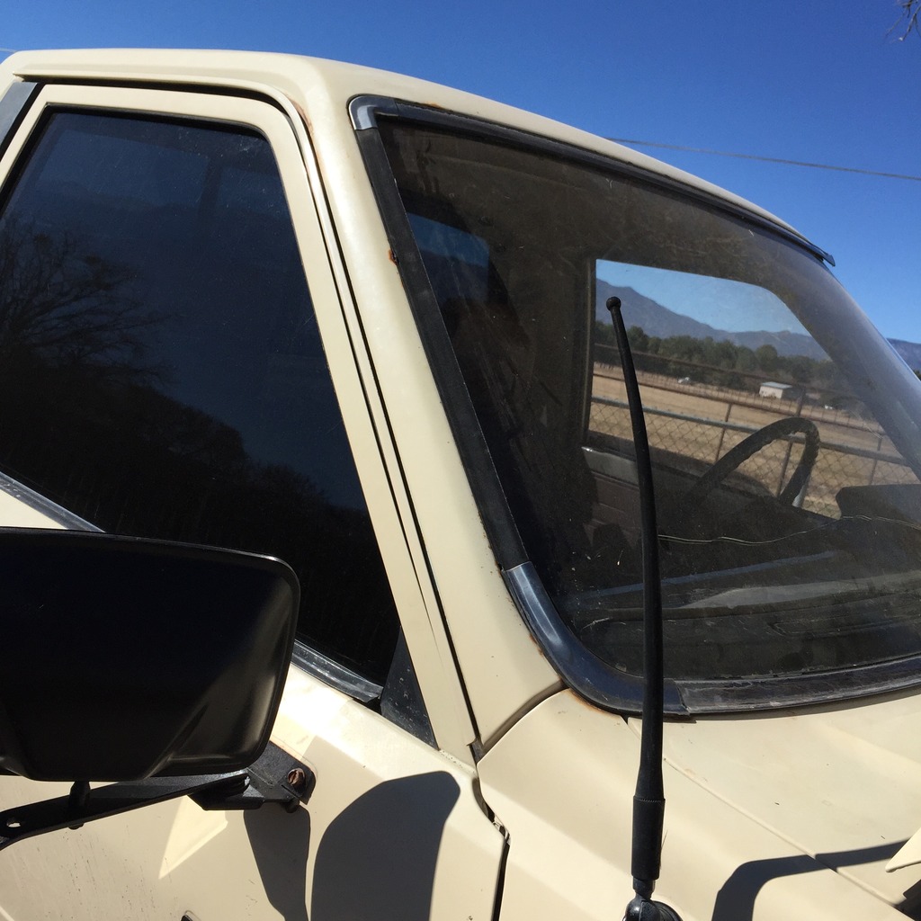

There's only one major spot that I'm going to have to weld a patch in but it's tiny.
The plan for the repair is I'm going to wire wheel it all down and Dillon where I need to, or weld what I need to. Then paint a strip around it. The strip will end up being a little wider than where my window trim is but it will be the same color as the trim so hopefully won't look to funny.

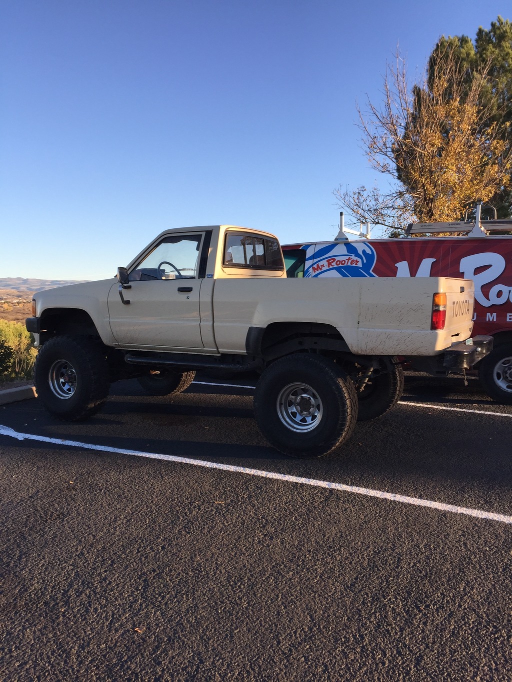

Where it's currently sitting. Had to steal the wife's parking space. Living in the high desert you never know when a random rain clouds going to show up..

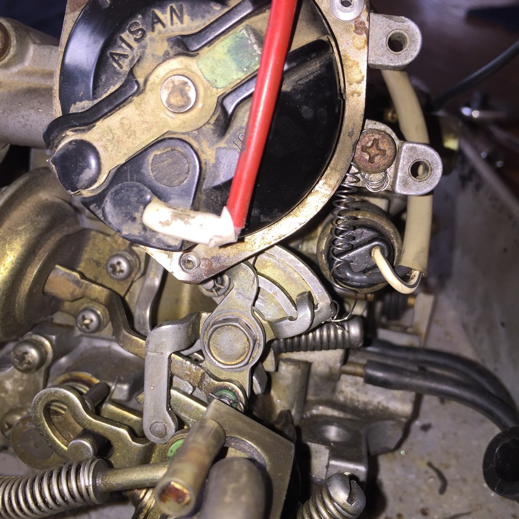

As for my issues with idling I ended up figuring out that the choke was not returning at all at first and was causing it to idle at 2500rpm. Played with that got it down to 1200rpm idle. Choke still wasn't fully returning figured out the spring for the return was shot. No one sold springs for it or even had one close. I am planning on upgrading to a weber when I can afford it so I had to ghetto rig it for now with a random spring. Today's plans to get this guy back on there as well as repair the a pillars.
