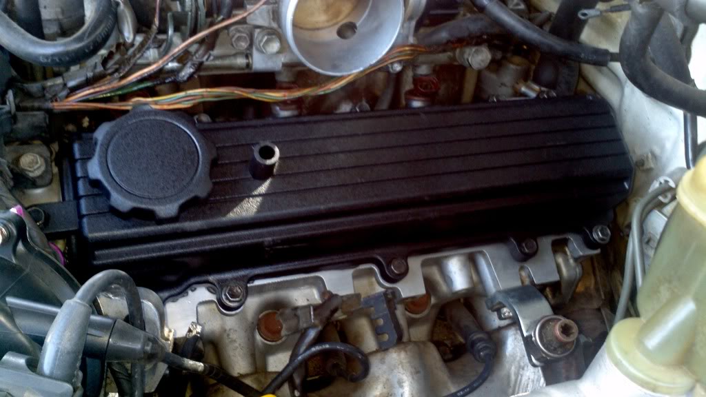

Bought my 94 about 3 weeks ago for only 900. Pretty good deal considering the body and drive train are in great condition. The downside is that everything else needs some attention.
To please the wifey i'm gonna tackle the oil leaks first. The entire underside of this thing is covered in oil. Figure I'll start from top to bottom and clean my way down. First step is the pesky valve covers.
For some reason the previous owner used two driver side valve covers. There was no hookup for the pcv valve! yikes... After a trip to the junkyard and I'll kill two birds with one stone.
Driver side cover removed. Head looks real clean, must have had some work done recently. If you look closely, one of the rear cover bolts had been snapped off. Not sure why they didn't fix it then when it happened. It was leaking at the usual rear corner. No rtv to be seen plus with the snapped bolt, no wonder it was leaking.

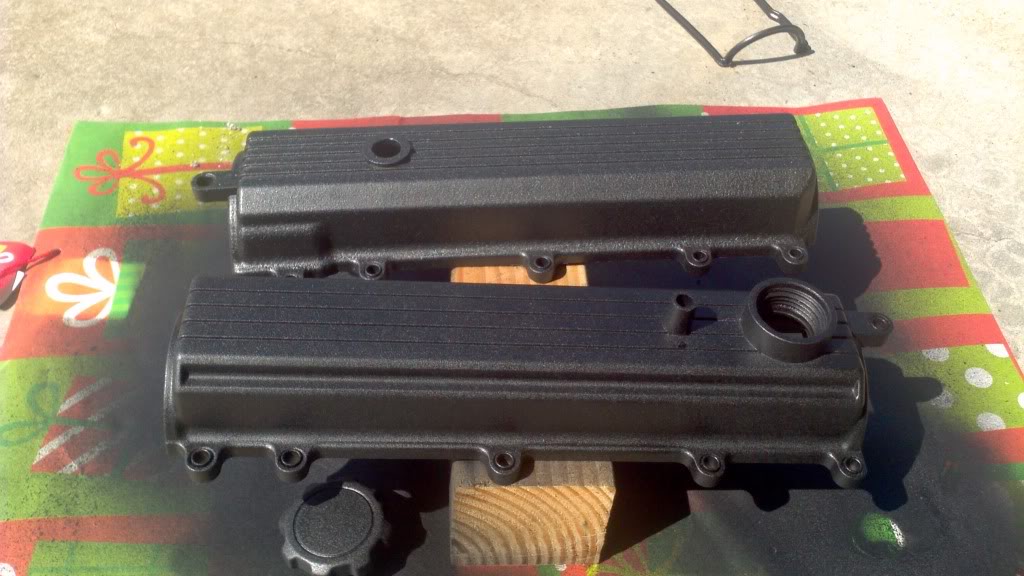

All cleaned up.
Decided to re paint the valve covers wrinkle black. Turned out nicely.

Driver side in and curing.

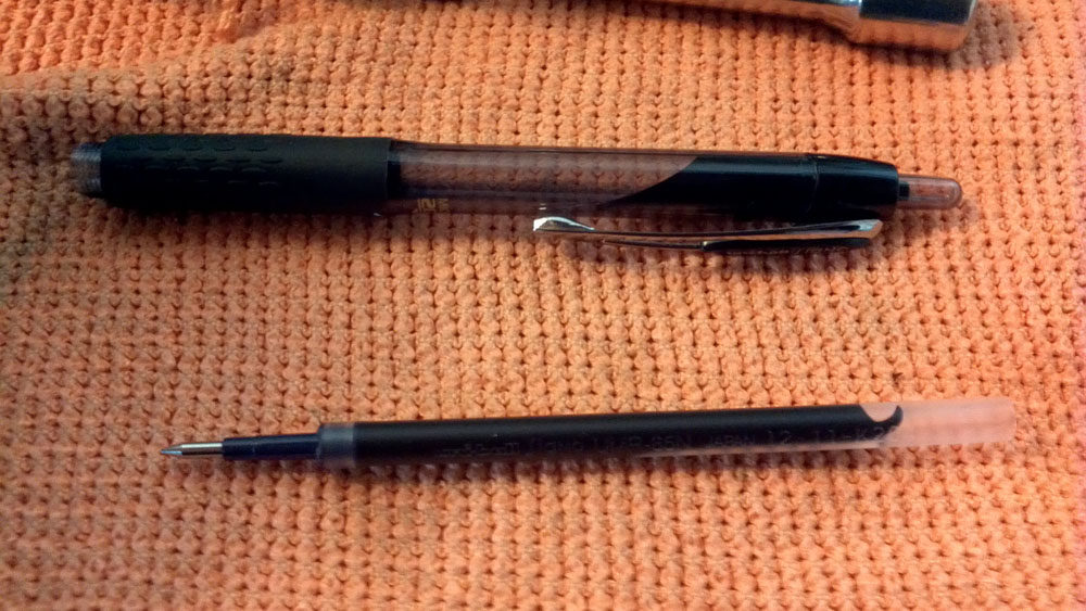

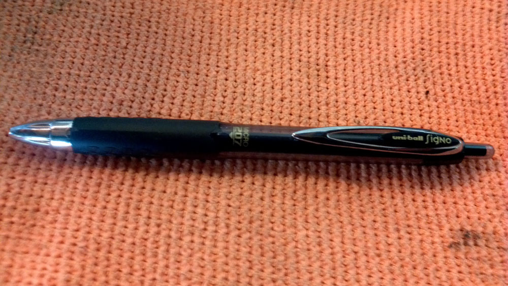

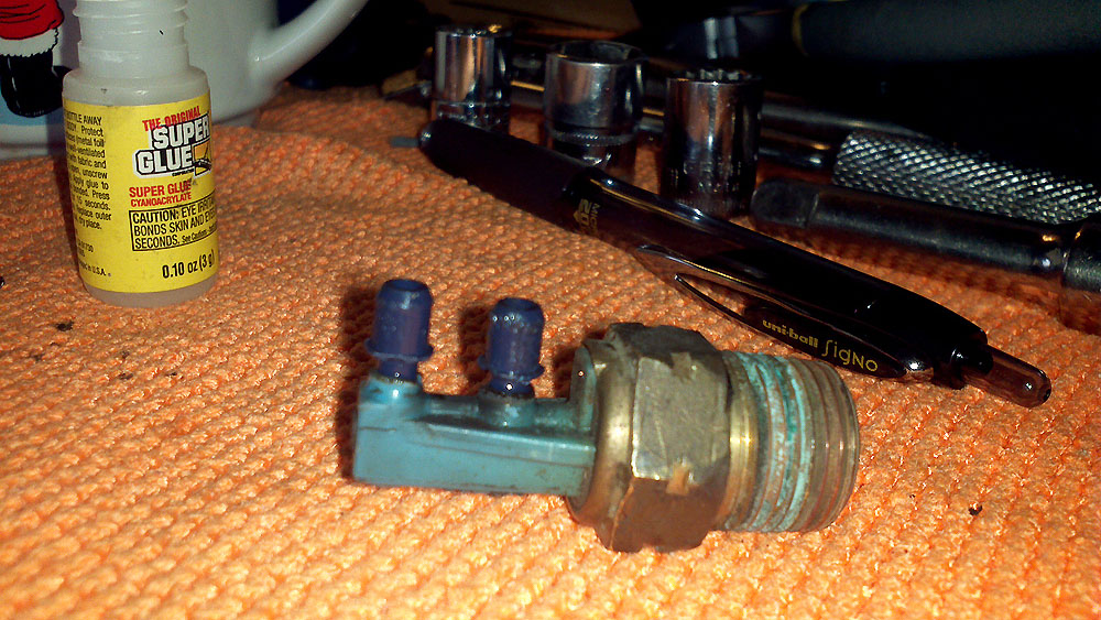

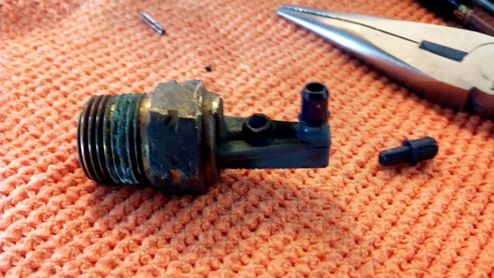

Well trying to replace the "U" shaped coolant hose I broke the plastic nipples on the tvv going to the vapor canister. The heat from the crossover pipe no doubt cooked these things a long time ago. About 50.00 from the dealer, I'm a little broke right now so I did a little quick fix.
I ransacked my wifes desk and found a couple pens that I thought could work.
Below is a pic of the pen I used. I'm sure a lot pens could work but this one seems to be a really good fit. Its a Uniball Signo.
Unscrew the tip and pull out the ink tube.
Use some needle nose pliers and pull the plastic end out and separate the metal tip.

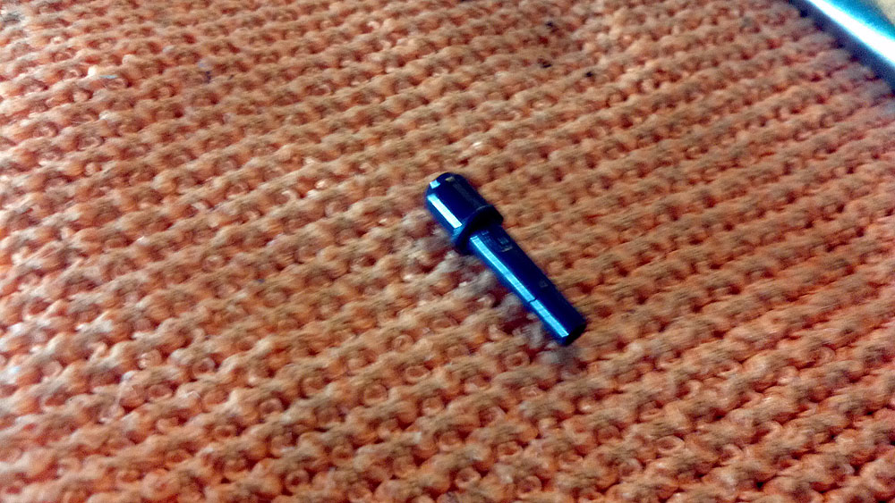

This is what we're gonna use. The end for the vacuum line is a good fit. Won't slip off.
If you look closely there is a slight step at the tapered end, (the part that is going into the sensor) I used some wire cutters and shortened it to that point.
Next, I used a 9/64 drill bit and opened up the "new" holes in the sensor where the original nipples broke. Now, mine broke off relatively flat, but you may want to sand it down a little.
Test to make sure the new nipple fits in there snug, not too tight that you break it trying to make it fit.
A little dap of super glue and pop them in. Let it dry and I just saved my self 50 bux.

Old Mar 25, 2013 | 03:26 PM
Co_94_PU's Avatar
iTrader: (-1)
Joined: Dec 2012
Posts: 5,433
Likes: 555
From: Colorado
Nice fix, thanks
I might recommend fishtank/aquarium line connectors. It'll be a little cheaper, and no one wonders where thier favorite pen went to.
random amazon link random amazon link
And for those of use with bad eyes. Tose are "Uni-ball SIGno 207 gel pen"

Yea I don't suggest going out and buying those pens just for this. I think they're like 3-4 bux each. But I had them lying around.

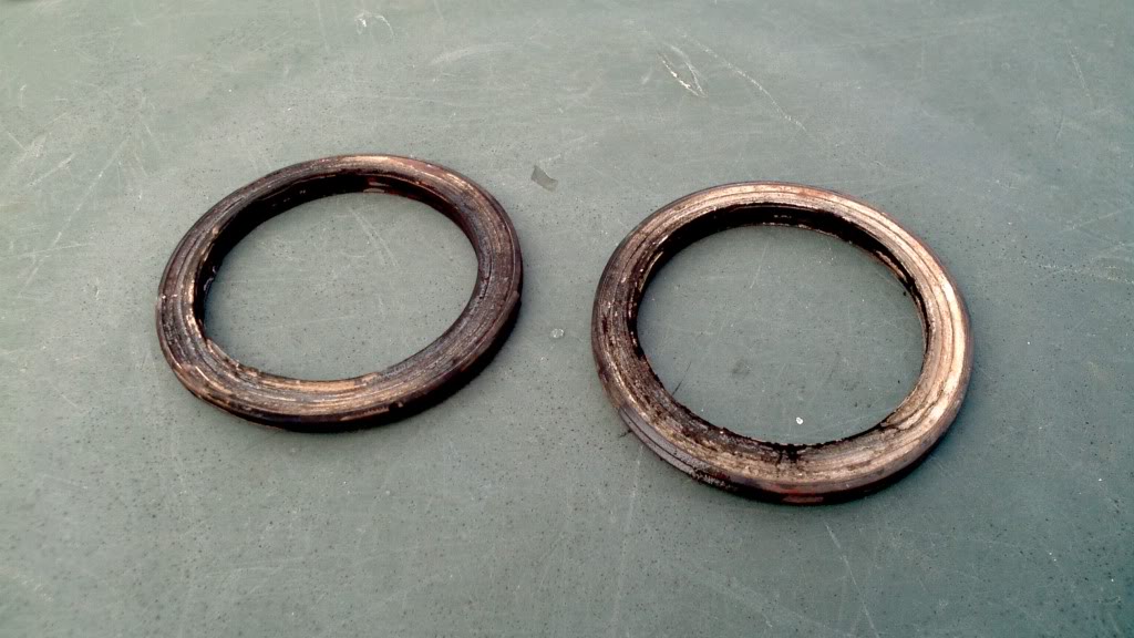

Got around to replacing the exhaust crossover gaskets. I had an exhaust tick that hopefully clears up after putting in some new ones. The old ones were pretty shot, they're worse than they look in the picture. Out of round and the gasket material was missing in parts between the metal rings.

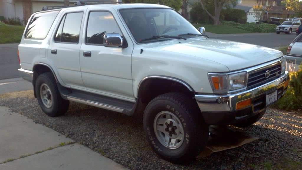

Heres a pic of my Runner. Waiting for my rear camshaft plugs to come in so I can get that leak taken care of.

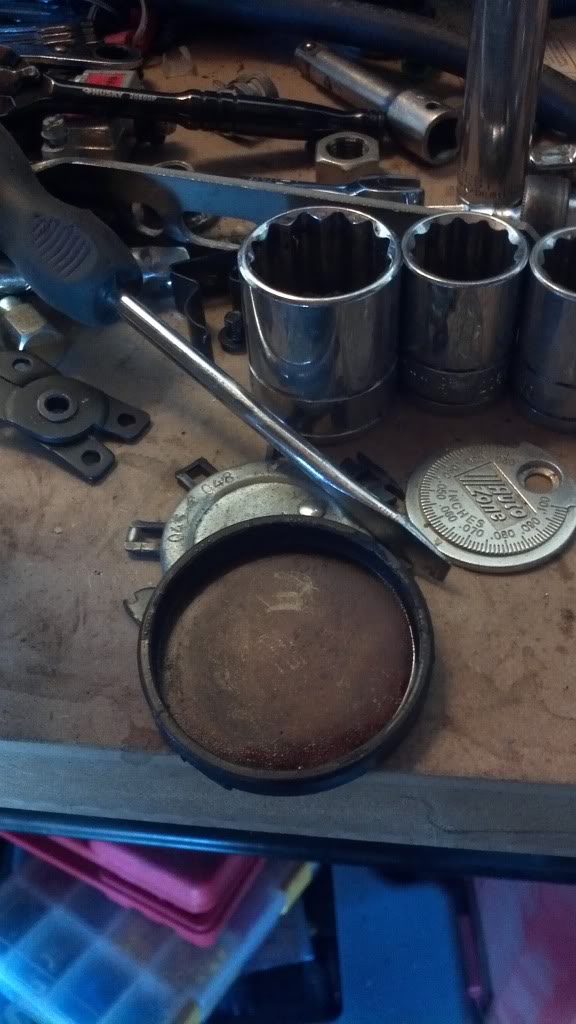

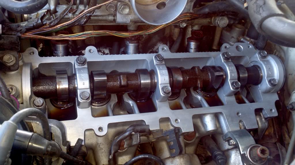

Well got my rear camshaft circular plugs. Kinda wish I did this when I changed the valve covers. I got the plate that holds them in off, but not sure how to get the plug out. Off to find a small suction cup and see if that works.

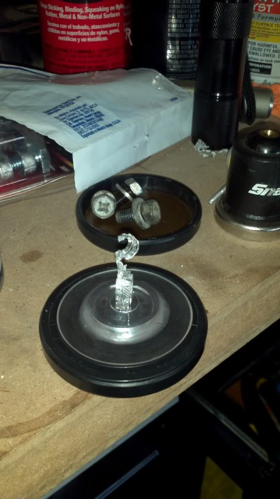

Found a suction cup that looks like it might be strong enough to pull the plug out last night.
Old Apr 11, 2013 | 07:52 AM
bpealer's Avatar
Joined: Feb 2013
Posts: 123
From: Sacramento, CA

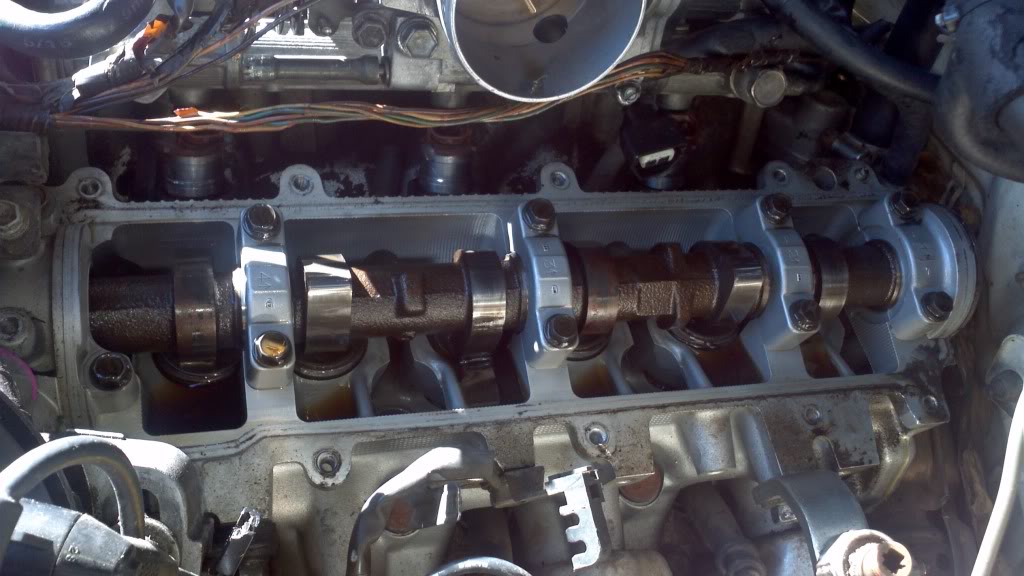

Went back at it this morning. The suction cup worked well. It was a little tedious but it did pop out. The trick was to pull with little force and hold it work as long as I could. Pulling too hard just made the cup pop off. Time to seal her up and on to the passenger side.

Here's the little devil.

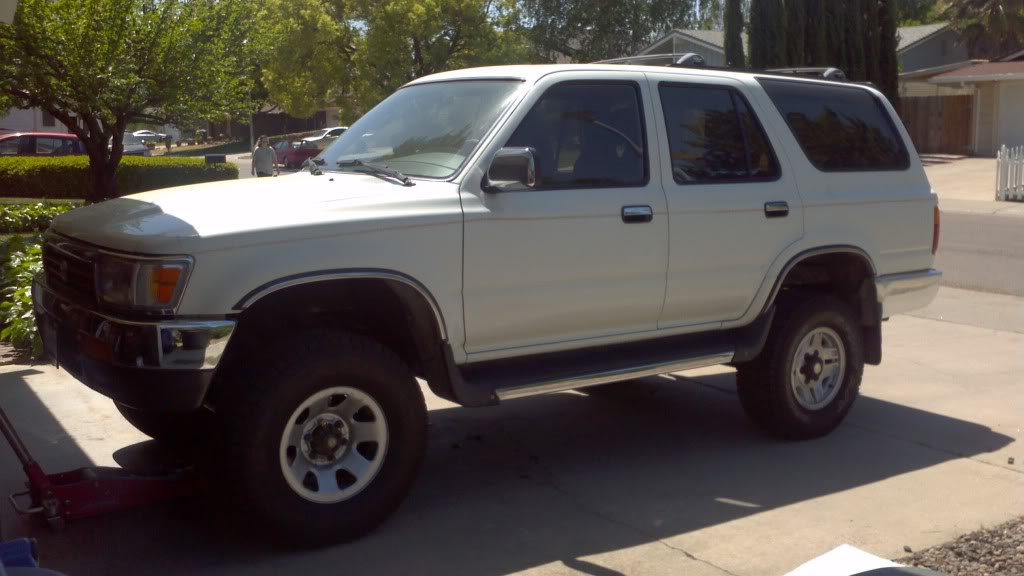

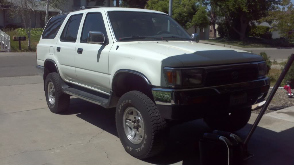

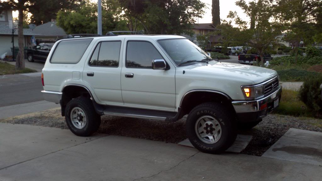

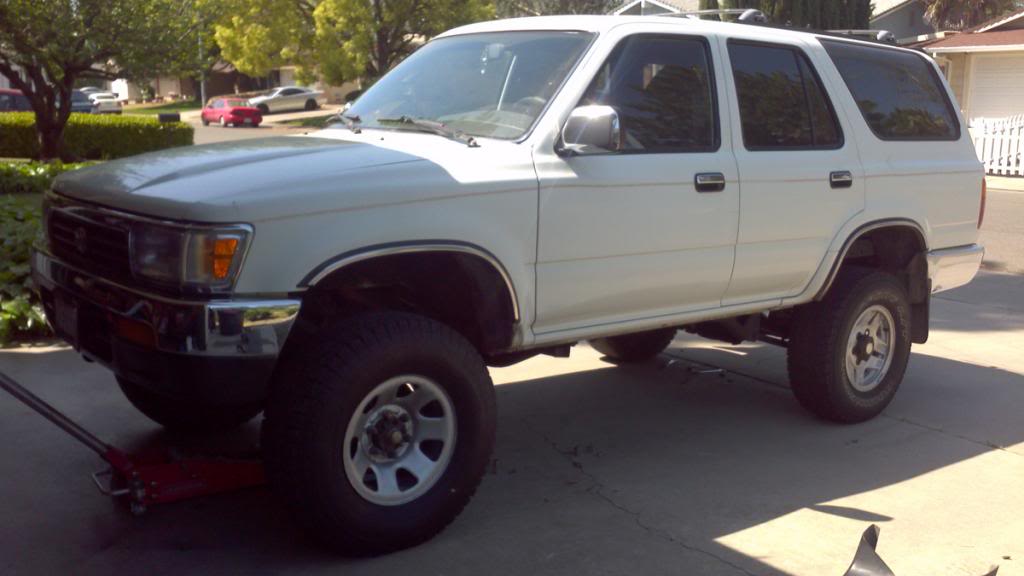

Came across a guy that was parting out a few Land Cruisers. I ended up trading him some old air tools that I don't use anymore for the rear springs. I grabbed two shorter rear springs. Don't have the longer shocks or panhard drop bracket yet, but I was dying to see what it looks like without the ass drag.
Measured before and after and the lc coils gave me a 3.5 in lift. Went from ass down to ass up. So just to even her out I adjusted the torsion bars about an inch. Just enough to level it out but didn't hurt the ride quality. I will be ordering some bj spacers though soon so I can turn them back down.
Rear lift first.
Front end adjustment. I think it looks a lot better. My balding tires seem even smaller now.

looks nice. might i ask what you mean by front end adjustment? torsion bars? i highly advise against that. get some BJ spacers in there and relax them back down. its a much smoother ride.
Old Apr 23, 2013 | 04:08 PM
bpealer's Avatar
Joined: Feb 2013
Posts: 123
Yea I cranked the t-bars....im ordering the bj spacers at the end of the of the week along with the panhard drop bracket

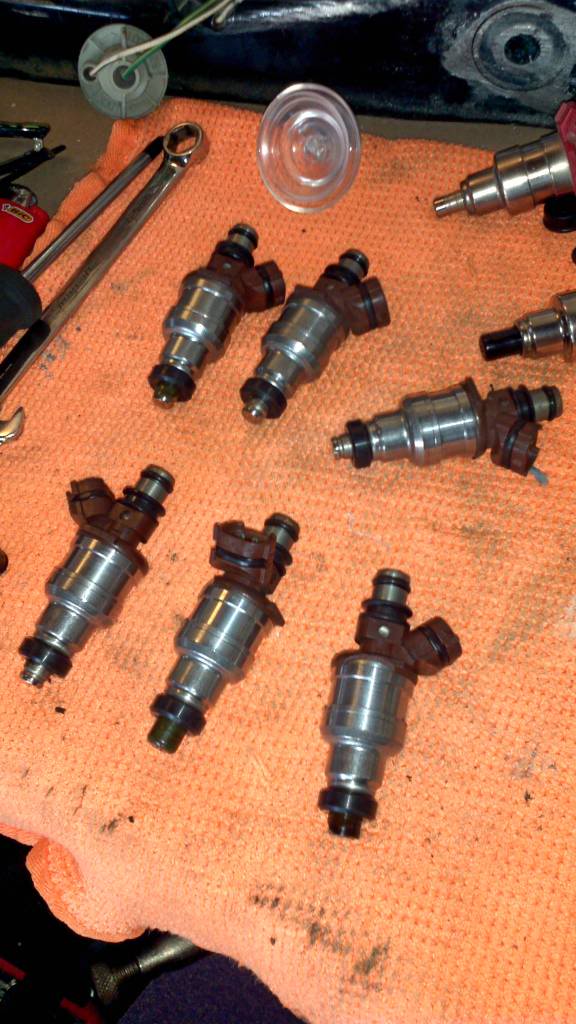

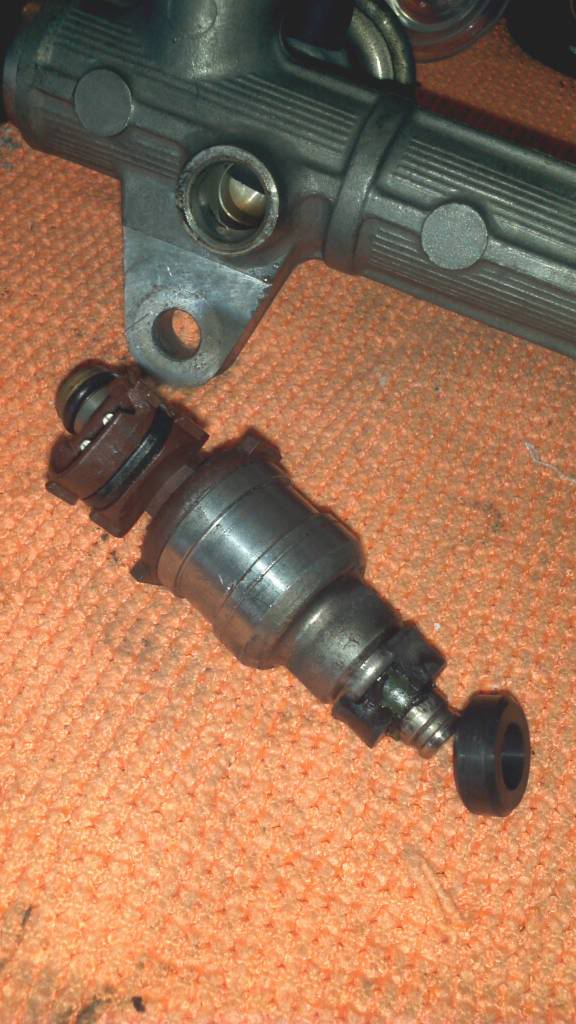

Picked up some fuel injector seal kits at Napa. If I was able to have my truck down for more time I'd send them out to be clean and balanced. For now I'm just gonna throw in some new seals and mine were in bad shape.
The bottom seal that goes into the manifold was missing chunks on 3 of the injectors.
I'm surprised this wasn't enough of a leak to throw a code.
All ready to go. If anybody needs the part number, it's ATM IK2401 from Napa Auto. 1.99 for just the 3 seals x6 injectors. In the future I'll have them fully serviced.
