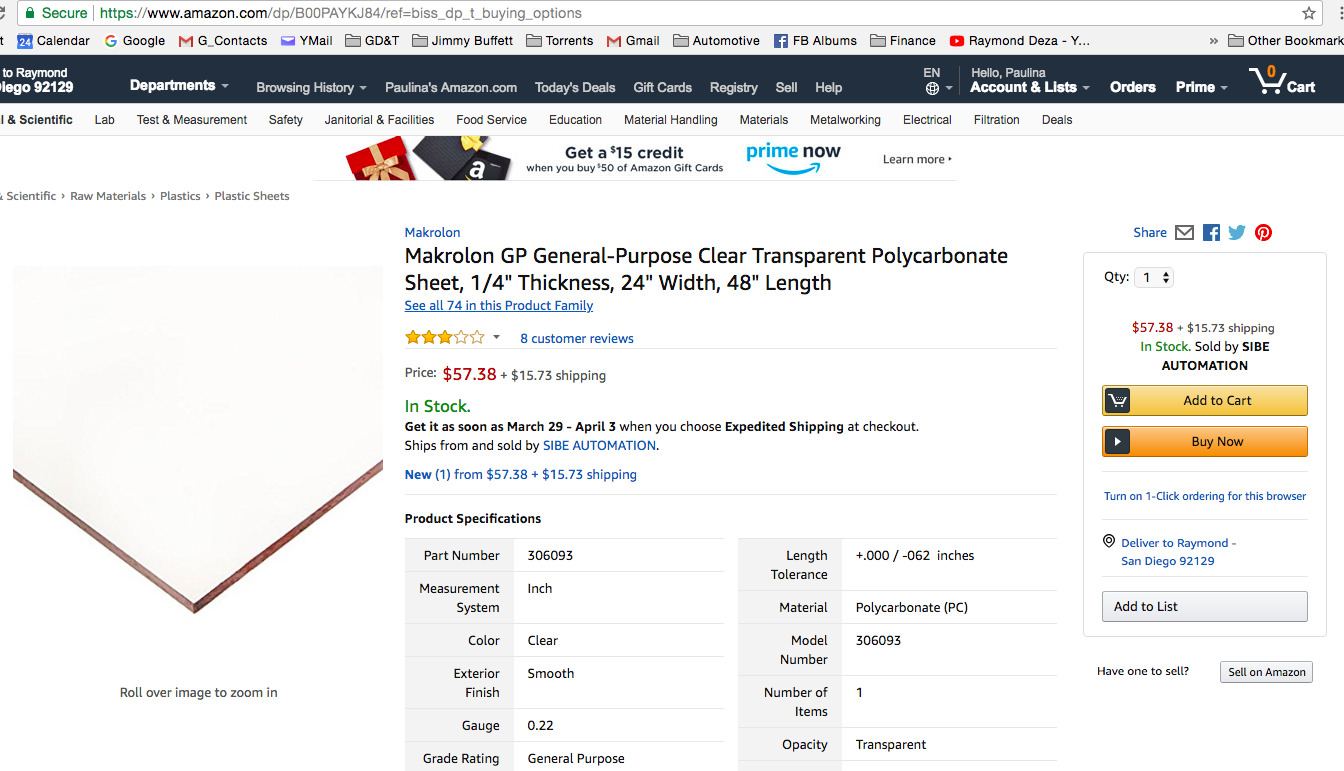

Originally Posted by dropzone
Ray granted my trekker was beat, but the rear hatch leaked like crazy..I know my 81 Trekker wasn't the only one.
I am really wanting to see this work.. the roll down rear glass is one of the things I hate about my 94
For your rear 'glass' material look at Makrolan. it is comparable to Lexan and they use it to make headlights.
Not as prone to UV as polycarbonate
Thanks Robb,
Makrolon seems to be a type of Poly carb. Reasonably priced, too.
