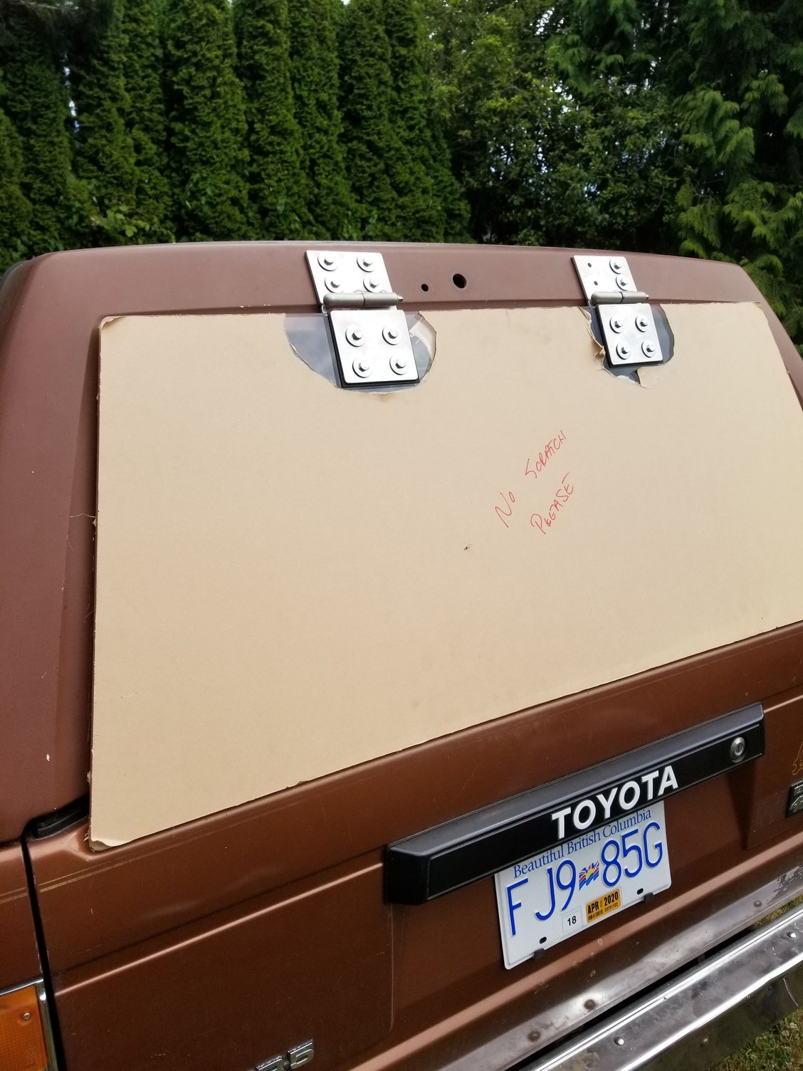

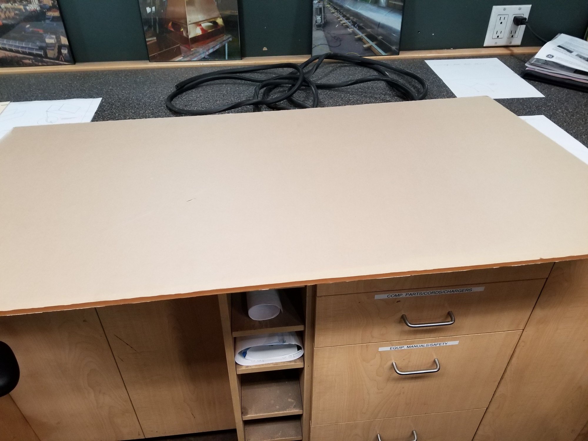

I will be ordering a piece of plexiglass today, these dimensions should put me about 1/2" inside the factory bevel around the removable tops window frame.
I'm thinking about using bullet hinges oriented the same way, so I can open the window and slide it out of the hinges for full and easy removal. The latch I haven't decided on yet.

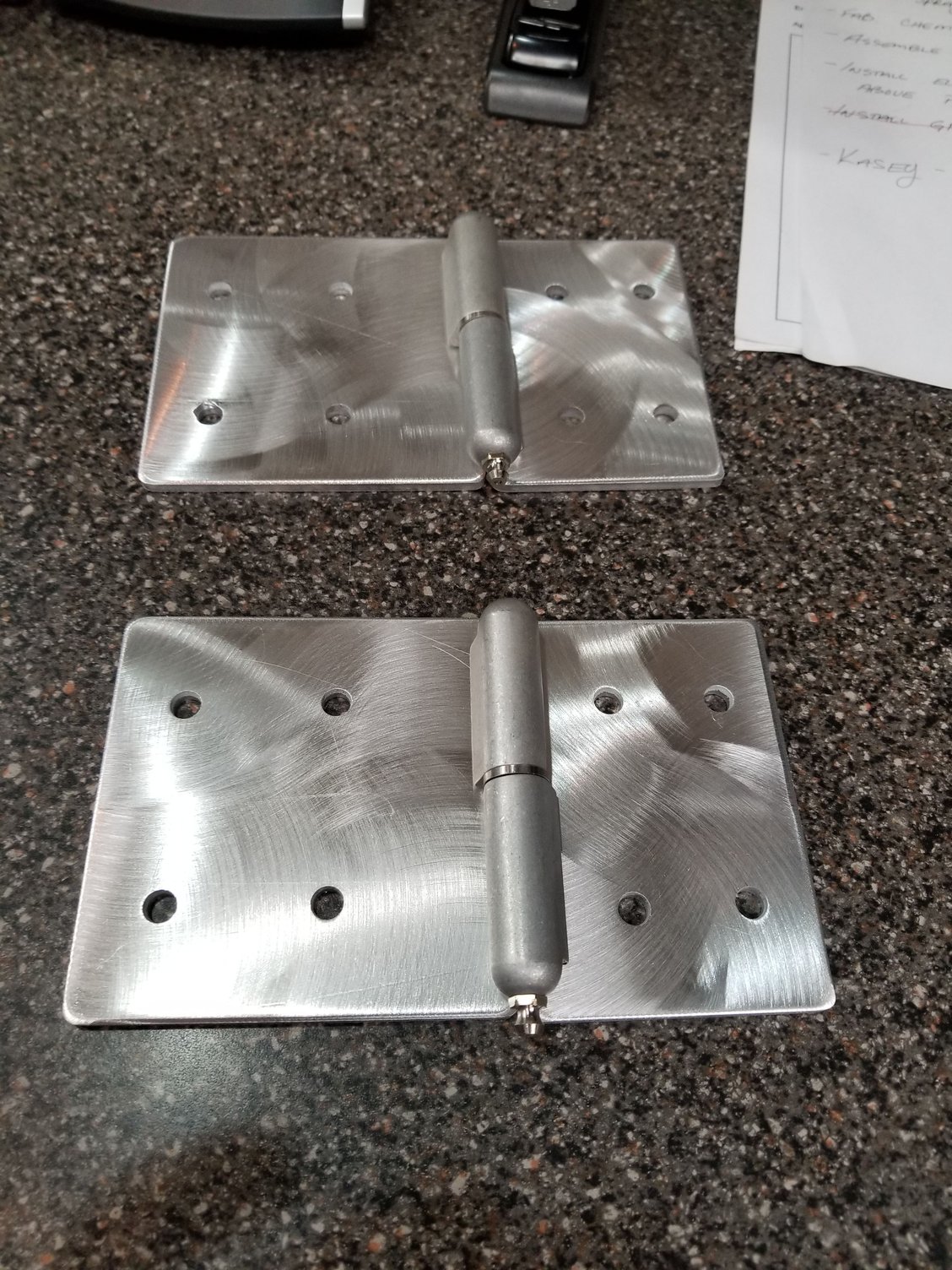

Plexiglass is in. In hindsight 3/8" may be a little thick, should still work though.
Hinge plates I've fabbed up.

Cool, looking forward to your progress. Nice hinges by the way.

Hinge fit up

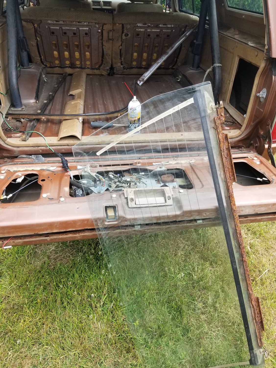

Old Jul 6, 2019 | 02:51 PM
  #59
5 Fists's Avatar
Posts: 531
Likes: 168
From: British Columbia

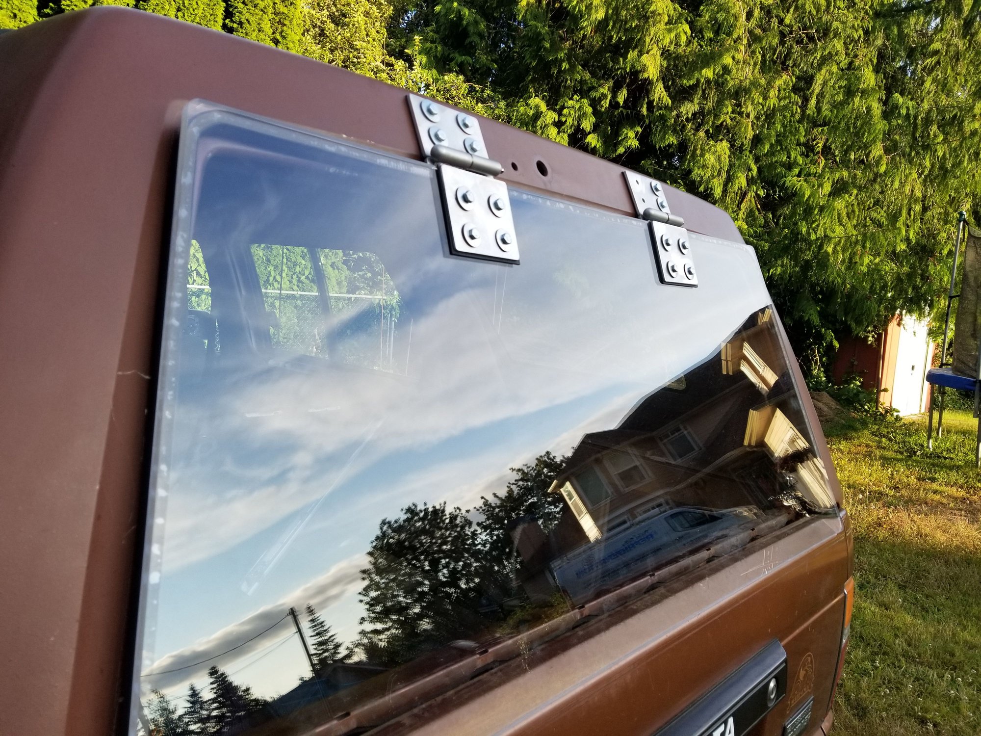

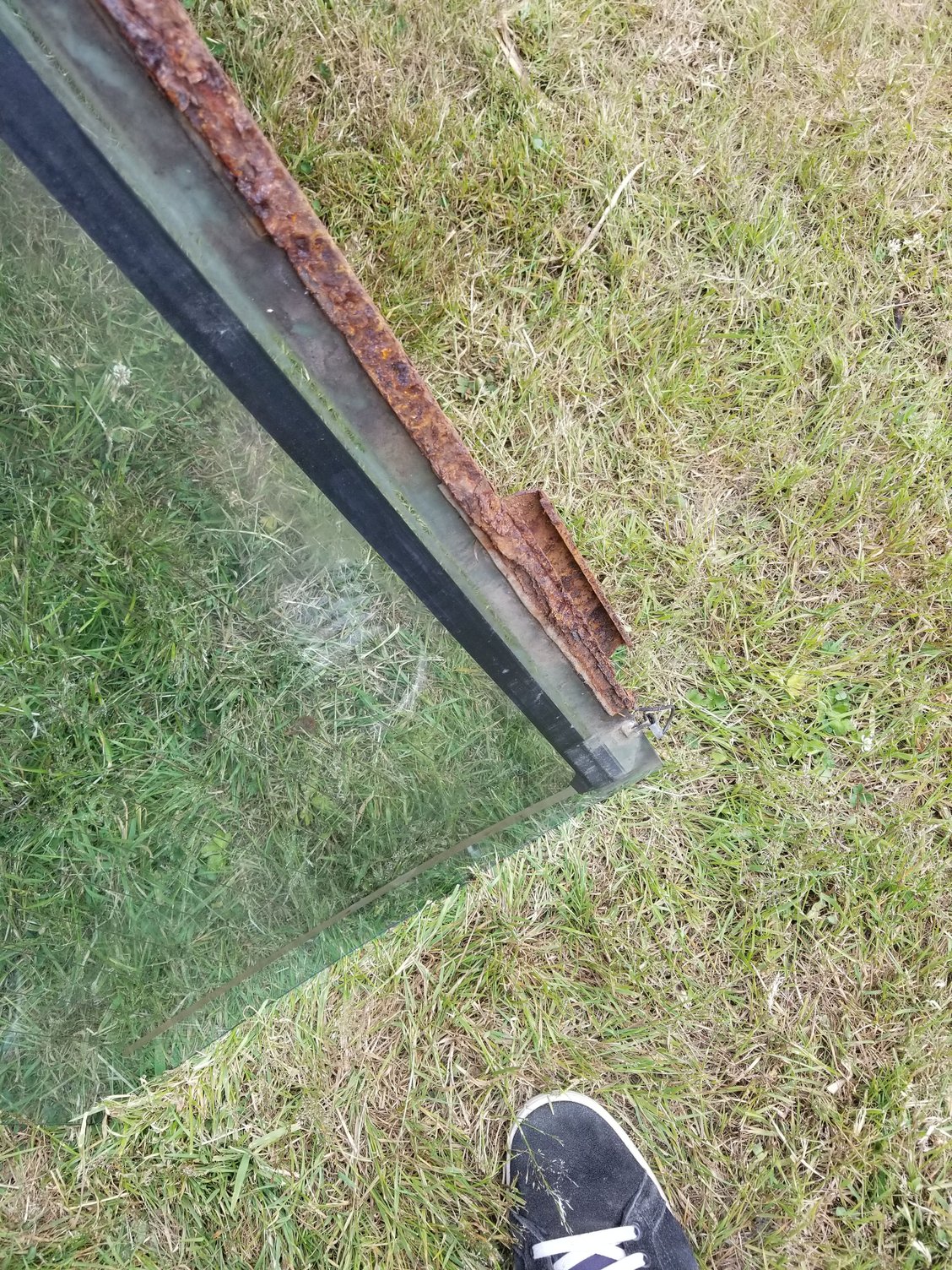

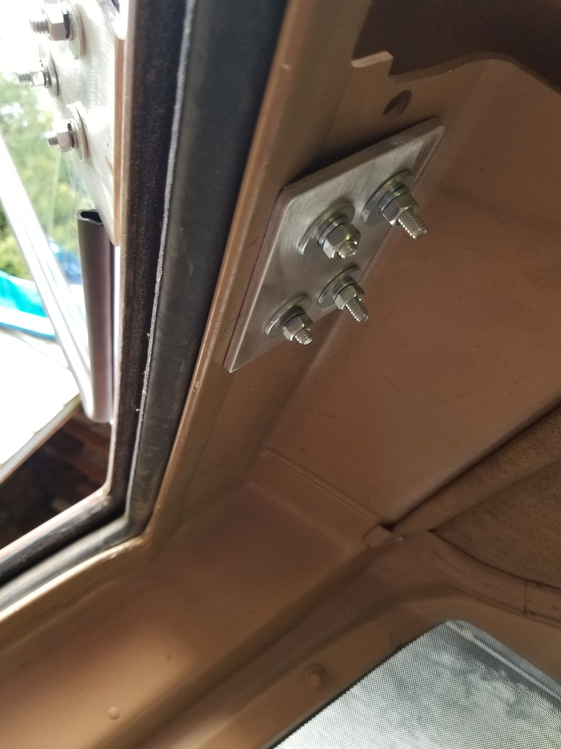

Finally had a chance to get back to this.
Window out
Rusted tracks I'll never have to deal with again
Mounted
Pretty happy with the gap I ended up with. I've got some 5/8" thick 'D' shape weather stripping that should work just fine. May need to beef up a couple areas to get proper compression of gasket for no leaks.
I'll throw some pics up later, had to leave two bolts out on the passenger side because I need to make a plate to cover the hole that the wiper motor came out of.
Gasket on, definitely need to compress it more with whatever latch I decide on. Also, gaps around my hinges for sure, will need to figure out a better water proofing for that area before the rainy season. Perhaps a metal rain shroud covering the whole top lip? Need to think on it more.
I will need to make some slight alterations to the inside plates before painting, I'll just put a bend in the right spot so it sits in that angle.
