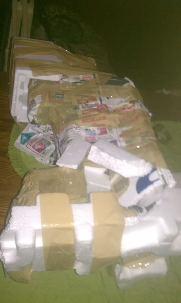

Holy Packing Material!

Whoop Whoop thanks Mark(Chefyota) aka the packing man haha!

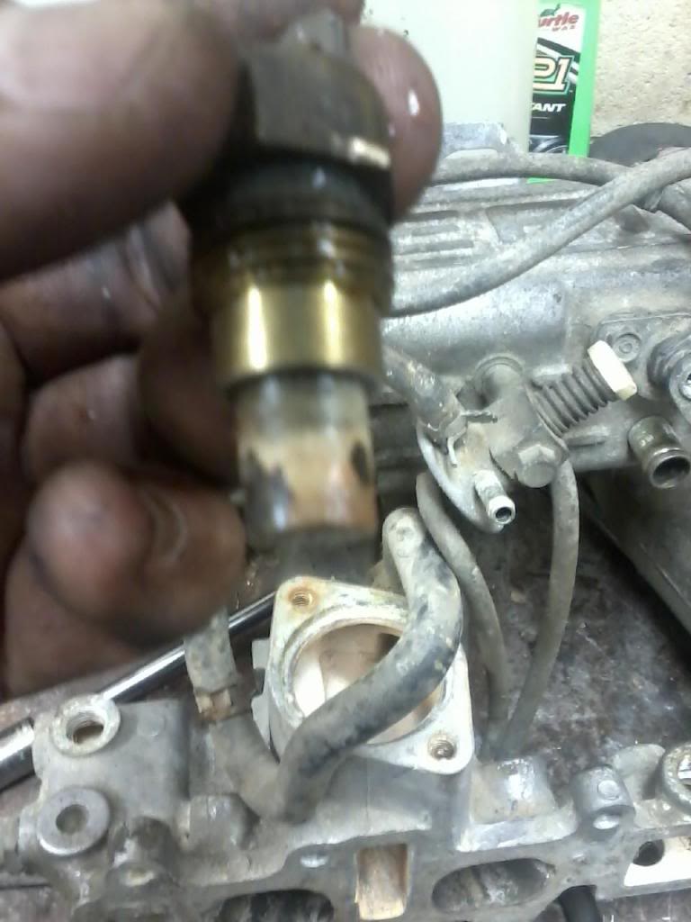

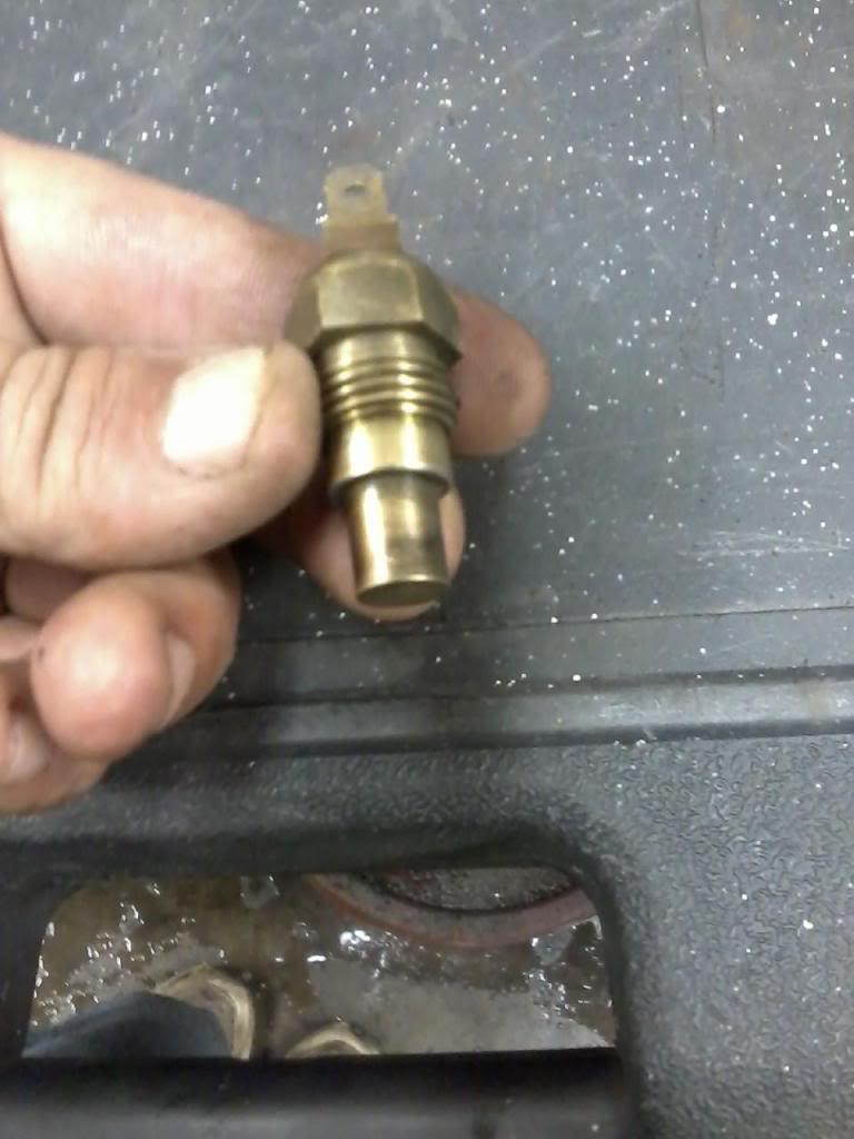

Here is how I fixed my temp guage. It is a good idea to clean your Cold Start Timing Switch and Thermo Temp Switch just below your Thermostat. Dont forget to use pipe tape on the Timing Switch, but I use tape on all 3 of my sensors.
Here is a picture of a dirty Temperture Sensor. I have seen worse. I chipped some of the scale build up off so you could see a difference.
The sensor sits just below the Cold Start Injector in the Intake manifold. Uses a 17mm deepwell socket and is a 5 minute job.

I think it's packing-ocd-man! Haha. ... But honestly, can you imagine if that thing was just bouncing around and some USPS truck or playing? Eek! Yeah, it would be in pieces! Hahaha. I spent quite a long time wrapping that, and I'm laughing right now just thinking about it. But, in the end, it got there safely, right? wooot! He he.

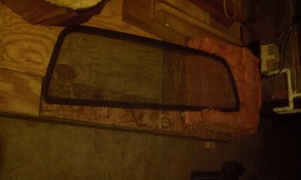

Woo Craigslist guy is gonna ship that back glass....roughly 50$...could be worse haha and i get the experience of installing always love the experience.

Also went to go pick this up this afternoon, the first guy didn't work out something bout wanting 100$+ for shipping, i just passed til this one came my way, real old guy, but he was nice and got him down to 50$ so it all worked out
Hopefully be installing this puppy tomorrow, gonna watch some videos and read bout it.
