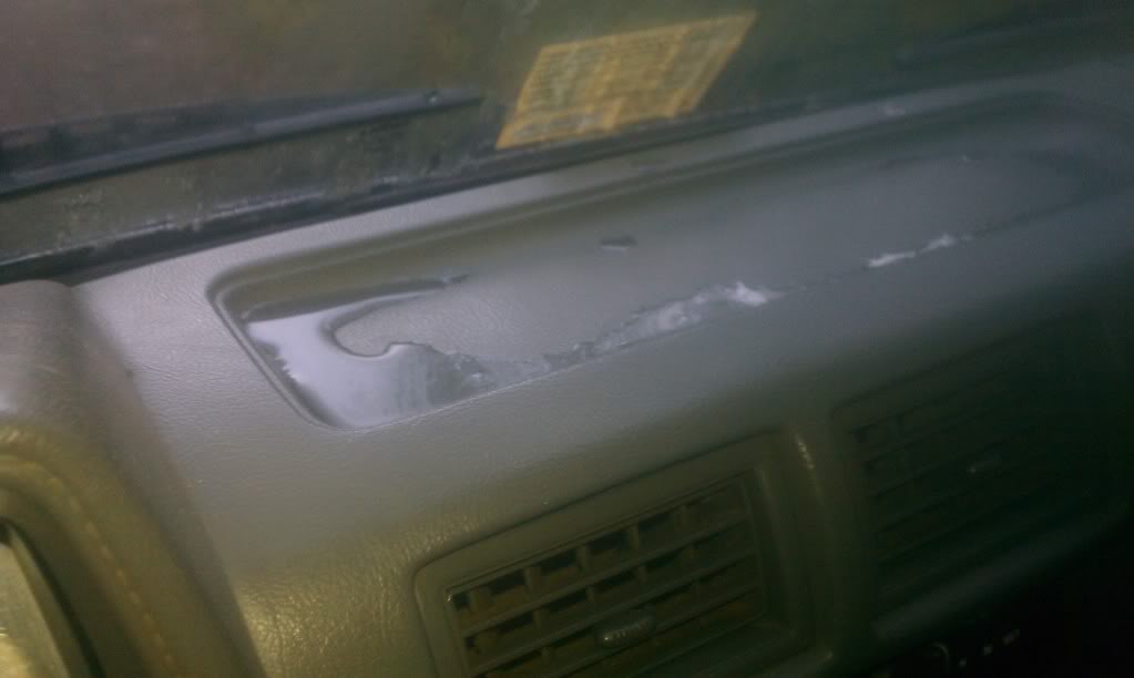

Old cab.....who knew the dashpad held water for times of emergency lol and i could've had the windshield re-put in, but it had been in so long that my floor boards were done.

well when it warms up use a hose an see if ya can find the leak a good choice is aquarium silicone it sticks to anything an makes a flexible seal so heating an cooling wont break it lose likely its tween the gasket an body not the gasket an glass find the leak an lift the seal squeeze the silicone in an press it into the joint wipe off the excess before it sets up
or find a windshield place an have them reseal it they will use a tar like sealant heated to 120+ an inject it along the edges

and i don't need to seal it anymore, that was what happened in the old cab which eventually led to floorboard rot.

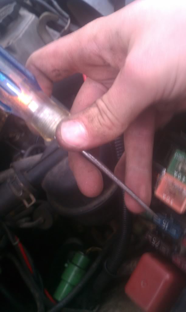

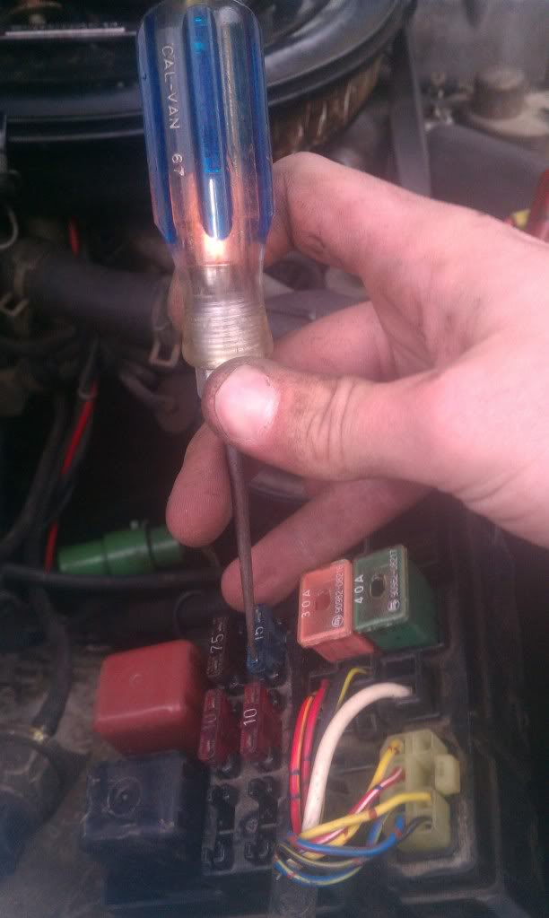

Tried tinkering with the horn today.... Still no workie, but did learn some stuff.
First off I have 3 horns, all 3 of these work on a toyota truck, tried today, just not mine.
Next can someone verify in these pics that this is what should light up my test light.
Ok so here I am with my test light....know i had it on a good ground, tapped positive on my battery to see if it would light up(dad taught me that)
Check the 15amp fuse that powers my horn and my hazards
It has power on both sides of the fuse just like it should

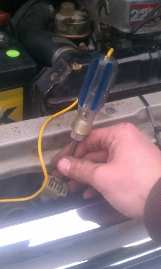

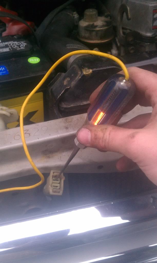

Now I'm at the horn harness, two wires....
Green one with red(Runs into cab to the horn plunger thing)
Blue one with yellow(Not sure where he goes, quite yet)
Here I am touching the green/red wire, doesn't light up my test light
Here I am touching the blue wire, it does light up.
Now just a thought....but does the plunger have to be depressed for the green/red wire to have current?
Also, I haven't really messed with any of my grounds, I haven't messed with them because, if something was grounding it out....Wouldn't other things not work besides my horn?
Thanks guys, I just want to hear my horn...on my truck!

The ground wire, you mean the white-black pin#1 pretty sure it goes to the drivers side kick panel. It's used by everything in the column so if any of its working it's probably ok.
Test under the dash, pin5 green-red (no horn relay involved). Should get the horn to sound if you probe that one to ground(A little weak running thru the lamp maybe). That just leaves the plunger and slip ring or a disconnect in the steering column wire to those..
On a horn related note. I had some twit cut me off making a left as he was heading into the bar the other night and really wished I had one of those ferry horns from the youtube videos !@#$. Woulda nailed him if I wasn't driving my mom back from an appointment.
Old Mar 16, 2013 | 06:29 PM
  #197
Cyberhorn The Dragon's Avatar
Joined: Jul 2012
Posts: 2,365
From: Idaho
ok yes you should have power to ONE side of that connector NOT both
now connect your test light to POSITIVE + on your battery an put it to the one that had no power an push your horn button
if it dont light an it should! every time you push the horn! somethings up in the steering column i JUST did this on my runner an my horn works
so for logic's sake (+) ---- fuse --- horn ---- slide contact in steering wheel ---- plunger when pushed makes circuit complete to --- (-)
ok following so far? so feeding + via the test light will light up if the horn button is pressed as that button is making the connection

I did CO 94s test(touching pin) and my horn didn't make a peep
Did Cyberhorns test, that neither wire lite up:/
Any ideas whats up guys?

Sounds like the disconnect is between the bottom of the steering wheel and the horn. You can confirm this by doing his test at my location. Probe clip to power, probe to #5, light should be on when you press the horn. There is power on pin #4(Blue) or the brake pedal switch Green-Red, or somewhere else of your choosing.

either your plunger is bad the sliding point which allows the steering wheel to turn an still make electrical contact or the connector CO is saying
