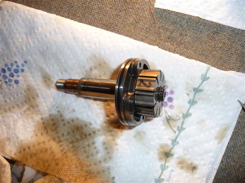

7. Tap some more on the shaft and it will come out. Be very careful that the cam ring and vane plates don't fall out and get damaged--they are not attached and will come right off the rotor. Slide the cam ring off the rotor and remove the 10 vane plates. The vane plates have a rounded side and a squared side. It won't matter where they go back into the rotor but do make sure that the rounded side of the vane plates are facing outward and the squared side on the inside. The front plate has two o-rings, one on the outside and one on the inside. When you remove the small snap ring retaining the rotor and front plate to the shaft, you can see and remove the smaller, inner o-ring. There are two types of large o-rings and the rebuild kit has instructions on where they go. Don't mix them up. When you reinstall the rotor make sure the mark is visible.
8. I used a pliers to lever out the old seal and a large socket to tap a new one (came in the kit) back into place. Lightly coat the inside of the seal housing and the outside of the seal with multipurpose grease to help the seal go in easier, and coat the inside of the sealing surface to prevent damage at initial start up. Replace all the o-rings, clean the parts with new ATF and a lint-free cloth, and reassemble. Make sure the parts and the new o-rings are coated with clean ATF during assembly. The long pin goes into the main housing and I didn't actually remove it at all. If you do, make sure you replace it in the correct place. See picture 6 and it's in the 1 o'clock position. The short pin goes into the front plate in the 7 o'clock position of picture 6; and doesn't go all the way through the front plate. Install each part as shown in the FSM, making sure it is seated all the way in. If the large retaining ring at the rear of the pump doesn't fit into it's groove, the shaft isn't all the way into the pump. Push on the rear plate with your fingers or lightly tap with a plastic hammer to fully seat the shaft.
9. Reinstall the pump with the two bolts finger tight. Attach the two fluid hoses and two air hoses. I cut about a half inch off the return hose and about a quarter inch off the air hoses to get a fresh section of the hose over the nipples to help seal better. Be careful when cutting the air hoses as there isn't much slop; so check first if you can cut any off and if so, how much. The return hose is plenty long. The kit will come with new copper gaskets for the pressure hose union. Coat the shaft, key, and inside of the pulley with oil and slide the pulley back into place. Coat the threads and face of the nut with oil and reinstall it. Install and tighten the belt. Torque the pulley nut. I didn't have any trouble torquing the pulley nut with just the transmission holding the crank from turning.
This isn't too hard and only takes normal tools. I didn't need a snap ring pliers to remove either ring. A hook shaped pick makes getting the old o-rings out easy but a small screwdriver can be used. I did this job to my Mother-in-Law's '89 truck years ago and it still is completely dry, so I expect this one will be the same. The rebuild kit can be ordered from the various online Toyota dealers for under $30. Good luck and have fun,
