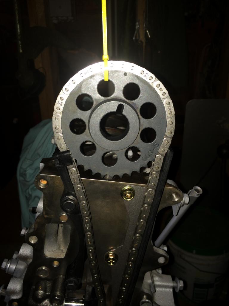

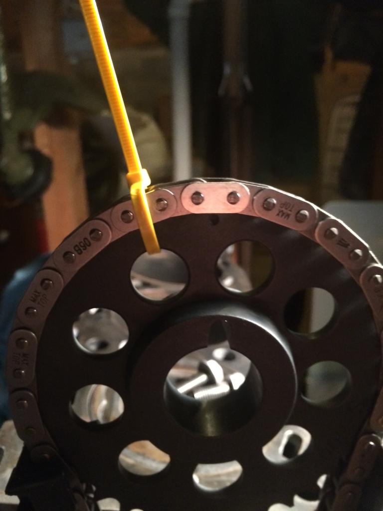

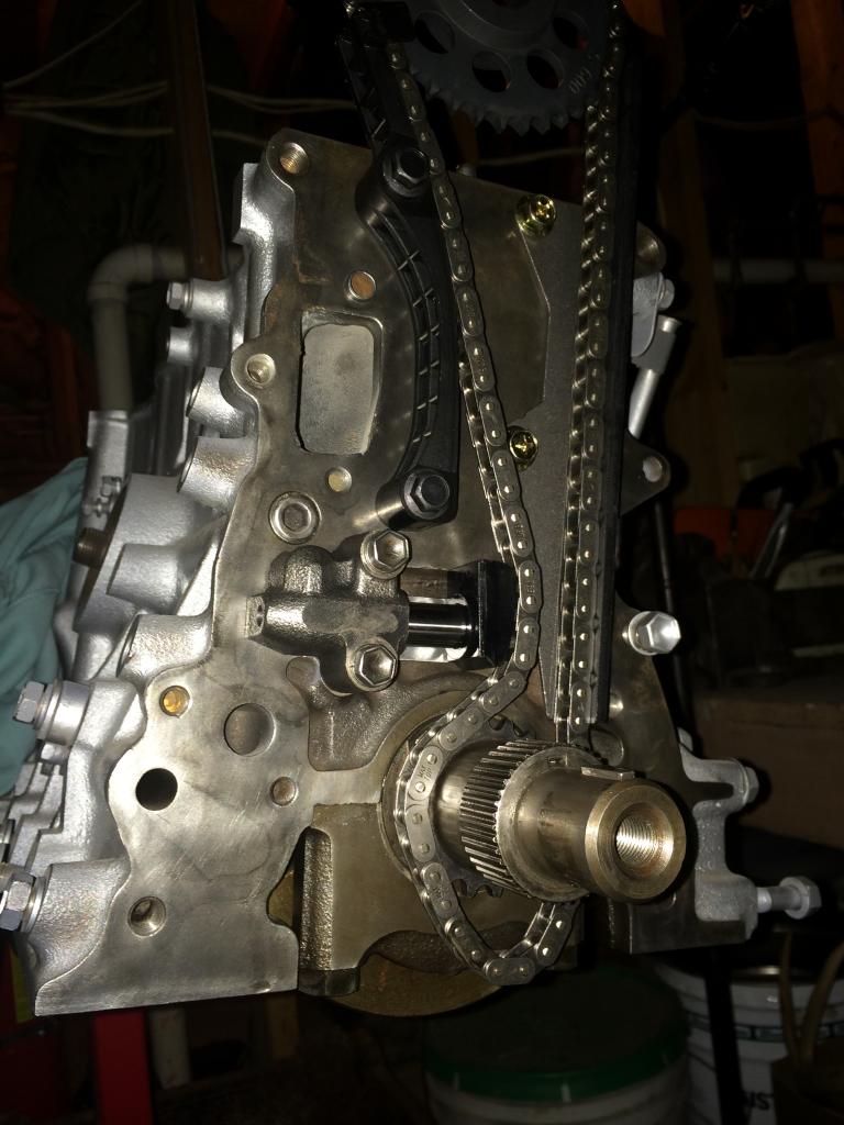

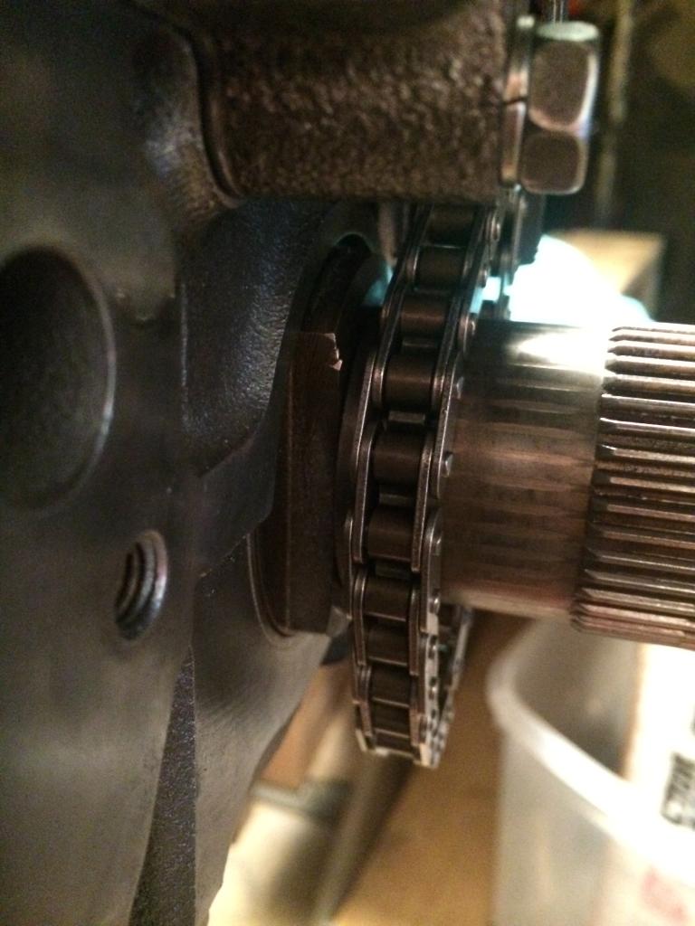

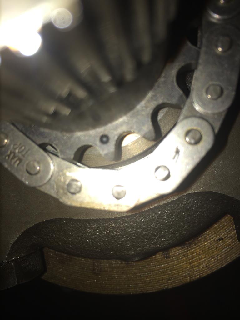

Shockingly I got a day off today and got to work on my motor some more, I worked on putting the timing chain guides and tensioner on today. I was reading what engnbldr gave me and they said to make sure the oil pump bolt doesn't protrude through the back of the timing cover. I tightened it up to the reccommended torque in my haynes and it just barely sticks through(forgot to snap a pic)
My guy at toyota said he didn't know if he could get the studs for my timing cover but he is looking. Unfortunately I also learned today that one of my timing cover bolts has decided to grow legs and walk away, been looking around the garage with no such luck, does any one know where I can get a replacement?

Anybody see anything that looks wrong?
