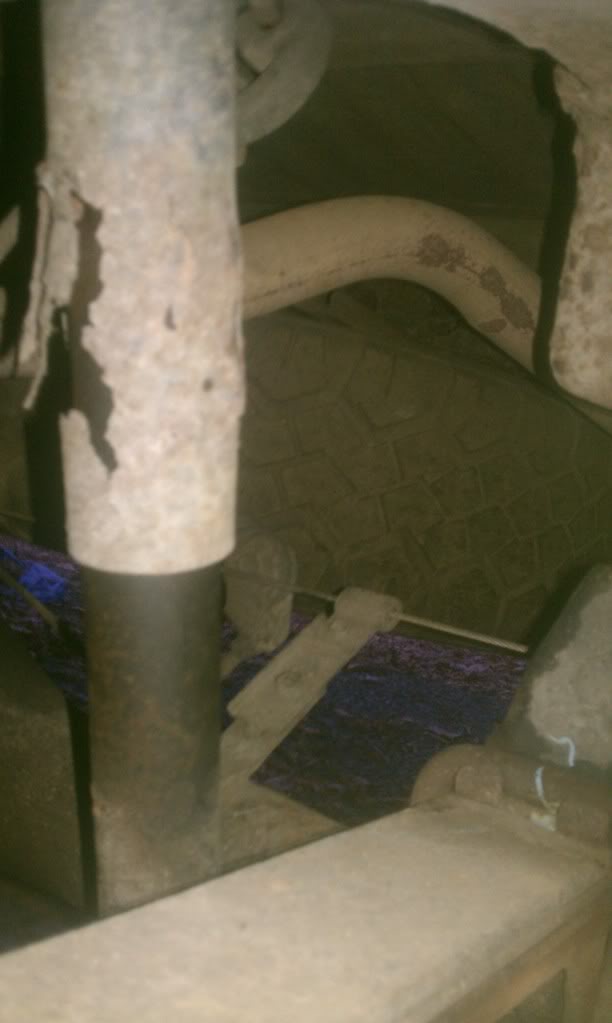

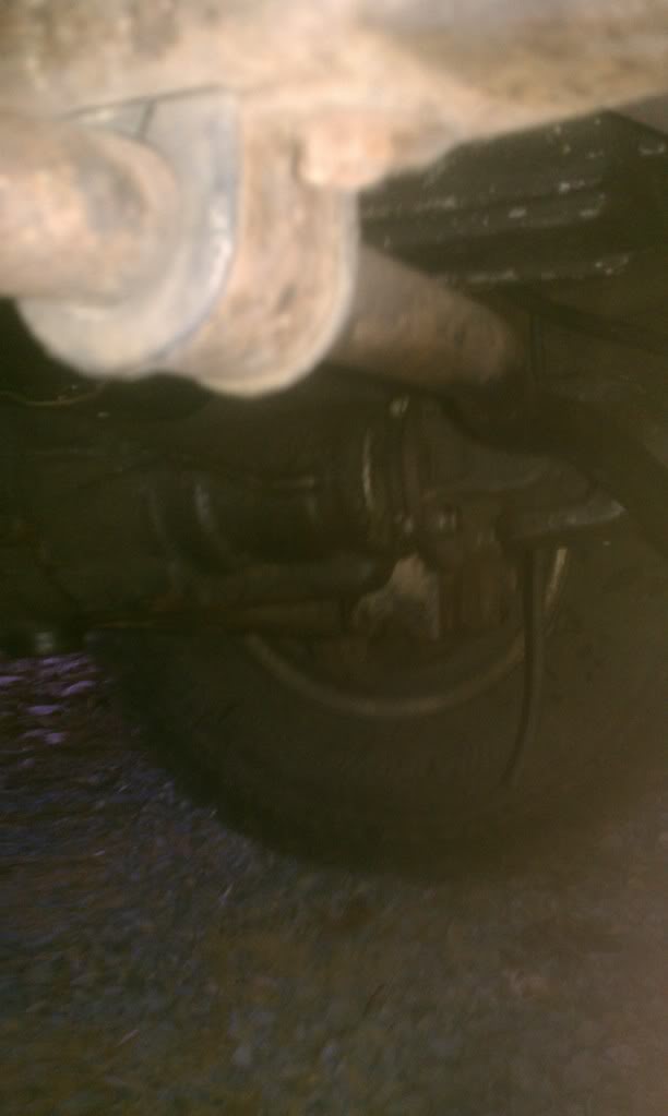

And oh.....rear shocks are sooooooooooo over rated

yep broken end link easy fix that kit i linked to polyurathane bushings new end links and bolts

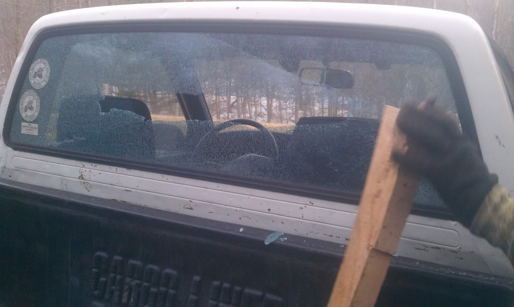

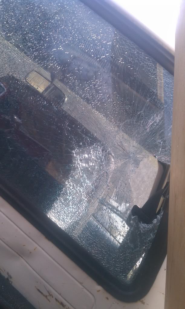

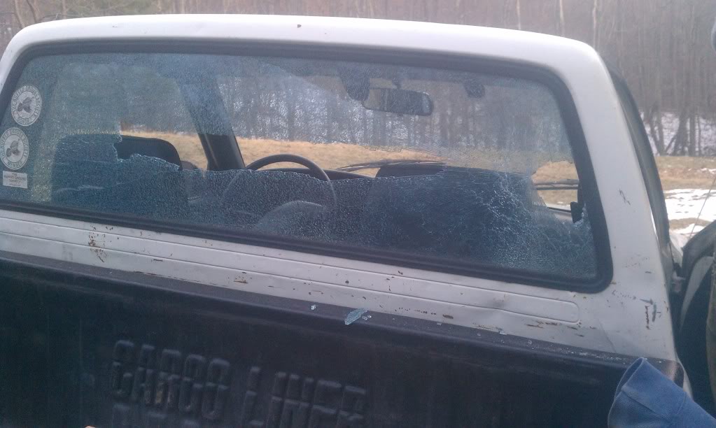

I busted out my step dads back window today. NOT ON PURPOSE, complete accident wasn't paying attention and sent a scaffold buck right through that puppy, so on the hunt for a back glass....and info on here how to do it.

well the rear glass could be quite easy to get check with your local car glass people (safelight ect) for prices they install as well
if you find a used one the gasget is likely going to be your biggest pain they get stiff an crumble if his old one is flexible clean the glass up (the newused one) make sure you take a moment to fix any rust along the metal edge while the window is out
install the rubber to the window put a length of laundry line rope (thin but strong white is the usual color) least a foot of slack on the ends to grip around the entire window in the channel the metal will sit in kinda like this
"cord -> o][- <- glass"
one person in the truck the other outside spray a bit of armor all on the rubber in the channel (lube so it'll slip over the metal edge easy) start at the center an pull the cord while person outside pushes firmly but gently to get the window in work all the way around the window till you have it in
its not easy but the glass guy will do it the same way he just has practice
youtube has a lot of vids on it
