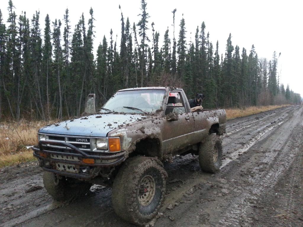

2014 Mud Bogs:

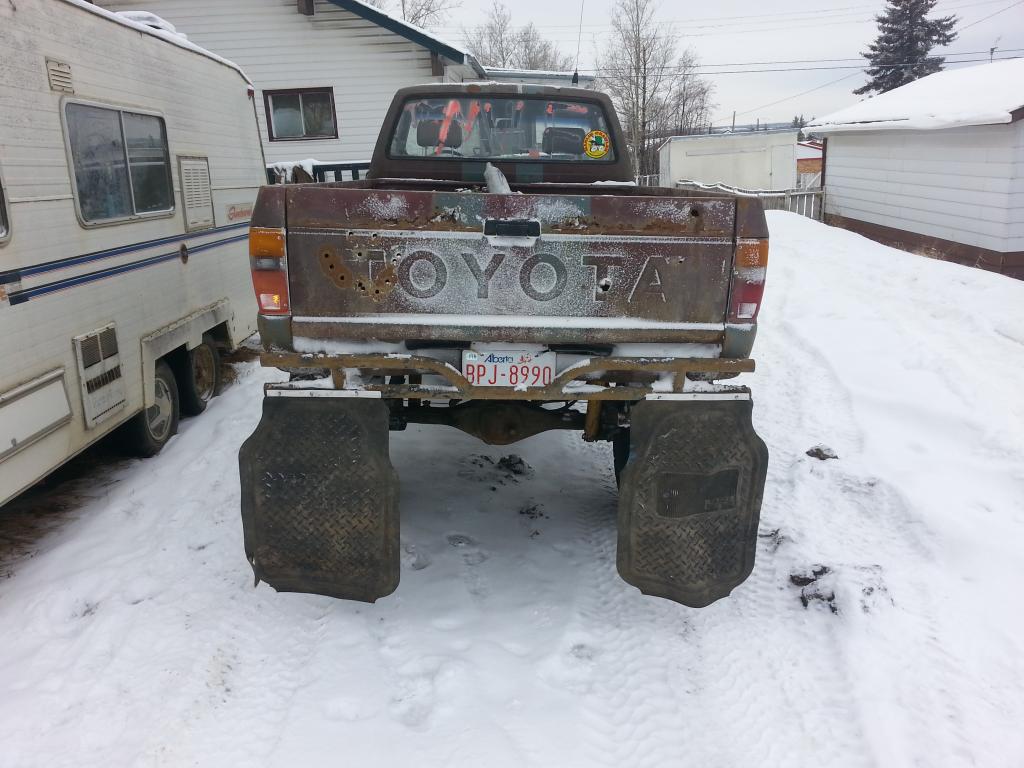

Got pulled over for no mud flaps, so i screwed my floor mats to the bumper... Works!

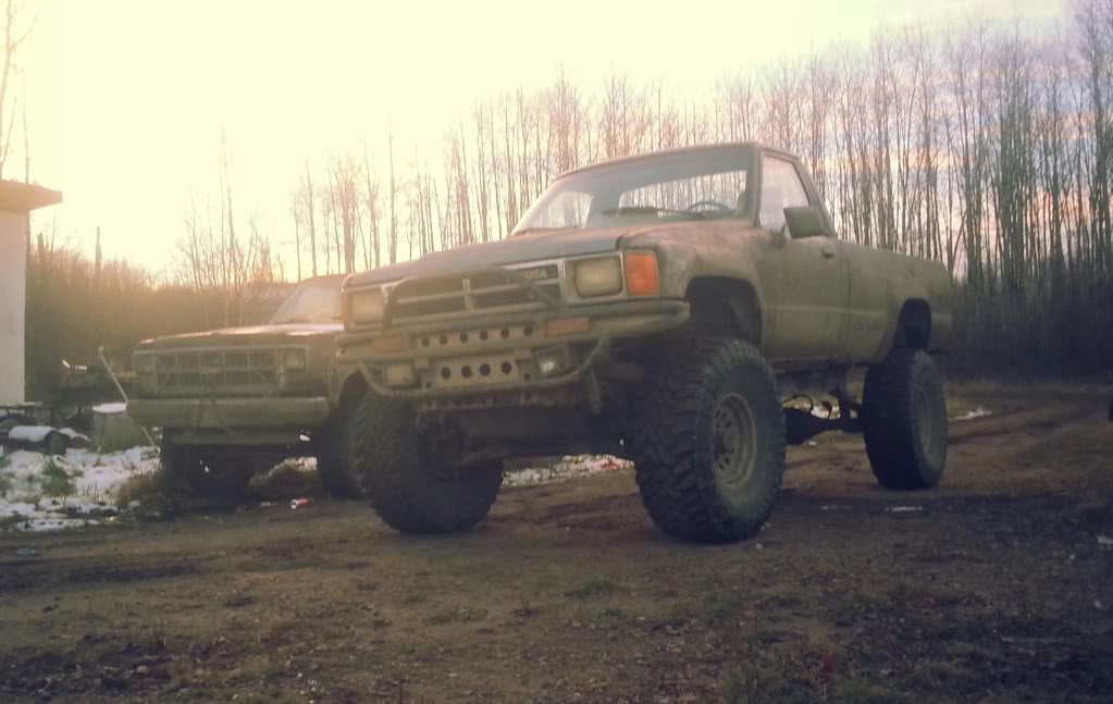

Update:
So the rear diff is all hunky dorey, replaced the pinion seal, and wheel bearings/seals while I was at it.
I received the new leafs and slapped them in. They weren't direct bolt ins had to drill the front shackles out to accomidate the bushings inside the leafs but now I have nice big beefy bolts front and back.
New development is a leaky front diff, so pinion seals, and axle seals for that will probably be the next project.
I ordered a ball joint spacer/diff drop for the front and new hardware for the torsion bars before I try cranking on them. I'm thinking of getting some 25mm swayaway torsion bars as well.
