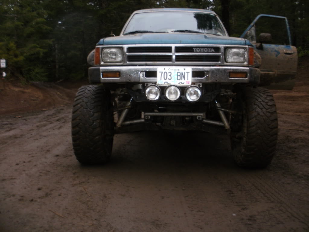

I did some flexing to see how the bump stops are working.I am thinking that I can shorten the compression stops about 1 MORE inch. That should give the rig about 2 inches more travel. By the way I am running a four inch lift with 3 inch bump stop drop brackets. The top droop stop has no rubber on it at this point . that needs to be addressed soon on of them is separating from the frame. I was going to weld on it but i held off. I am thinking of cutting them off and lowering them the thickness of the OEM rubber pad.http://i1099.photobucket.com/albums/...teturbo005.jpghttp://i1099.photobucket.com/albums/...teturbo004.jpg[url]

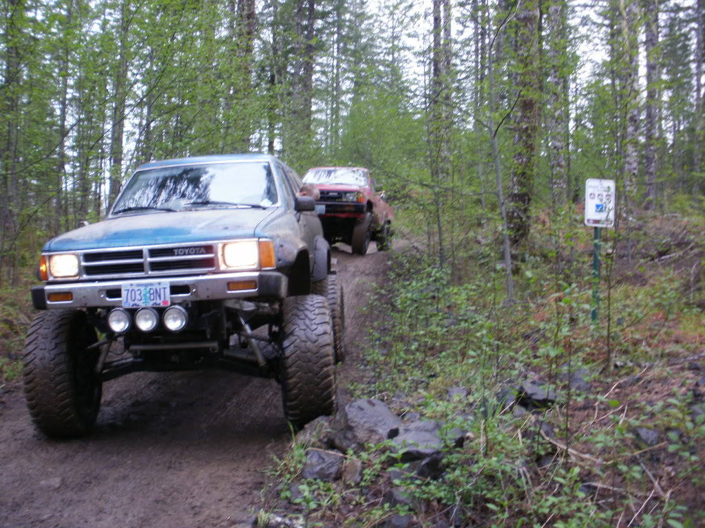

[QUOTE=dark_fairytales;51730151]The looks sweet man. I can't wait to have Long-travel. Looks like your runner might run as smooth as a Cadillac down the high way, browns is so much fun. all the trails a clearly marked.Name:  brownscamp017.jpg

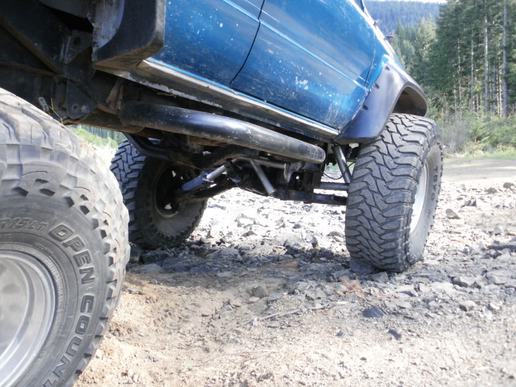

turned down the t bars for some fire road slides, awesome ride and handling.Name:  brownscamp003.jpg

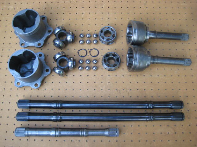

Can u dig it! Here are the custom CV axles lengthened to work with the Blazeland Long Arm Kit. The axle on the bottom is the standard Pickup / 4 Runner.
DudeName:  IMG_24681.jpg
Size:  47.7 KB those are so sweet we need a big picture.
