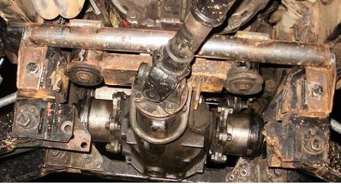

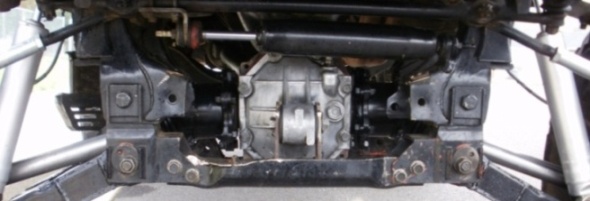

i dont know if this is going to work so I`m not going to spend a lot of time on the cozmetics at this point. trying to come up with something that will bolt to diff for a mount.

i used the 3 mounting bolts and a 3.5 inch u bolt to hold in place. seems to be solid.

i don't understand what you are trying to achieve.....please splain!

If i mount the diff in the center i can run longer cv axles .more wheel travel.

How are you going to get the drive shaft around the oil pan?

I have seen this done on an aussi runner. the guy used the rear diff out of a MK3 supra. his plan was to make the angles of the CV's more reliable. He did achieve his goal and found out he could run more travel then stock as a plus.

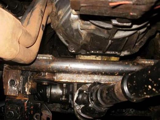

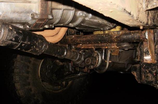

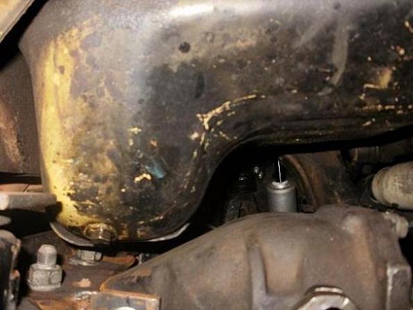

i ajusted the third so the pinion is up some and is close to the oil pan. there is more room than it looks.

by the looks of that one photo where you show the clearance of the diff to oil pan, if you did not have the bracket lift and engine drop (equaling effectively a 1" bracket lift) you would not clear.
Just throwing that out there in case someone tries this on a truck that doesn't have the bracket lift. Looks good though, I admire the creativeness.

when i built my mount i did not relize that the pinion was offset so my mount ended up being off set as well. I have had way worse drive line angels on my straight axle truck at full drop on pasiger side. so drive line should be fine.

Is that also a SFA oil pan? I'm pretty sure (on my diesel anyway) that the pan is sort of clearanced around the front diff. Of course a SFA pan probably wouldn't be.

It is a 22re.I don`t know if it has a diffrent oil pan than stock.When i bought the 87 it had yellow paint on motor so it had ben out before.
