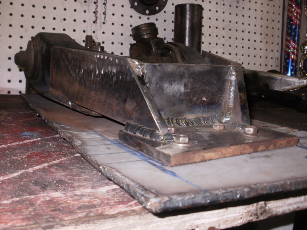

started to build the other side after work .A pic of the arm bolted to my jig.Name:  P4140605.jpg

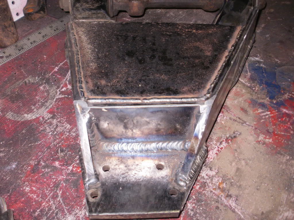

i finished welding up my right side upper tonight.I took a few pic of what it looks like befor i weld on the top plate.Just a bunch of scrap welded together.Name:  P4150620.jpg

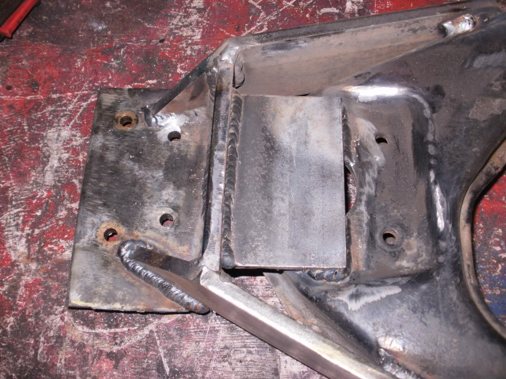

underside.Name:  P4150623.jpg

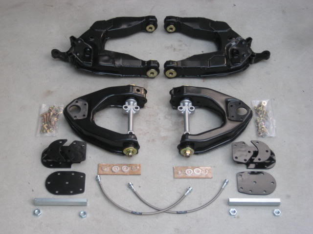

Interesting evolution of your build. How much wider are you now? Are you still going to be able to get enough spring rate out of the aftermarket Torsion Bar (25-26mm) with the added fulcrum length or are you going with a coil over conversion?
What remains from the Blazeland LA kit that hasn't been modified, welded on, or cut up to sell? Who ever ends up buying feel free to contact me at the Blazelandn8 at yahoo e-mail account if your wanting alacarte items.
$500 LCA's
$200 UCA's
$200 UCA Extension Brackets
$100 SS Brakelines
$100 Tie Rod Adj. Sleeves
$999 Complete Long Arm Kit

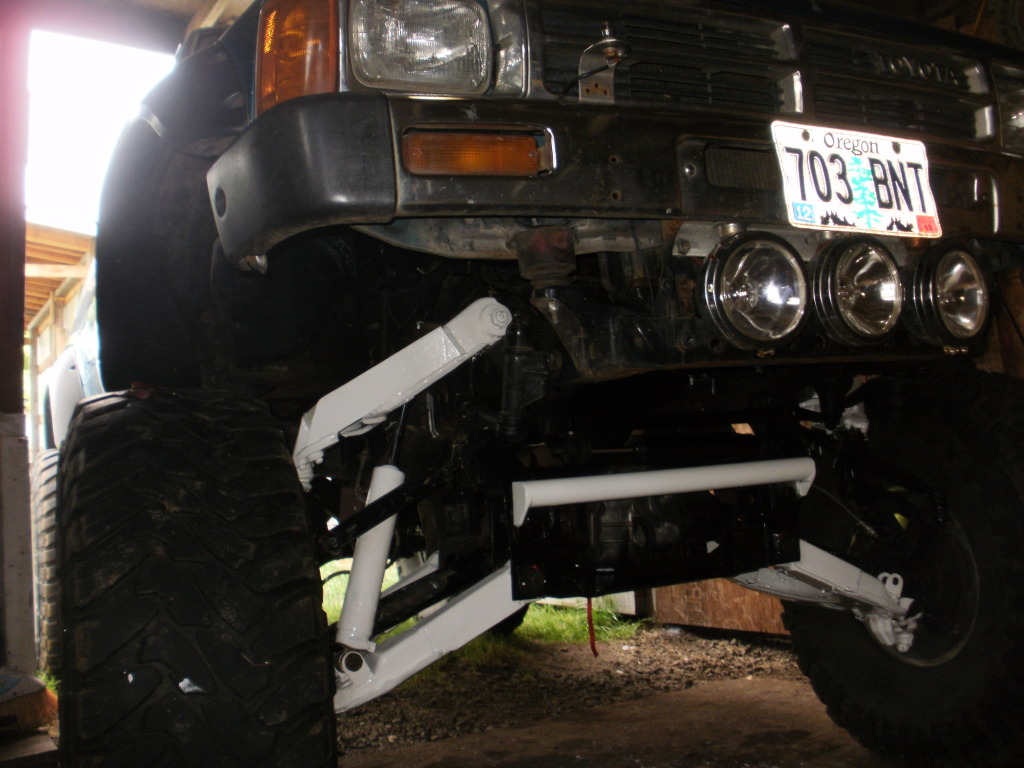

I shorted up the upper arm from + 5.25 to +4.50.My thoughts, it might handel better with the top arm shorter and help with the torsion bars.I also moved the top balljoint back 1 inch for added caster .37-14.50 tire needs more caster than a smaller tire to dive down the road good. I rolled the cams in on the lower a arm and was able to get the tire staight up and down. I am happy with how it drives although the steering fills slightly heavy when turned.

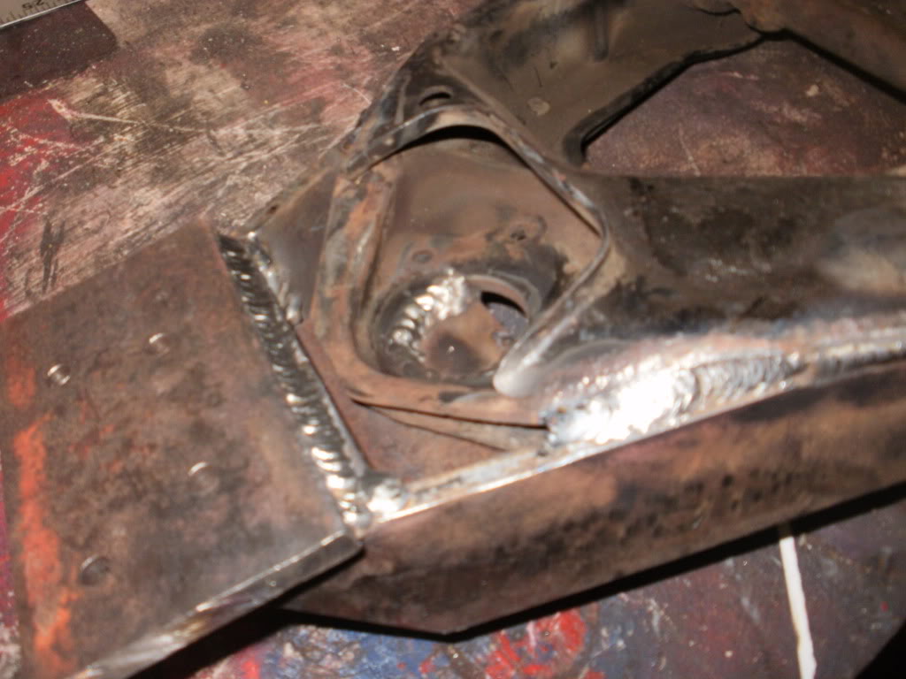

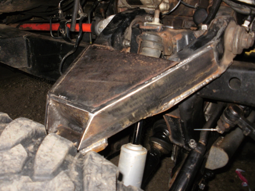

My scrap yard freebee arms are looking like they need some help.I Started to clean them with a grinder and flaper wheel.On my second arm I built the top plate small so when i welded it in my weld would penaetrate down the the side so i can smoth the weld .Name:  P4210639.jpg

Your scrapyard UCAs look super beefy! I like the design of adding / welding on an extension section the way you did. I have a few sets of scrap UCAs from core returns that customers sent me over the years that were rejects because they were hacked up for BJ spacers or such. I was revisiting the possibility of cutting and lengthening in a way that would allow running a coil over conversion through the pocket rather than behind the UCA. Running the coil assembly behind the UCA (like a J-Arm) works fine but adding a secondary bypass shock would be a nice feature. I was also trying to incorporate some improvements for caster / camber adjustment. It just seems to be over engineering a simple solution; the bolt on UCA extension brackets have been working so well. But then again everything has room for improvement. Good stuff!
