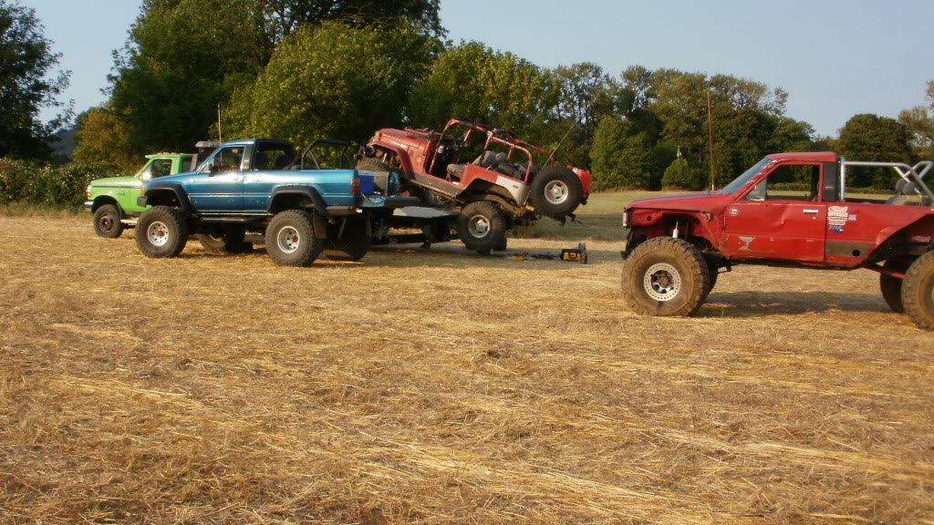

Taking center build to a cool offroad park with hopes for video and pic.Name:  quackattack004.jpg

Old Aug 24, 2011 | 08:03 PM
  #182
dark_fairytales's Avatar
Joined: Oct 2008
Posts: 1,621
From: Sacramento, Crawlifonia
that thing looks really good. When is it time for a locker?

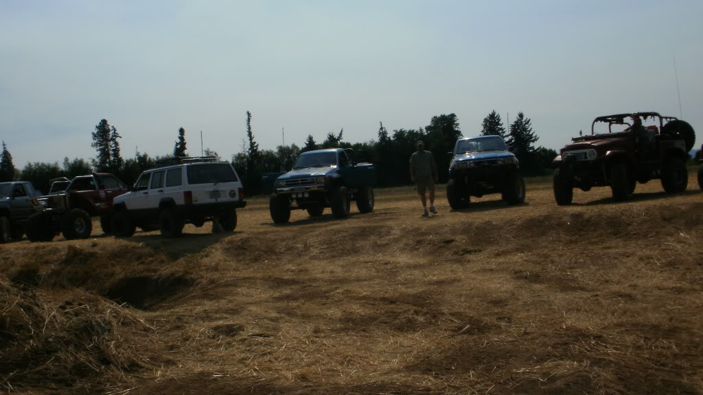

WIDE OPEN BOUNCINGName:  traskmountainclubrun096.jpg

Old Sep 3, 2011 | 01:59 PM
  #191
drew02a's Avatar
Joined: Aug 2010
Posts: 109
lol, buy a locker
Old Sep 3, 2011 | 04:12 PM
  #192
eric924run's Avatar
Joined: Jun 2011
Posts: 77
From: Phx, AZ
Is that the first shaft youve lost. Time for .250.

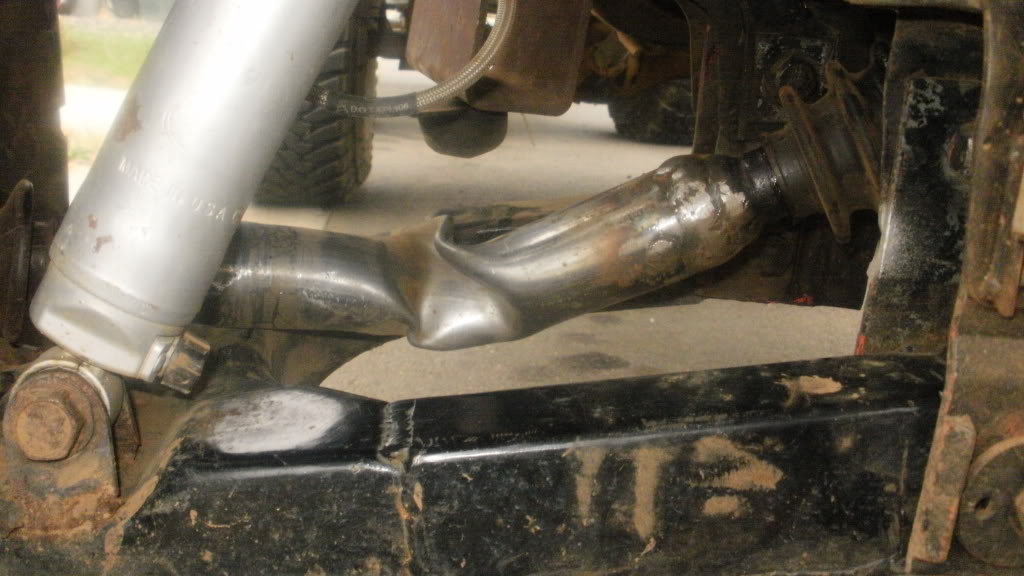

Yes that is the first.I was surprised that i was able to twist a 2 inch 120 DOM tubing. I was wide open with a fresh motor in good tune.It did not break easy. I was happy to see that the tubing held onto the original axle shaft. That was what i was expecting to be the failing point. You are on the money next one will be .250.By the way that park is 3 mile from my house and we use it for testing.I kinda did it on purpose or was not one bit surprised when something let go. we had three broken axles before the day was up. glad my buddy has a roll bed makes changing rear axle niceName:  traskmountainclubrun063.jpg

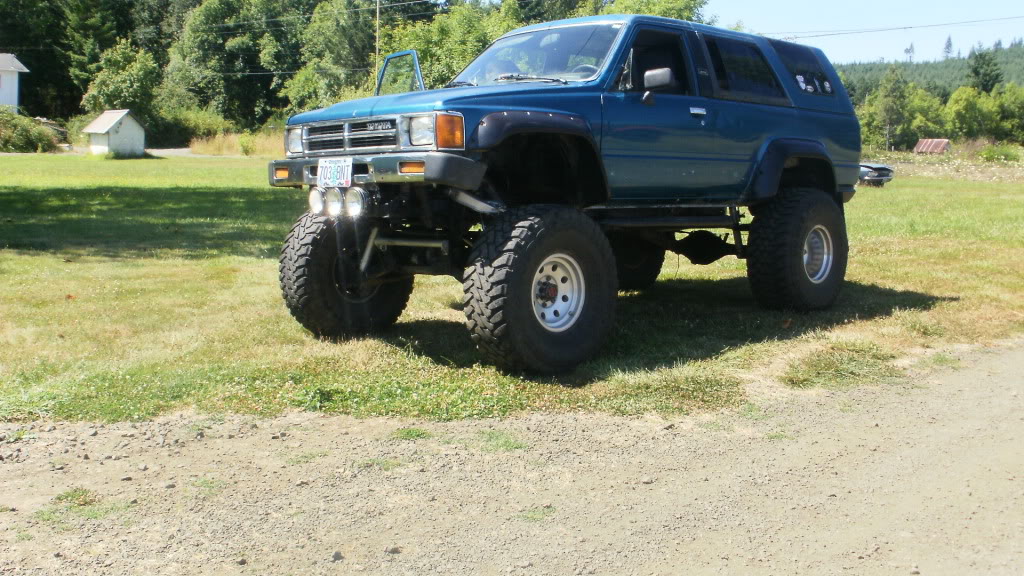

9.5 toyota land cruieser 33 pline shat.Name:  traskmountainclubrun063.jpg
