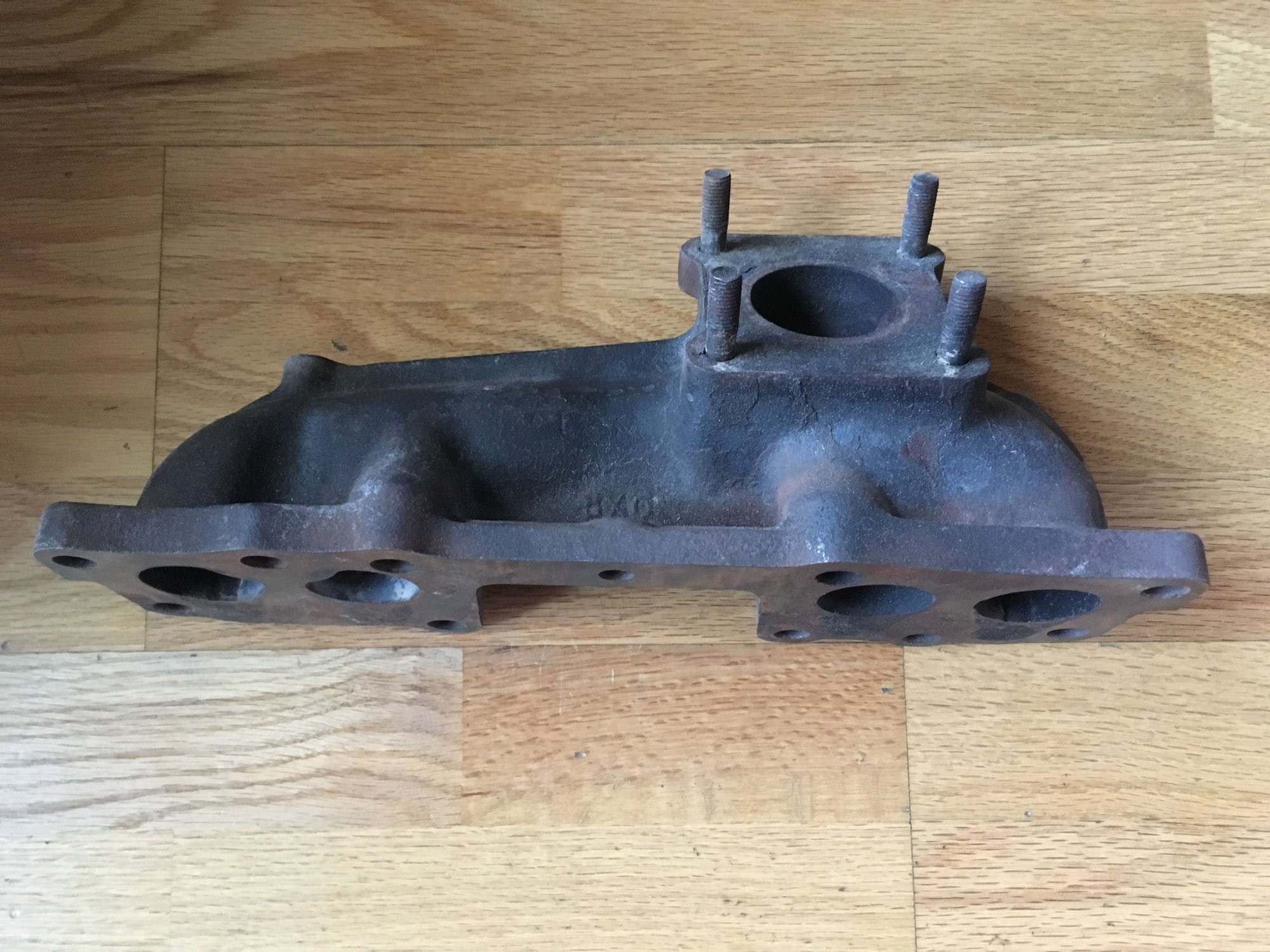

I just received my replacement OEM exhaust manifold. Thankfully, as advertised, it doesn't have any cracks. I'm going clean it up a bit. Perhaps by performing rust removal by electrolysis. I'll post the "after" photos when I get it done.

interested to see how the rust removal via electrolysis works out!
as the attemptor of many home chemistry experiments, I am doubtful, but wiling to be proven wrong
try on scrap first and regulate your power supply!!

I'm interested to see how it turns out too, magnet18. I'm going to test the electrolysis process on my cracked exhaust manifold before I even think of doing it to the one I just purchased and recieved. I'll do a write up and provide photos of my results when it's all said and done. I still need to gather the supplies. Wish me luck!

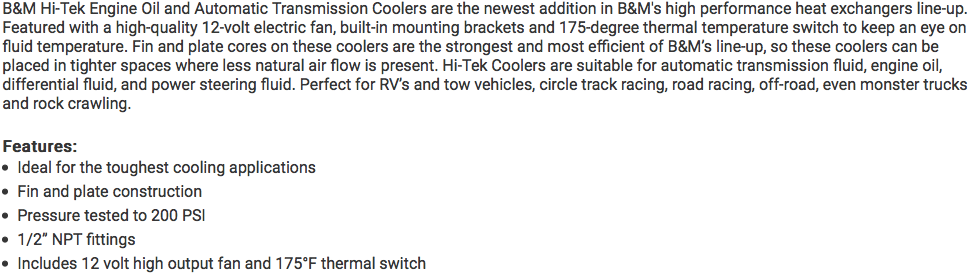

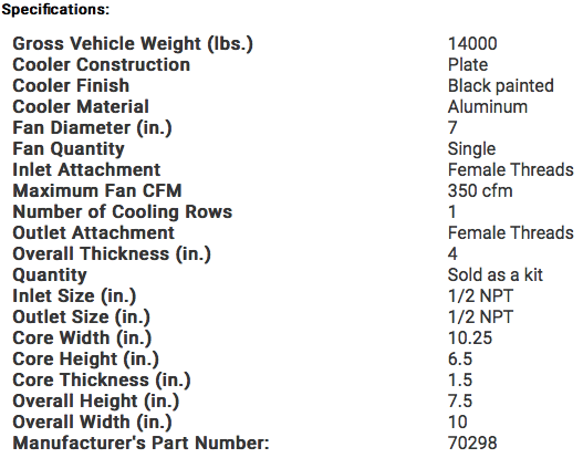

Since I'm going to keep running the OEM automatic transmission, I'm going to want to run a transmission cooler equipped with a fan. I figure this will come in super handy especially when crawlin' or haulin'. I've been looking at this unit on Jeg's... Any thoughts or experiences with transmission coolers would be greatly appreciated. Thanks ahead of time.
My experience is that the B&M didn't do anything mounted with a fan. I mounted a hayden oil cooler in the front and that made a huge difference. On most versions of the front end it fits well, but with mine I had to do some modifications.. It was worth all the effort as I don't have ovreheating issues anymore.
You can see how I installed it in my build thread at this link.. few posts from the top. https://www.yotatech.com/forums/f199...5/index13.html
And here is the link to the thread where I installed the B&M cooler... then made a cowling... then spent a lot of time thinking about it and still didn't work ... https://www.yotatech.com/forums/f116...08/index2.html

Gevo, I was looking at the Hayden ones too. I gotta do some more research before I decide on which one I'll end up installing. I should crawl under May soon and look up her skirt to find where I can possibly install a transmission cooler.
