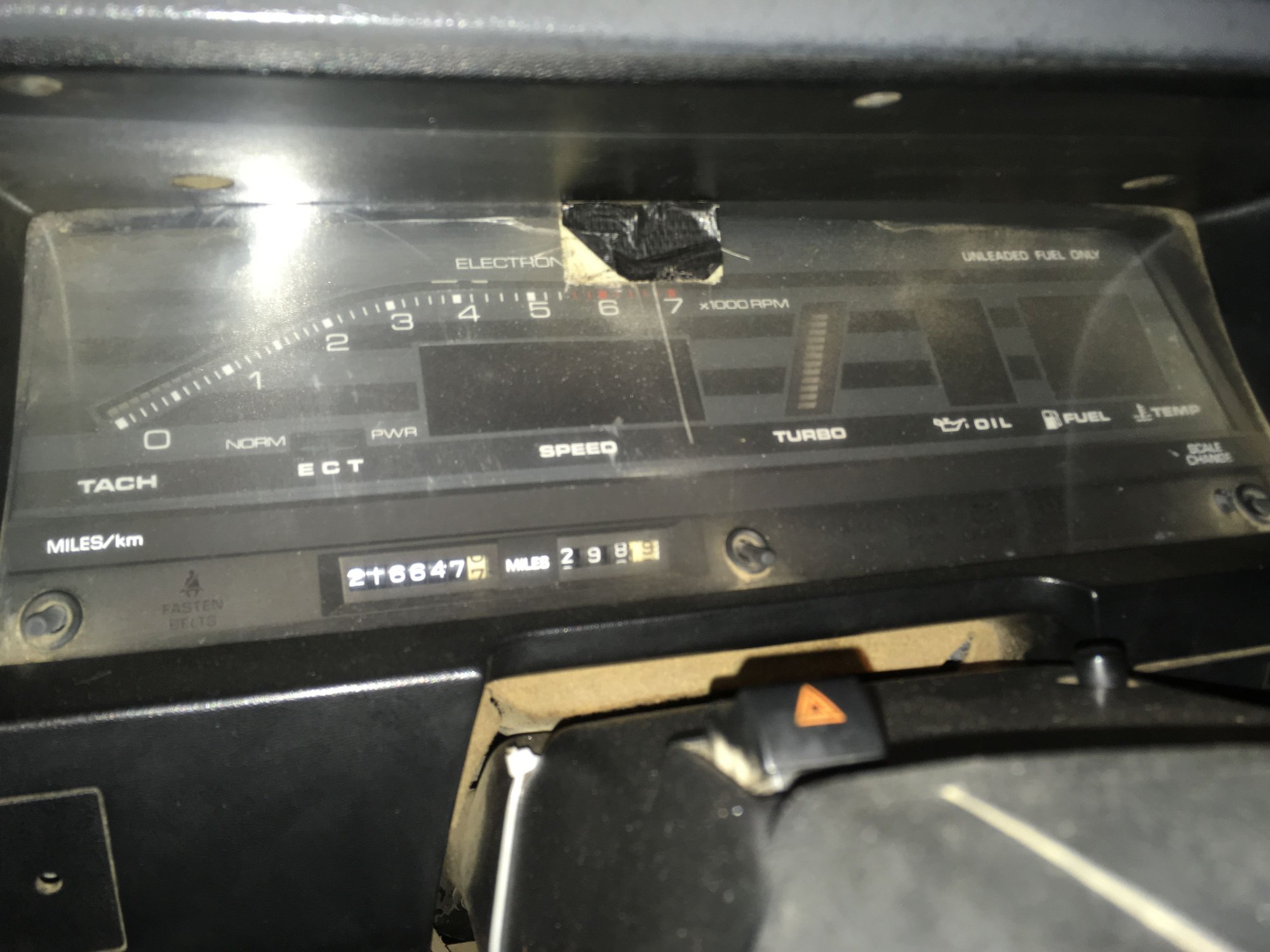

This is the condition of my digital meter. I have no clue how the meter was damaged? All of the gauges work but I'm afraid that I need to replace it with another complete meter or... I can perhaps purchase the parts from one of y'all from perhaps a digital meter that's non-operational? If any of those options are feasible, please send me a PM with a photo of the meter/part. It will be much appreciated. Thanks ahead for your time and consideration!
'86 Turbo Meter
Exploded View of Meter
- GLASS, COMBINATION METER (83133-89305)
- DIAL, METER, NO.1 (83131-89301)
- DIAL, METER, NO.2 (83131-89305)
- PLATE, COMBINATION METER, NO.1 (83133-89303)
'86 Turbo Meter

If the only issue with the cluster is the front face, your best bet is probably to troll eBay for awhile and look for one to pop up that's broken or untested, then swap parts around
#37
C'mon magnet18, of course I'm all over eBay, Amazon and Craigslist. LOL! Posting a request on my thread is just another avenue for possible opportunities. Is someone bites, cool. If not, that's ok too. I was told at a young age, "If you don't ask, you won't know."
