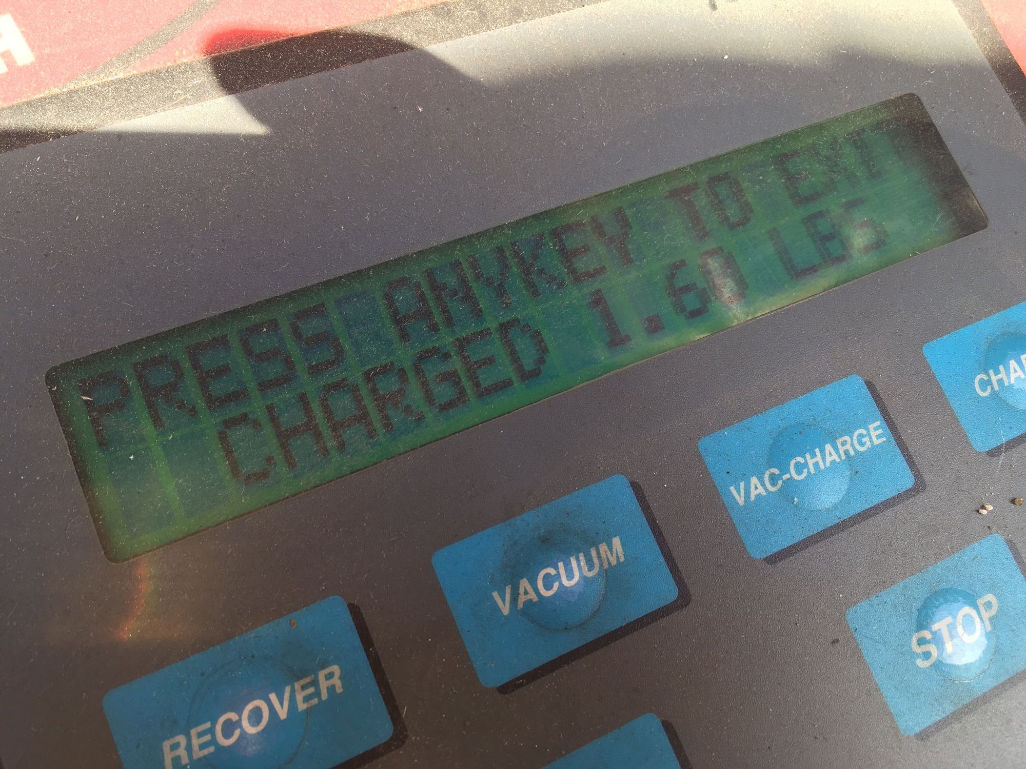

We charged the AC system today. Unfortunately the compressor clutch isn't getting a 12V signal even though the AC switch on the temperature control is on/lit.
I'm looking at the FSM but I'll be THE first to admit I suck at electrical troubleshooting. I'm very confident with any mechanical work but I'm intimidated by electronics work
The good news is we directly connected the wire (the ground is achieved via the compressor housing itself) for compressor clutch to 12V and managed to actuate the clutch and immediately got cold air to blow out of the vents so at least we know the system is charged.
