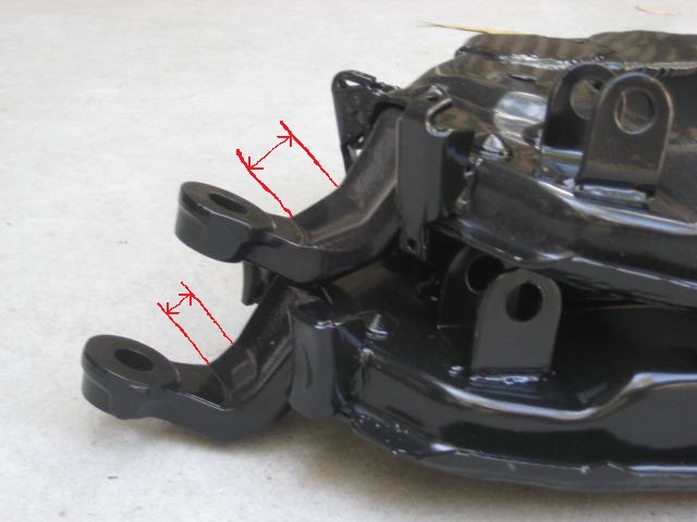

Yeah, I figured out a few things that were limiting my travel. My 4 Runner is a 1986 but because I had a surplus of 1989+ control arms I had put the later model control arms on the 86 rig.
On the LCA the BJ drop is slightly different as you can see in the photo. LCA on top is the later Gen.

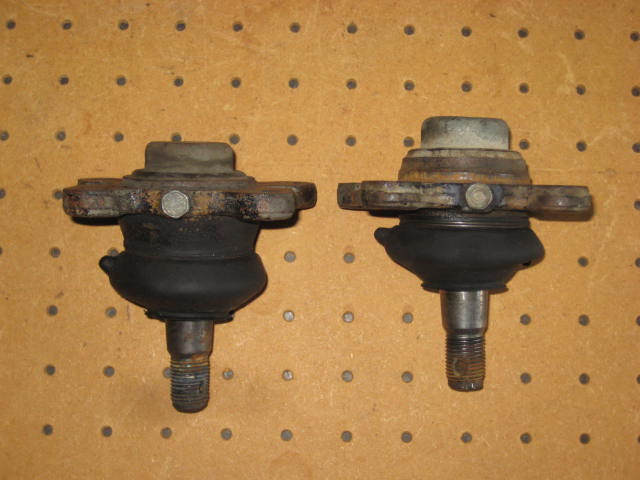

The 1986-1988 control arms, bushings, and lower BJs are different from the 1989+ control arms. The lower BJ on the left is the later Gen. Well the problem was, I didn't remember to swap out the lower ball joint to go with the later model LCAs so I was using the wrong application.
When I switched the early lower BJ to the later Gen (to match the control ams) I was able to get almost one more inch of up travel and one more inch of down travel.
I have not tested the opposite scenerio but it may be advantageous to use the later Gen lower BJ on the early Gen LCA to get more travel? I don't remember this being the case when I was prototyping the design but its a possibility. I'll look into it and report my findings later.

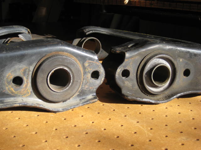

On the UCAs, the differences are harder to spot. The early Gen has flush bushings and the later Gen has a void (see photo) You can only see this if you remove the cross shaft nut and washer, but if you insert a flat blade screw driver betweeen the rear washer and the bushing you can feel for the void without disassembly. The upper BJ doesn't change between years.
