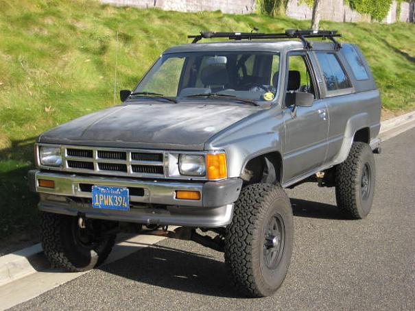

Here is a before photo, and its the same stance now! 3" of lift then, 3" of lift now! No sense of taking another photo. Before it was on 2" blocks and the add-a-leafs. Now its on a progressive rate springs. The MiniPack gives about 2" of lift and the longer shackle that about 1". The difference is the progressive spring rate and the added wheel travel. The ride quality is drastically improved!

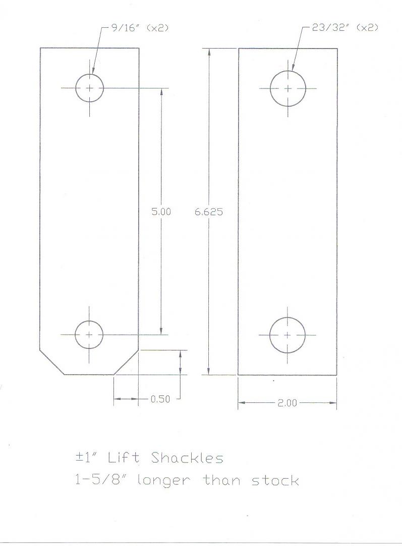

Ok, so about those extended length shackles, here is the write up:
First obtain a 2" wide x 1/4" thick bar of Cold Rolled Steel about 30" long. Cold rolled steel is a high quality material and excellent choice for machining. It has a greater ability to withstand bending than Hot Rolled steel. Cut it into (4) sections. I wanted my shackle to be 1-5/8" longer than stock so I cut it into (4) 6-5/8" lengths. Oh heck..... see attached CADD drawing plans.

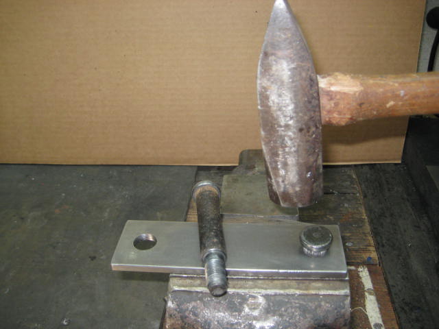

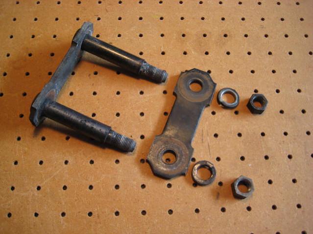

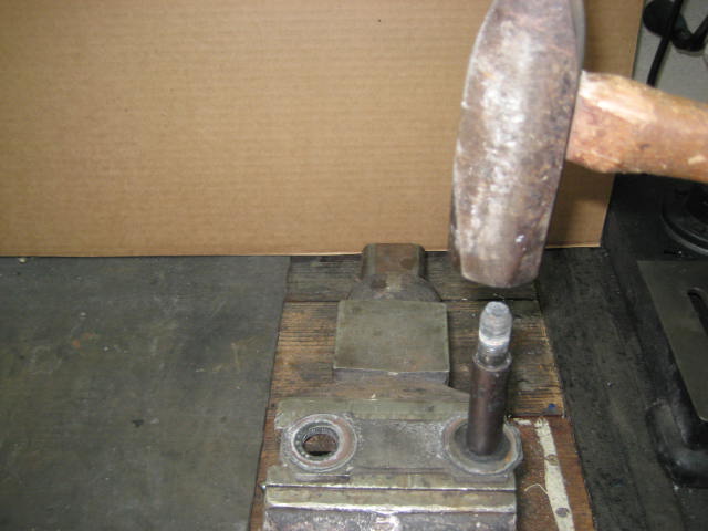

Once the plates have been machined or drilled in a drill press you need to transfer the bolts out of a donor pair of stock shackles.
Photo A1: stock shackles
Photo A2: Press out bolt
Photo A3: Dissasembled
Attached Thumbnails BlazeN8's 1986 4Runner Build-Up Thread-a1_stock_shackles.jpg   BlazeN8's 1986 4Runner Build-Up Thread-a2_press_out_bolt.jpg   BlazeN8's 1986 4Runner Build-Up Thread-a3_dissasembled.jpg

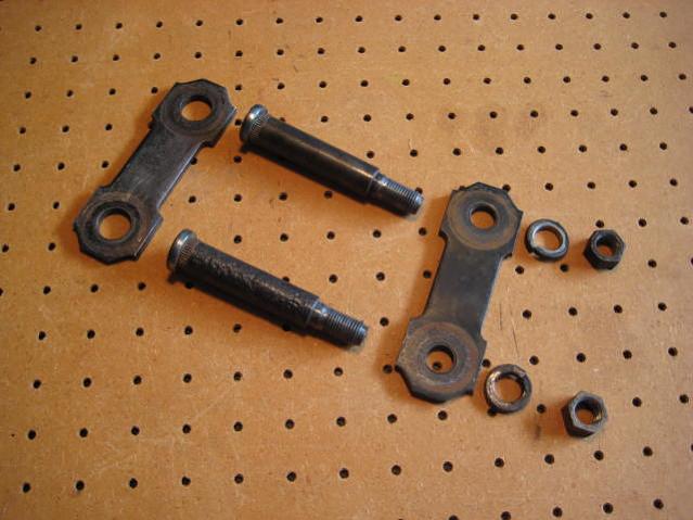

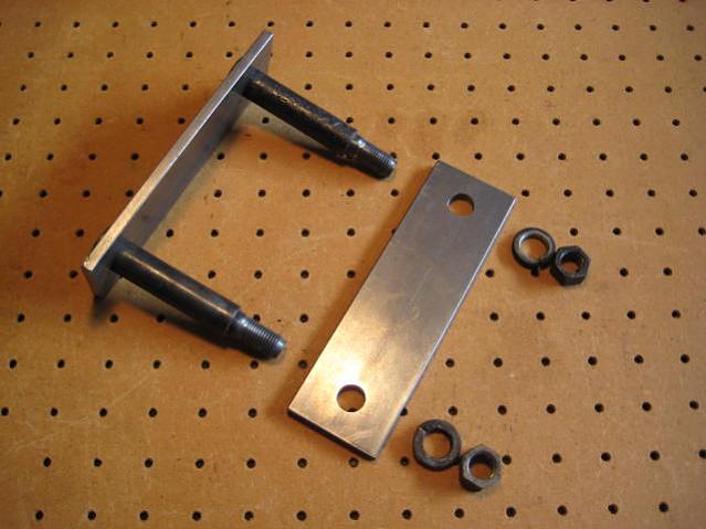

Photo B1: Comparison
Photo B2: Press in bolt
Photo B3: Assembled
Attached Thumbnails BlazeN8's 1986 4Runner Build-Up Thread-b1.jpg   BlazeN8's 1986 4Runner Build-Up Thread-b2_press_in_bolt.jpg   BlazeN8's 1986 4Runner Build-Up Thread-b_pressed.jpg

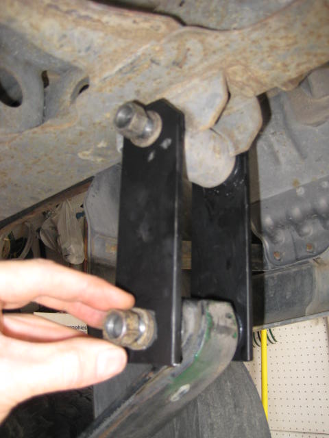

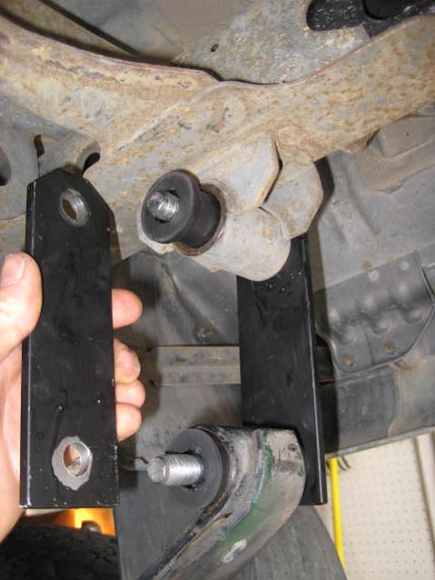

Photo C2: Install side plate
Photo C3: Tighten nuts
Attached Thumbnails BlazeN8's 1986 4Runner Build-Up Thread-c2.jpg   BlazeN8's 1986 4Runner Build-Up Thread-c3.jpg

Well there you have it! Now you can use the factory spec bushings either in rubber or poly! And when you tighten the shackles because of the shoulder in the bolts it wont crush the bushings onto the spring eyes; a propper preloaded bushing! This design also will suport better lateral loads. And last but not least you can make custom lenghts to dial in your lift. I wouldn't go anylonger than 2" over stock unless you welded some additional support to the sides. Time for a beer at the pub. Sweet its Friday!

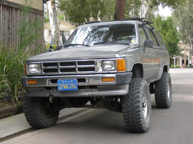

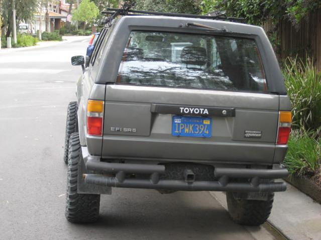

do you have any shots of the 4runner looking down the side body panel? i'm interested in how far out your tires stick with those stock rims and your long travel ifs kit. what size tires are you running?
Old Feb 6, 2010 | 10:04 AM
  #37
BlazeN8's Avatar
Posts: 977
From: Southern California

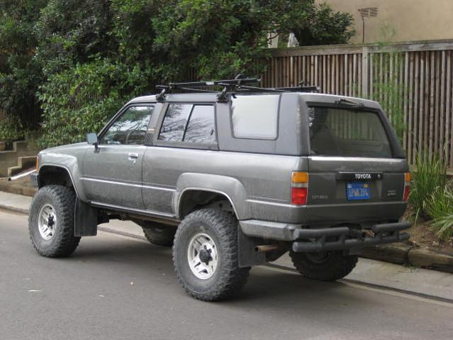

Sure, I have a few side shots........
This is the 4Runner with a 33x12.50R15 BFG MT on the SR-5 factory mags which are 15x7 with a 4.5" backspace.
Attached Thumbnails BlazeN8's 1986 4Runner Build-Up Thread-33x12.5sa.jpg   BlazeN8's 1986 4Runner Build-Up Thread-33x12.5sb.jpg   BlazeN8's 1986 4Runner Build-Up Thread-33x12.5sc.jpg

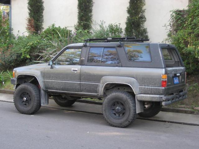

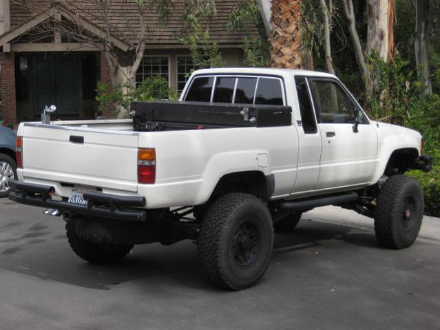

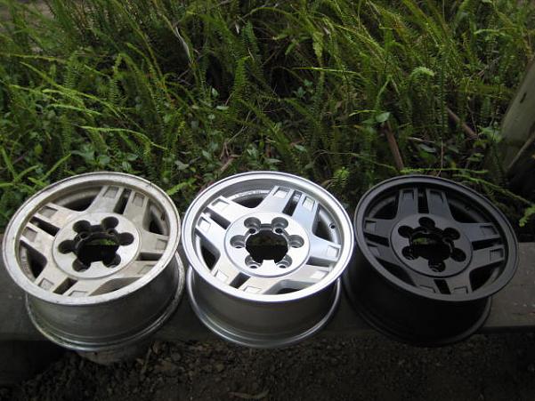

Here are the same SR-5 rims but with 33x10.50R15 BFG ATs. The 7" rim and a deep backspace keep the track width manageable. These SR-5s rims are great, they are strong and are hubcentric. Fairly easy to restore. A light sandblast and a fresh powdercoat. Textured Black or Bangle silver turn out well. Contact Dan at High-Tech coatings in Santa Anna, he will hook you up for $35 each black and $45 each silver.
Attached Thumbnails BlazeN8's 1986 4Runner Build-Up Thread-33x10.5_4runner.jpg   BlazeN8's 1986 4Runner Build-Up Thread-33x10.5_fordota.jpg   BlazeN8's 1986 4Runner Build-Up Thread-sr-5_rims.jpg
