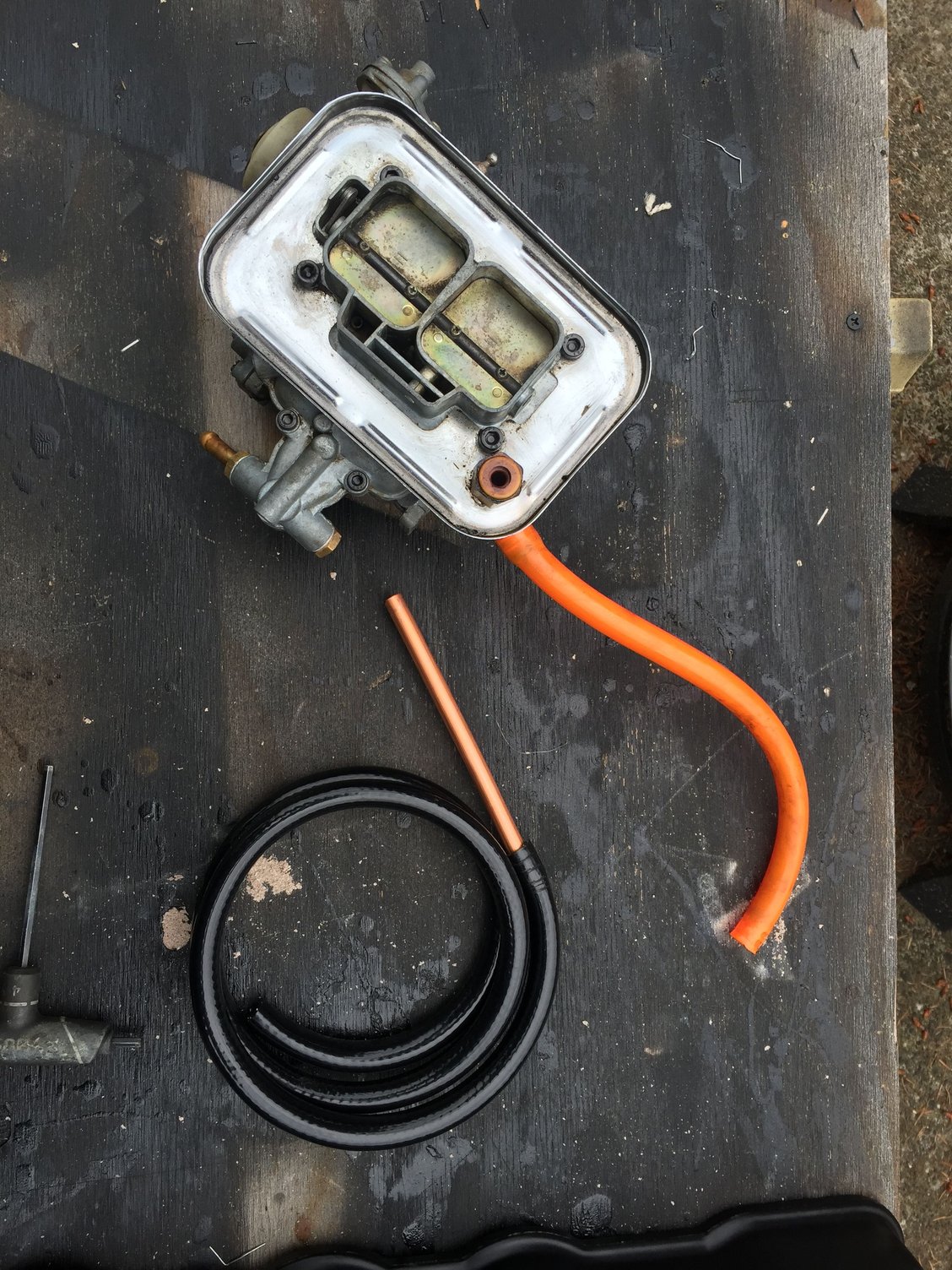

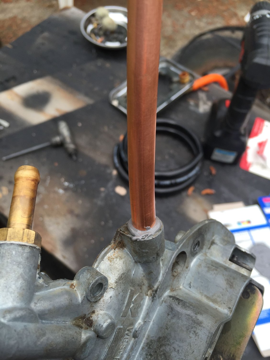

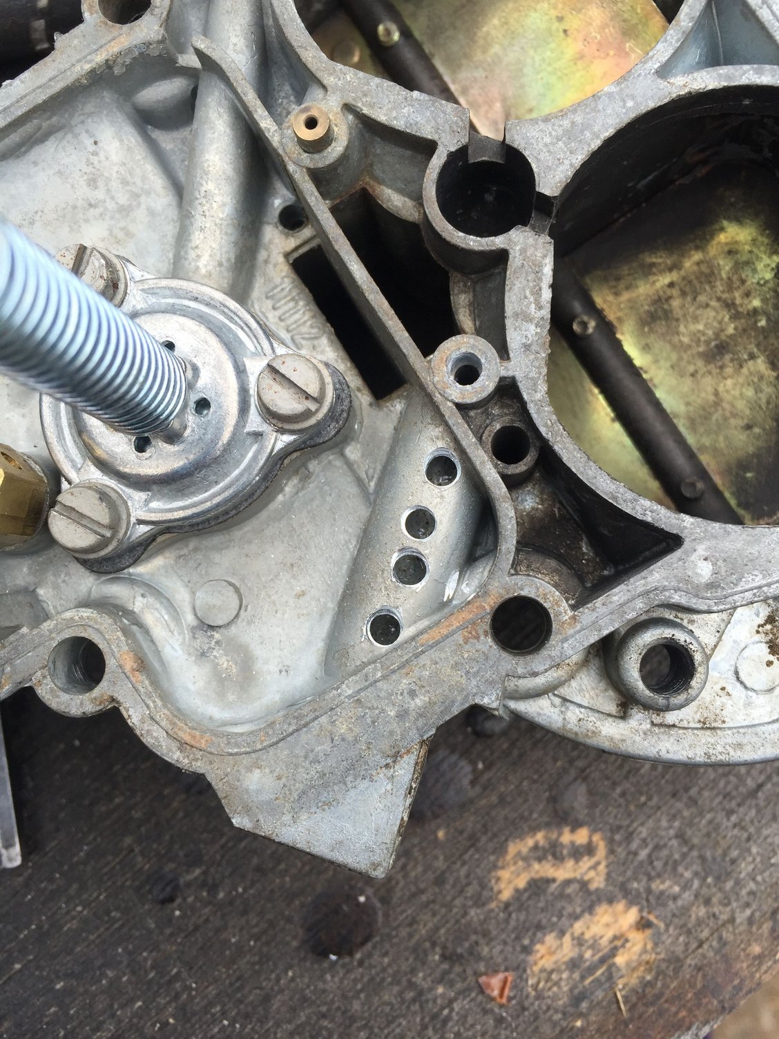

Weber mod was completed once the heavy rain moved in. 🤓👍🏼

is the new copper line and port block off a vent reconfiguration?
Old May 23, 2016 | 01:50 PM
  #74
BlackStone's Avatar
Joined: Dec 2015
Posts: 84
From: Portland
Yes, exactly. Places the fuel vent higher so the carburetor doesn't cut out at high inclines. The mod can be found on MarlinCrawler "How to: Make a Weber climb a hill".
