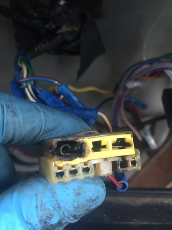

When I got the truck home, first thing I did was tear into the dash. After about 15 minutes; I think I found the culprit..
Good Lord, how didn't this truck catch fire?! Obviously it has been done before as well, seeing that this must be another pigtail that was "wired" together. I went to the local pick and pull, found a new pigtail, replaced it with a new switch from autozone. Soldered the connections and used heatshrink on the exposed solder. Works good as new now.

Wow, that's some scary wiring, like you said, I'm surprised she didn't catch fire! I hope all goes well on the re-wiring project. So you currently don't have high-steer? What did the PO do, hack together the old push pull steering off the 85?.... Some of the things people do, you gotta wonder what the heck they were thinking, not worth the risk just to save a few bucks! Looks like it will be a really nice rig once you get all the PO's hacks fixed, lol. I have some rewiring to do on my latest project as well, I can see a bunch of wire nuts showing through the gap in my steering column cover...wire nuts are never a good sign, lol. Good luck on the project, and welcome to Yotatech!

Agreed. Wire-nuts, always mean shotty work. I get if it were to be temporary, but they should be left alone or for a permanent wire job.

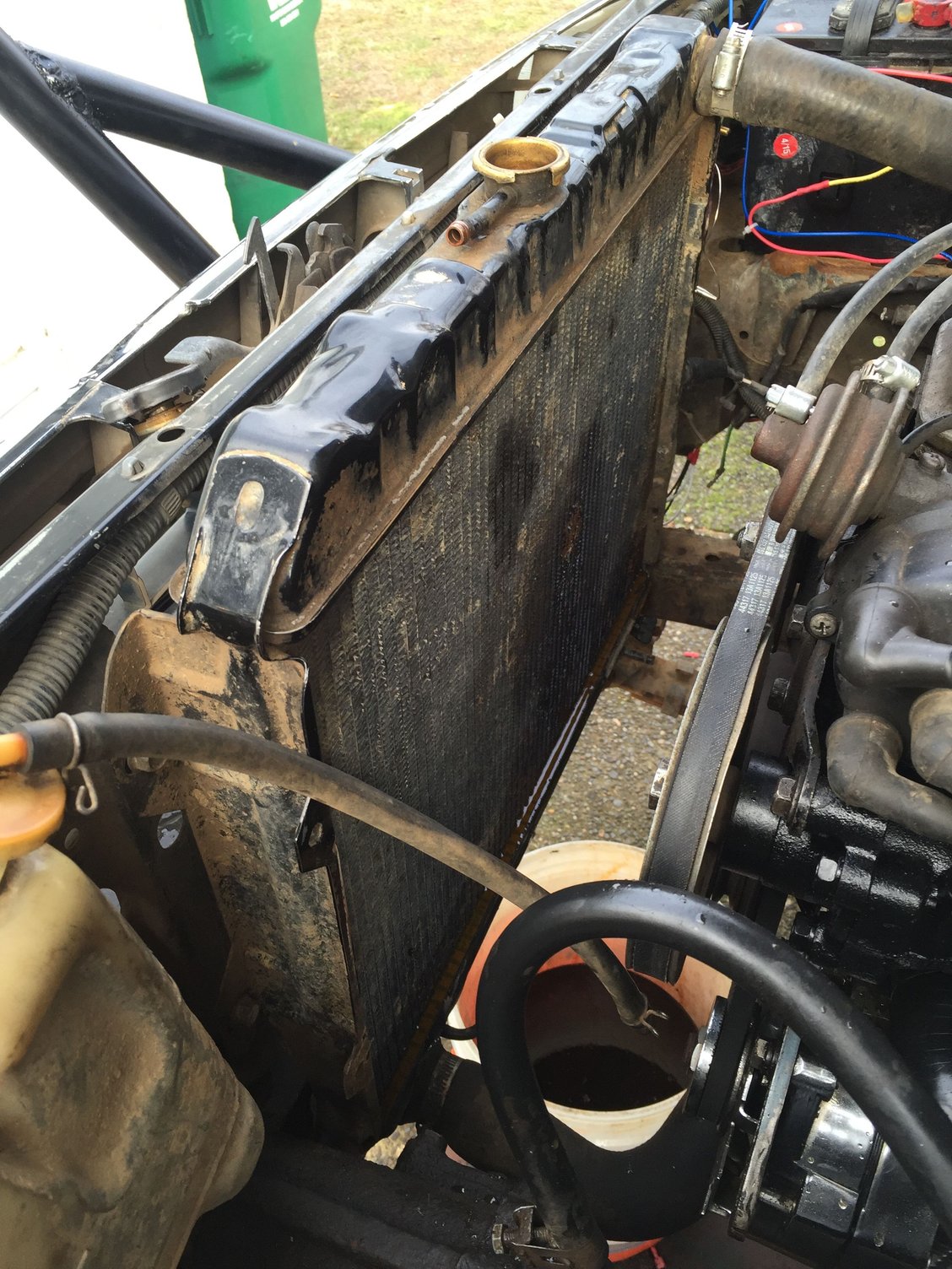

Unfortunately this time I wasn't so lucky, and the first speed bump out of my neighborhood the fan decided to bite the brass radiator.
Ouch....
It was time for a new one anyways.
When the PO swapped in the 22R, he didn't re-use the 3.0 radiator, not sure why?
Old and broken, no thanks to my electric fan...the irony
Rusty muddy engine bay...drives me crazy. Cannot wait until warmer weather to start painting.
Old vs New 3.0 rad
Went back to the stock clutch fan like many wise members suggested I do. Makes everything look so ugly, being that it's so new.

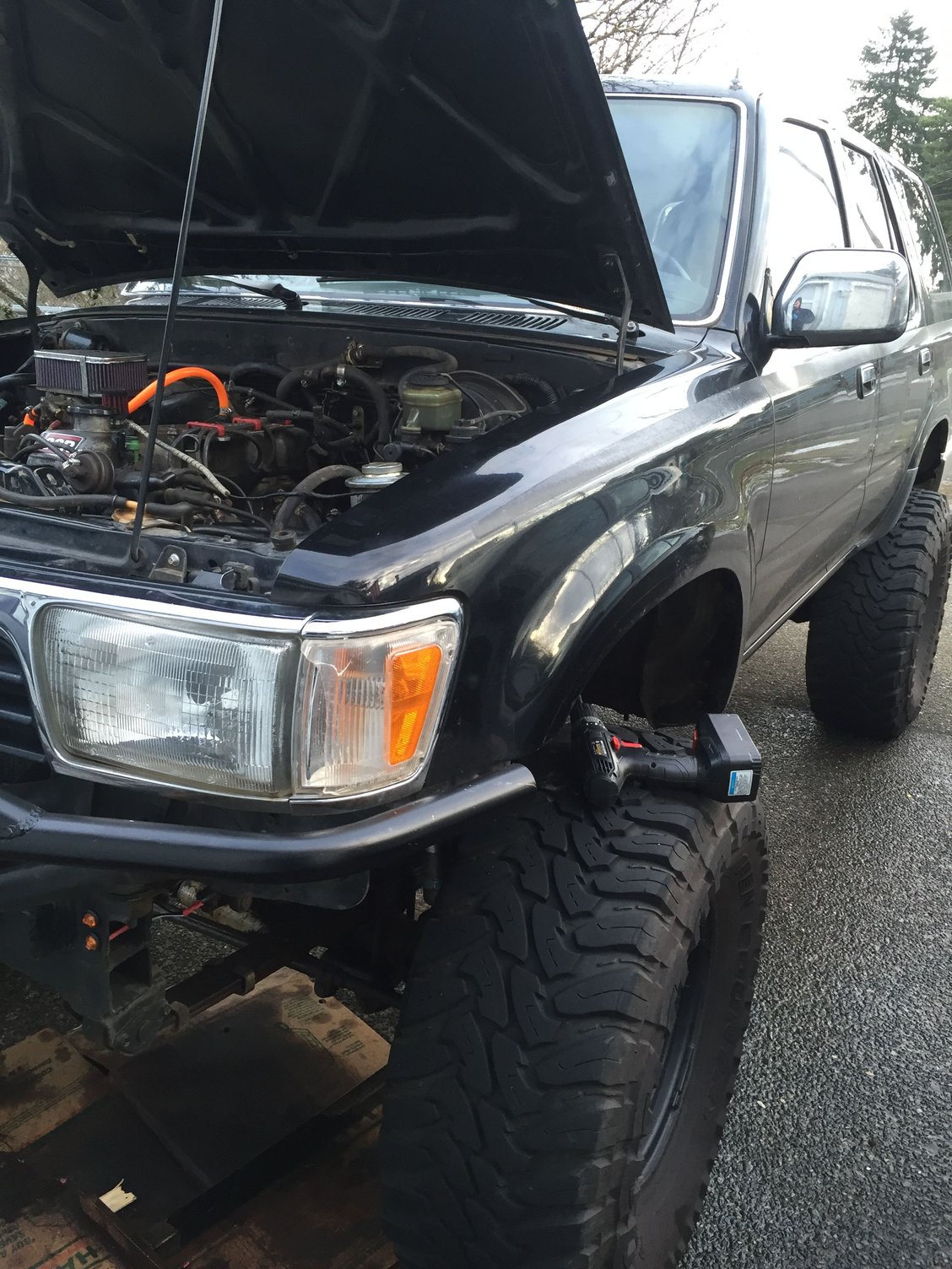

After the new radiator was installed I decide to replace some old parts.
I replaced my corners with clear ones, because the previous corners were broken and filled up with water. I bought these off eBay for cheap and must say the quality is there.
Then I replaced the old B&M t-handle shift knob, and transfer case knob for new round ones. White for the transmission and a grey one for the t-case. Not sure why, but I like this simple mod a lot.
Also cleaned up my engine bay, new gas lines, cleaned up some electrical connections, as well a new airfilter for the Webber.
A little better, always room for progress.
