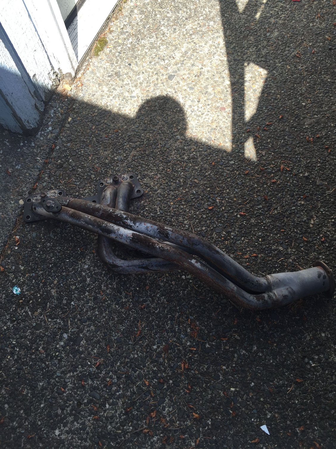

Let's see. First off, driving home last week the header fell off. Then the distributor vacuum advance went out. I tested it with a mightyvac and the manifold advance was toast.
Most likely where all of my idle and acceleration woes came from.
I removed my header from the exhaust and sent it to be ceramic coated yesterday; Oregon Powder Coaters got the job. Purchased a brand new distributor, $60 for new Vac advance or $100 for a new one off amazon.

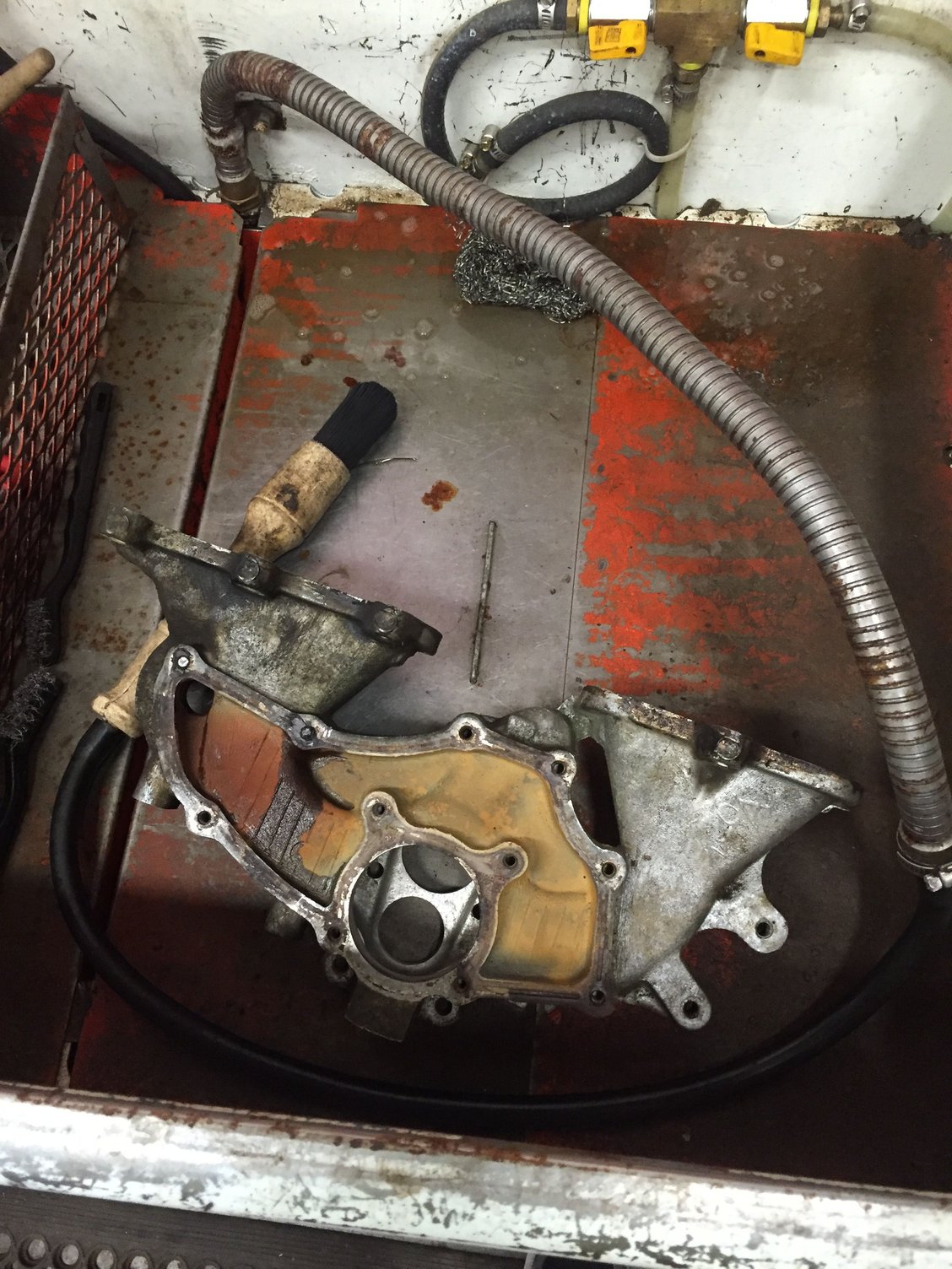

Decided to remove my intake manifold and valve cover to send in for PC. Purchased more block off plates from LCE, unfortunately I snapped 2 bolt heads off. Hopefully I can find a machine shop to extract them for me.
I guess I will be purchasing a new timing cover kit and new head gasket. I figured I'm half-way there with the header and I take off the motor, and save myself the peace of mind.

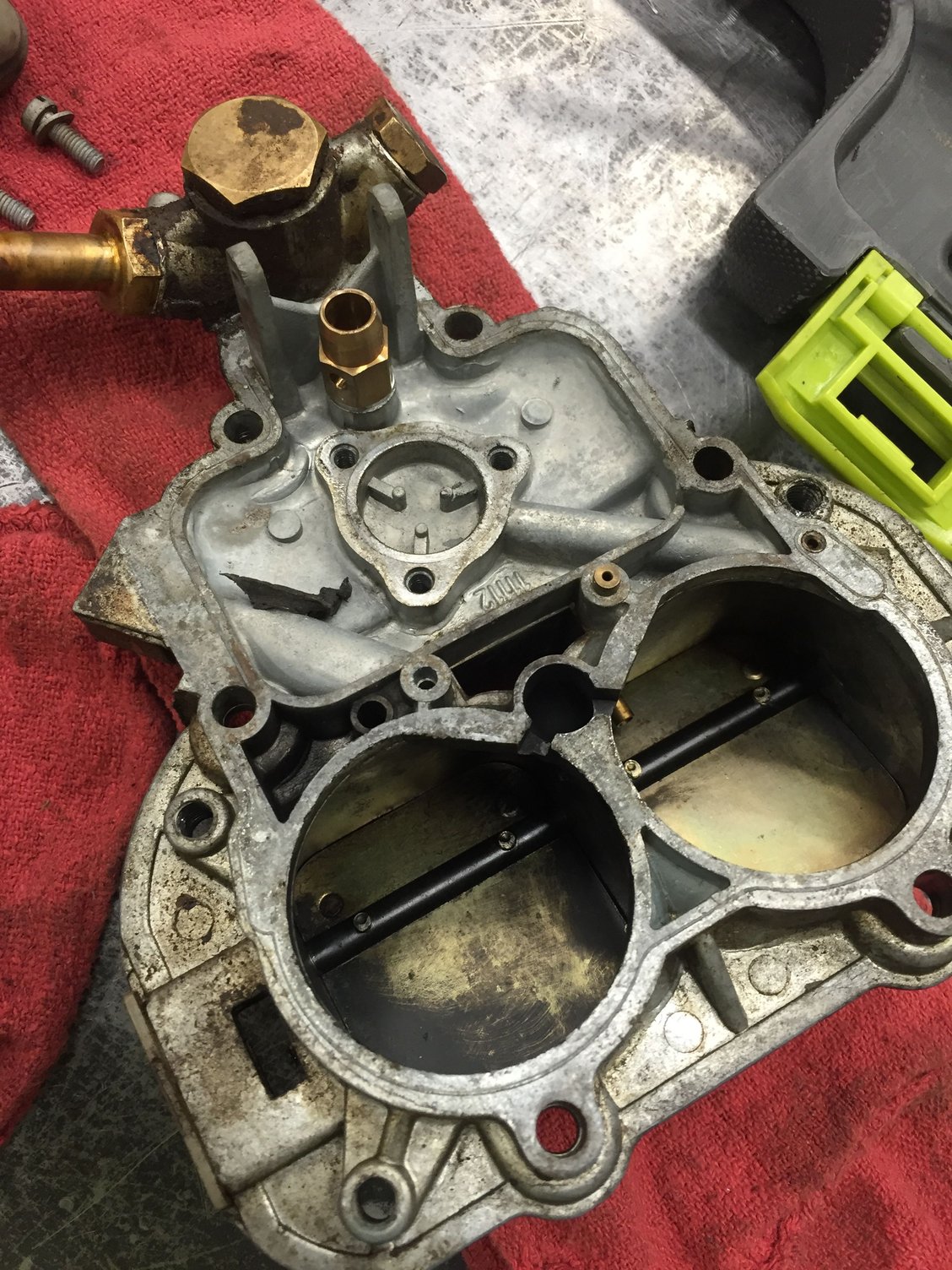

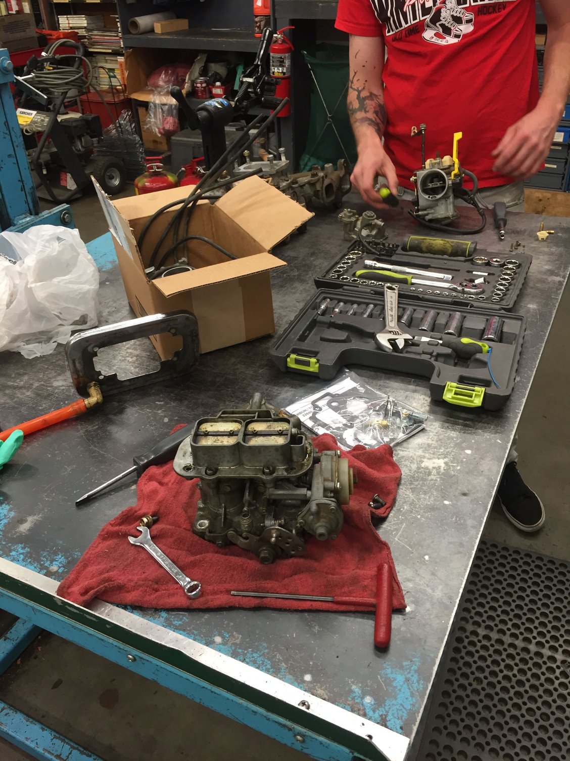

I found my model number on the carb after the sonic clean. It's a "DGAV" with electronic choke? Possible the PO put the Electric choke on it?
New plate! The quality of LCE's parts are amazing.
Went to my buddy's work and we both did some major carburetor overhauling.

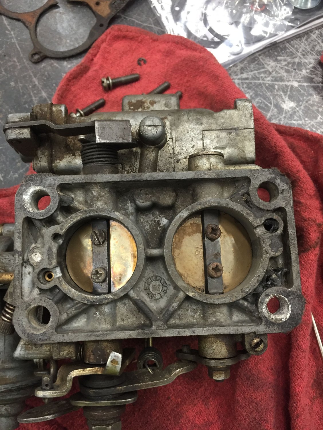

Many mismatched screws some even the wrong thread.
On the right you can see the PO used black RTV for a gasket. Nearly all of the jets were clogged with RTV....SMDH
I want to do the Weber mod, but need some JB weld, will be doing it this weekend.
Removing EGR plugs...
Plugs pile
Solvent bath

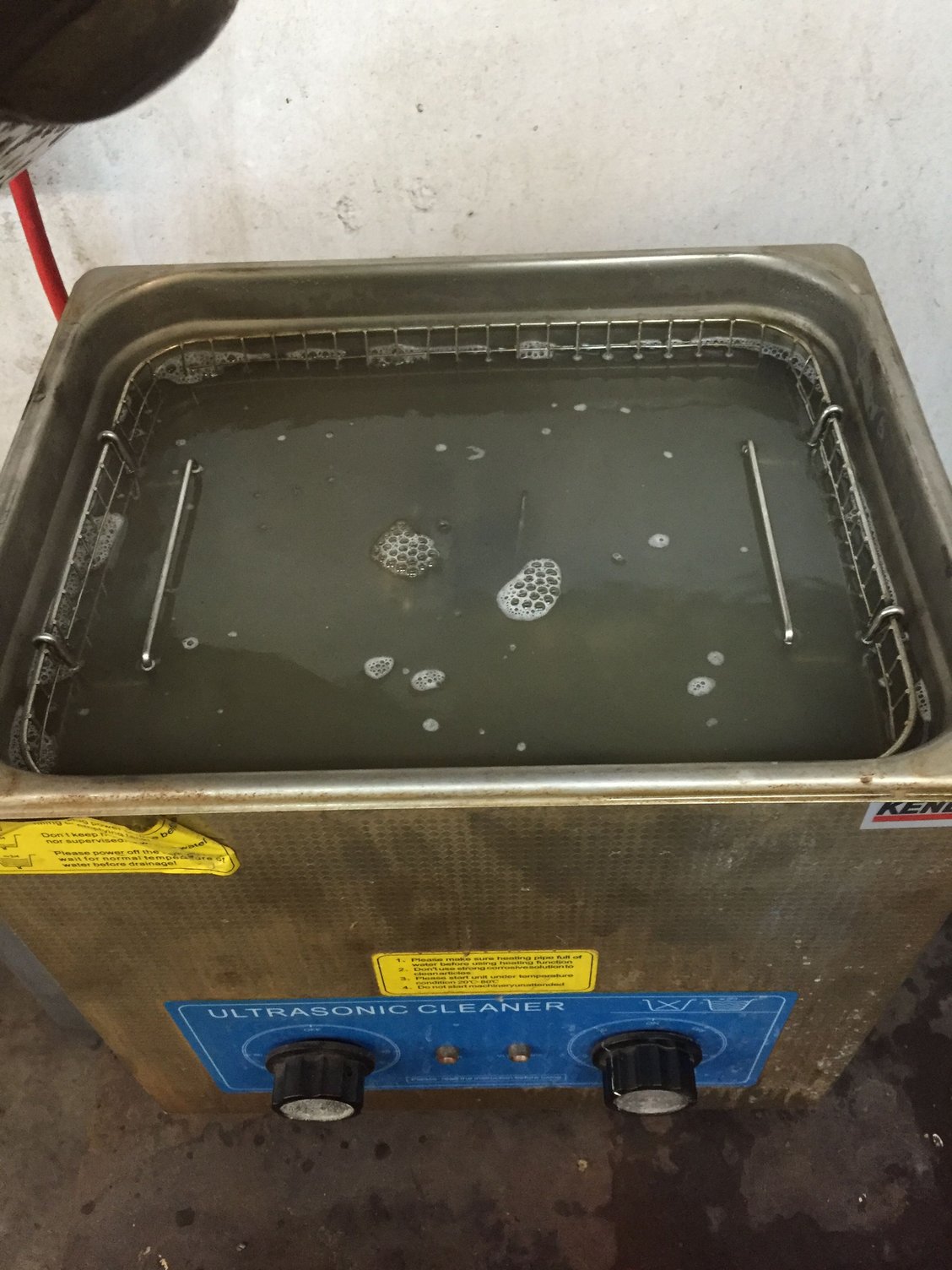

Sonic cleaning the carburetor
Replaced all my flathead screws with allen heads. We do this to all our carbs, less chance of stripping them.

Is that a special solvent in the sonic cleaner?

Thank you! Actually it's just extremely hot water, not sure what the temperature gets inside the tank, and LemonJoy dish soap.

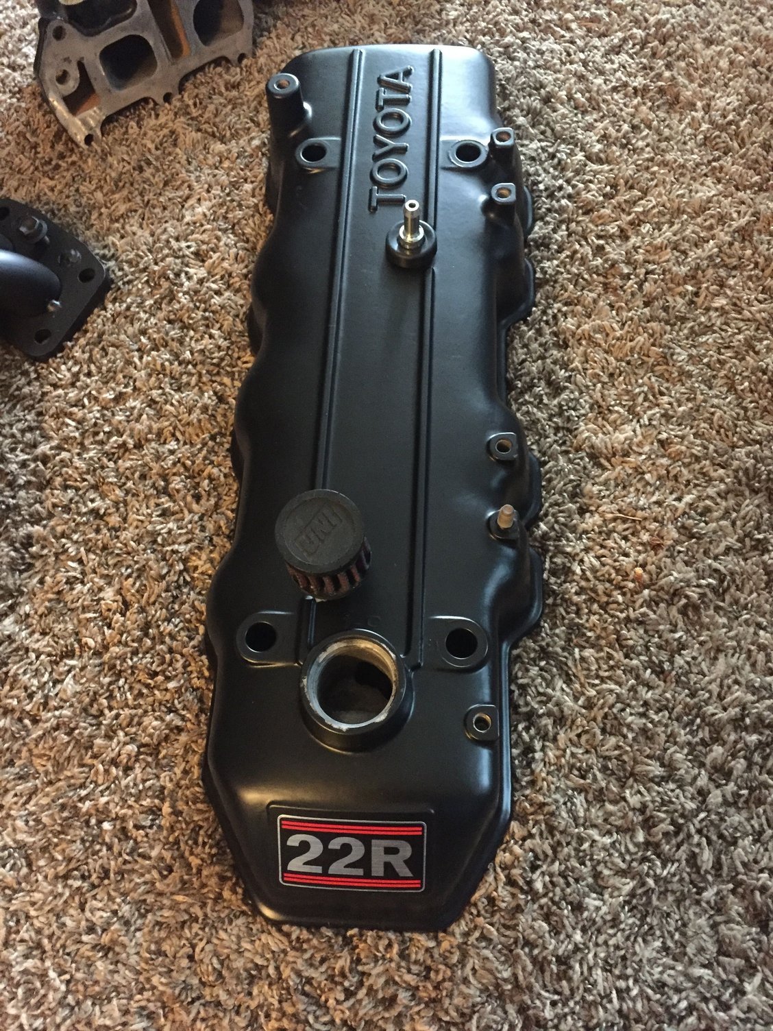

Pulled the dizzy, removing the carburetor today; Weber mod and rebuild. Painting the valve cover, just purchased the delete plate from LCE for the Intake manifold.

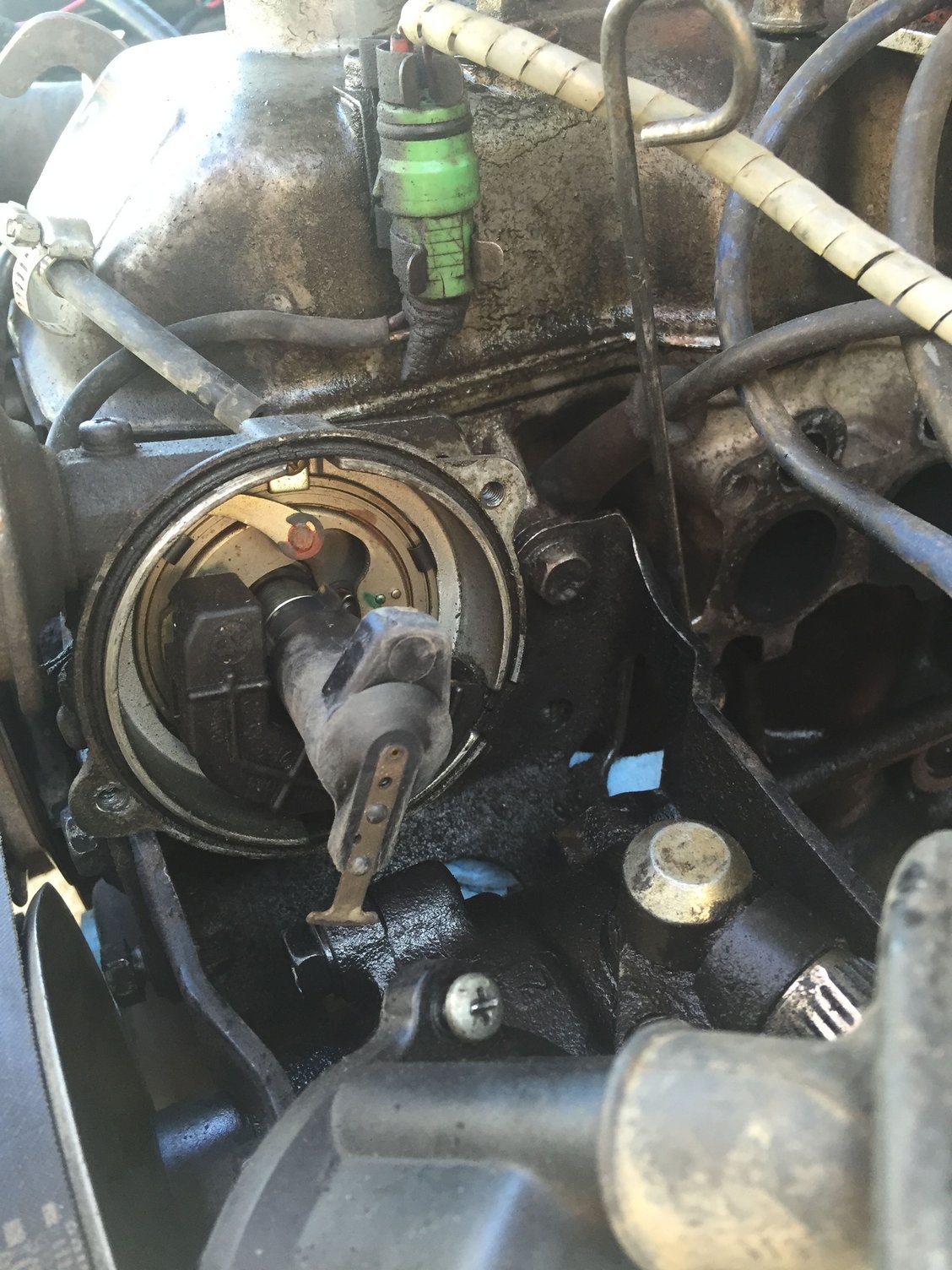

Bad dizzy. Vacuum advance is toast and the plates are rusty.

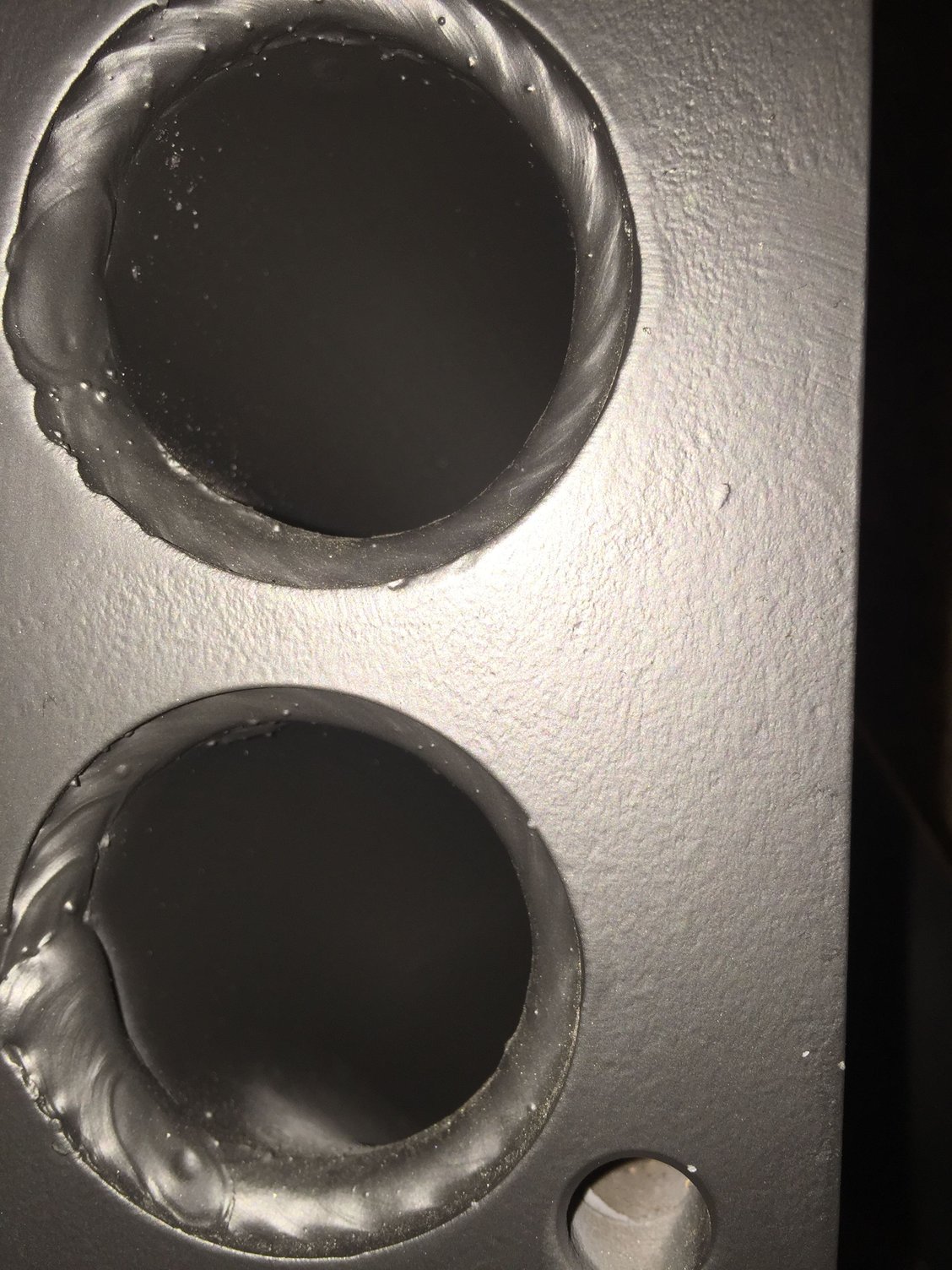

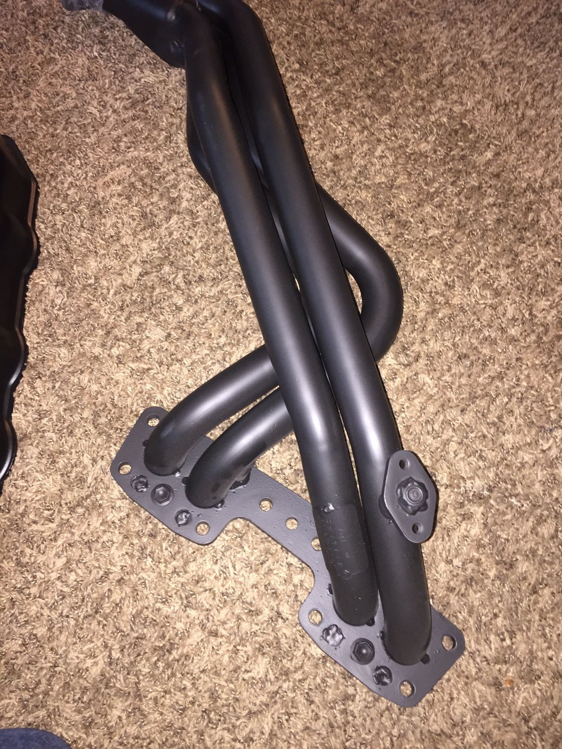

Parts back from the coaters. All parts were sand blasted and coated with "Cerakote V-171 Turbine coat"
The heads off too, going to replace the head gasket, oil pan and rear main seal.
Does anyone have a link to the FSM for an 1984 Toyota pickup?
<br > <br > <br > <br > Had to do some welding on the flanges before the coating. Both sides leaked badly, pacesetter...<br ><br > <br > <br >
