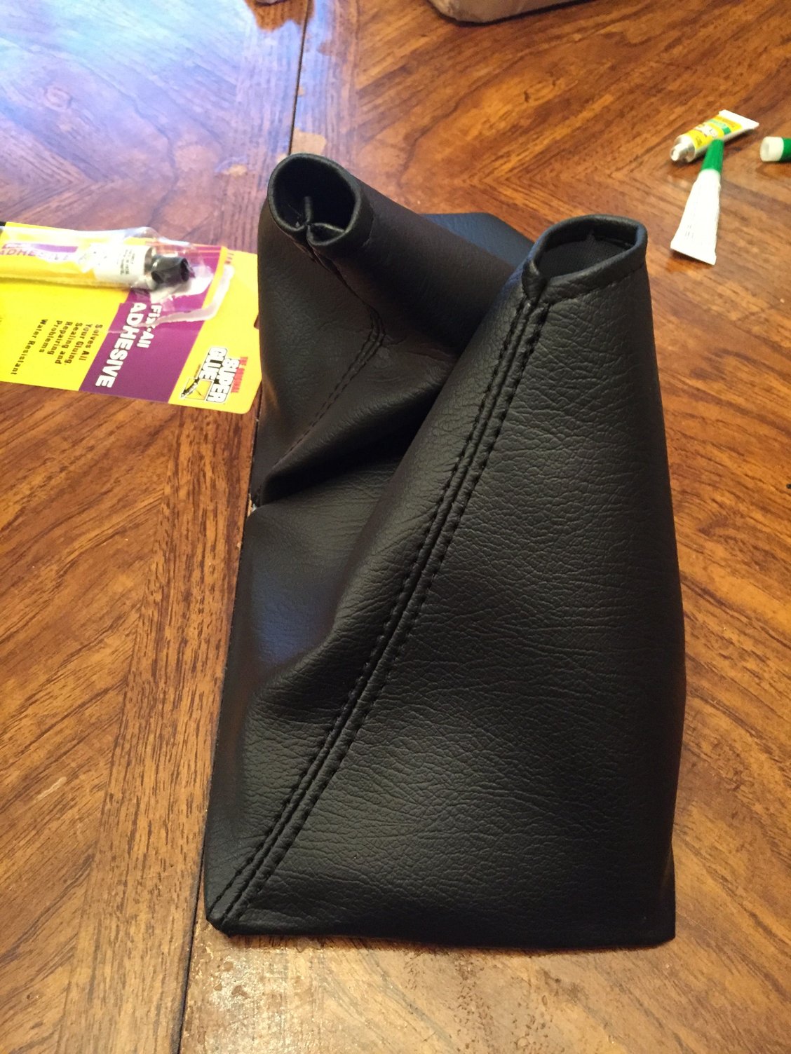

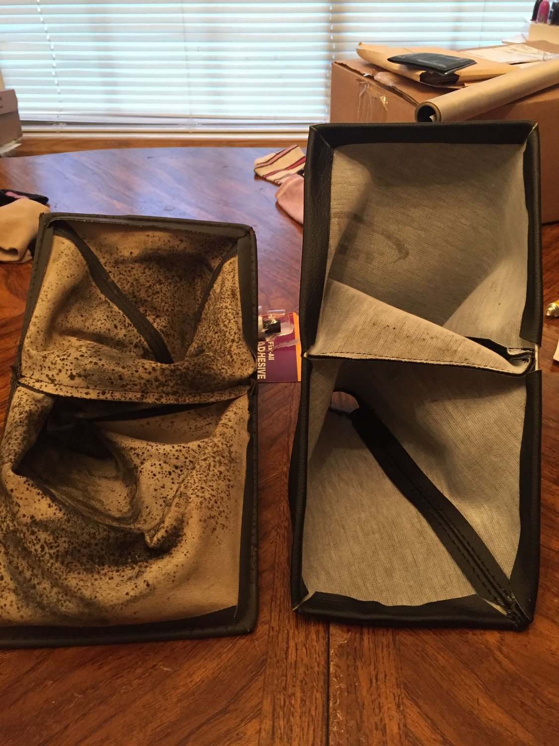

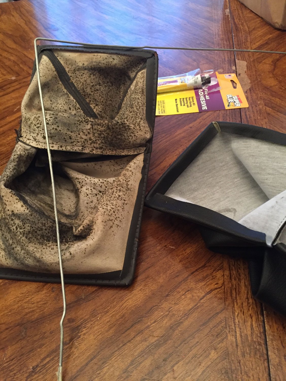

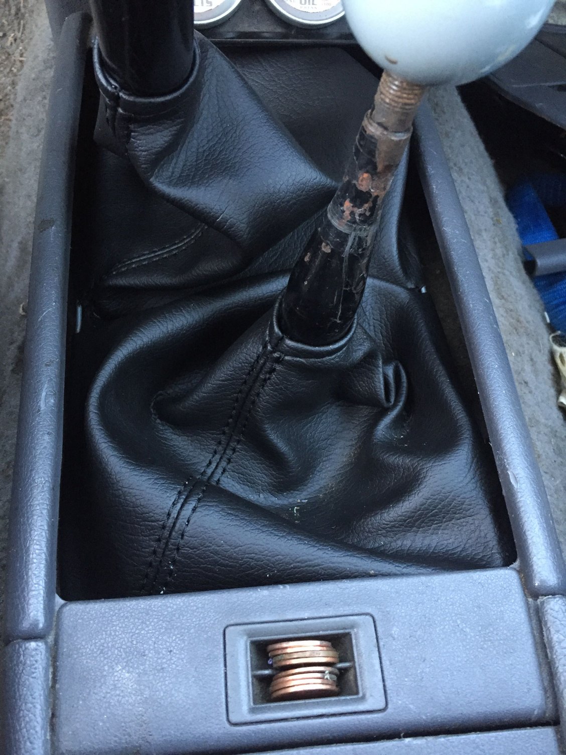

I did today manage to remedy the old shift boot situation and a local u-pull-it had the rubber boots I needed, to keep from fumigating from in the cab.

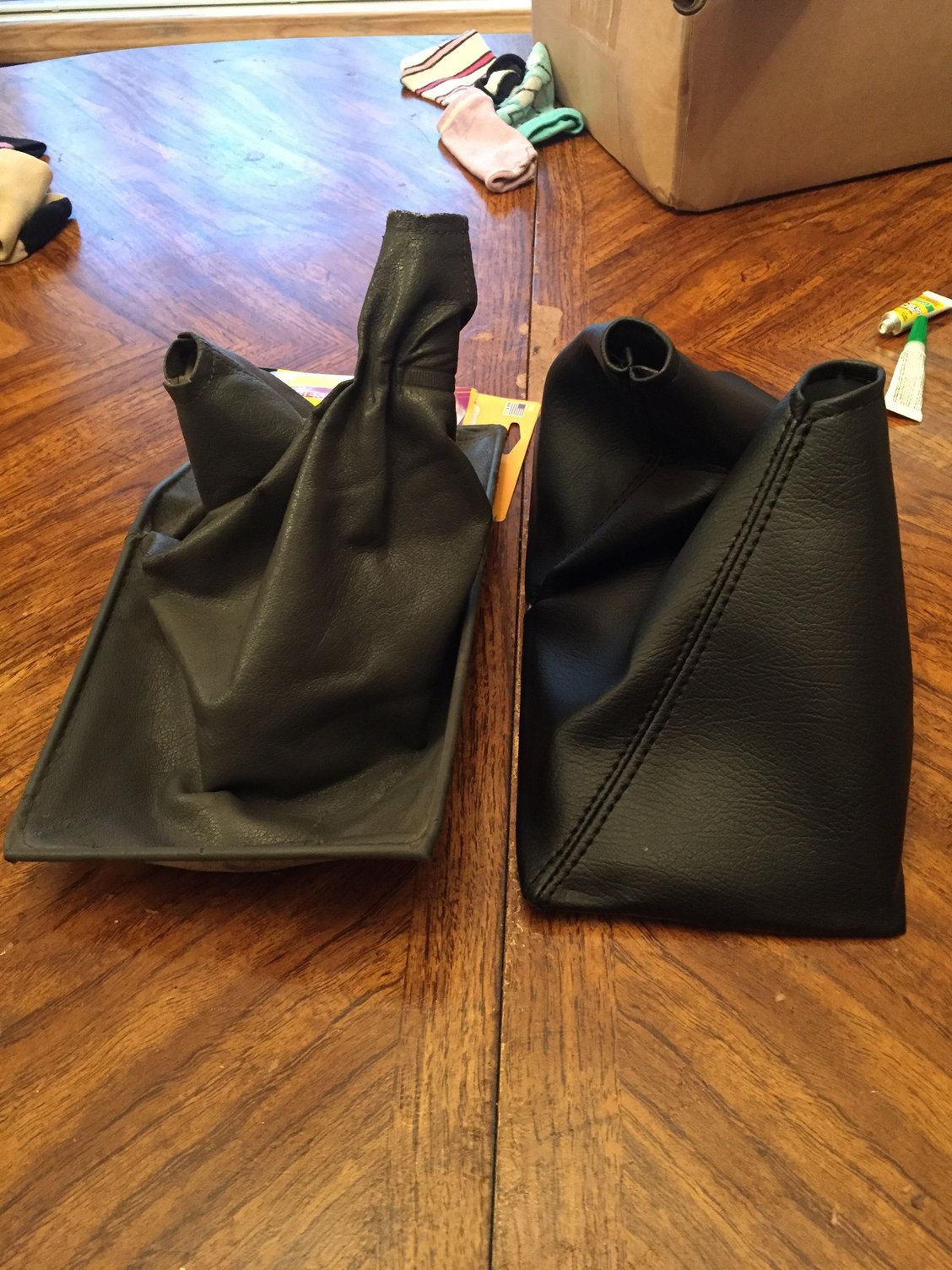

I ordered this cheapo eBay vinyl boot. Even ordered the "wide 11.5" version. No! Fitment wasn't even close, no worries it was very cheap. After about 5 minutes of looking at the poor quality of how they glued the ends to the metal frame. I was able to mod it to fit.
Here is what I had to do.
Cheap eBay boot
Old vs new
Left you can see is much wider than the new one
Removed the frame of the new one and bent it into a new rectangle, luckily the original had about 2" extra of metal to do this.<br/>
Voila

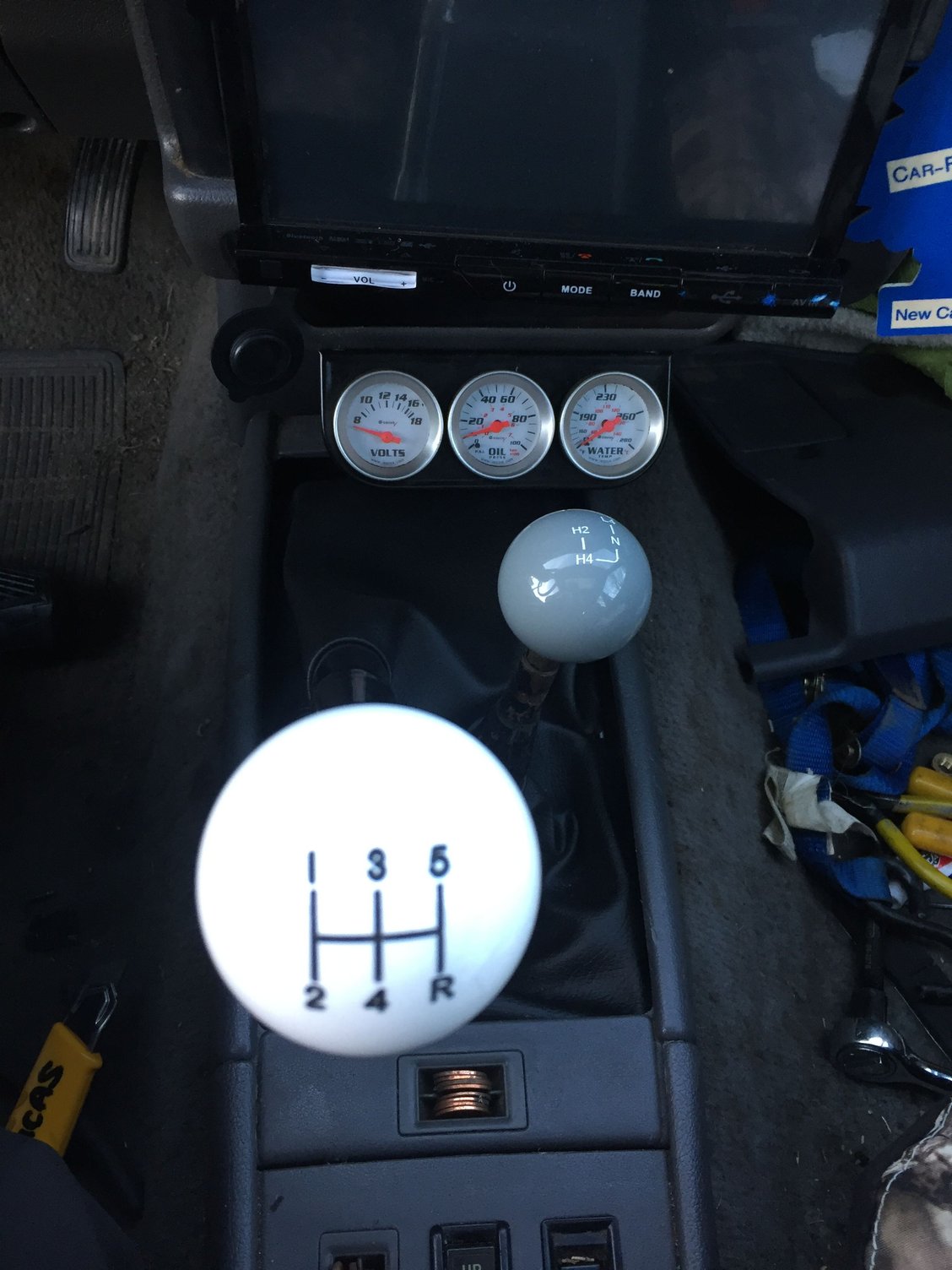

Nice work making the boot fit. I like the white shifter knobs and white face gauges, gives it that classic muscle car look!
Old Feb 21, 2016 | 12:51 PM
  #26
BlackStone's Avatar
Joined: Dec 2015
Posts: 84
From: Portland
Thanks rustED. I've always been fond of the old white shifter knobs. The white gauges actually did come from my fathers 70' Chevelle SS. He liked them for all of 20 minutes and decided to go back to Black gauges LOL.

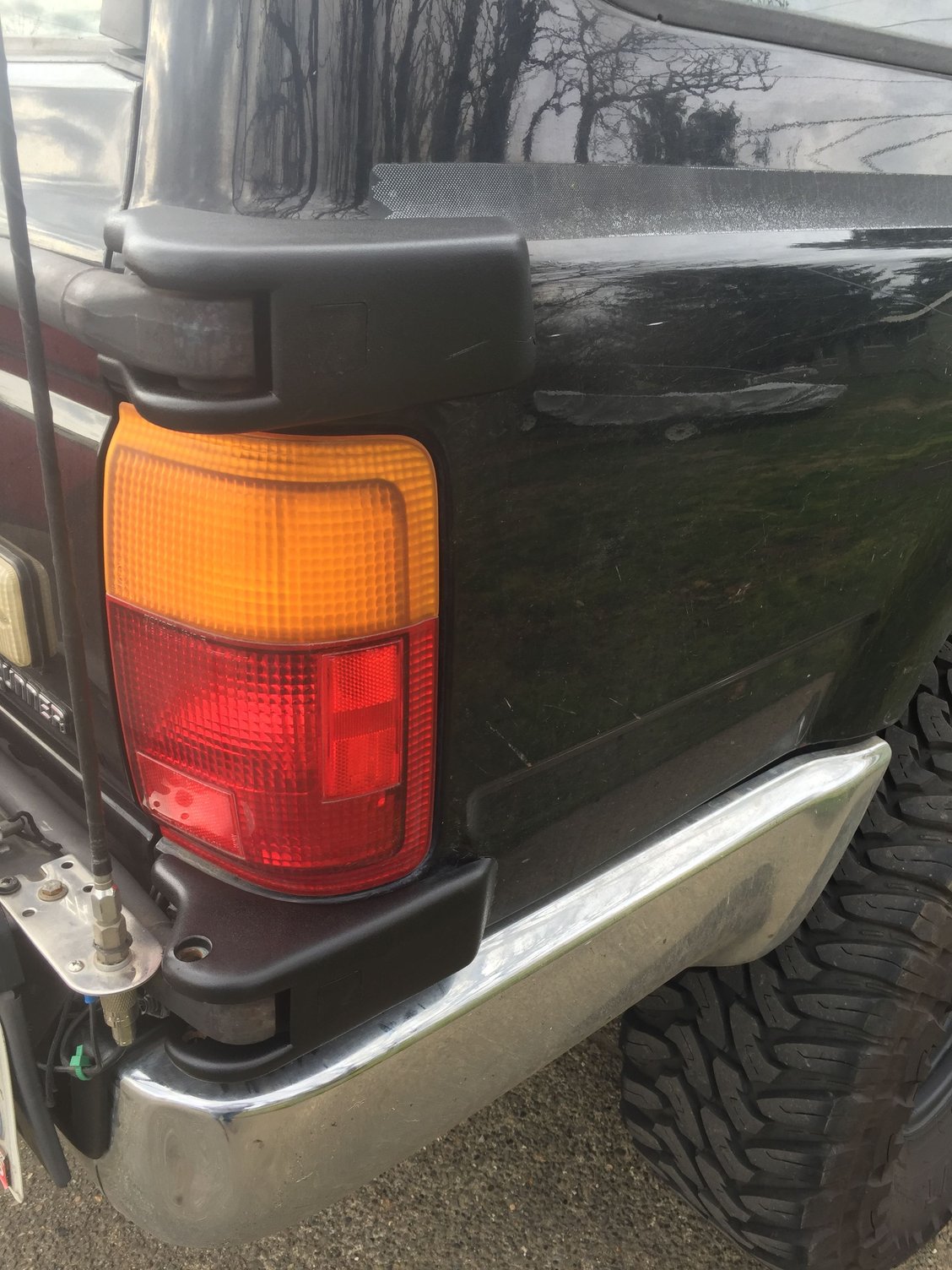

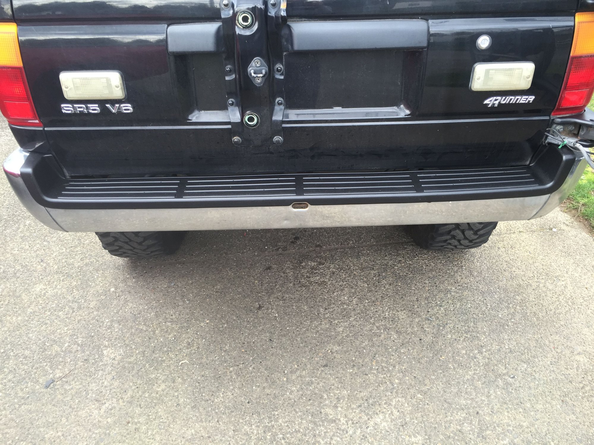

Since I really like simple mods, with zero motivation today and some sun. I decided to take a walk around the rig and see what I could do. At the rear,
I found the ugly faded gray bumper rubber and corners of the tire carrier.
I walked back into the garage, grabbed a can of Rusto bed-liner and hit the parts with it. Unfortunately I forgot to take a "before" picture.
I wish I had a before picture, but I am sure yourself know very well, what it looks like and how ugly it is.
Next I will do the tire carrier in satin black(my favorite). 😋

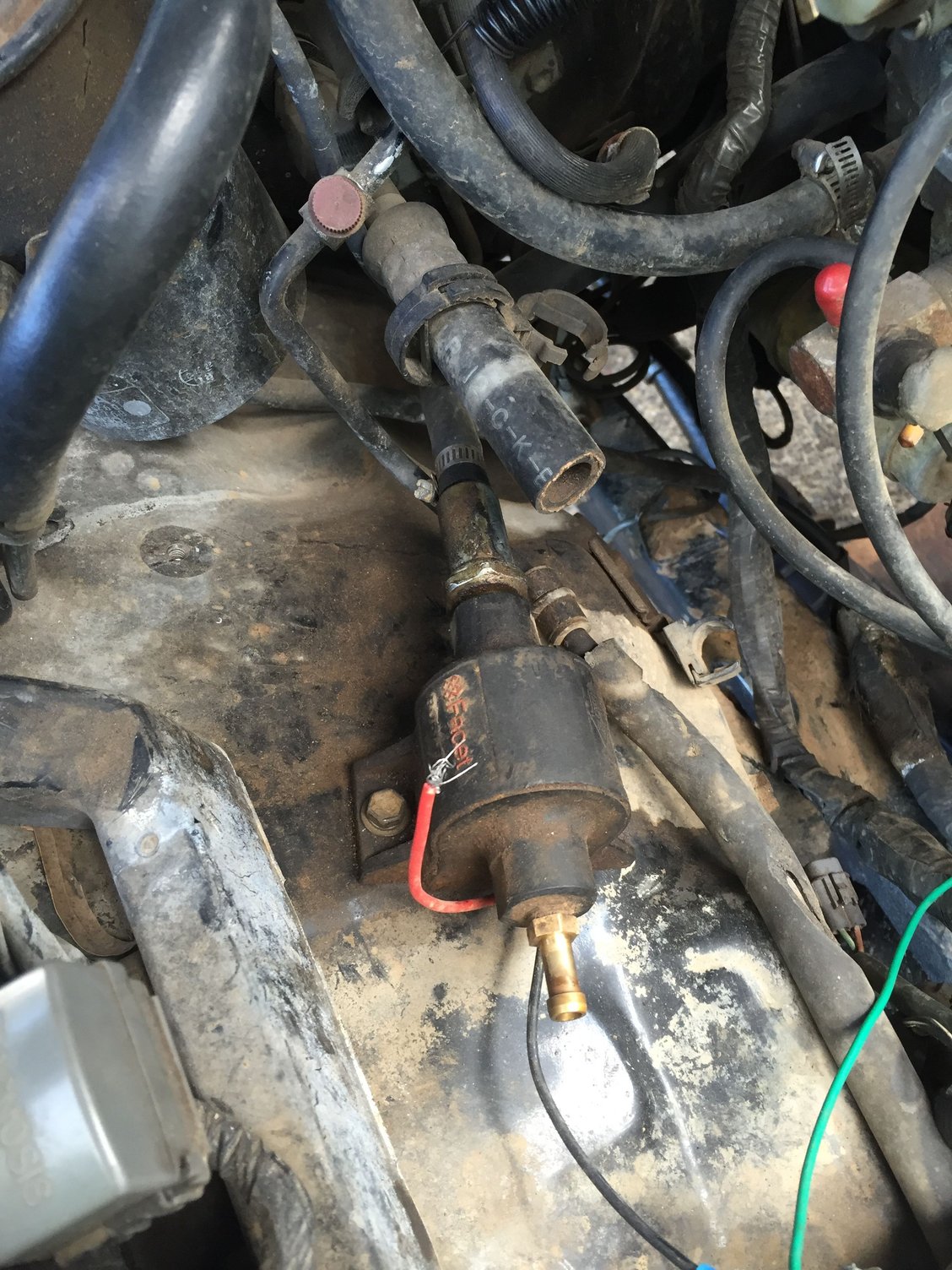

Just been Daily driving the rig lately. Parts gathering is going on now, u til recently.

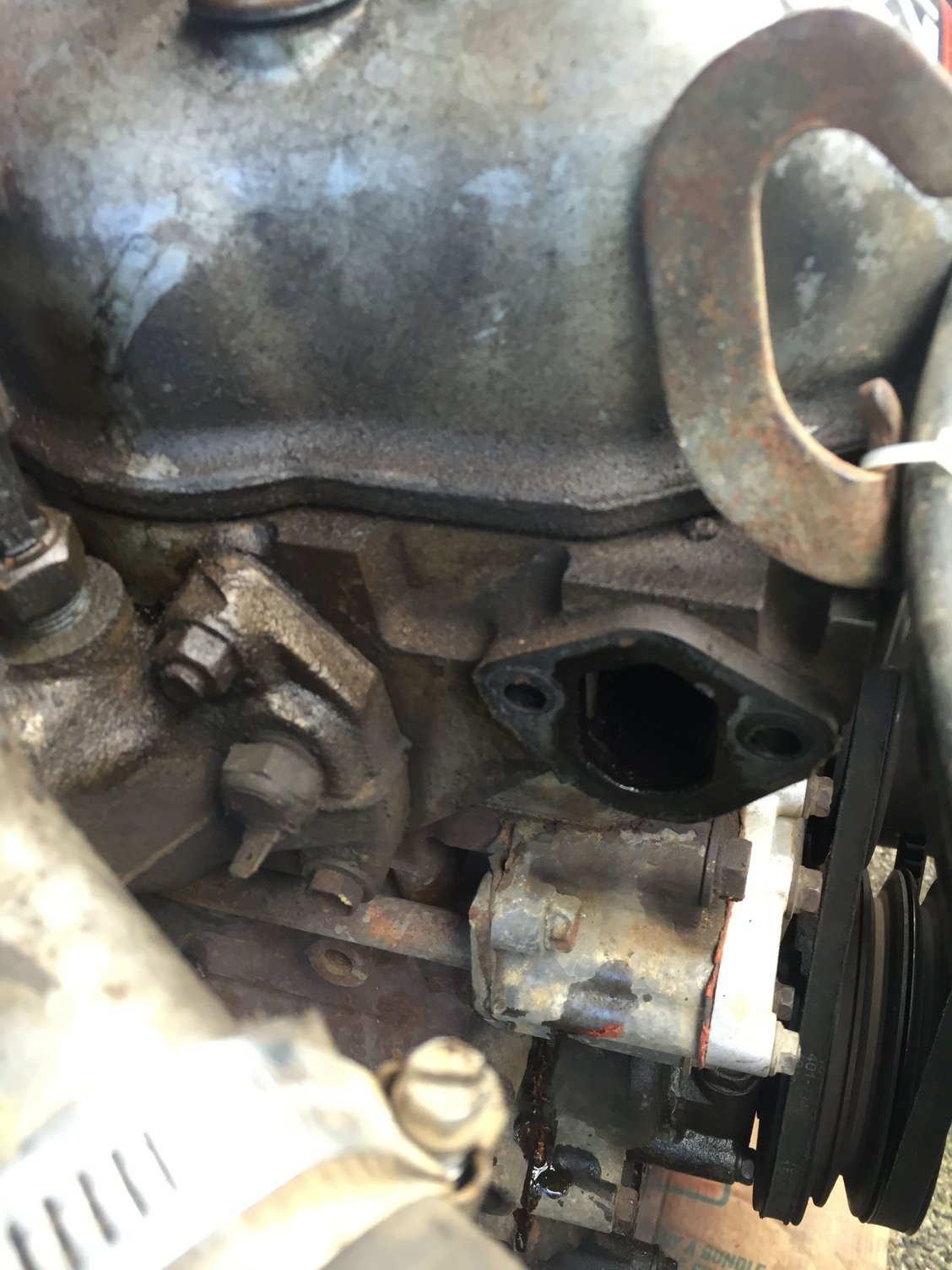

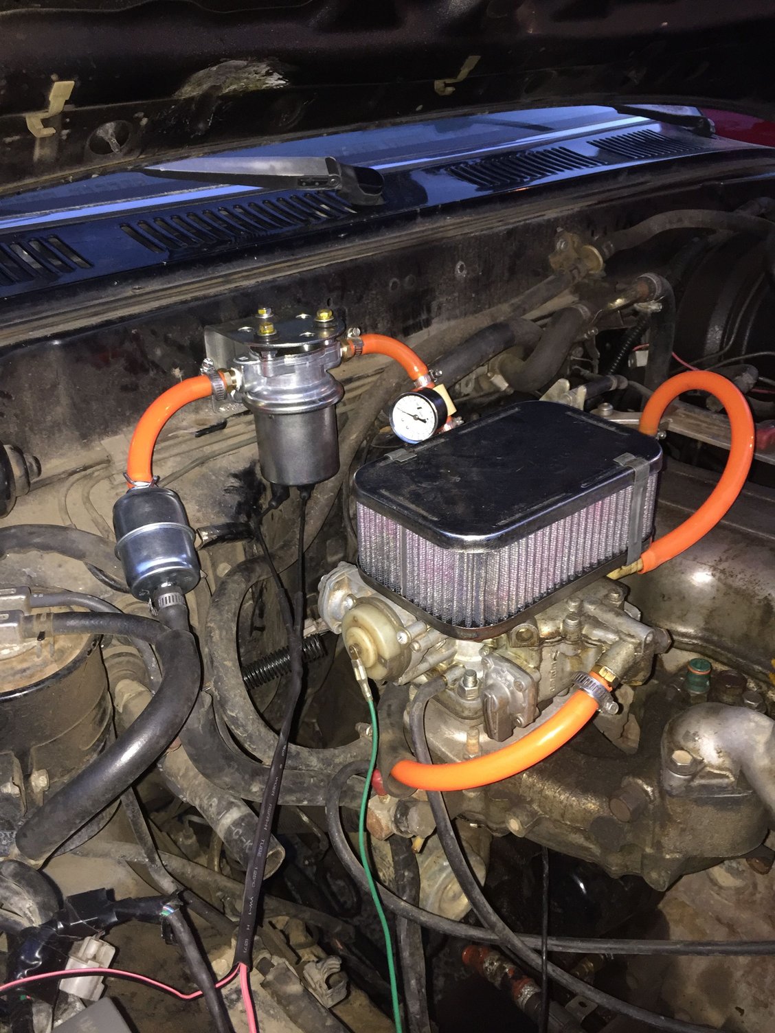

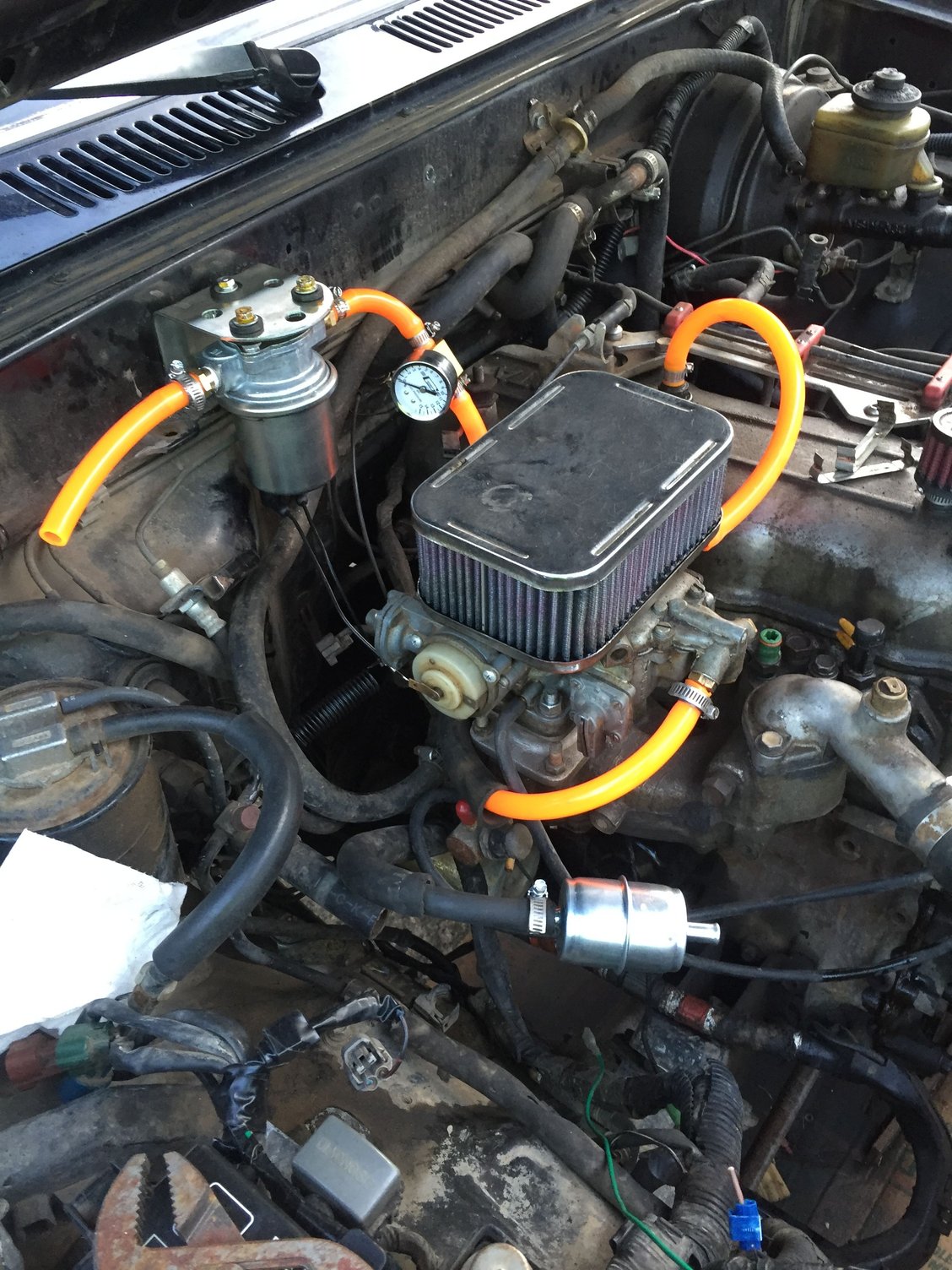

The POS facet pump went out, no surprise. Ordered a new Carter 4070, FPG w/ Filter.
Old set-up

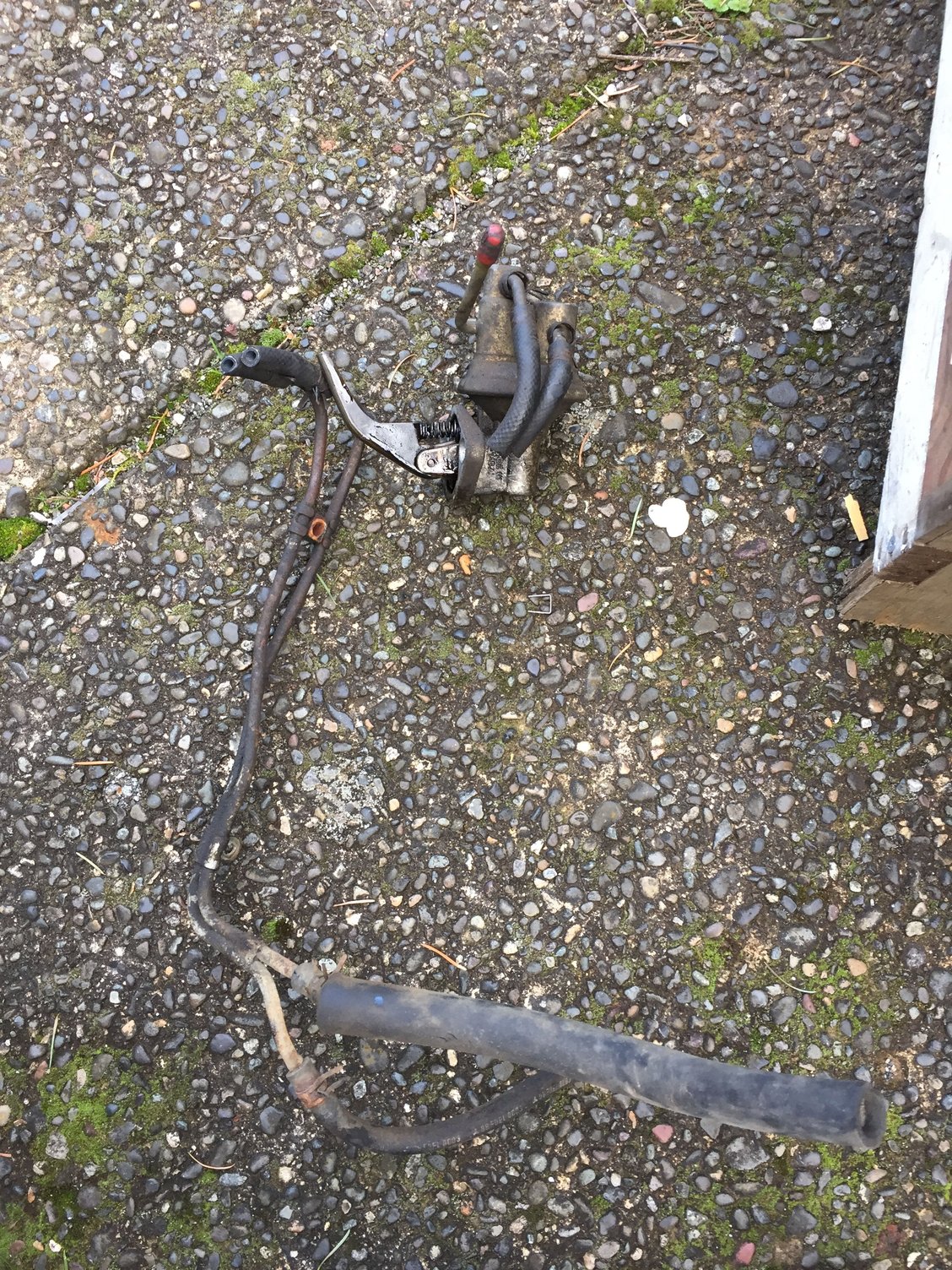

Also this was still hooked up, probably why I could never get the stumble to go away...
Deleted this
Facet crap pump, I don't recommend his to anyone
Old Mar 25, 2016 | 08:04 PM
  #32
BlackStone's Avatar
Joined: Dec 2015
Posts: 84
From: Portland

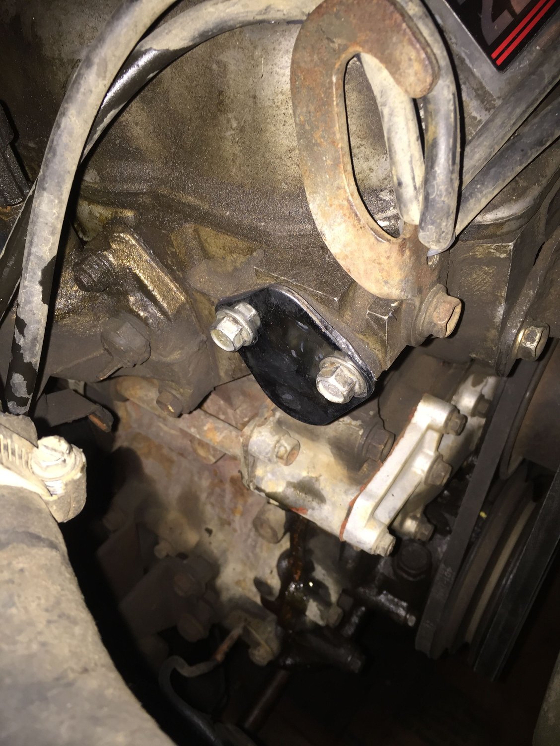

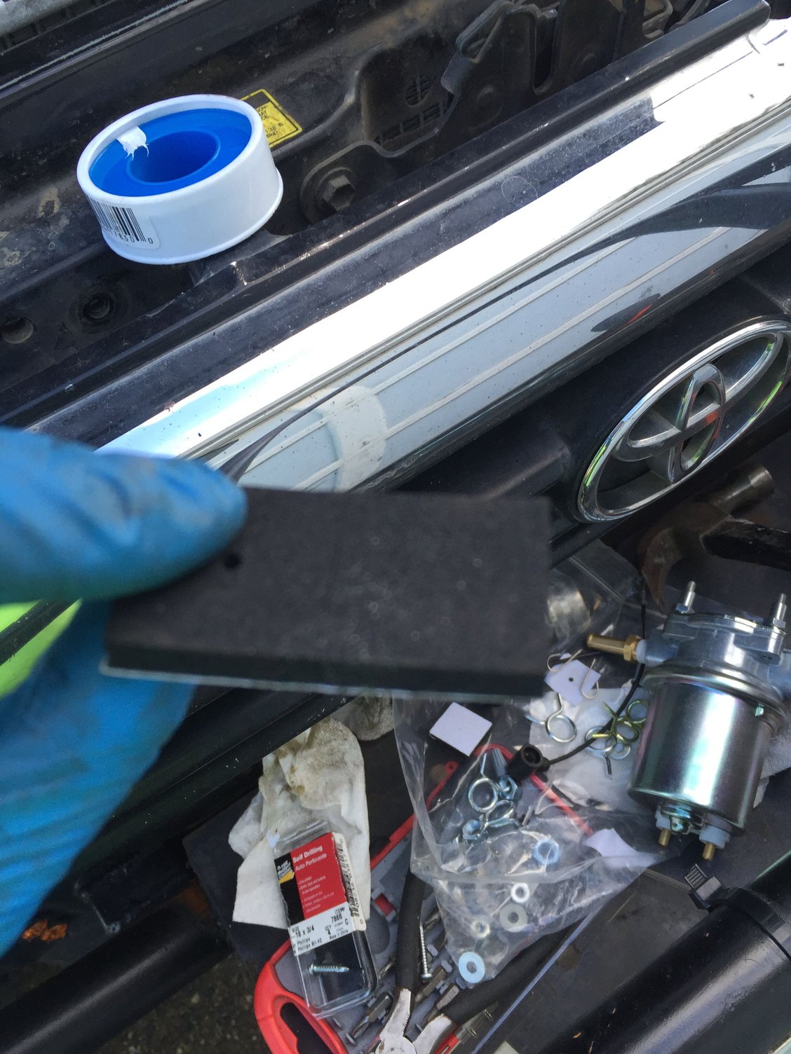

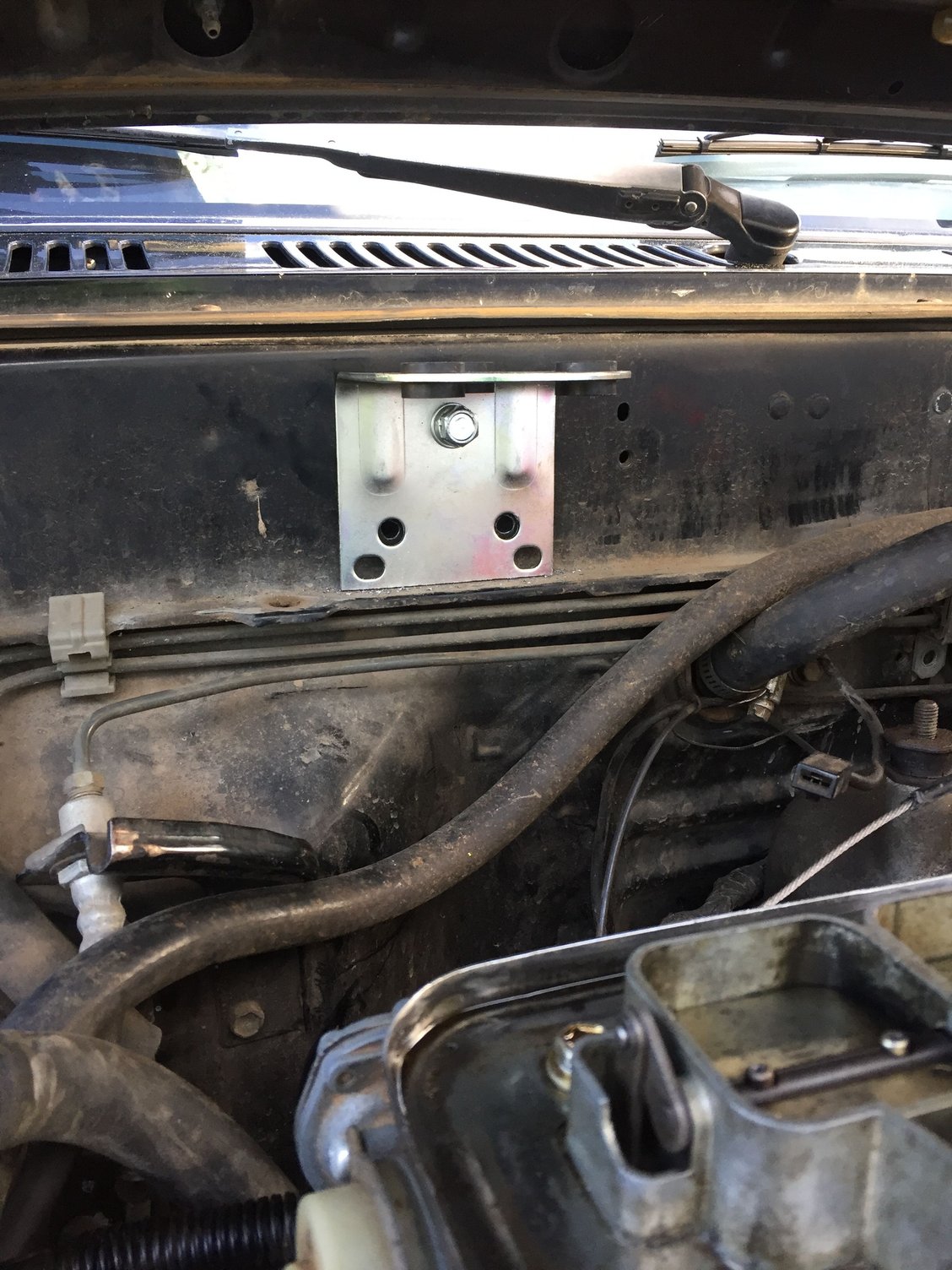

I used this on the back of the bracket to keep vibrations down

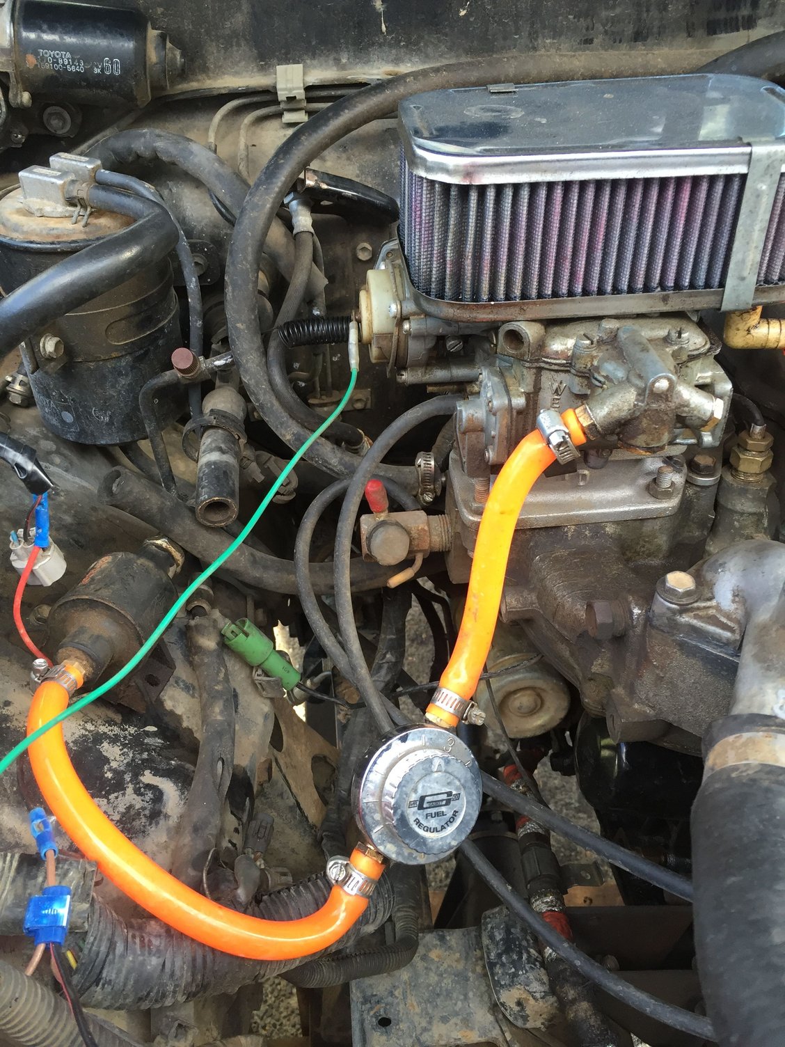

Plumbed and almost read to turn over!
This pump is noisy! Sounds like a tiny helicopter under the hood. Not Pictured, I cut a piece of dynamat and placed it onto the body of the pump. It dramatically reduced the noise!
As well, this is a V8 mr.gasket fuel pump block off plate, works perfectly.
Video of the pump, running. No Regulator necessary, it's like driving a new truck! Throttle response and power now.

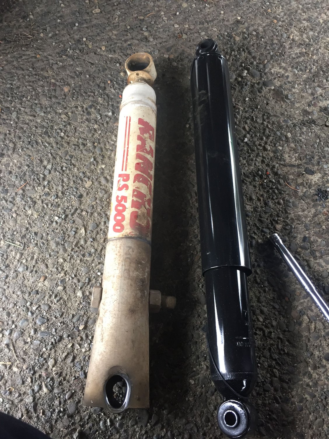

Installed new shocks today! Got a late start, but damn! What a difference. LOL. Anything was better than that garbage! Went from shopping cart ride to, a tolerable ride. Actually quite nice ride now with the cheapys surprisingly.
I went with Cheap shocks from Autozone, Gabriel 61656 for a 2001 Ford F-250 V8. $24.99 ea. Flex nice and a great ride, reduced body roll as well.
Specs: 31.5" extended
18.5" collapsed
13" stroke
Only problem was using the bushing from my old totaled Ranchos because the bottom eyelets Bushing was not 5/8".
Old set-up from PO. Home brew extended shock solution, highly; Not recommended! <br/><br/>Sorry wasn't able to take better pictures, started late and started raining on us. So we had to get them installed quick. I'll take pictures in the morning 😁

The Gabriel's are as long as that POS Rancho and extension 😂, collapsed! They travel quite nice. And should be better when my rear leafs get installed.
