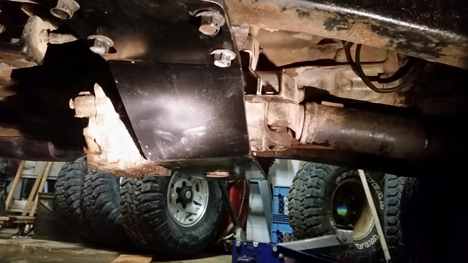

Today I started and mostly managed to get just about finished with the tranny swap. All that I have left to do is cover the hole for the shifters and figure out how to make the 4wd indicator and reverse light switches work. This is a w56 tranny and a gear driven transfer case out of an 86 4runner. I rebuilt the case adding 4.7 gears and a twin stick shifter. I also was able to install all of the budbuilt crossmember and skid plate using a sky's offroad transfer case mount.

Here is some pictures of the crossmember and skid plate, along with the Sky's Off Road heavy duty transfer case mount.
