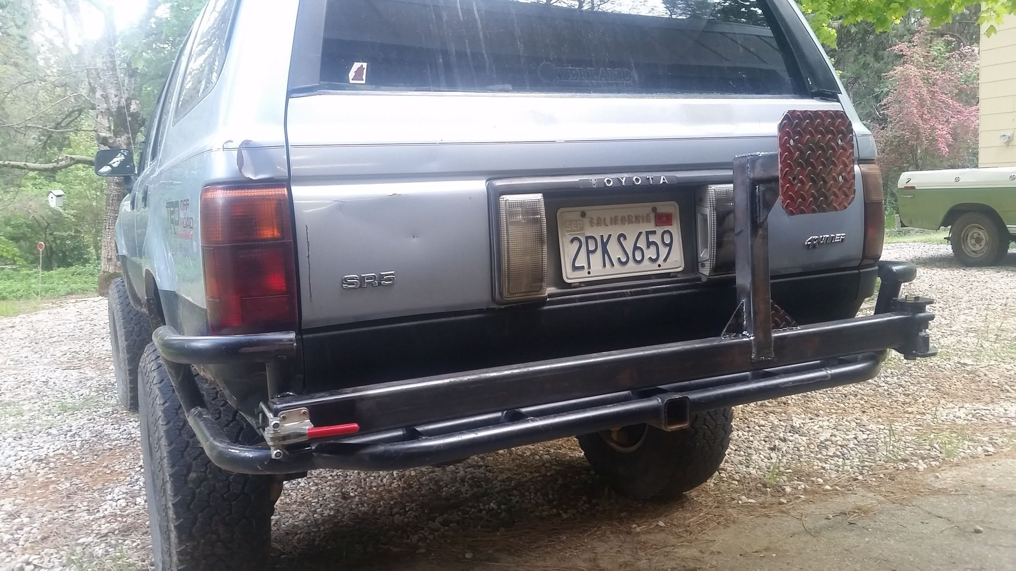

I'm in the process of building a spare tire carrier on a swing out off of the rear Trail Gear bumper. My plan is to keep it fairly light and simple. I would like to have a spare tire, a hi-lift jack, and a rack for a couple gas cans when I'm done. So far, I only have the tire part welded up, but I'll add pictures as I go.
That is a lot of weight to be hanging off that rear bumper.
At least you are going double shear..

From: Sierra Foothills
That's true, but the next phase of the build will include a way to strengthen the bumper attachments to the frame. I'm going to run some metal in from the forward edge of the bumper at least. Once I started working on this I realized how weak the Trail Gear mounts are, so I'll do some thing to fix that. The hinge is a 4xInnovations double shear and the latch is a De Sta Co version, just for the record.
I'm also thinking about adding a second gas tank in where the spare used to live, if I can do that I might forget about the jerry can mounts or just make a cooler mount instead.
