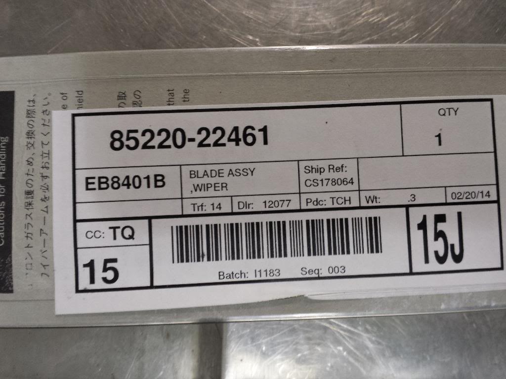

Anyone looking for a 2nd gen. Rear window wiper ....just go to dealership...got mine for 6 bucks. Was going nuts trying to find one in stores. Here is the part number.

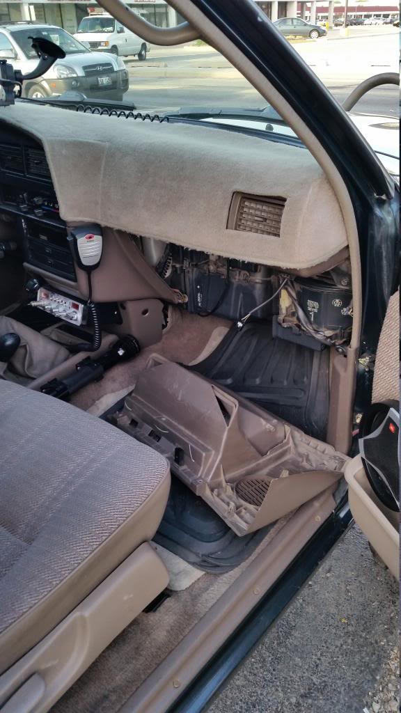

Dang I still haven't snapped any pics of the bumper....been having phone issues. Still no powder coater either....but I did however recharge the ac system. Blows ice cold now I also adjusted the clutch on the compressor using the small adjustment screw behind the glove box...if your ac gets warm at red lights you might try adjusting it with that screw.

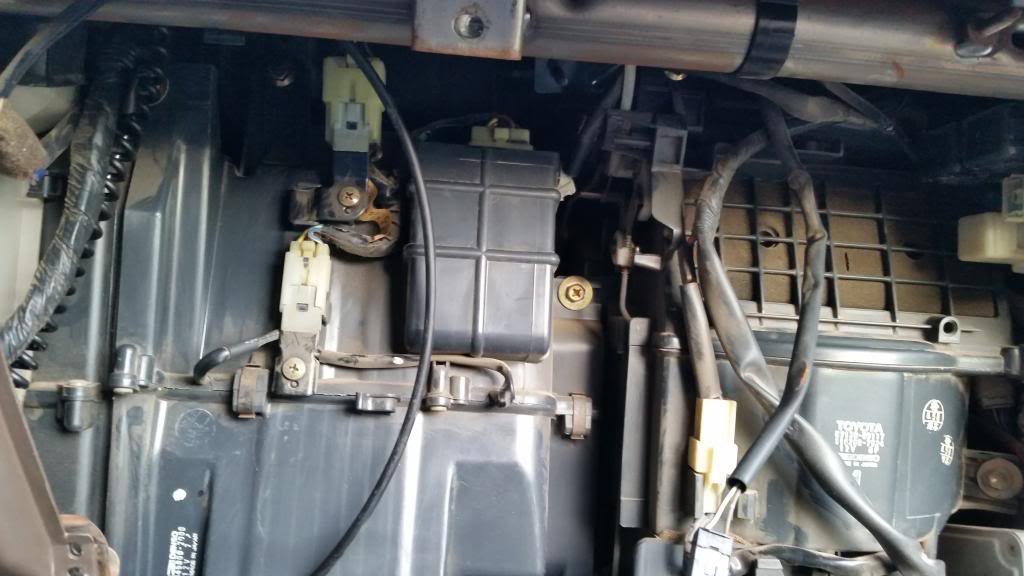

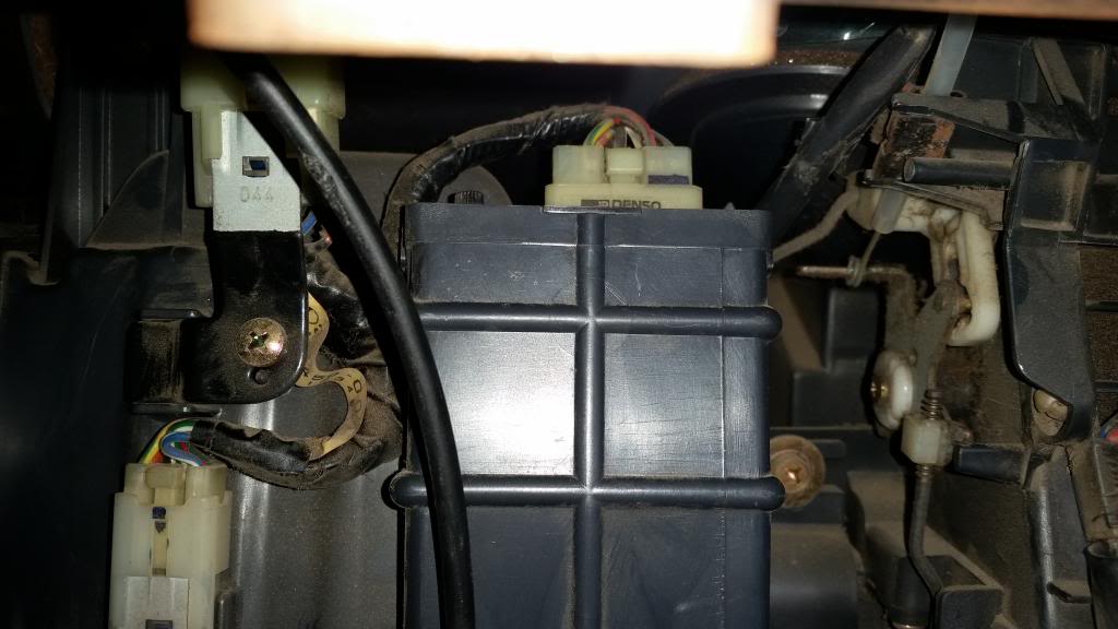

Hmm, not that I think that's the problem with my ac, but got a pic of that screw to adjust the ac clutch? May be good info someday.
The small black plastic nob on the left in the last pic.

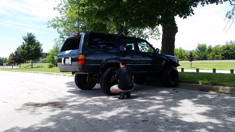

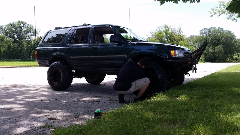

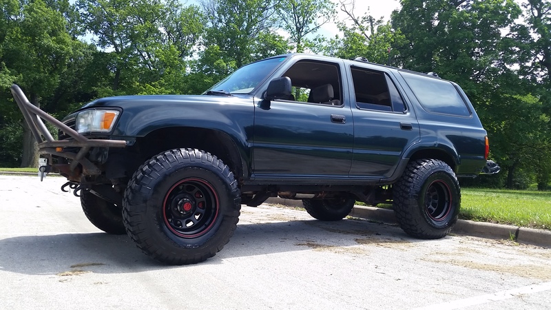

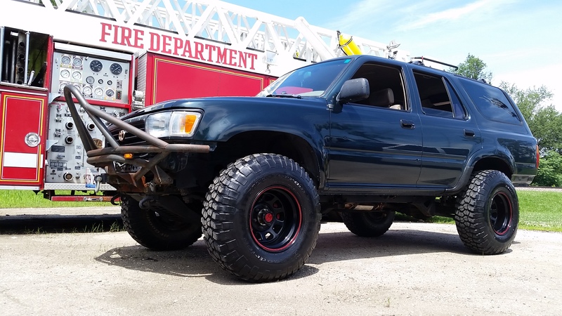

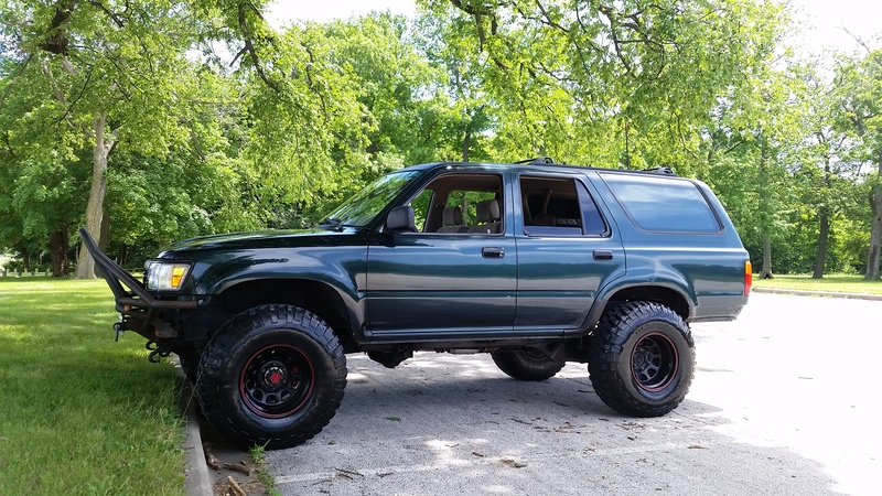

I washed the truck the other day and realized my paint was feeling pretty rough. I decided to clay bar the darn thing finally. Did a good pressure wash first followed by a vigorous clay bar episode. If you have never done clay bar look into it because it makes your paint feel quite smooth. Basically you are using a clay bar lube to allow the clay to glide over the paint easily while not getting dry and as you rub the clay on the paint the bar glides and picks up all the debris that normal washing leaves behind.(such as road tar, oils, and overspray) I would recommend this before doing any type of polishing or waxing for best results. After the clay bar I did a polish and wax. I did not spend too much time because I was doing this in the shop detail area and did not want to take the space up for too long. Again I would have been able to take my time if I had my own work space/garage. I also skipped the compound because not only the time concern but also I'm not too sure how my thin 20 year old clear coat would take to the abrasive compound with the industrial buffer I was using. Here are the results.

There is rust that needs to be addressed sometime soon before it gets worse...
1 more long year to go before I get a work place of my own and this thing gets to sit in a garage and get worked on all year round!
