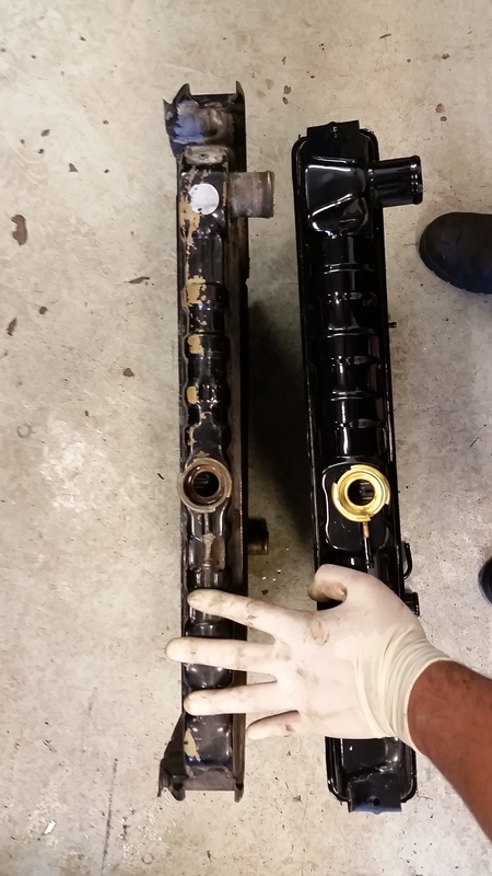

Old radiator vs the new 3 row csf radiator

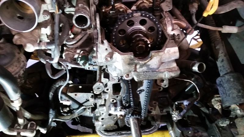

New timing kit on
This is when the new timing cover was on

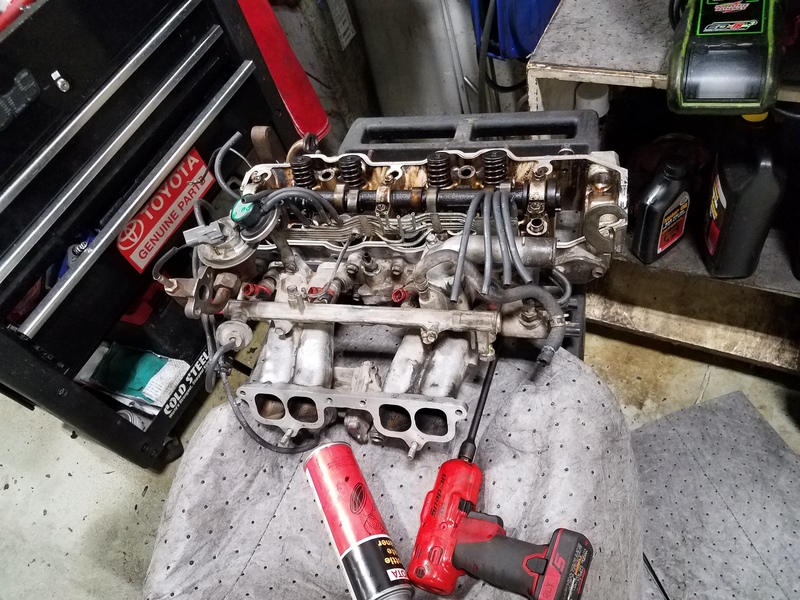

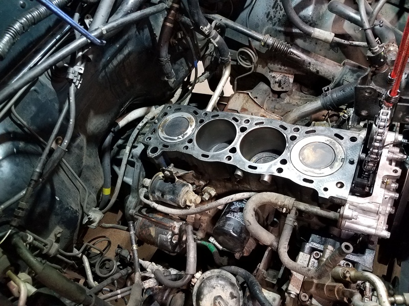

Head off at TDC
The head is pulled off with lower intake attached

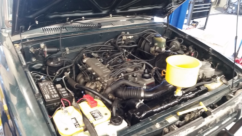

Last things are cold valve adjustment, purge cooling system, hot valve adjustment
