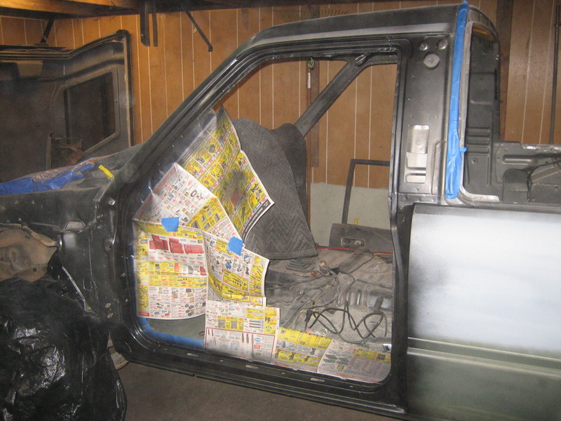

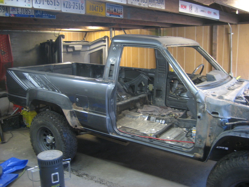

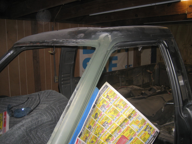

Today I finished the driver's side of the body. I had a few little tidbits to do around the rear wheel arch, the rocker, and the top of the windshield. Well I knocked those all out today.
Self etch primed the door jamb.

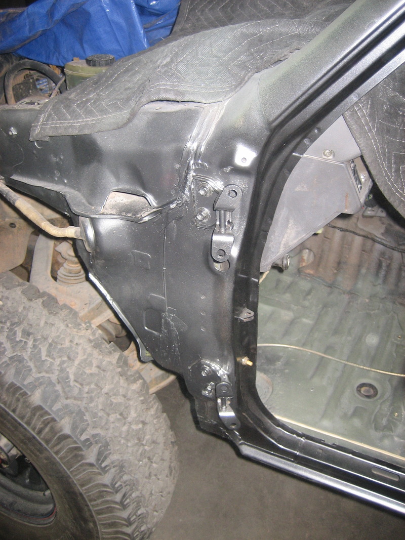

And did the same for the area I repaired at the top of the A-pillar.
And I painted the door jamb. I just used some rattle can paint here. It is not the factory color but it's darn close for parts store paint. Not terribly worried about it. Tomorrow I'll hang the front left fender and driver's door and get them all lined up. Driver's door is already finished and primed. The fender just needs to be stripped and primed.

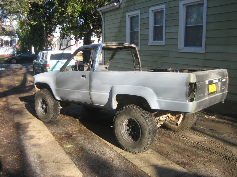

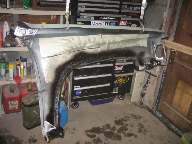

I installed and aligned the driver's door. Also sanded and re-primed the front fender. Since these fenders always collect debris on the lip on the inside I sprayed some rubberized undercoating to hopefully prevent the fender from rusting out at the top of the wheel arch.
Fender cleaned, primed, and undercoated.
Mounted the door and aligned the body side bolts. Removed the door so I could seam seal and paint the hinges.
Once the hinges are painted I reinstalled the door and aligned the door side bolts.
Here's the truck in the driveway. When the sunlight hit it I noticed a couple tiny dents I missed. Door and fender are aligned to each other. The fender might need a bit of adjustment once the hood is installed. I'm just happy to see parts going back on. It feels like a big accomplishment to me.
Took the truck around the block once just to be able to drive it, then backed it into the garage. Time to start the whole process over again on the other side. This side should go a lot faster. Less to fix and I can work a little more efficiently than I could when I first started.

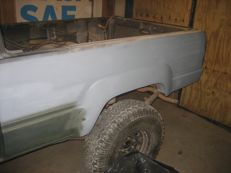

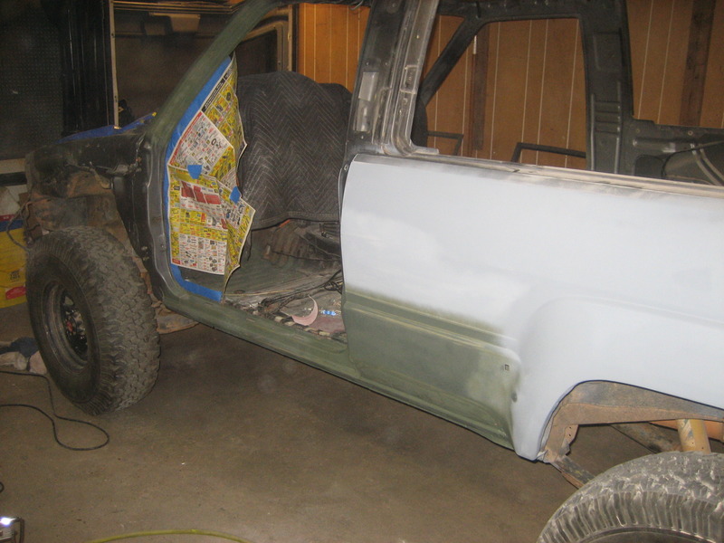

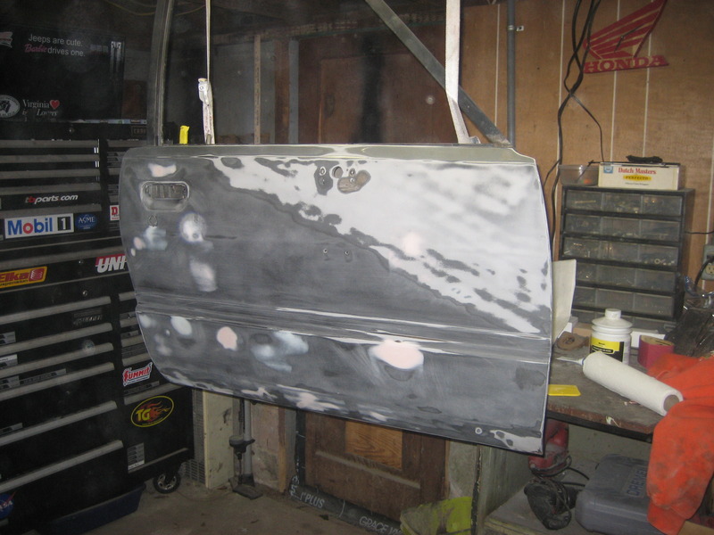

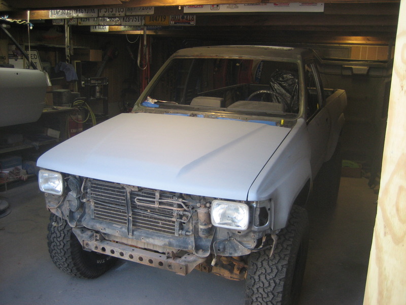

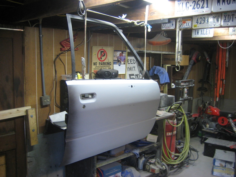

Passenger door is all fixed up. Had a lot of dents. Had some rust right at the front edge on the bottom. Ended up cutting out a 10x4 inch strip and welding in new metal but it was after this picture.
Primed and cut in the jambs and edges.

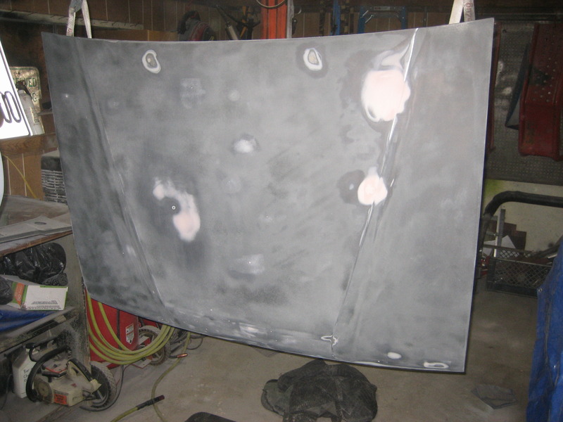

Hood smoothed out. A few blemishes showed up in primer that I missed, nothing major, just a few small chips and such.

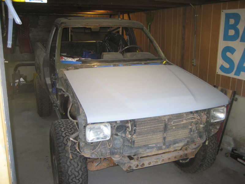

Mounted up the hood. Won't interfere with fixing the little things I missed. It's lined up enough to close but I'll finalize the alignment once I have all the fender and doors on.
Looks kind of like a truck from here.
