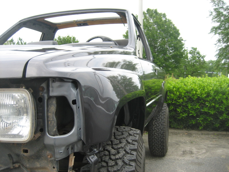

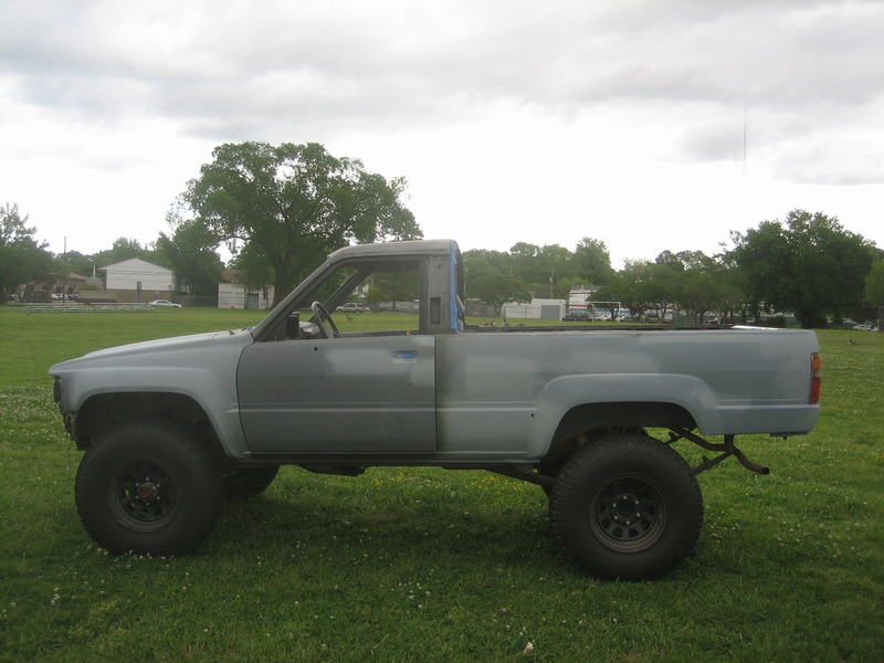

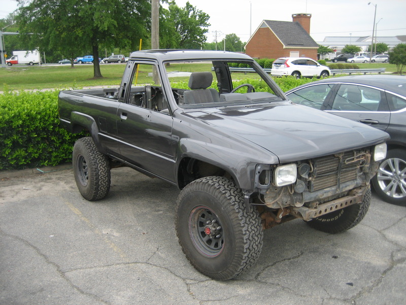

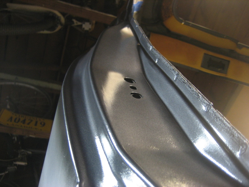

The last bit of bodywork was the dents in the tailgate. I have a couple pictures but they are nothing special. Just the typical fill, sand, repeat to smooth out the dents. Once this was done I finally had a rust and dent free truck!

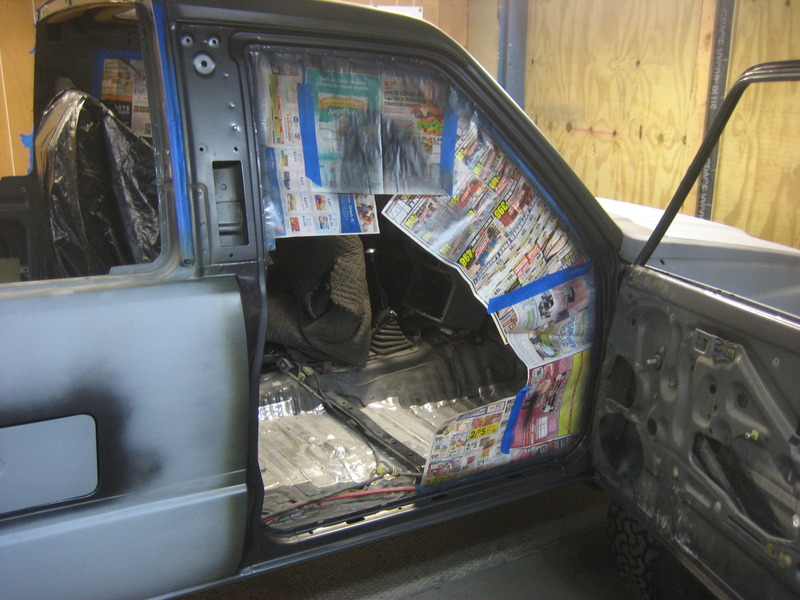

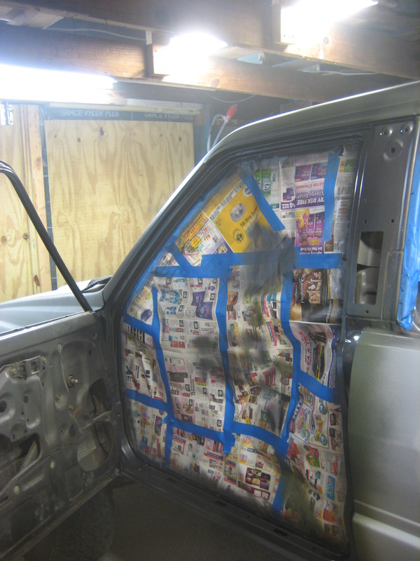

With all the bodywork done, the absolute last thing to do before taking it to the paint shop was to paint the door jambs. I had bought two cans of color matched rattle cans from AutomotiveTouchup.com. They have all sorts of different products from paint pens, to spray cans, to quarts and gallons of sprayable paint for spray guns. They are a bit pricey but the stuff is quality. I paid just under $50 for two cans of spray paint but I'm happy I did. Follow the instructions on the can and it turns out great. They also sell their own brand acrylic lacquer clear but I used Duplicolor acrylic lacquer clear to save a couple bucks.
Lots of newspaper and tape.
The passenger seat isn't installed so I wasn't worried about overspray as much. I still covered the dash and driver's seat.
Here's the final product. I'm very pleased. It lays down really even and came out great.

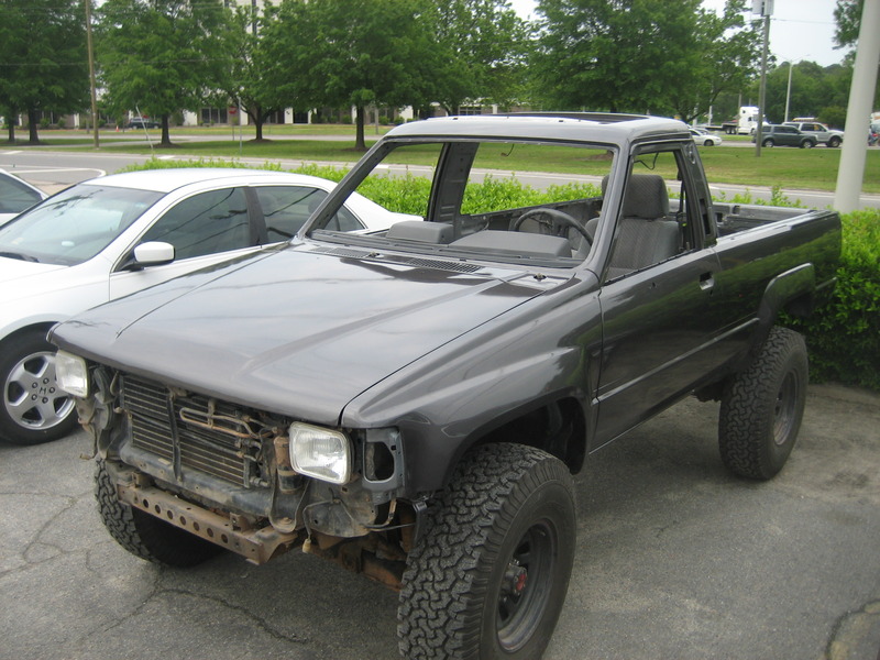

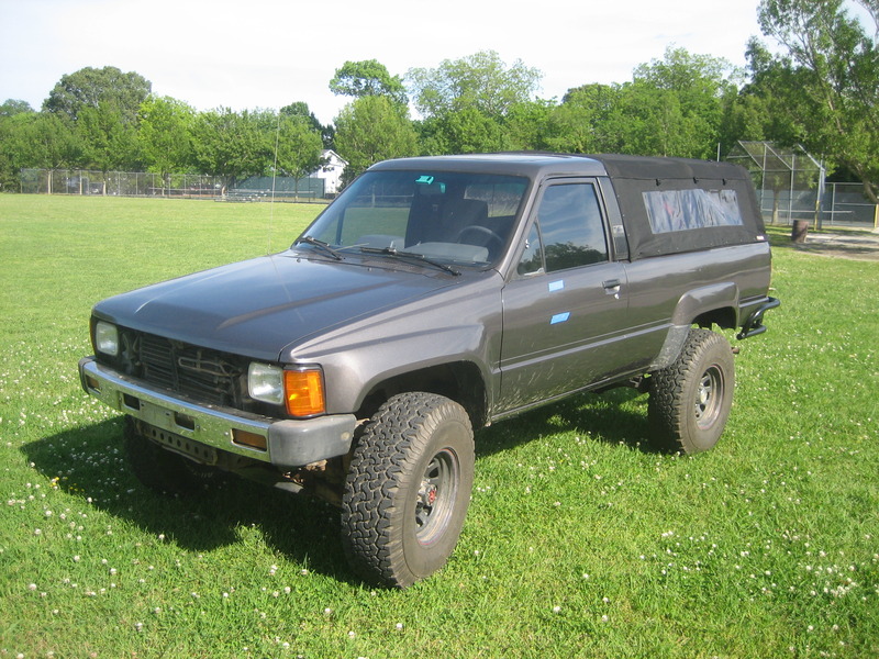

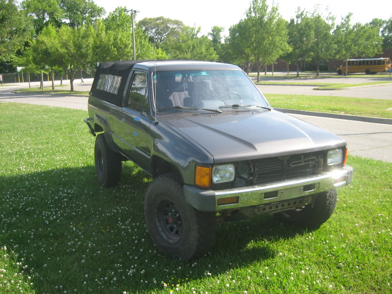

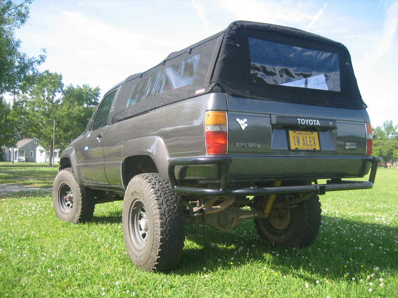

Haha, sorry for the delay guys. Here's the pictures. I'm pleased with the paint job. There are a few specs of dust in the paint here and there and one spot on the hood where the clear looks a bit messed up like they tried to lift a bug out of it or something. If it were anywhere else I wouldn't be too concerned but it's right in my line of sight when I'm driving so I'm going to take it back to them and see if they think they can safely fix it. Other than that, I'm happy. I can definitely see where my bodywork skills are lacking but they are all the kind of thing that no one else will notice but me. Anyway, onto the pictures.
Here's the truck the first time I saw it after paint. Taken the same day as the teaser picture above. As you can kind of see, I forgot to tell them to paint the upper door frames satin black as they should be on 4Runners. I haven't decided yet if I want to go back and paint them black myself or just leave it.

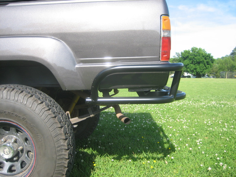

The rear bumper is from Trail Gear. Bought it from 4WheelParts on eBay for $321 shipped. It's painted with VHT Roll Bar & Chassis gloss black which I've used a lot in the past. It sprays nice, looks good, and hold up really well.
I wish the TG bumper tucked up a little closer to the body. Probably would be better if I hadn't chopped the lower part of the rear quarters.

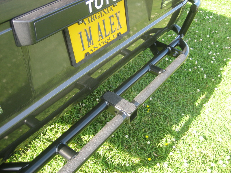

Grip tape on the bumper so I can step on it if necessary and not slip.

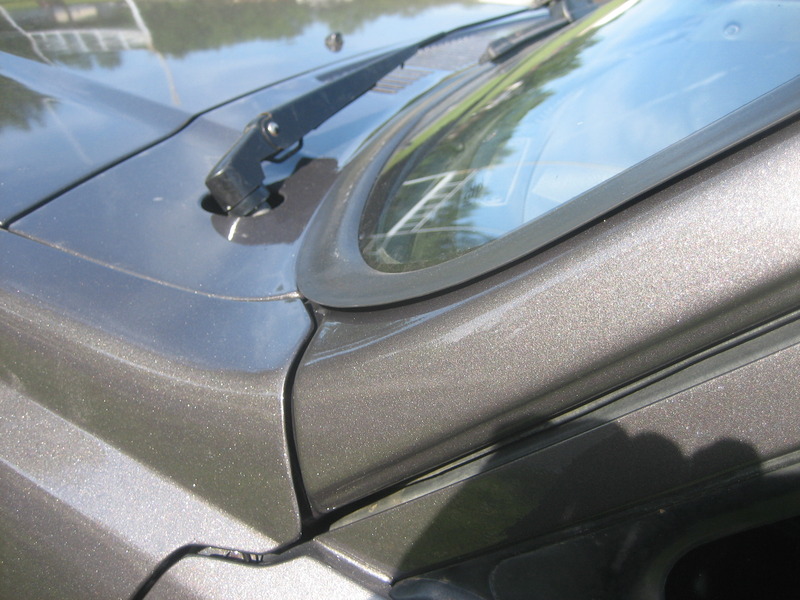

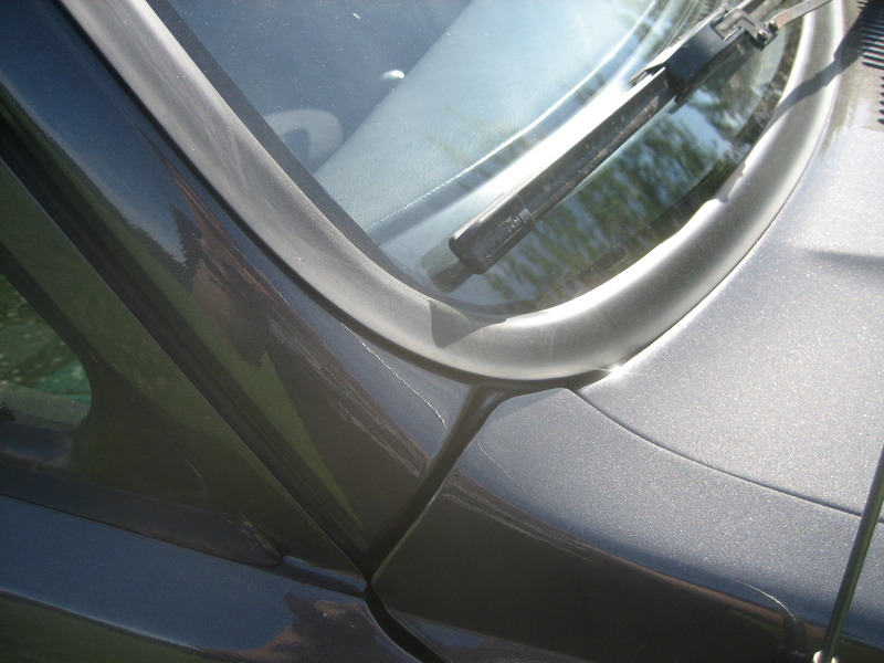

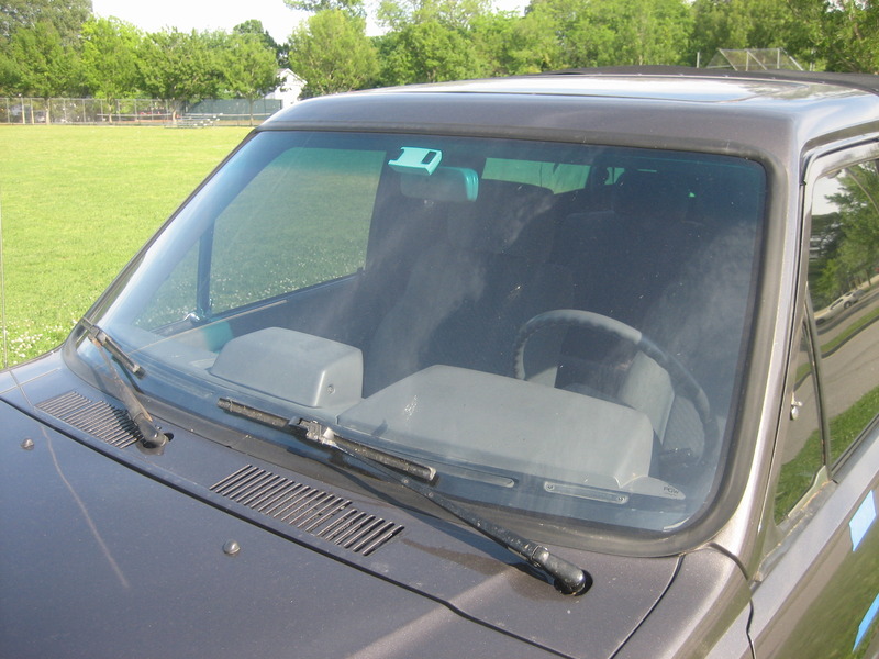

The new crack free windshield with universal rubber trim! No more chrome for me.
Fit is decent. It looks nice around the top.

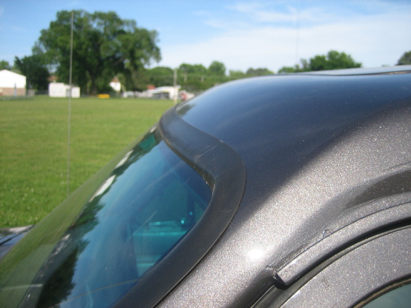

But it's a bit too wide for the sides so it leaves a slight gap.
Bottom looks good.

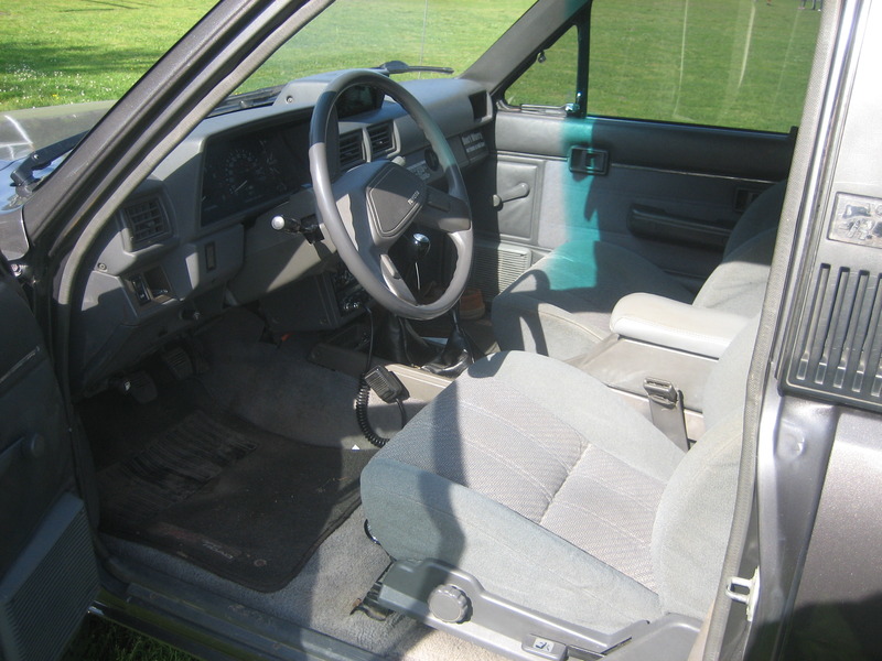

And the interior. I'm really digging the new center console. I never had a place for my right elbow before. Sure is nice plus I get twice as much storage. The seat heaters are installed in the seats but I still need to wire them in. I'd like to get a dashcap to cover my cracked dashpad. Mine is cracked but the steering wheel is blocking it in this picture. I also have the vent register for the passenger side but I don't want to install it until after I install the dashcap since it is very difficult to remove with cracking it all to hell.

Looks good man. I think you could chop the mounting brackets for the bumper and shorten them to tuck it.
The chopped quarters flew pretty darn well with the back end imo
