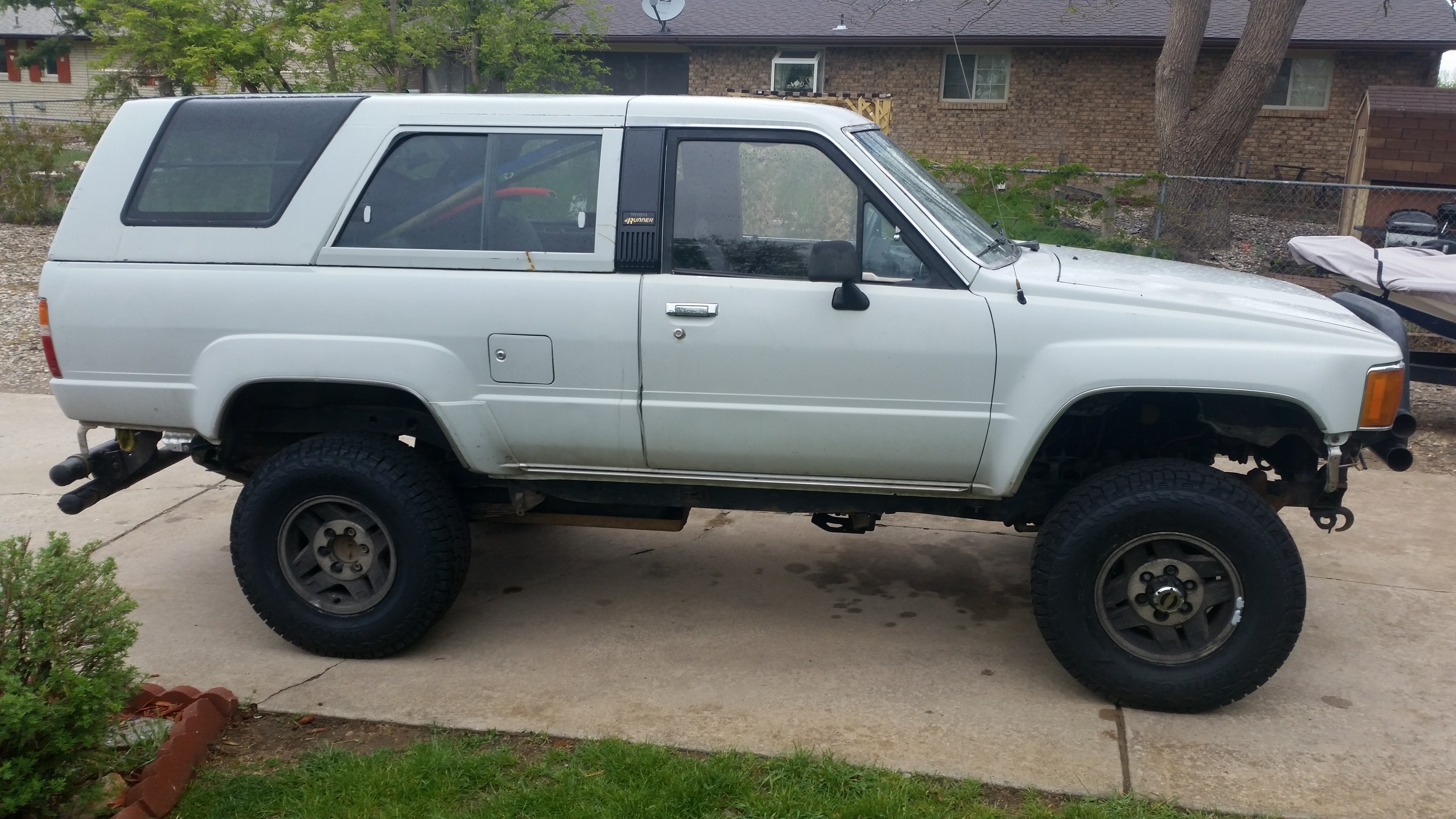

Hello everyone,
I bought an 87 4runner a couple of years ago and have since spent alot of time on yotatech...great site and information.
I have more plans for the truck than I do time and money and I feel like I have barely scratched the surface on this project. Anyway as its been rainy in Colorado recently I thought I would spend some time and start a build thread.
Projects completed (everything I can think of):
  • Dealt with loping idle issue for quite a while but it is solved
  • Replaced heater control variable resistor
  • Replaced control cable under passenger seat
  • Installed speakers in rollbar
  • Installed stereo amp in body panel near rear window relay
  • Changed alternator brushes
  • Installed conduit bars in back side windows
  • Fixed starter wiring per Rad4runner build page
  • Upgraded tires from 235/75r15 to 31/10.5r15
  • Installed mechanical oil pressure gauge, mechanical temp gauge, and a voltmeter as electrical senders and gauges were failing
  • Refinished louver panels
Projects ongoing/still to come:
  • A previous owner (it's had at least 2) did some interesting wiring of which I am not a fan. The rear window, wiper, and defrost all have issues or don't work and the wires behind the switches have been hacked into so this is on going and a headache...would be nice to have proper function of all three. Wiper side of combo switch has similar issues.
  • Power steering pump leaking badly...rebuild kit in the mail
  • Issues with charging system...difficulty running wipers/lights/defrost at same time. Need this capability in Colorado. After power steering fix am likely going to replace what I believe is the b wire running from alternator to see if this helps and clean up alternator. Possibly upgrade alternator and rewire accordingly. Replace battery with optima yellowtop.
  • 3 in body lift came with it when I bought it can't decide what to do with it
  • New shocks input welcome...
  • New steering stabilizer...ome or moog or other?
  • Upgraded headlight wiring harness...in process of building this
  • Retrofit round headlights and older yota pu grille to fit...have parts
  • Replace rear seat belts with 3 point style
  • Paint top black
  • Deal with minor rust and currently poor paint job that may be either cheap paint or primer and rubs off when wet
  • Add aux fuse box
  • Sound deadening of some sort along with replacing original plastic panels which are brittle and broken in several places with something more durable. Interior was originally grey but has been mismatched with some red interior parts would like to fix this
  • Refinish and repaint wheels
  • Diagnose and fix fuel sender/receiver problem
  • Replace rusty tube bumpers with something more sturdy
I am sure there is more but I have written enough for now. Any questions/comments/input are welcome. Thanks for reading.

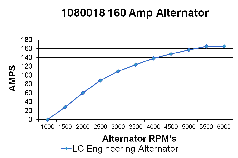

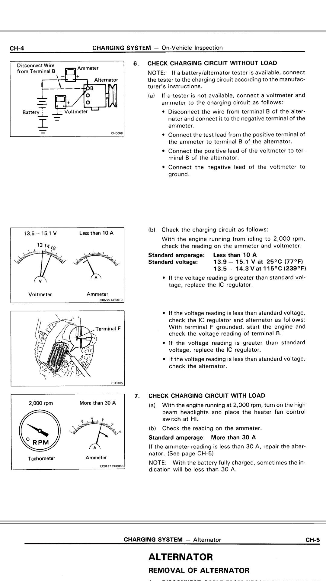

So based on these this chart and the page from the fsm if I chose to go with the lce it should be fine. If I am reading this stuff correctly.
Also, when you say upgrade the stock for about same price do you mean about the same as the lce?

Same price as the GM i paid 150 for my GM alternator and it's huge and took putting in a new bracket for it. If I had the money I would go with the lce. Good company good return policy and you know it will be quality just a big price tag I think the last time I looked it was over 300$ !! And it's just plug n play too
