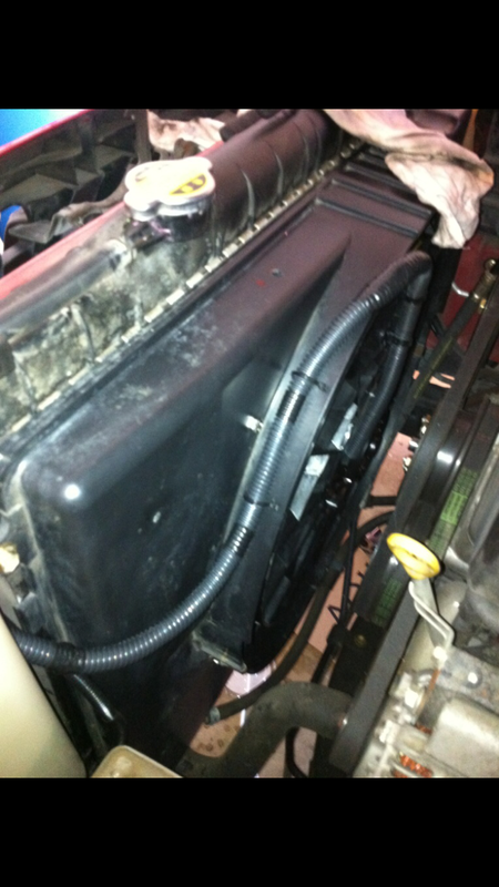

This isn't a step by step install thread. I just happened across some pics I took of the install I did on my brother's 2003 about 5 or 6 years ago. To date, the fan is going strong with no fan or controller issues.

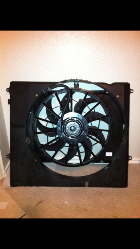

I bought a decent quality replacement Taurus 2 speed fan and bolted it to the stock shroud. I didn't want to take my chances on a used junkyard or eBay stock Taurus fan so I got the new one.

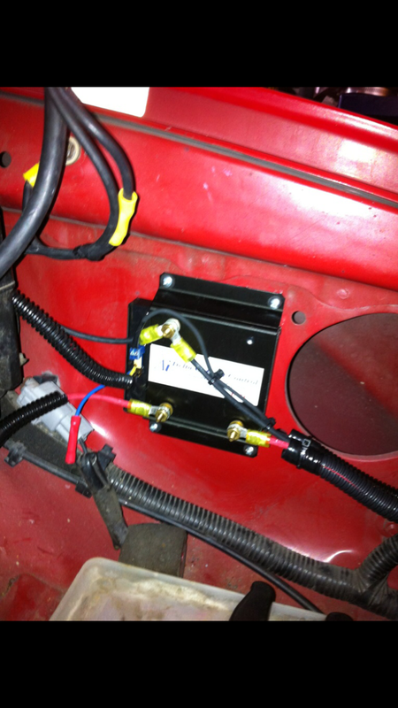

I bolted the fan in the stock shroud and wired it up with a DC fan controller.
Fan bolted in. Lazy garage dog for posterity

Closer shot of fan bolted in

Controller mounted on fender near battery

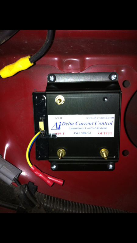

Controller wired up

Fan Wired Up and Installed. Wires Tucked Nicely In Loom

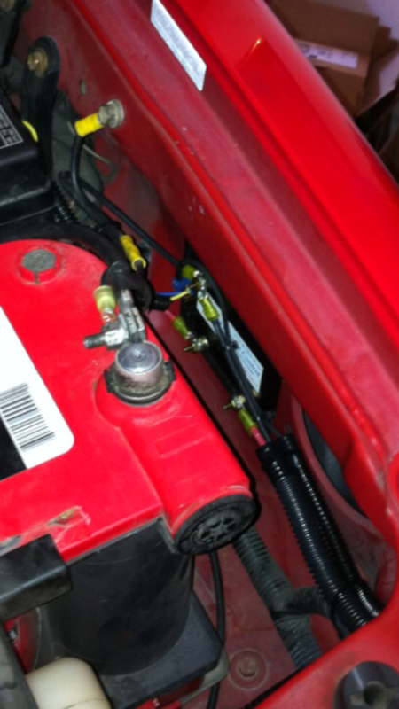

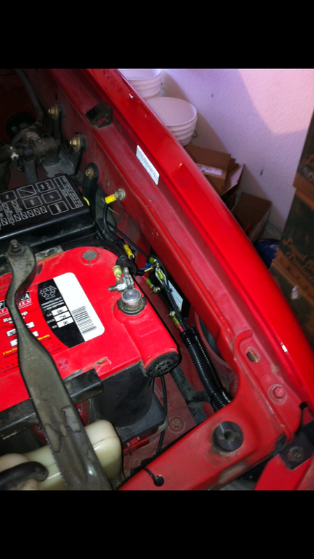

Controller views with battery re-installed
