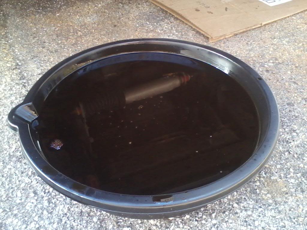

Ok, it's been a while since I've updated. I've run into a bit of trouble with the truck and I just wanted to see how it would play out before updating.
Up until 9/3/2013, I've always used Valvoline Max Life 10x-30 synthetic blend motor oil in the truck. A new Napa opened and they had a really good deal on cases of Napa brand full synthetic oil, which according to my brother who works at Napa, a Valvoline representative told him that all Napa motor oil is made by Valvoline. Anyways, I picked up a case of the full synthetic Napa 10w-30 and a Gold filter and changed my oil on 9/3/2013 with 195,540 miles on the clock.

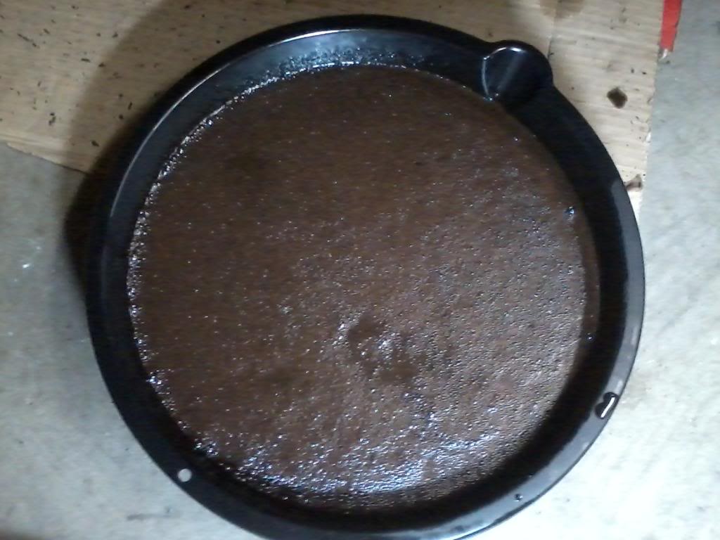

Jump ahead to 3/6/2014, I changed the oil again with 201,660 on the odo. Why did I wait 6,120 miles before changing the oil? Just school, work, and not wanting to work on the truck when the temperature outside was near absolute zero. I usually change it after 4500-5000. Well, when I drained the oil, it looked like this:

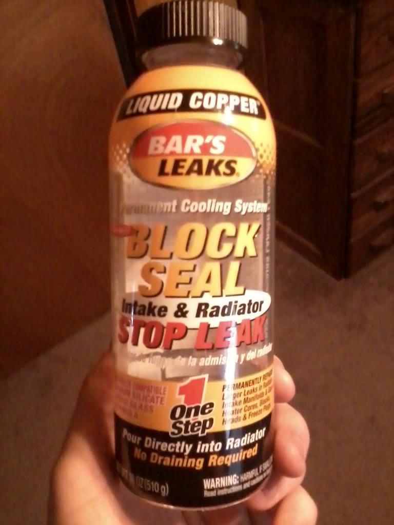

So, I immediately thought "crap, head gasket". But after sitting there, scratching my head for about a couple minutes, I realized that it didn't blow white smoke, it has never overheated, and there was no loss of power. It's been running like a top. I really didn't get it. I filled the truck up again with the Napa oil and installed a Gold filter. My dad told me it could be some gasket in the intake or something that might be leaking, and maybe I should put in some Bars Leaks or something. So that's what I did:
I know it's not gonna be a permanent solution. The plan was to drive it 500 miles and then change the oil again to see if it still had anti-freeze in it. Well that didn't happen. Jump ahead to today, I changed the oil with 203,424 on the odo, 1764 more miles, again because school and work. This is what it looked like (Photobomb Level: Steering Stabilizer ):
There's very little antifreeze in it this time. My guess is that it is just the little bit that didn't drain out the time before OR it's from the short period of run time when I backed it out of the garage and then added the Bars Leaks and then ran it to get the Bars Leaks through the system.
Anyway, today I put in Napa Premium Conventional 10w-30 oil with a Gold filter. The plan is to change it again in 500 miles (let's see if it happens this time).
My guess regarding what caused this is the oil. I've read that high mileage oils, like the Valvoline Max Life, have gasket swellers in them. So when I changed back to the full synthetic, the gaskets reduced in size and started leaking. That's just one of my theories. Next time, I'll go back to the high mileage oil and see what happens.

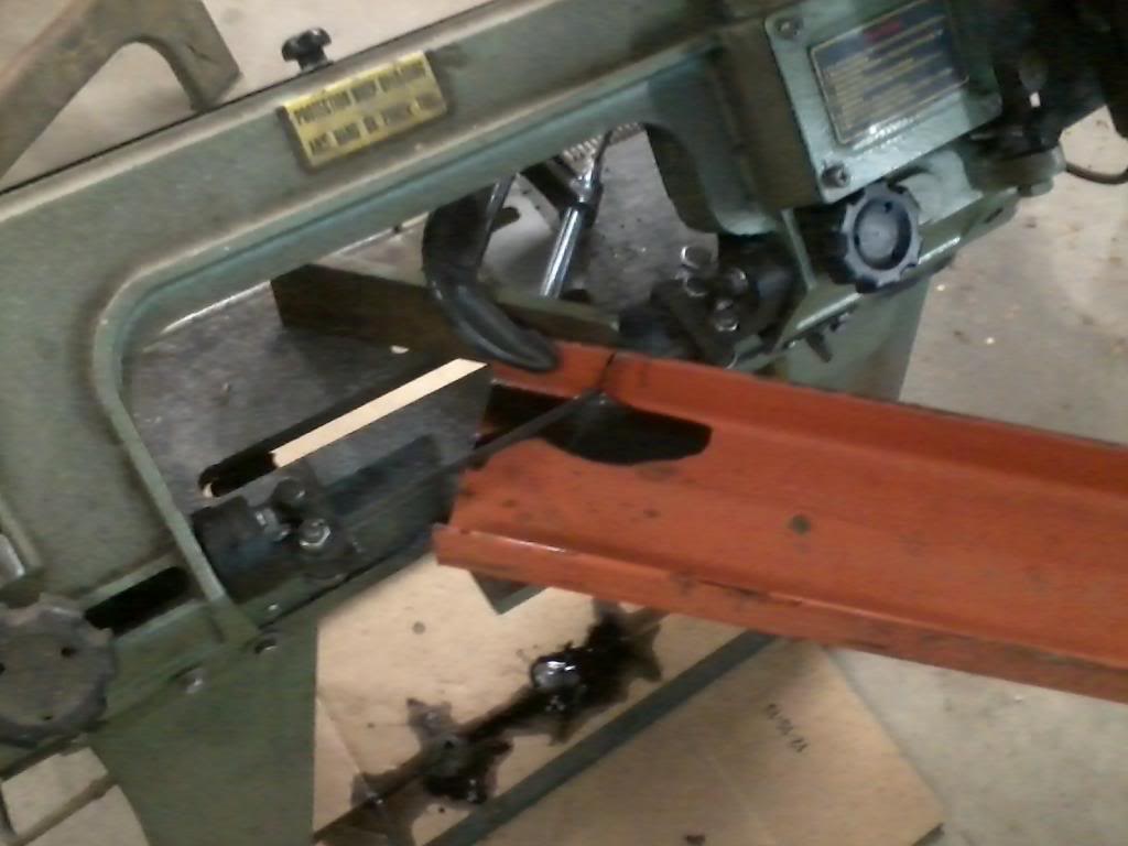

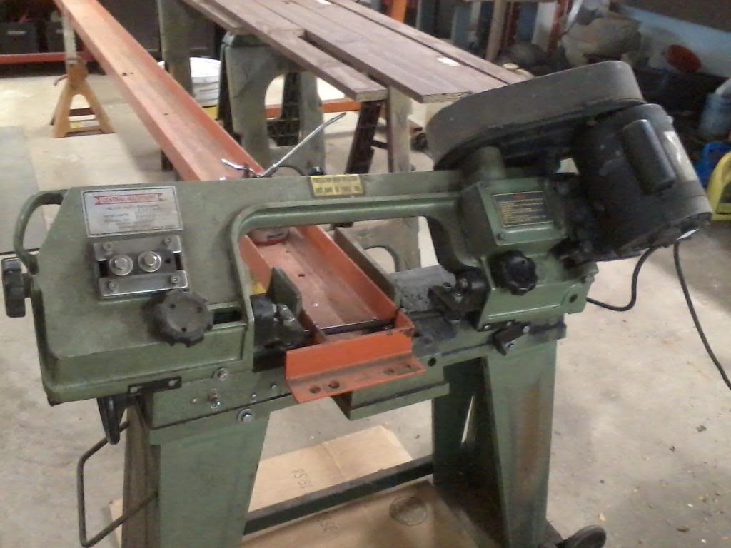

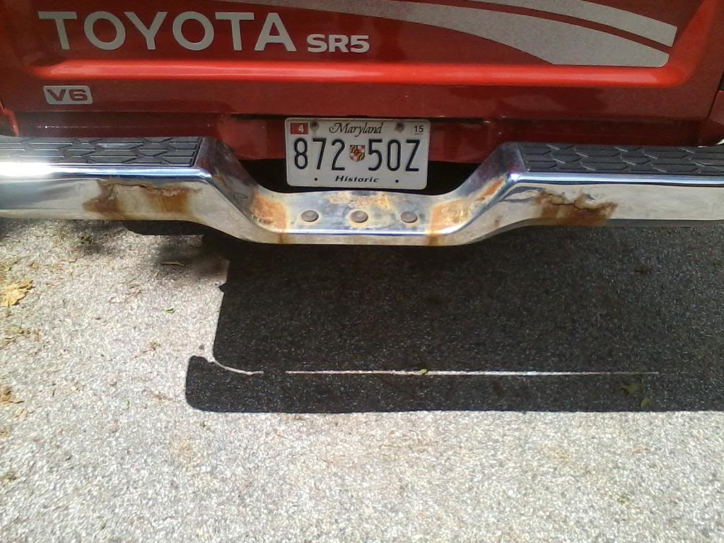

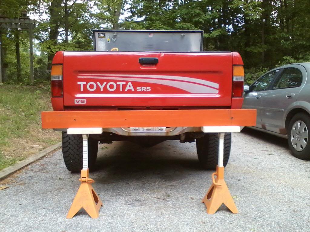

A couple pages back, I talked about building a tube bumper for the pickup. Well, it's happening. I'm sick of looking at this ugly, rusty heap sitting on the back.

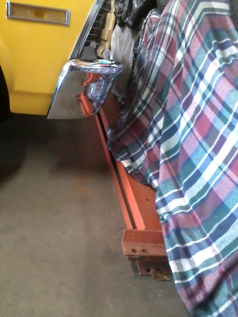

The initial plan was to use 4"x2", .120 wall rectangular tubing, but my dad and I just remembered that we have four 10' lengths of C-channel that have been laying in the back of our garage and forgotten about for at least a decade. So that's what I'm using. Plus it's free, which is a bonus. Free is always good.

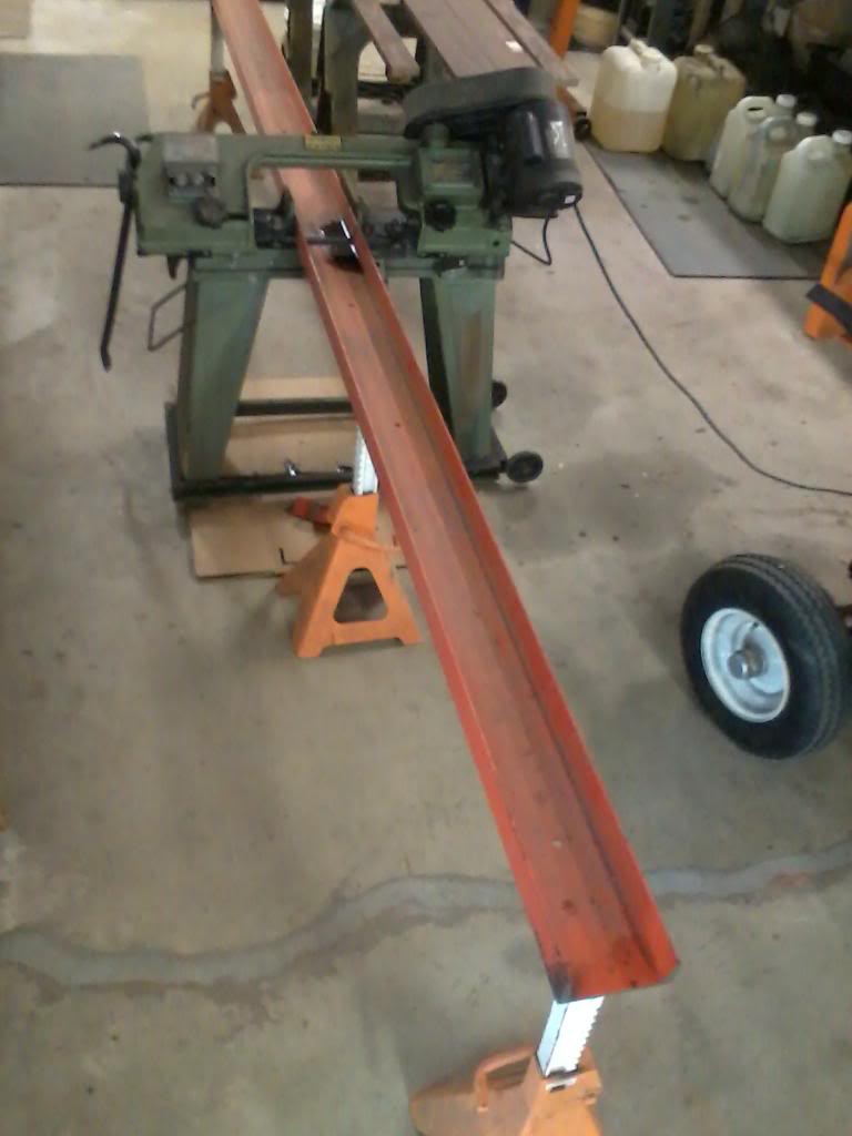

Getting some cutting done
I cut it to 64" total length, IIRC
The channel measures to 5"x2" with a 3/16" wall. The sidewalls begin at 3/16" and taper to about 5/16".

Just had to see what it looked like before cutting more. It looks a lot wider than the truck, but that's because it's sitting about a foot away from the back. It's really about the same width of the factory bumper. Dig the orange!

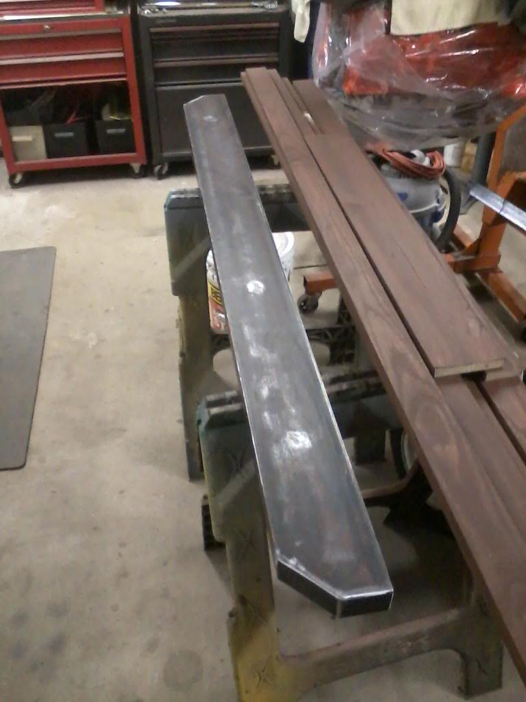

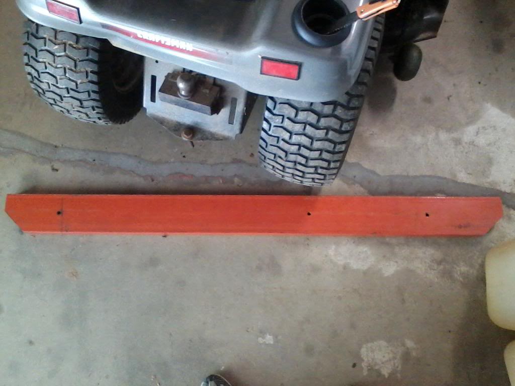

I'm not cutting any corners with this bumper build...ok, except these corners
And this is what I have done so far
The three holes will be welded closed and the ends will have plates to close it up. So, I guess technically it will be a plate bumper. I originally wanted a hitch receiver on the bumper, but after thinking about it, I don't really need it. However, I do want to add a set of D-ring shackles to it.

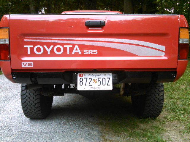

Got some more stuff done. I coated the area under the tail gate with some undercoating.

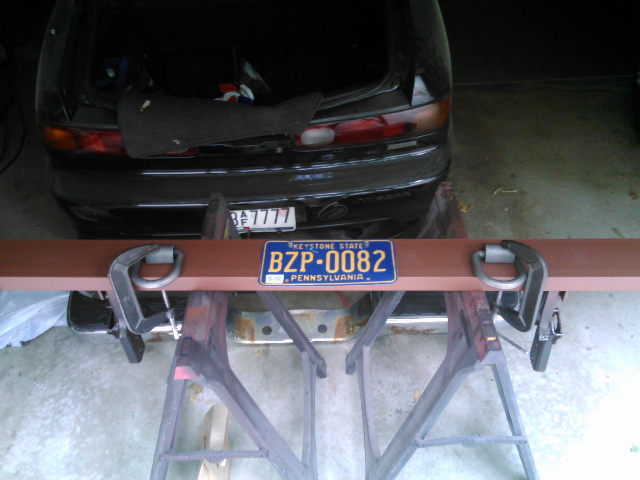

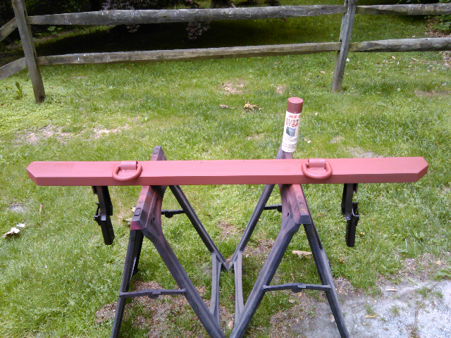

Also, i bought some D-ring shackles from Tractor Supply for $10 a piece. The cost of the two shackles is over half of the total amount I've put into the build. They have a working load limit of 6666 lbs. and a break strength of 20000 lbs. They also contain chemicals that are proven in California to cause cancer
Burned on and primed
More to come.
