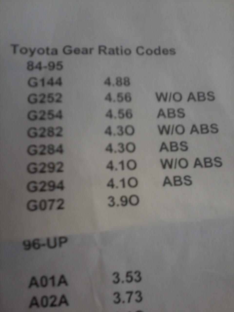

My local salvage yard gave me a cheat sheet for etermining gears if this will help. See you said they were 4.56 but just to double check. He told me it was really accurate and from a few I have checked I would agree.
