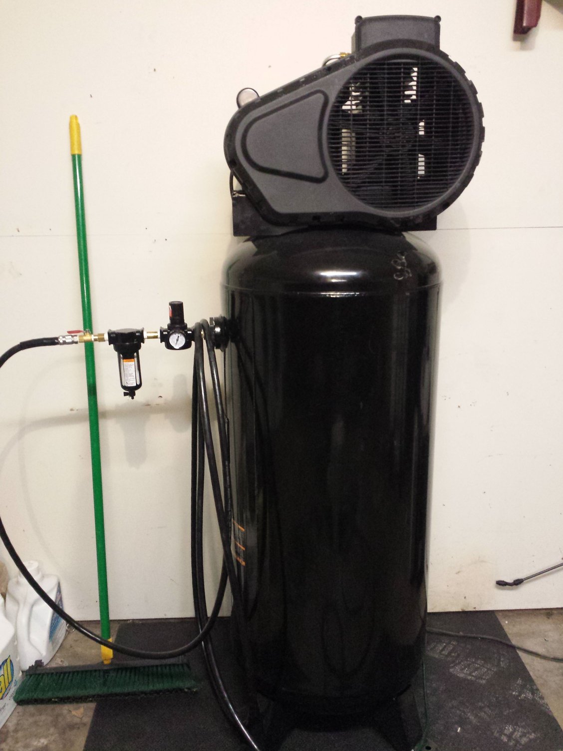

So body work was going slow hand sanding everything. And my da sander pulled to much cfm for my little 21g compressor.
upgrade time! I ran a 220v 30a circuit to the garage and bam 60gal 11.5 cfm at 90 psi.
i did put a plug and outlet on it so i can use a 220 welder or hook up a dryer for testing etc.

Nice set up there. That should run your air tools with out breaking a sweat. I only have a 26 gallon but I rigged up another air tank for reserve and added a dryer.

I can run my da now without a hitch. I ran it for about 15 minutes ands the gauge fell to 80 psi. That is way better than my 5 min on, 5 off with my other compressor.

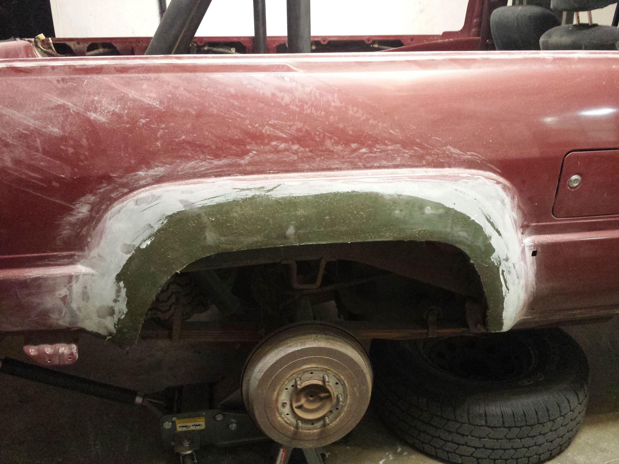

started the body filler on the passenger side. That's the second and last wipe of fiber filler, then comes the evercoat. Can't wait, evercoat is so much easier to sand than that fiber stuff
Old Feb 24, 2017 | 09:25 AM
  #233
92ehatch's Avatar
Joined: Jan 2015
Posts: 652
From: Hendersonville NC
Oh so close.
Circle dents as you find them. Doing so ensures you remember where they are. Different light will hide/show dents

Maybe I'll get the truck in primer today, i worked my ass off last night and fixed all the dents. Only have the hood and roof left.

Circling dents does help as once you get the paint off and it is in primer they will disappear. First coat of paint and they will show up quick.
