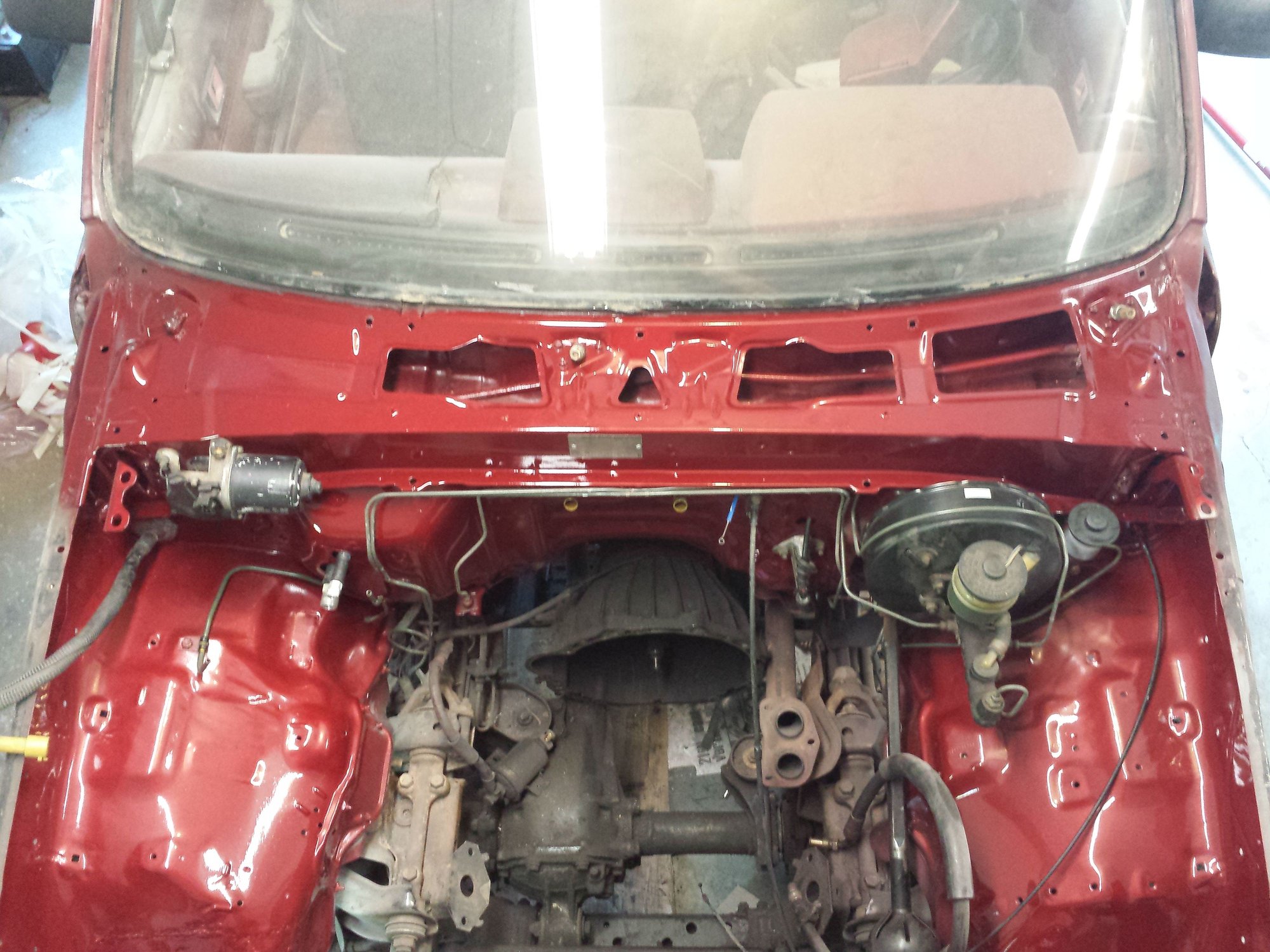

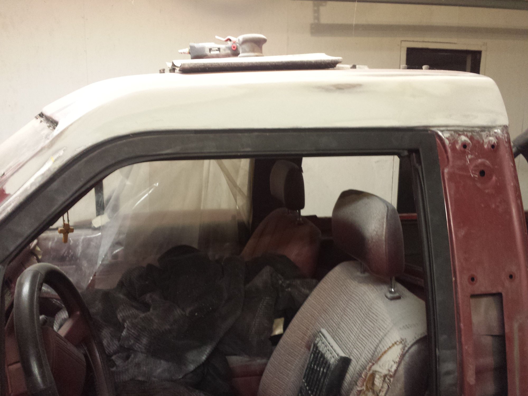

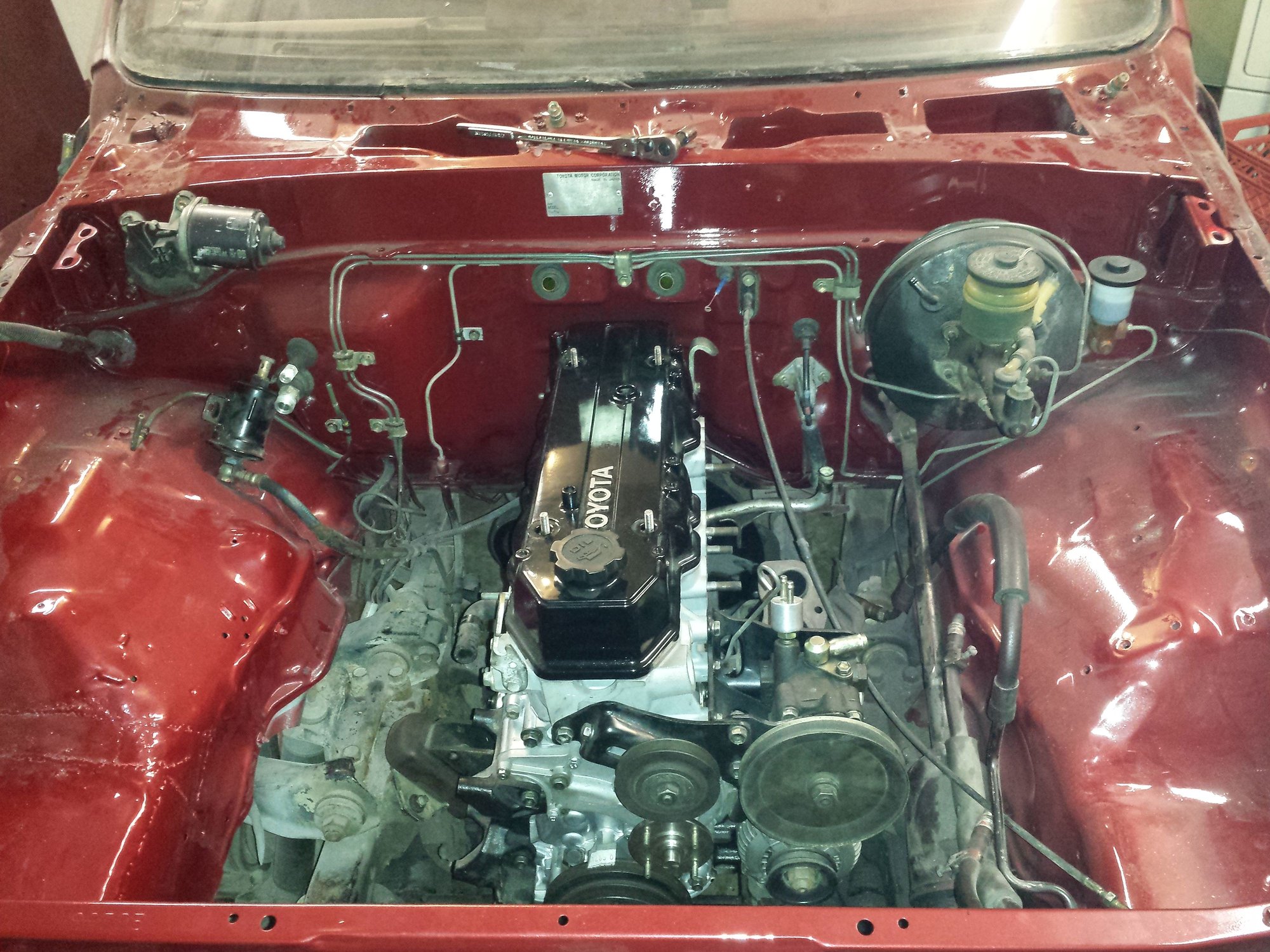

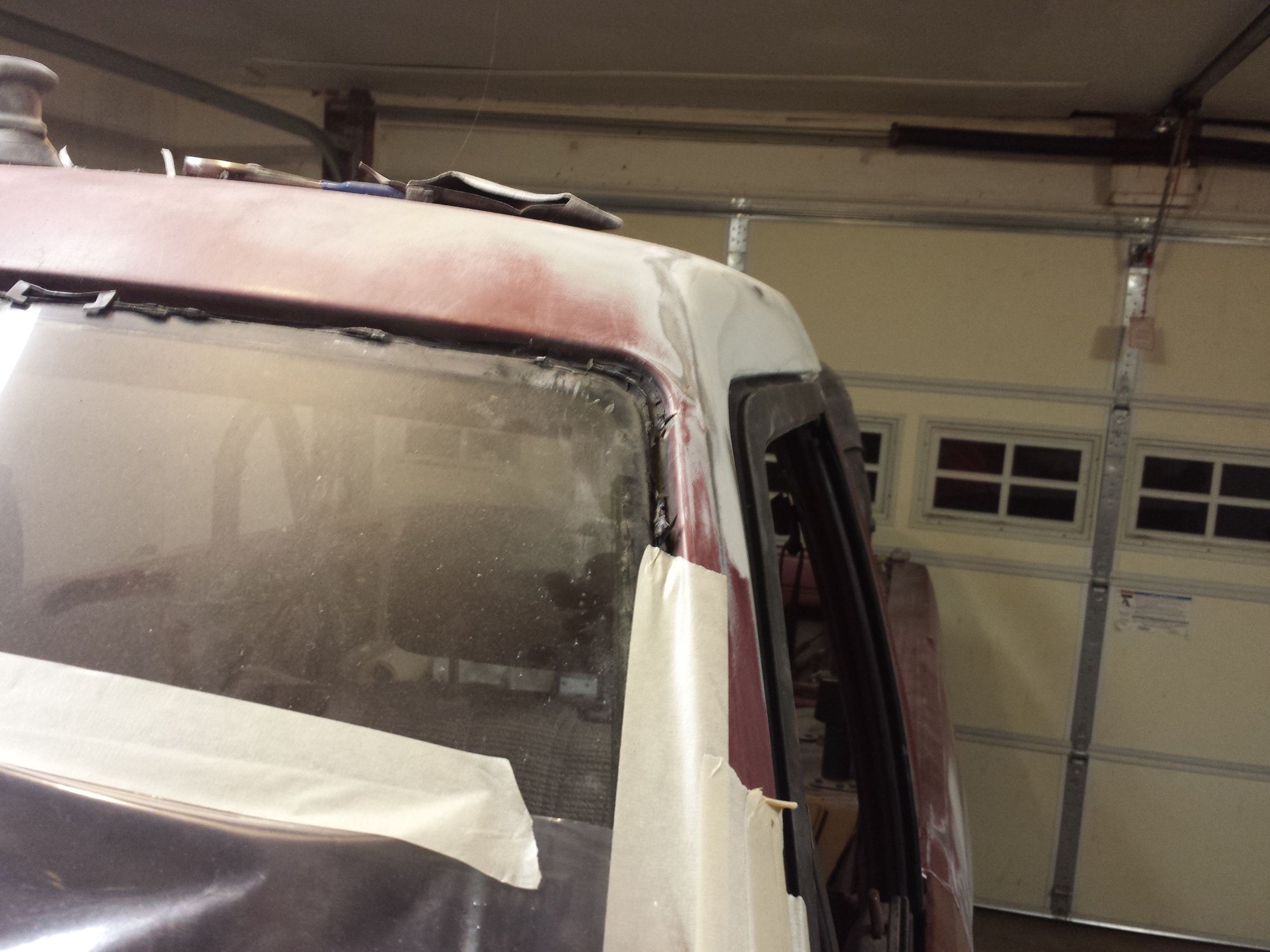

Here is the drivers side roof line where the gutter was removed. I am super happy that is done with for the most part. I still have to sand a little and finish up some filler work but it's respectable.
I'll seam seal the door jamb side prior to painting it.

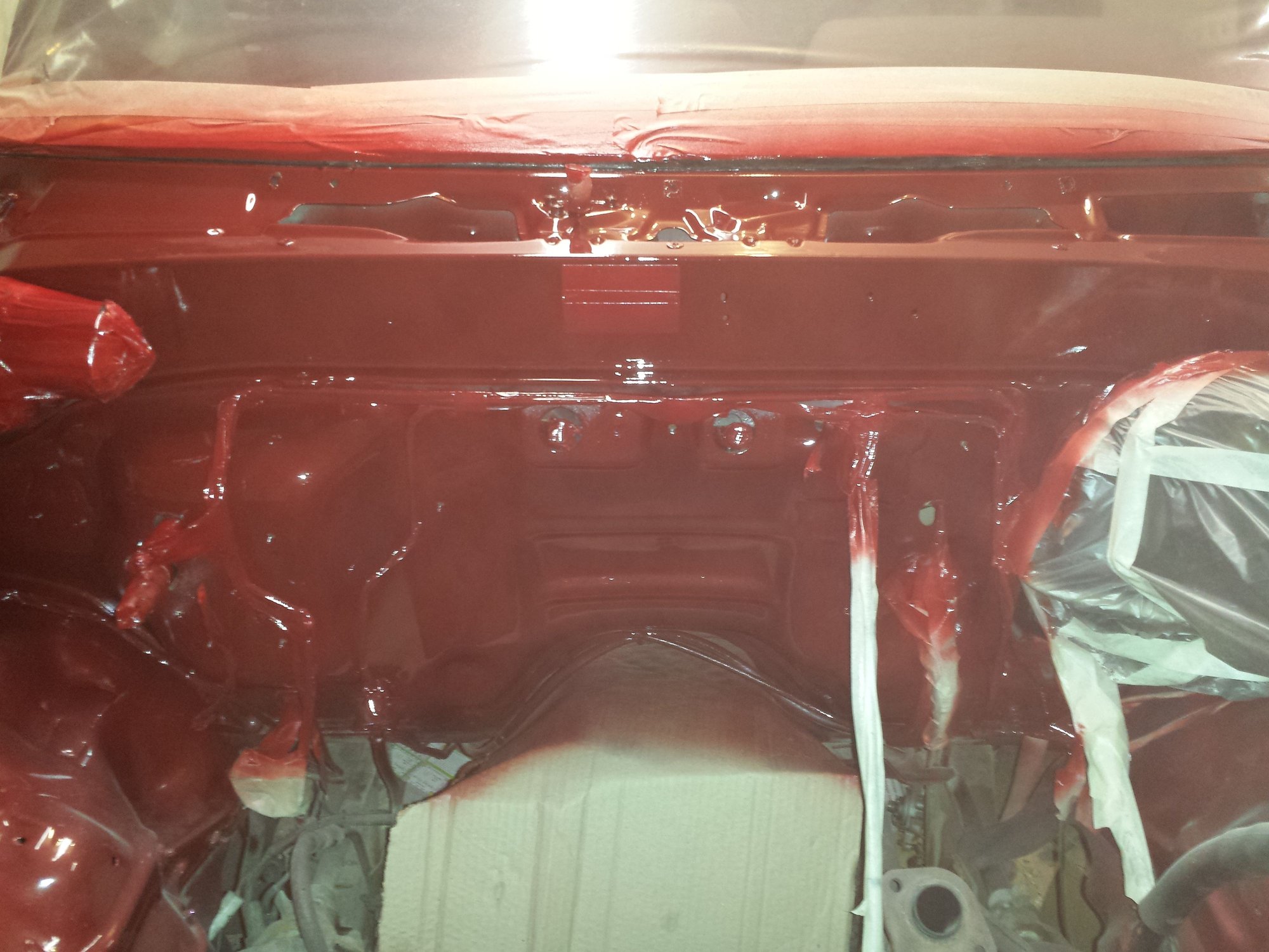

And i painted the firewall so i can start putting the engine back in. Maybe I'll get it bolted back in next weekend. The first picture without flash the second is with flash. The second is fuzzy from the paint fumes/particles still floating around.

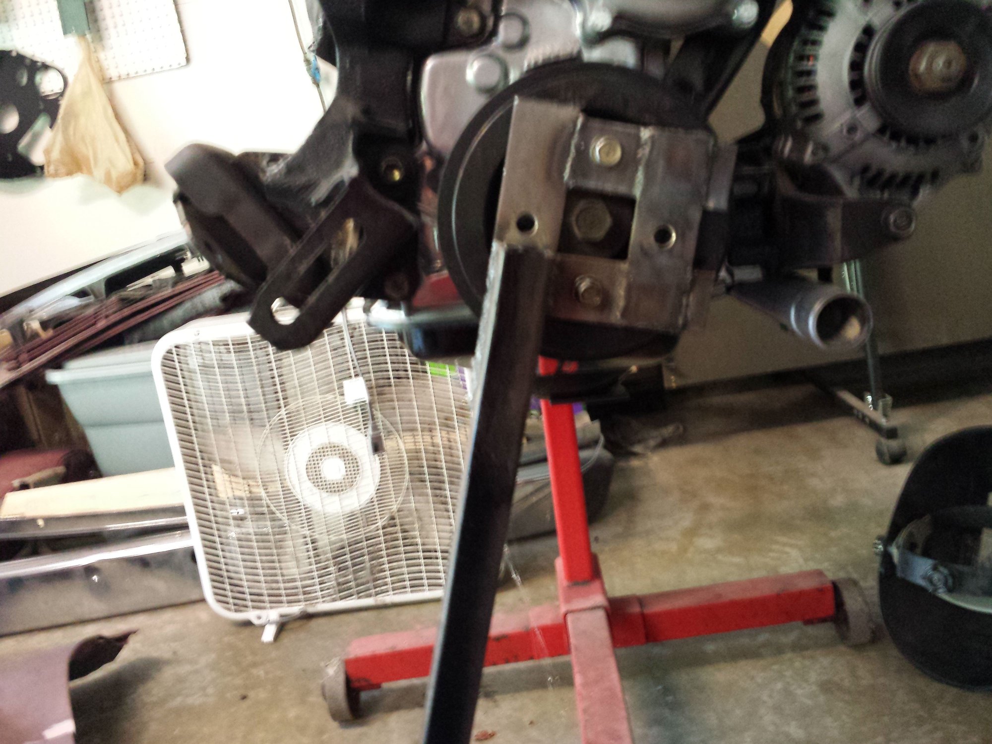

More pictures in better light. And a Crank pulley holder tool. The bolts are one time use as they bend. Oh well it worked for the pulley bolt.

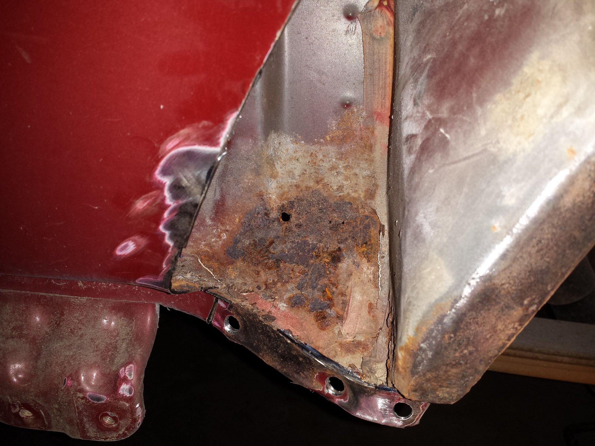

So i moved the truck a bit for more access to the passenger side, it was way to close to the wall for comfortable work environment.

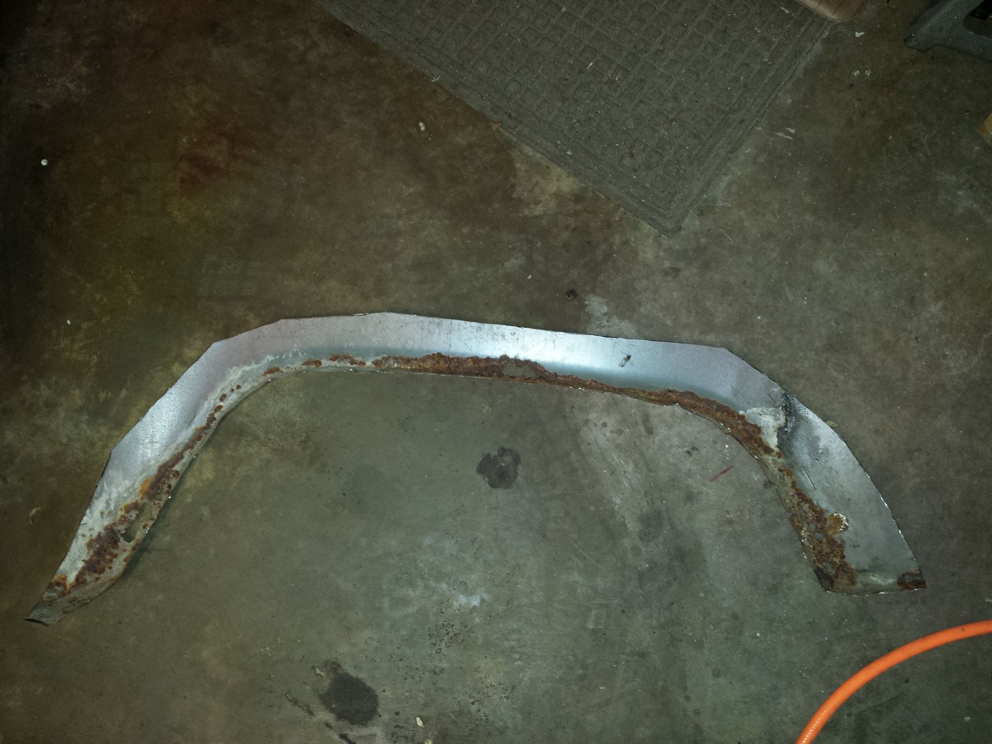

I then cut out the rusty panel. I did it differently this time. The plan is to repair the panel off the truck then simply weld it back.
There is one spot of the inner fender well that has rusted through and will need a patch put in but will not need to be perfect as its not cosmetic so it should be easy.

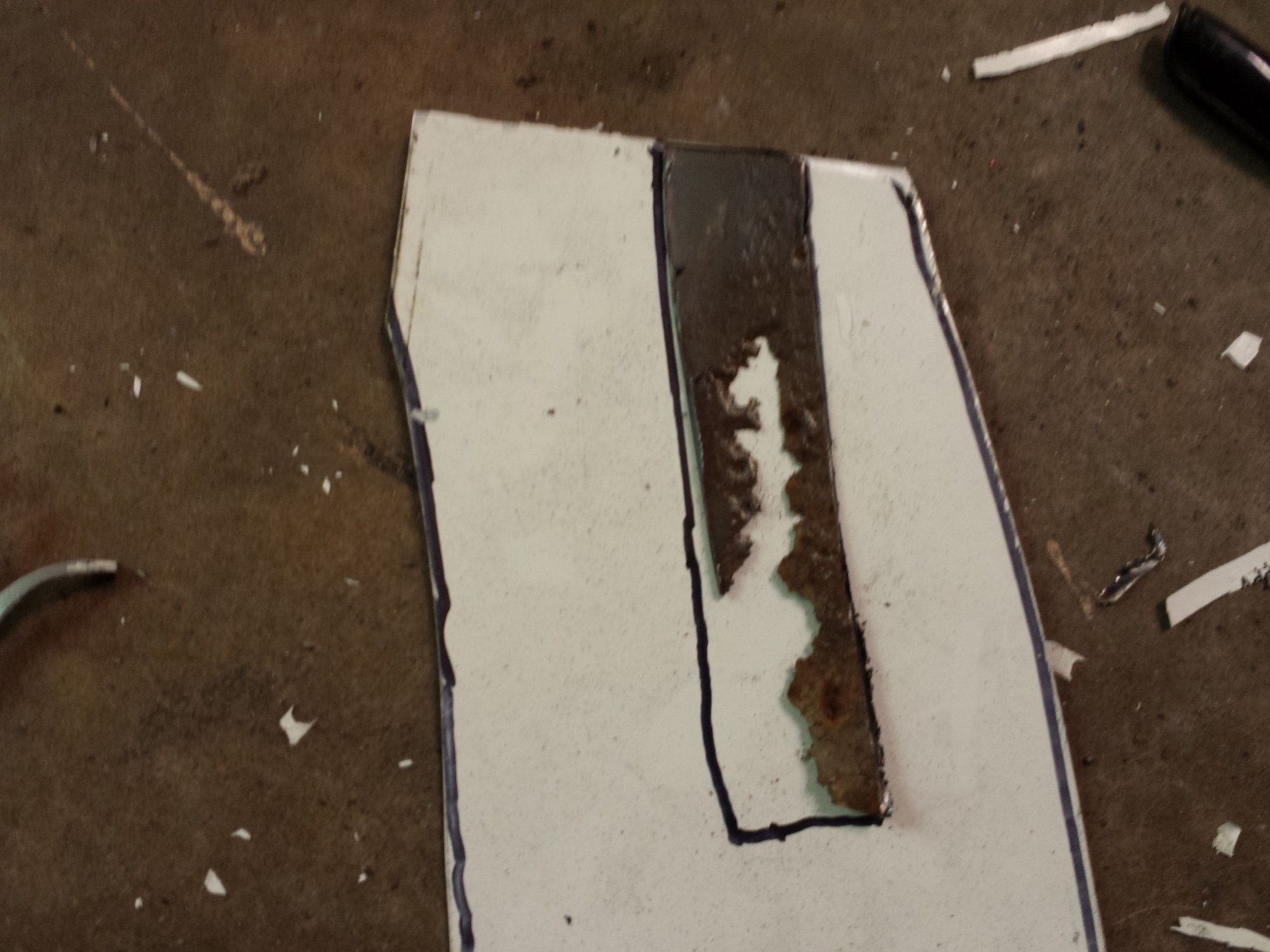

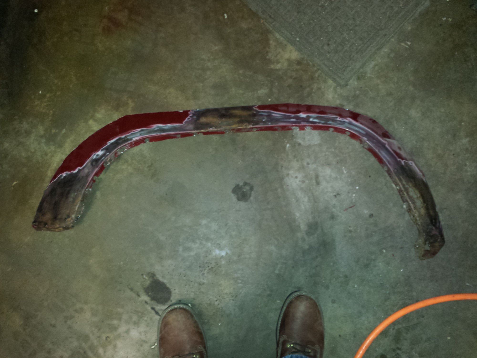

So i cut the bad out of the rear fender well and put the good back in place.
Then started making the pieces to put back in.

Ha, I see you're still using the old washing machine metal. A little "ring around the collar" print will be a nice touch on the inside of your quarter! Somehow reminds me of leaving empty beer cans inside the walls of a house while hanging drywall...
One of my panels had the whirlpool logo still on it on the inside. I'm not removing the paint from the inside portion as it can only help to protect the inside. I'm still going to coat the inside with por15 though.

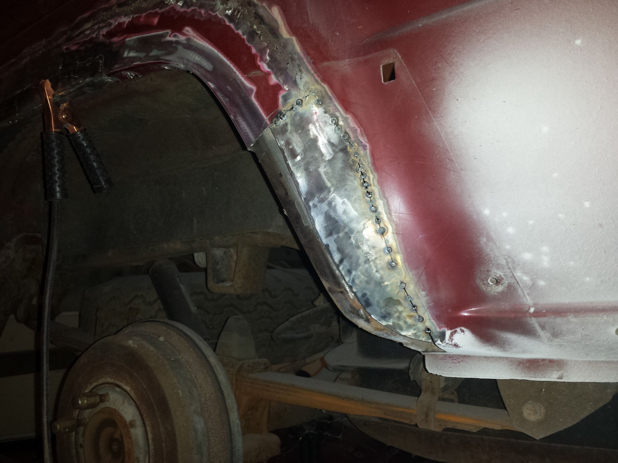

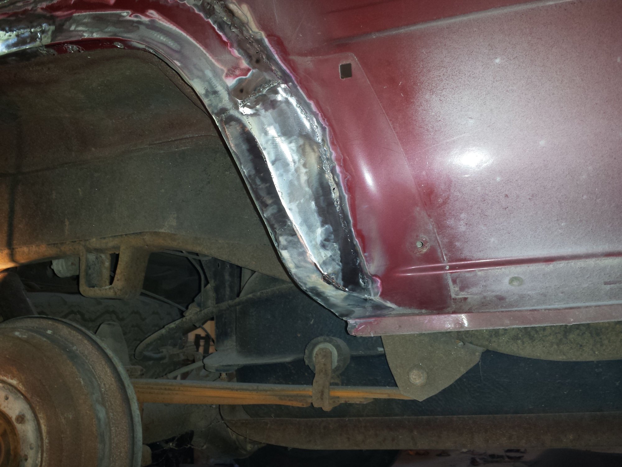

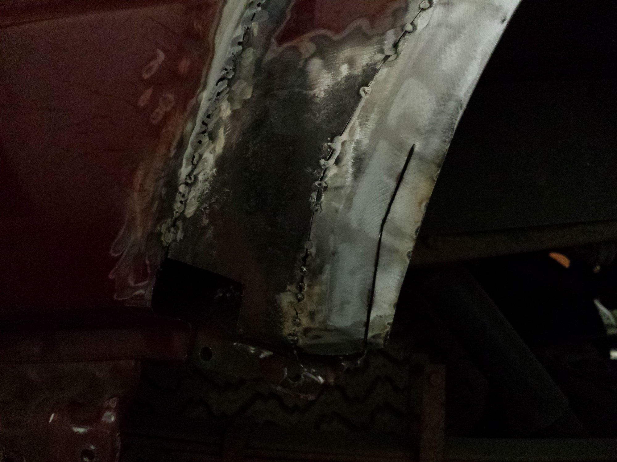

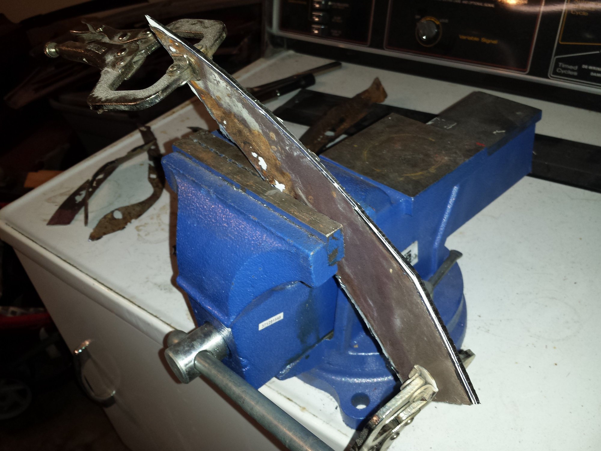

I ran out of that whirlpool metal, it's thicker than the ge metal. I finished most of the passenger side but ran into a wall in the rear with blow throughs and getting the panel welded in to far forward. I had to cut a slit and beat it back, which only caused more warping.
A little imagination needed
Looks good
80 grit flap discs really help make those tough shapes
Done
The slit i had to make in the rear, it didn't look bad before but the plastic bumper trim didn't look right against it

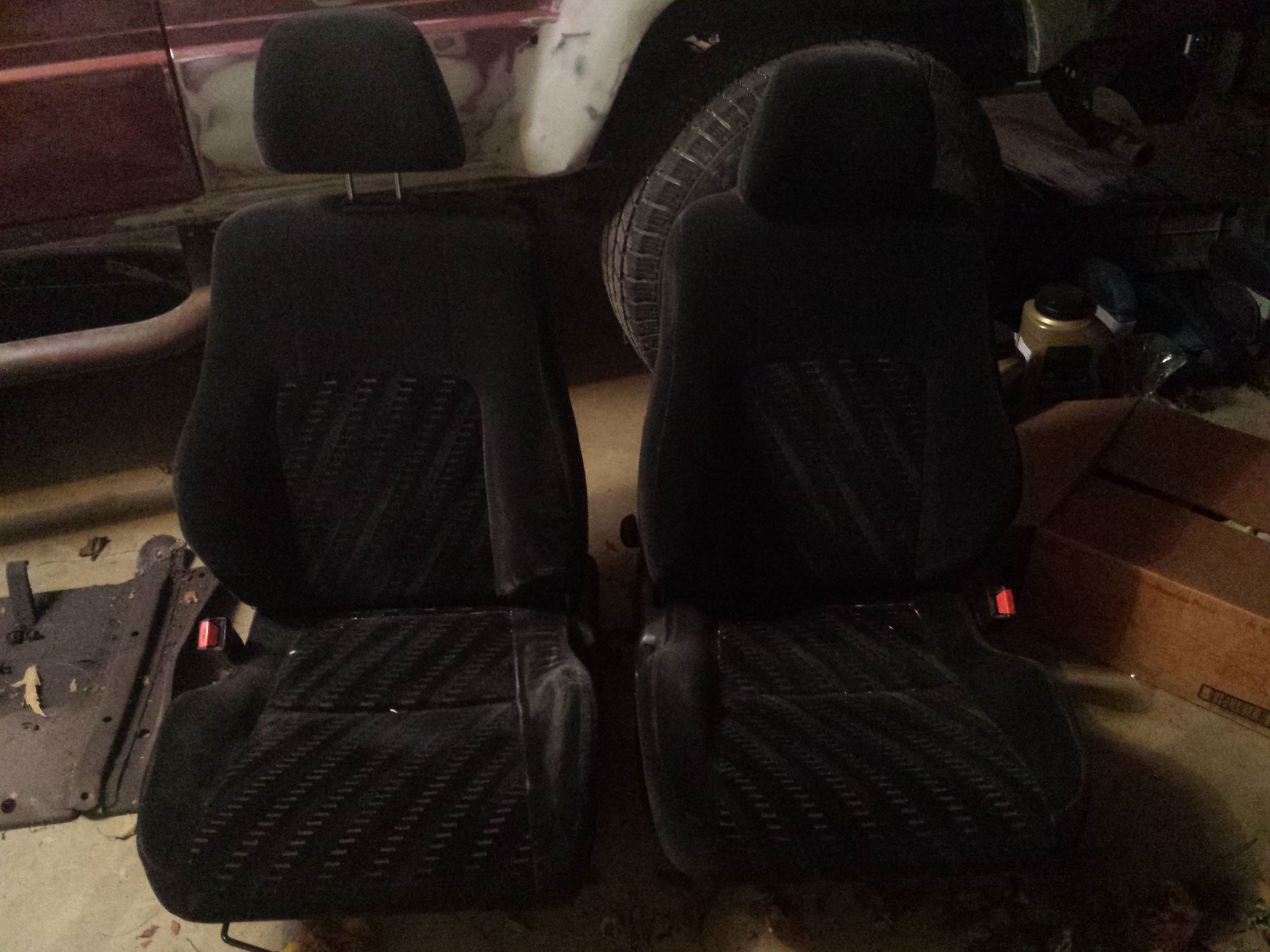

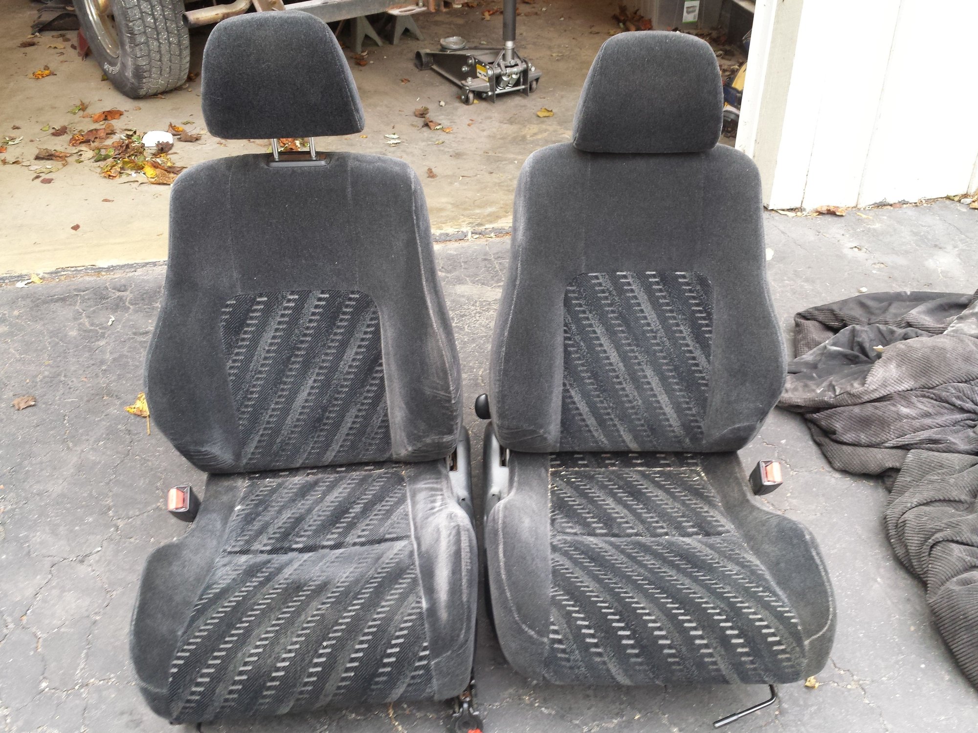

50 bucks scored me some very nice condition honda prelude seats. The guy told me they were integra buy being a Honda guy and thinking about it, integra seats all have holes in the headrests.

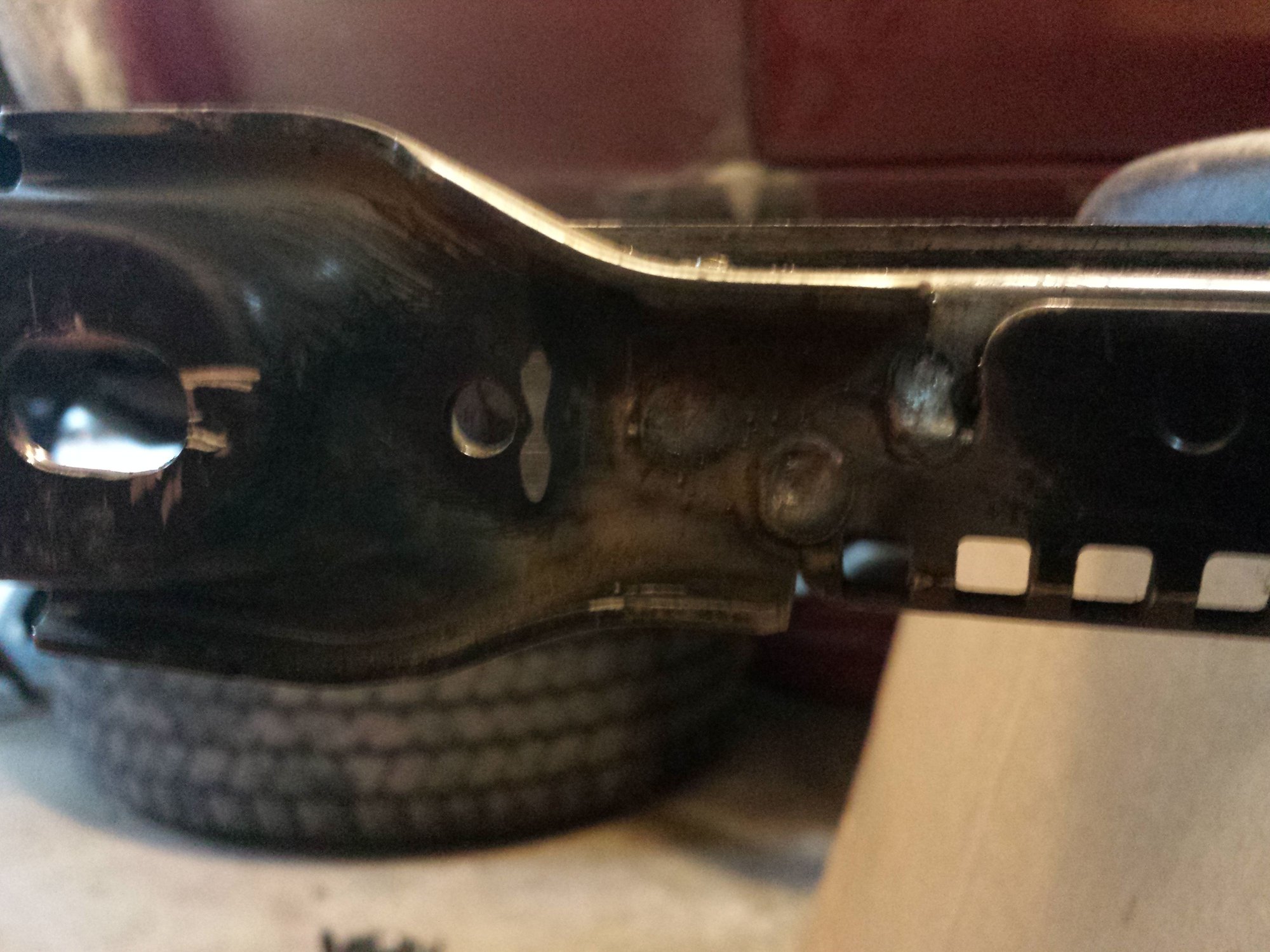

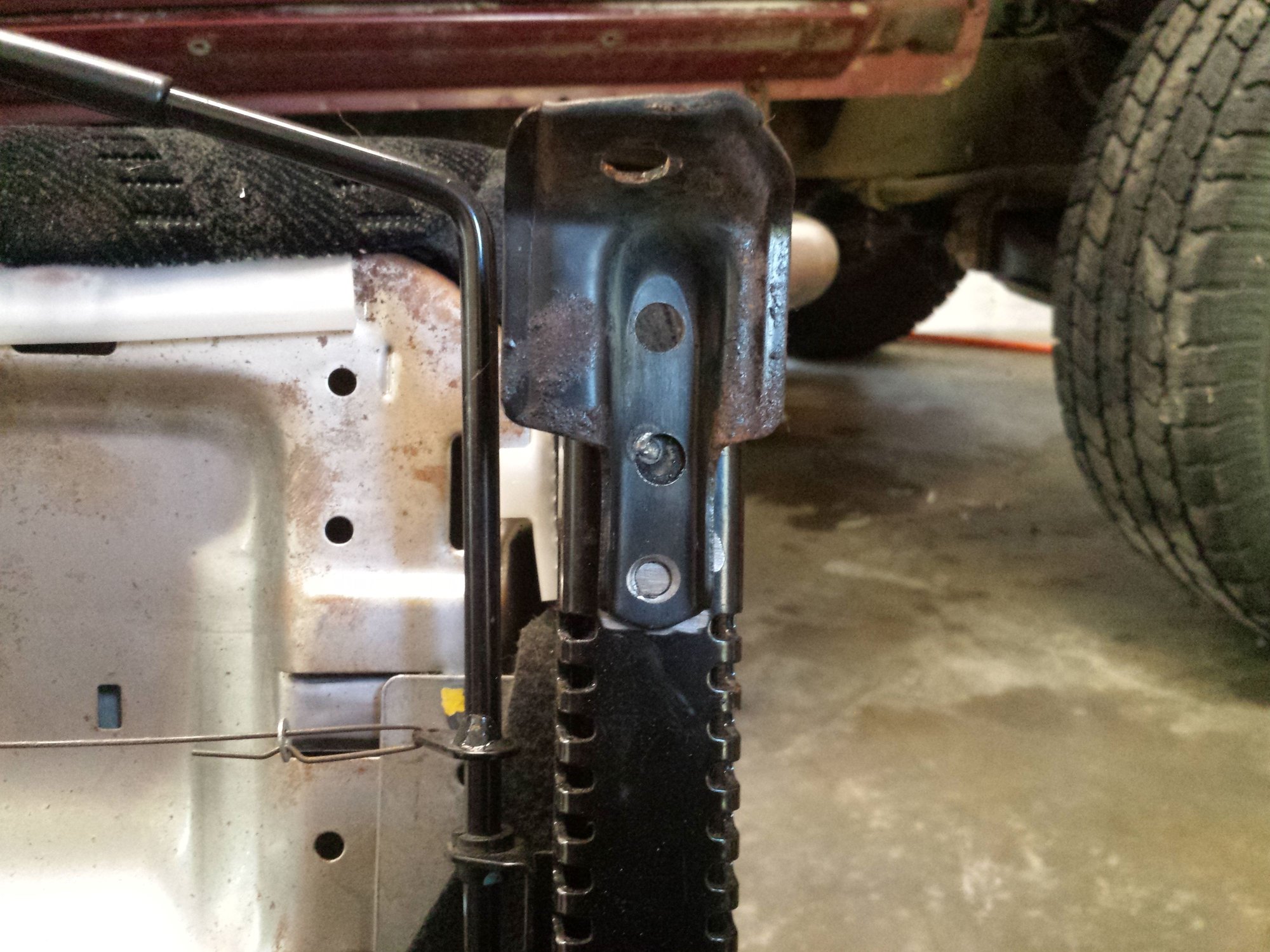

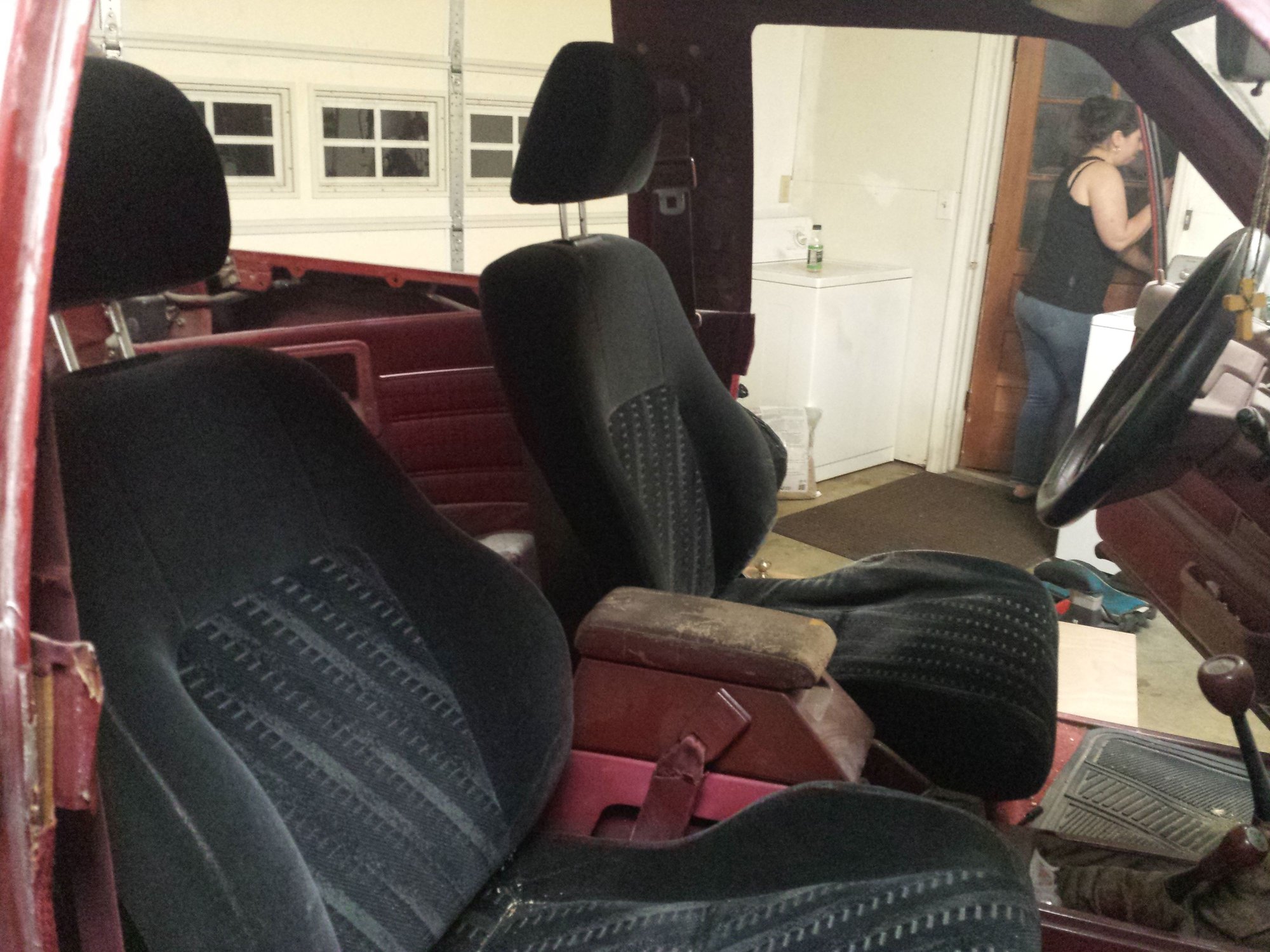

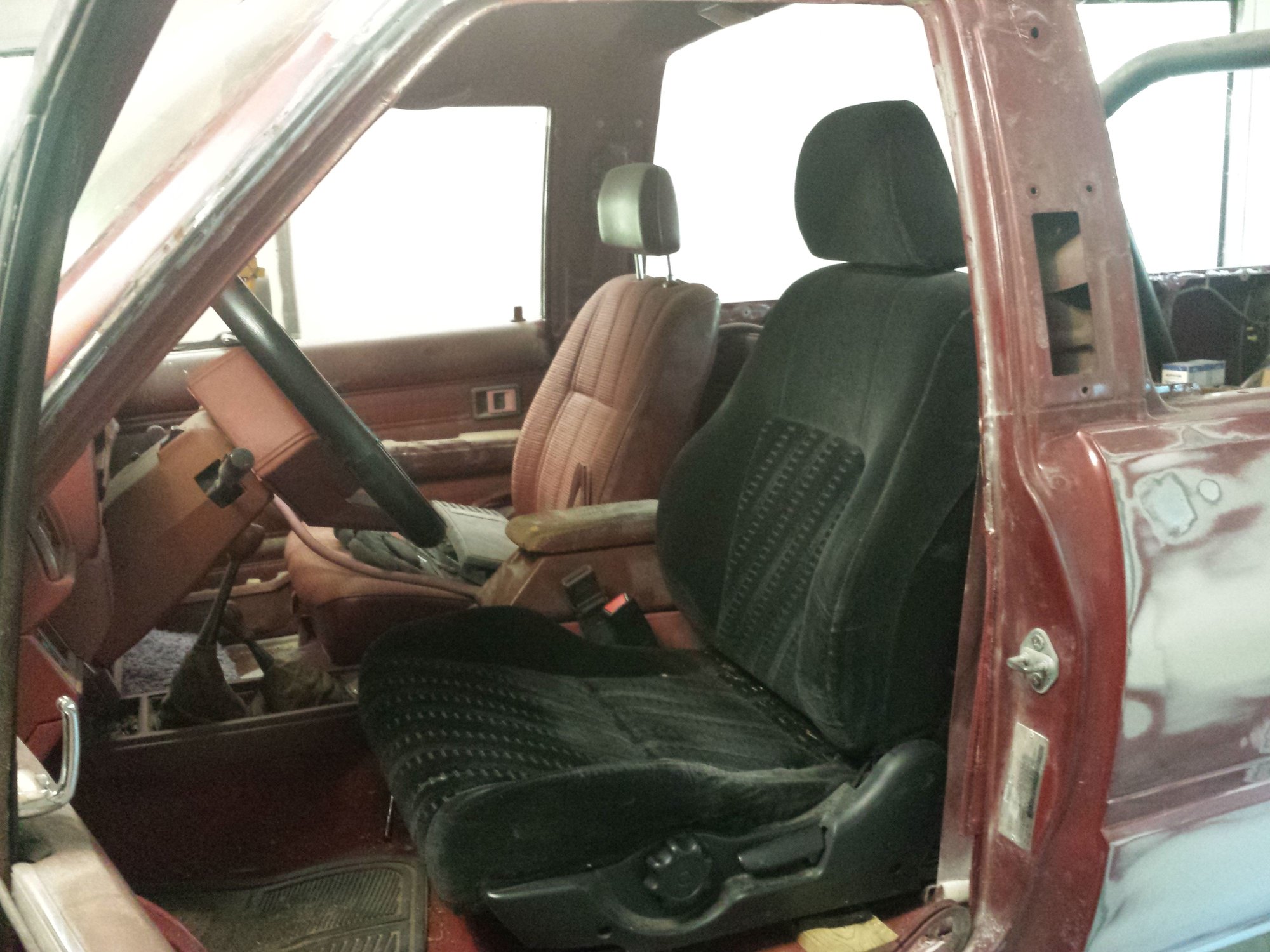

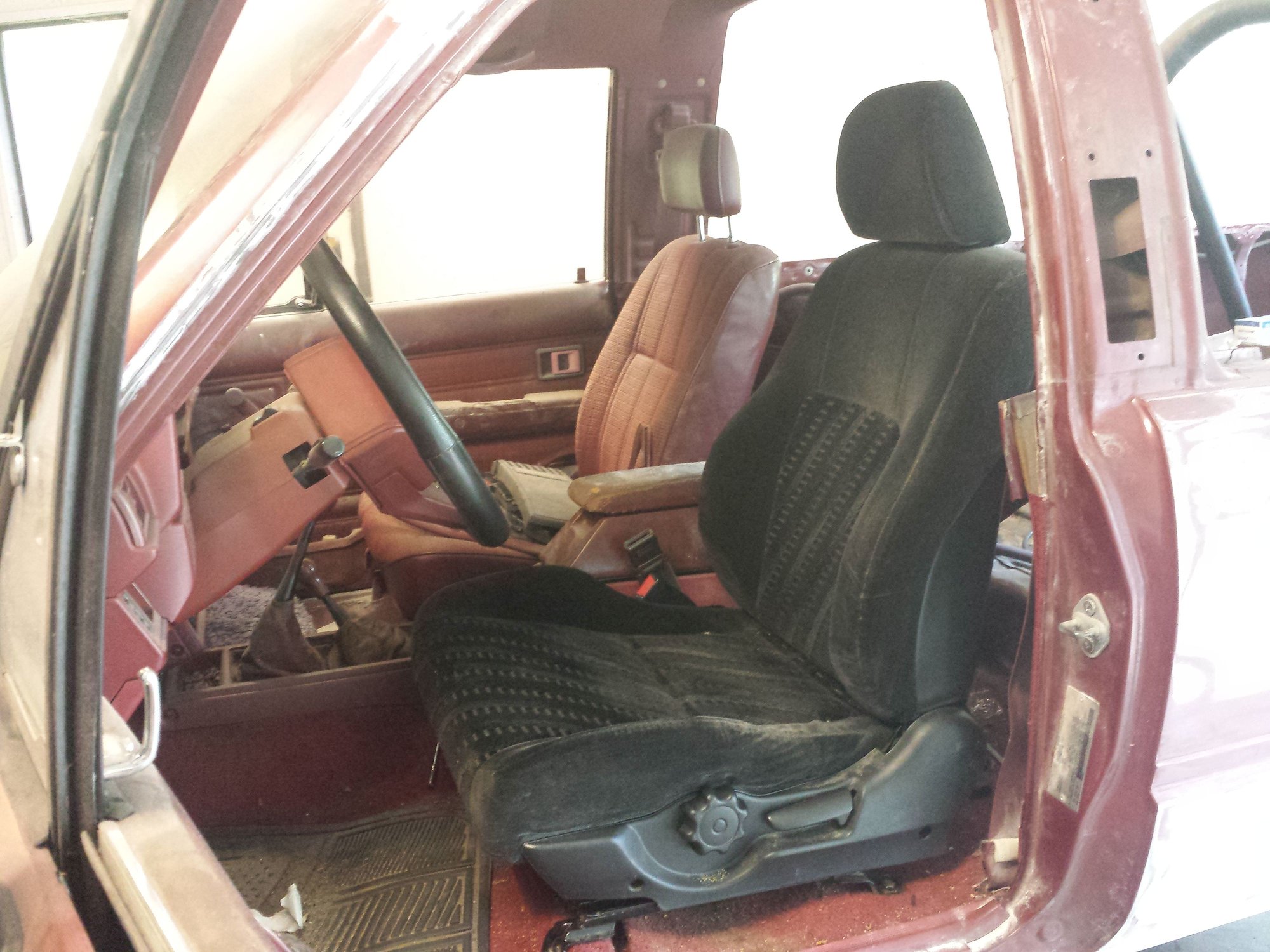

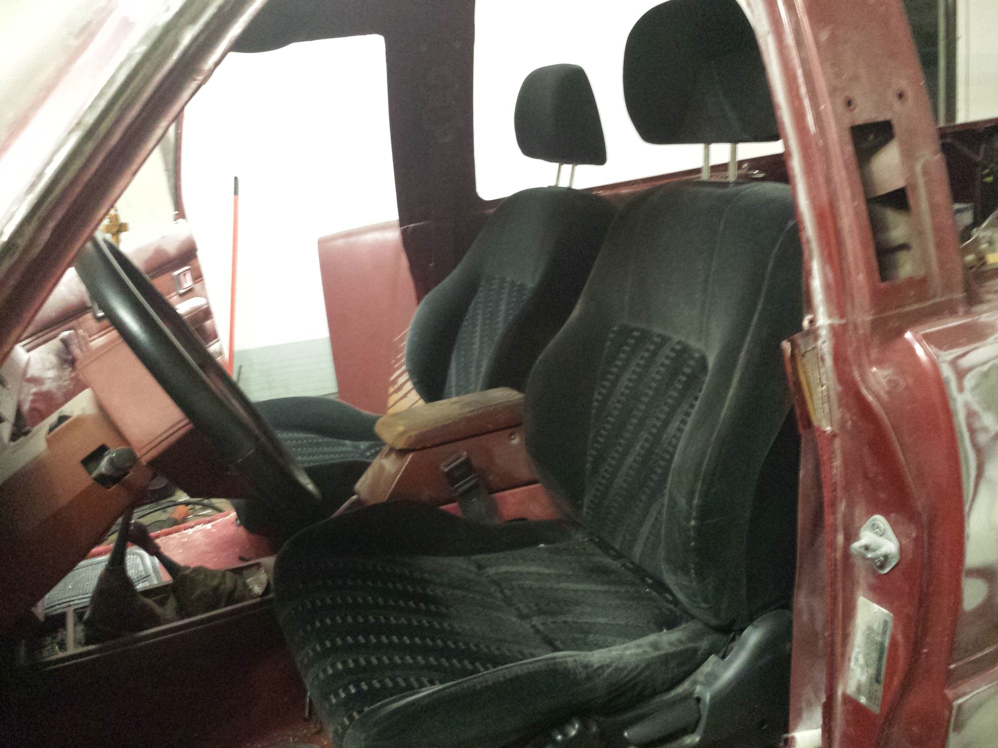

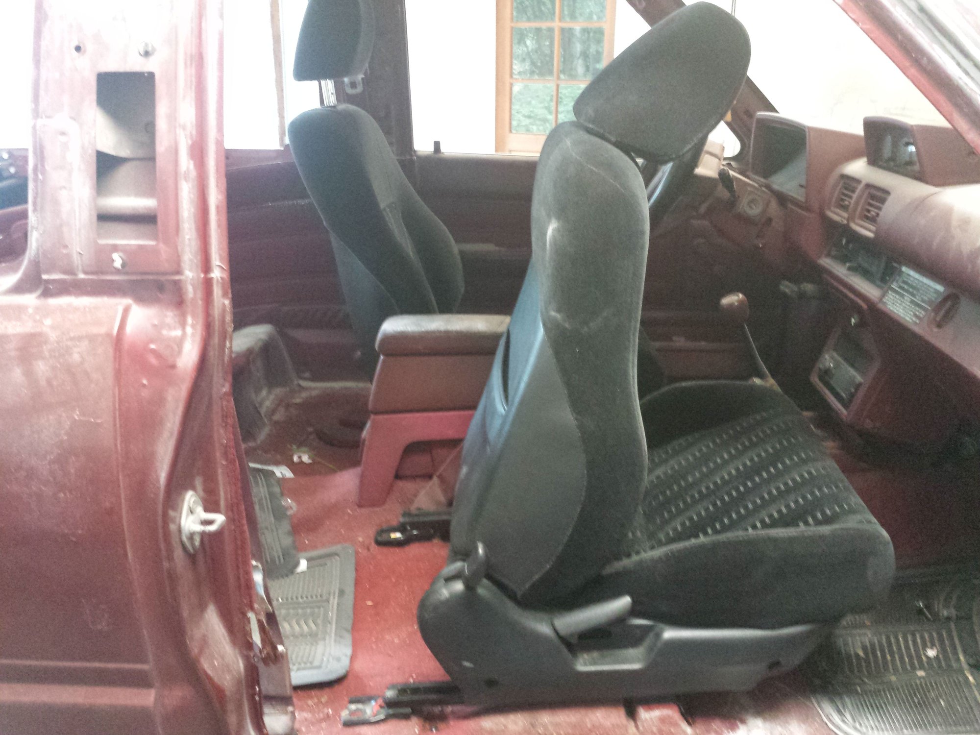

So today i put the new seats in, it was not easy. Took 8 hours to do.
Very comfy seats, the passenger slides way forward like factory, has a spring to pull it forward for you and has a rear accessible lever for moving the seat.
Drivers side has a control for bottom cushion height and tilt adjustment.
They sit slightly higher than factory

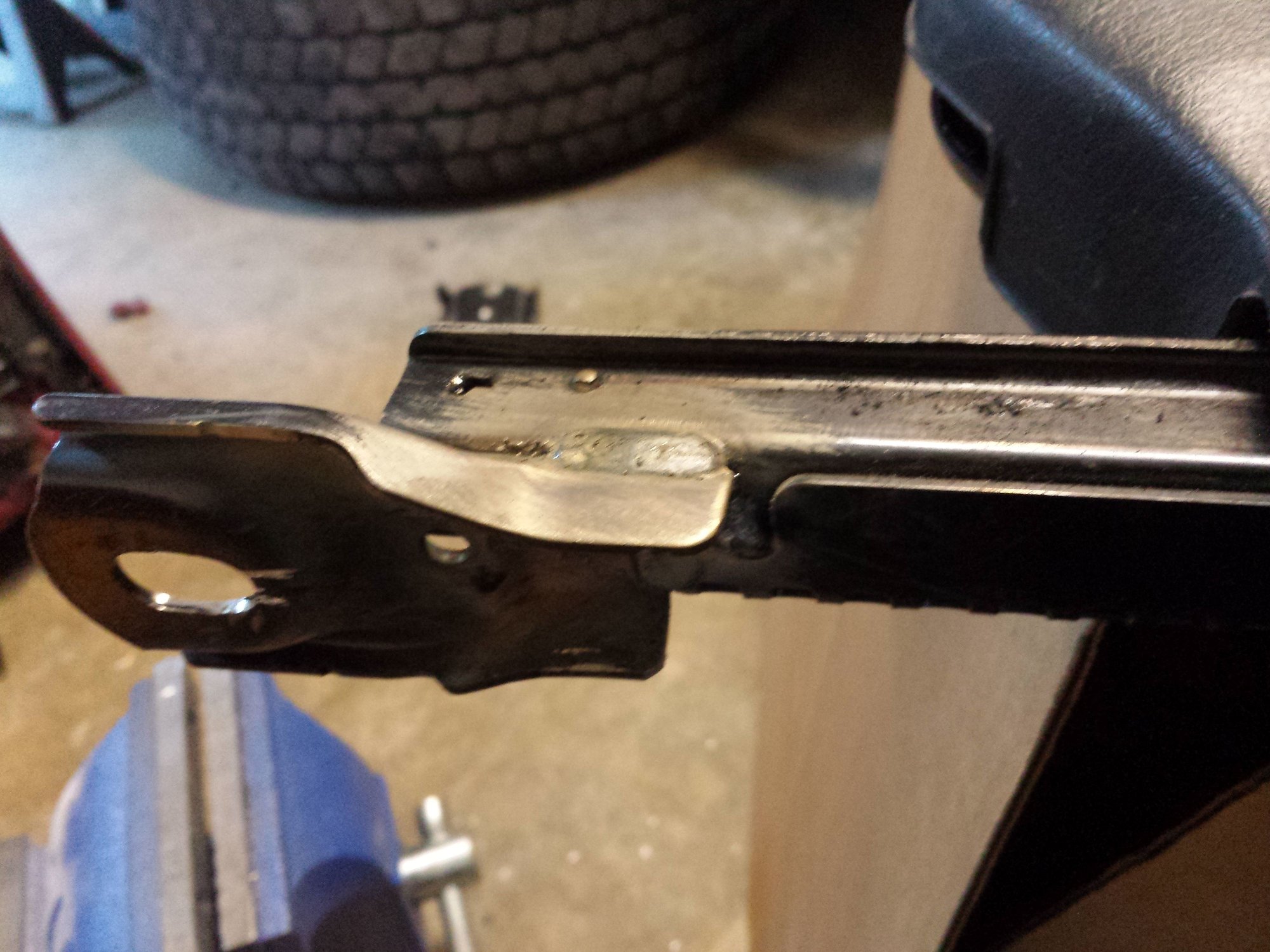

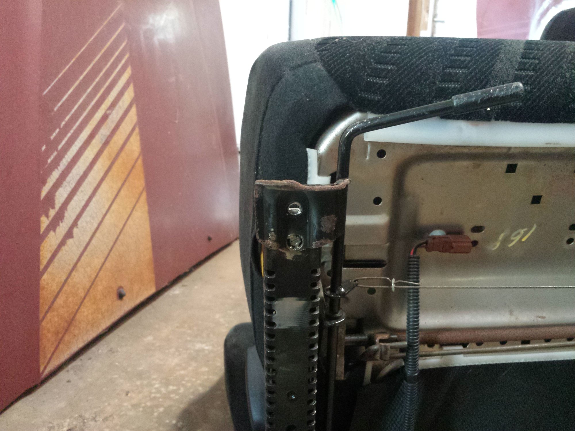

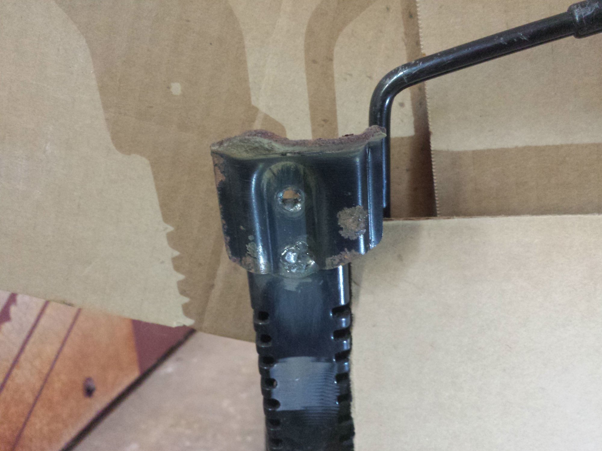

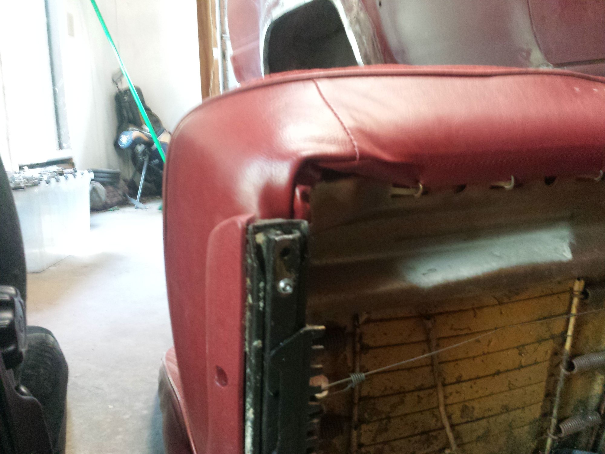

I did the drivers seat first. I left the outside front tab on the prelude seat as it was pretty close to prefect. I then drilled out the spot welds and rivets from both the 4runner seat and the prelude seat tabs and attached the stock seat tabs on the prelude seat. So the drivers seat bolts up to the factory location.
the passenger seat was a different story completely. The factory bolts are super close from the front to the rear on the 4 runner and really far away on the prelude seats.
I once again left the outside front tab from the prelude and removed and swapped the inside front from the 4 runner. On the rear outside i found that the 4 runner chassis has two welded nuts and i was able to utilize the one further back, i still had to move the prelude tab forward a half inch to fit.

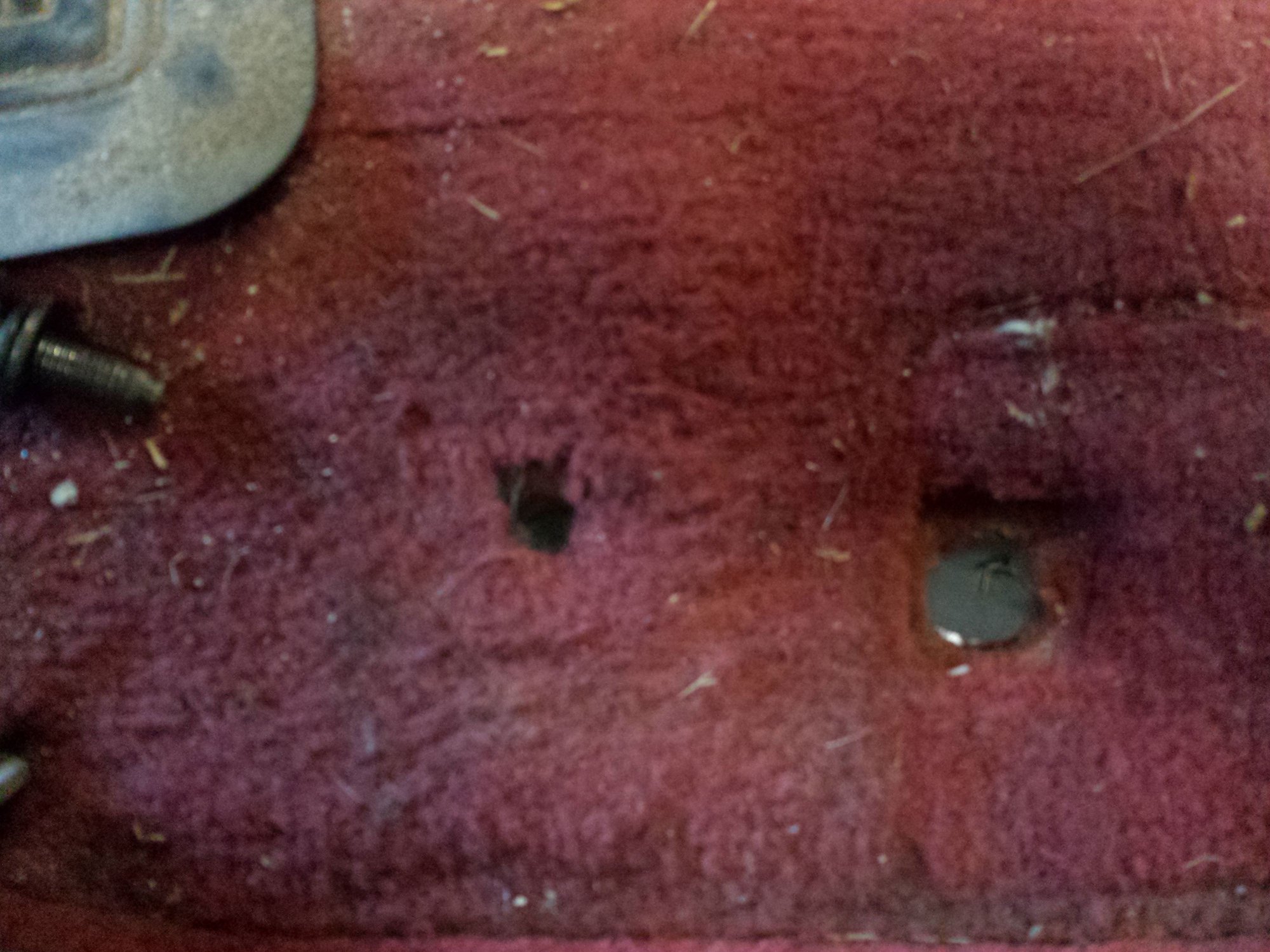

On the inside rear i had to drill a hole in the floorboard and use a nut and bolt combo from underneath. There was no way to put the toyota tabs on the prelude seats without interfering with the sliding mechanism.
Here are the random pictures i took while doing the job.
In better light
Test fit with blocks in the rear
Front inner tab removed
Tacked in for test fit
Plug welded, i had my welder in to low and had to redo this one as i was afraid of it being weak
Bolted in to the factory location
Notice how far these legs are compared to the factory holes
Front inner tacked in for test fit
Rear outer all welded up, half inch closer to the front from the factory prelude mount
Same
Hole in the right is factory, left is another factory welded nut
Both bolted in
She didn't want to get in the picture, caught her.

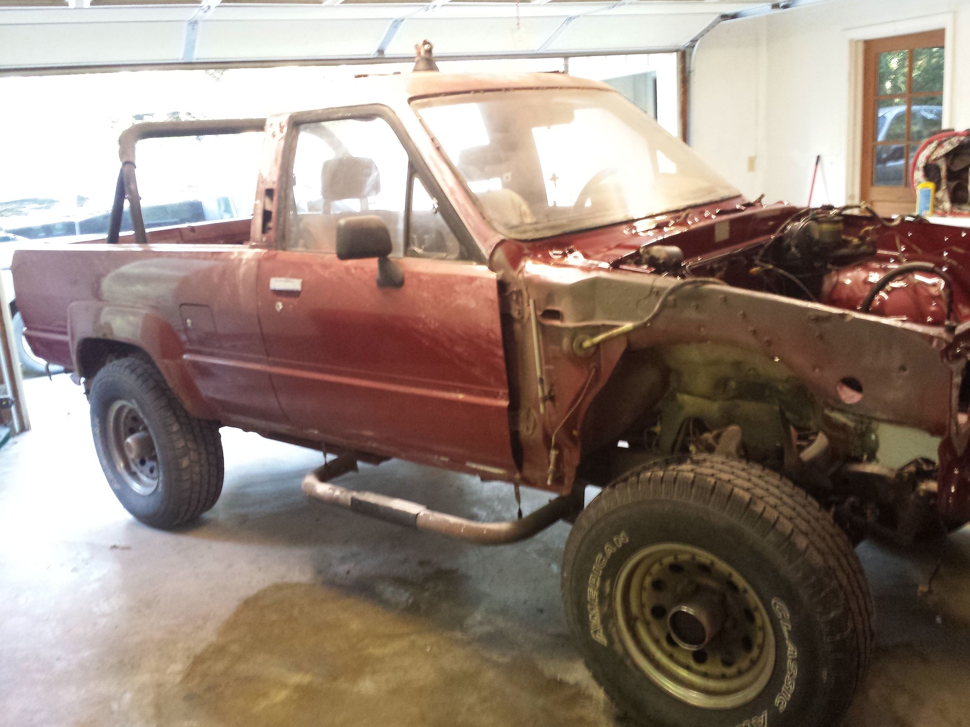

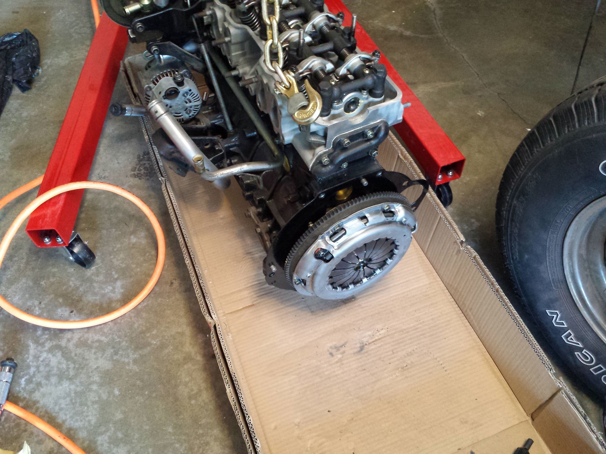

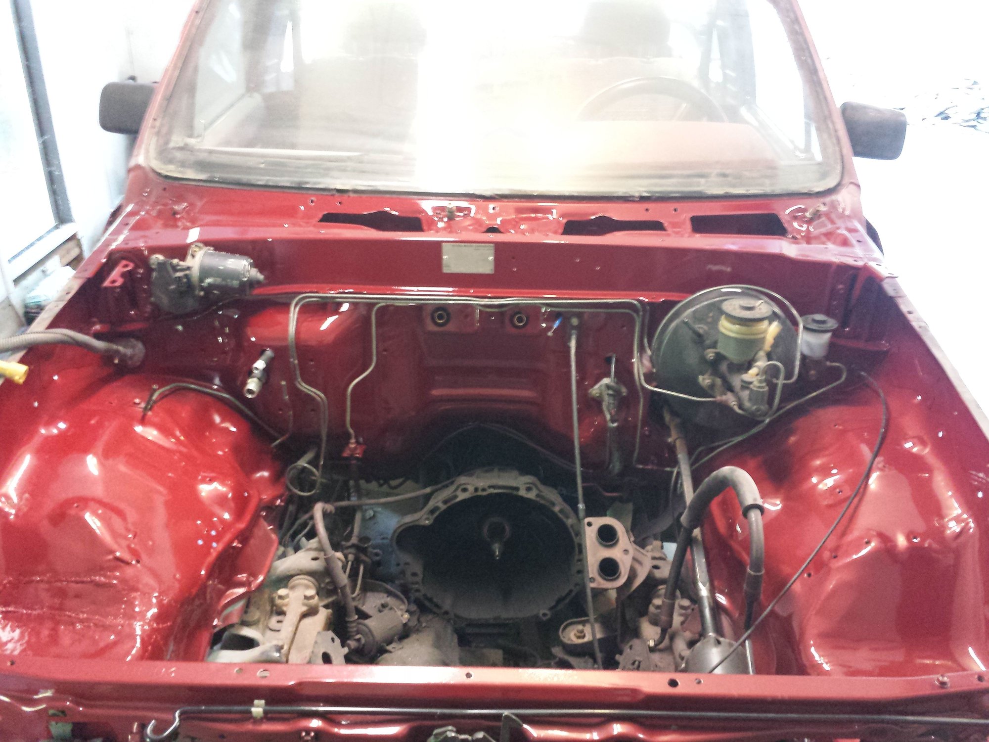

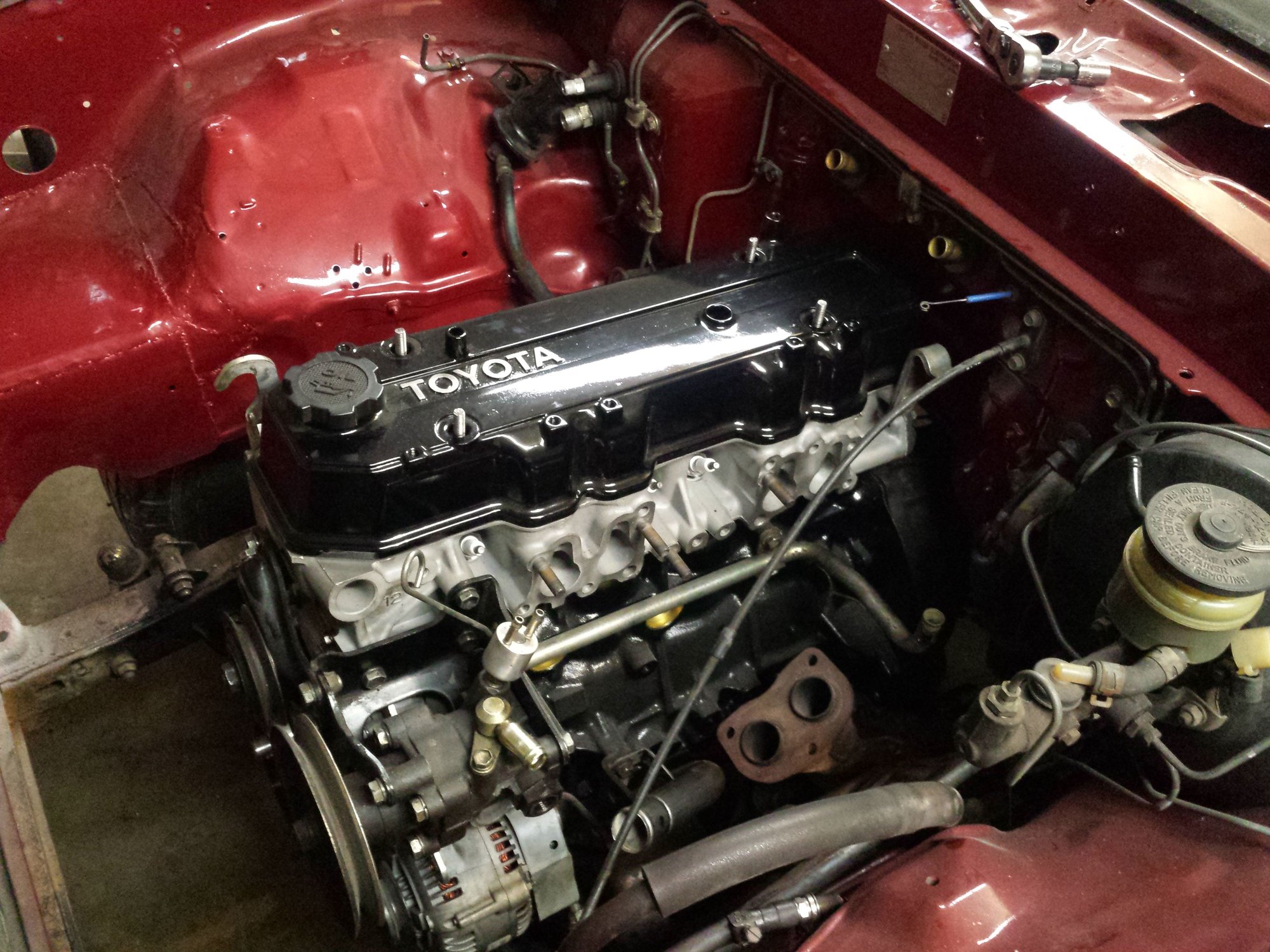

Motor is bolted back into the truck! Obviously still a ways to go but in she is.
New aisin clutch, throwout and pilot bearing. I replaced the input shaft seal as preventative and used fipg on the bearing cover since no one has the paper seal in stock.
I only scratched one small spot in my engine bay right under the heater core inlet pipe but it won't be seen.
I'm going to continue on this route for now and get this thing running and driving so i can move it at will and get it to my buddies paint booth once the body work is finished.
