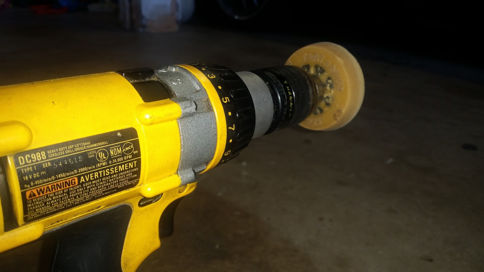

I can vouch for the rubber wheel. Use it more often than I thought I would. Especially on tree sap. Freeze it with the keyboard cleaner can upside down and erase it. Great for debadging emblems also.

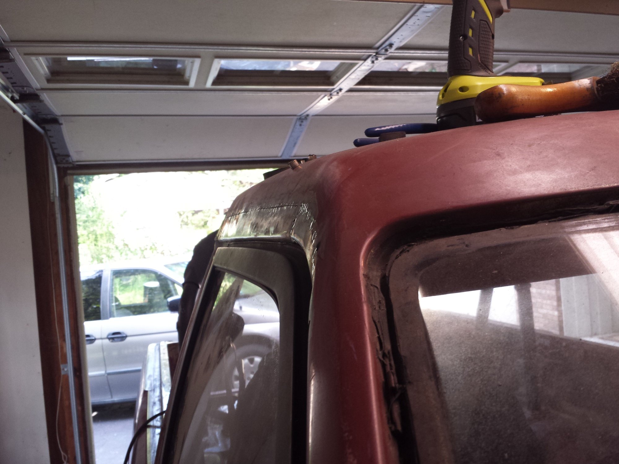

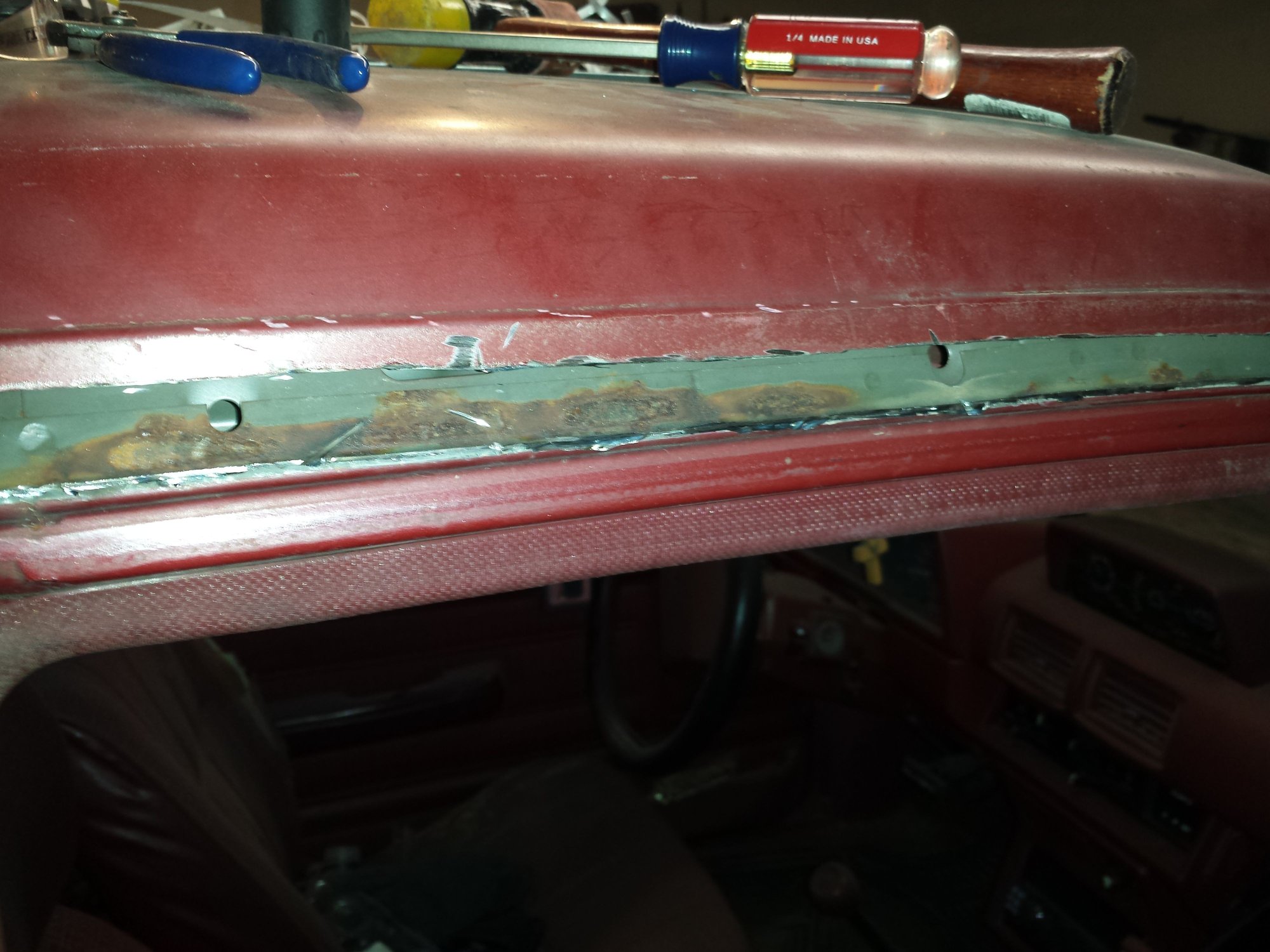

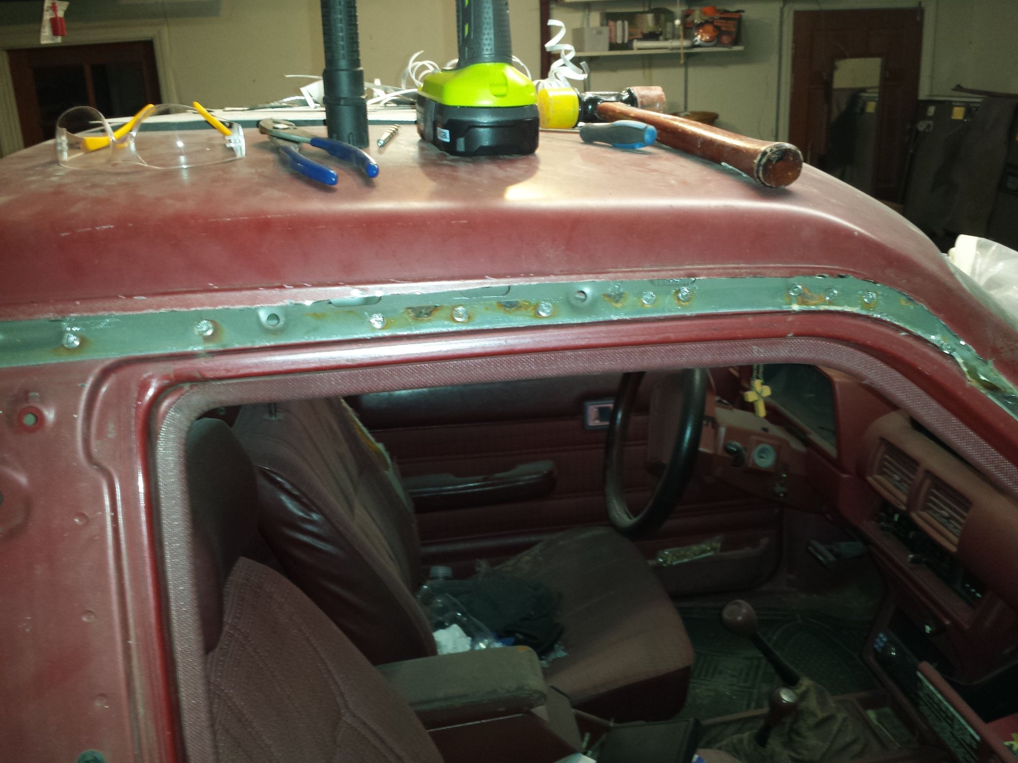

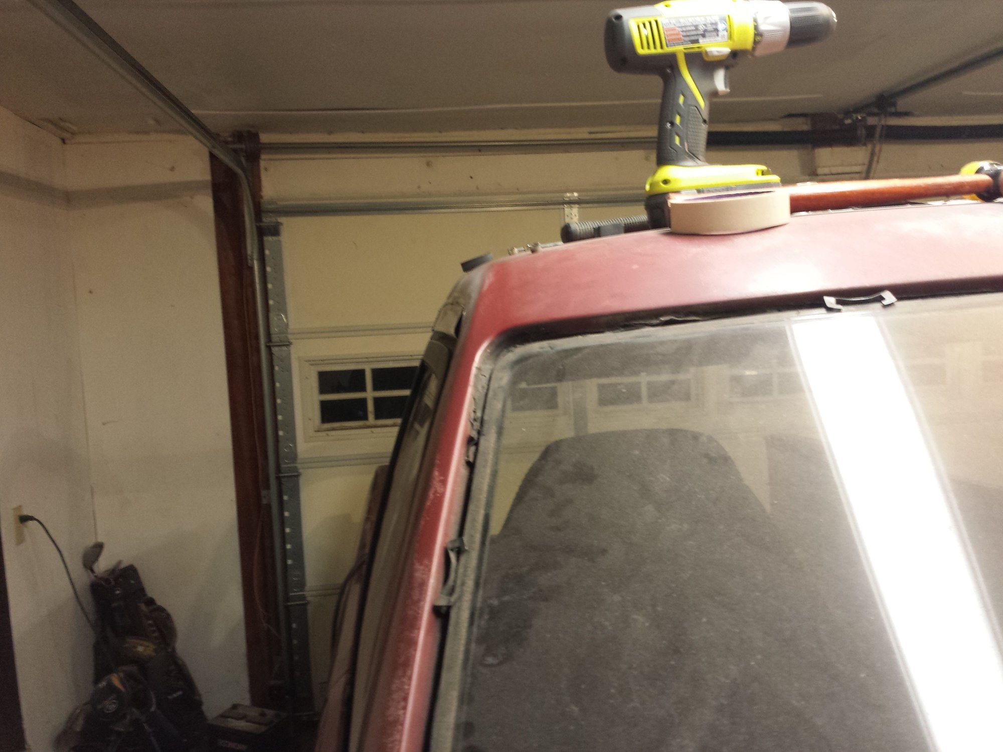

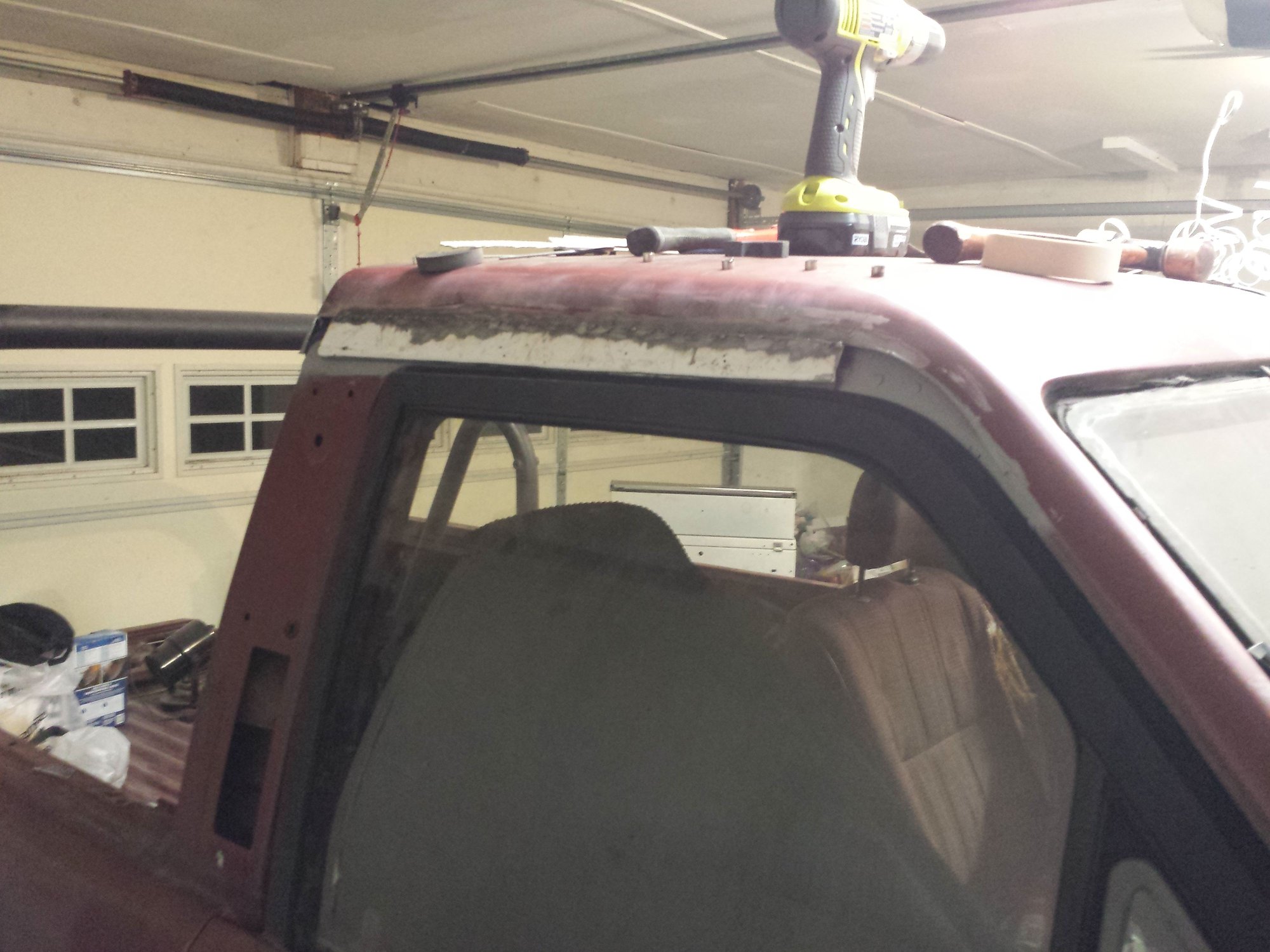

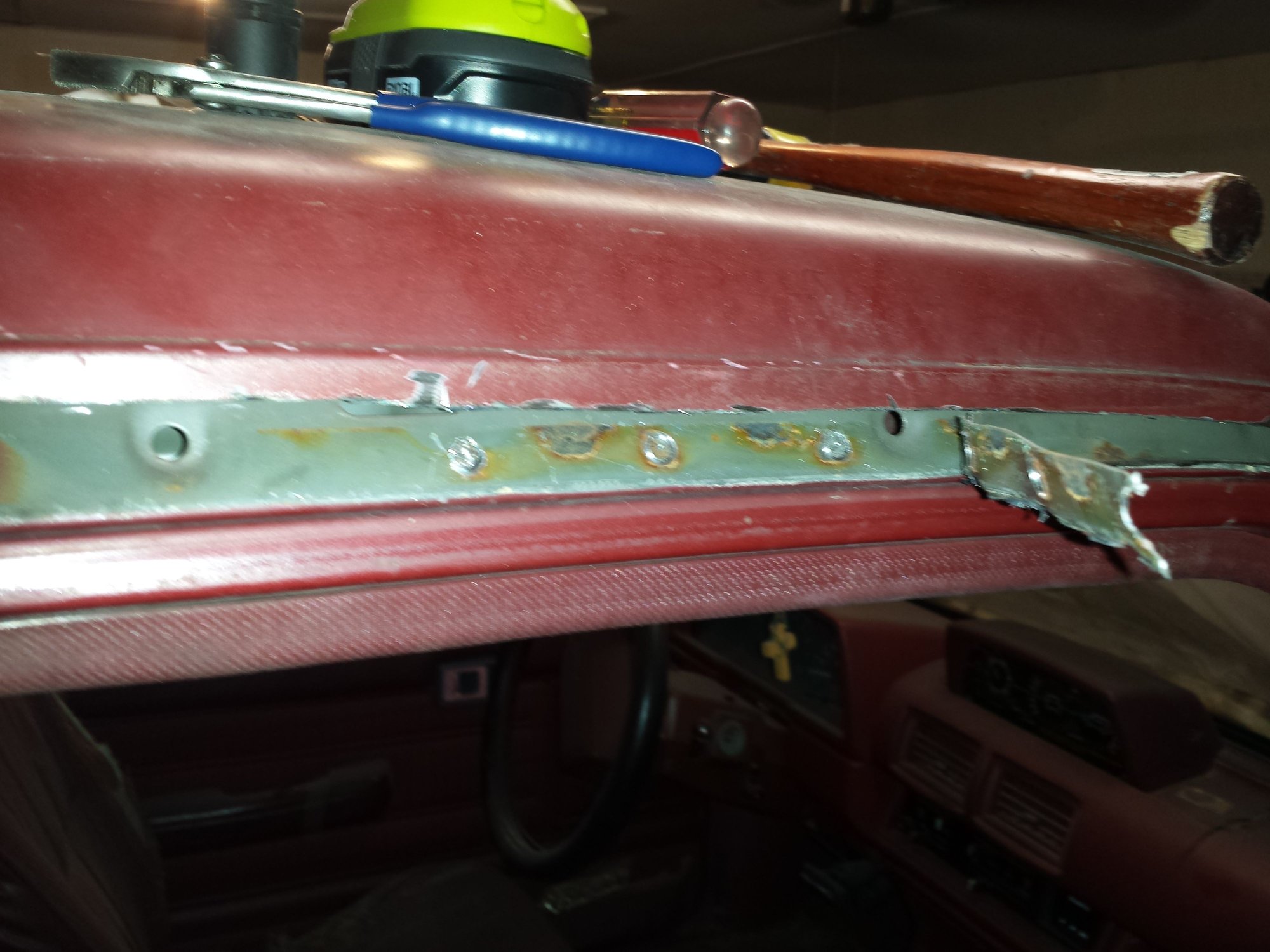

I'm going to touch on arlindsays posts about the rain gutter being spot welded to the a frame.
Yes it is and not completely. It is spot welded to the a frame. It is spot welded to the roof skin at the top of the door opening. It is NOT removable this way. Unfortunately i got to find this out the hard way.
However, without this i wouldn't have found the rust hole in the roof and what was behind it.
I plan to build it out to make it more like dad's 94. We will see how it goes.
Pics with relevant spot welds.

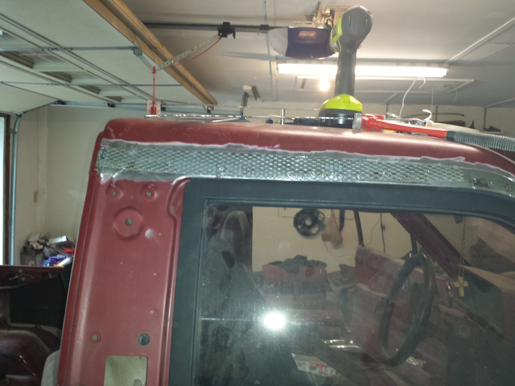

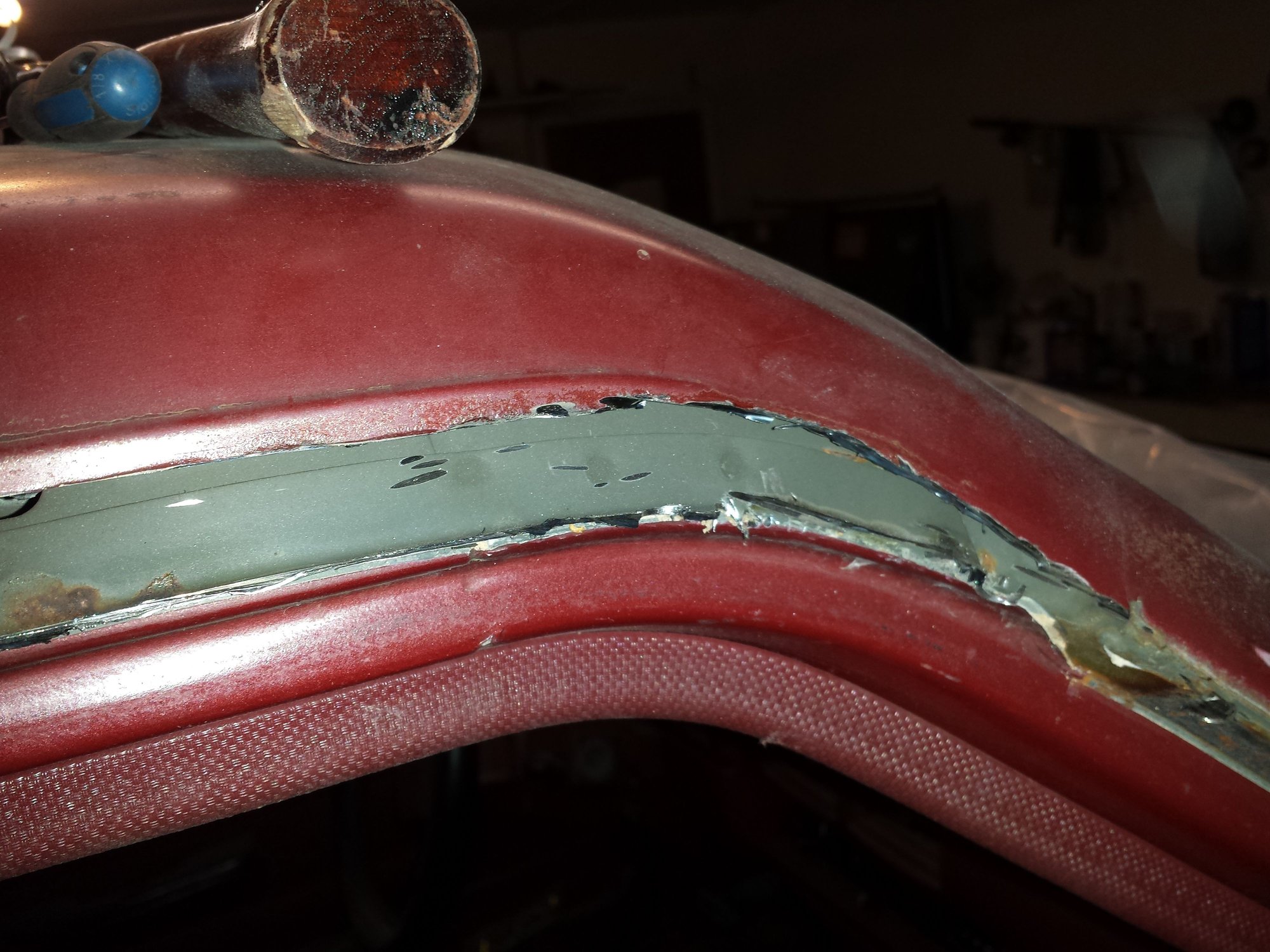

I've never wanted to give up on anything more than i want to give up on this truck right now.
If you go looking for problems you will always find them.
I could have filled that little rust hole in the roof, sealed the gutter and been done with it but i had to "fix it all"
I have now hit a wall, spent 10 hours cutting bending and fitting metal and got no where. I can not create a shape that will look right, i got close and even had a piece welded in, but i know it will just rust out from the back side no matter what i do.
I'm asking for thoughts and opinions.
Fiber reinforced filler is water proof and strong. I think by taking some expanded metal and creating the basic shape, tack welding it in them filling it with tiger hair will produce the shape i want, water proof properties, and strength needed. Being that this is the roof line and right at the door jam it should flex the least.
Here is a mock up with some spare gutter guard from my house.
What do you expert body repair guys think

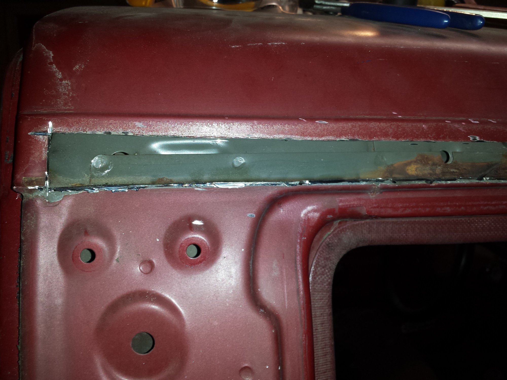

Two days rest is good.
Found a dryer for 30 bucks just to use for scrap metal. It's a working dryer and since i cut it up I'll keep the parts for my repair business. Win win.
Turns out the curves on the corners of the dryer are perfect for what I'm trying to accomplish.
I got this piece in, the bulk of the missing metal. Weld thru primer and tacked in. The rear and front parts will be super easy to make i believe.

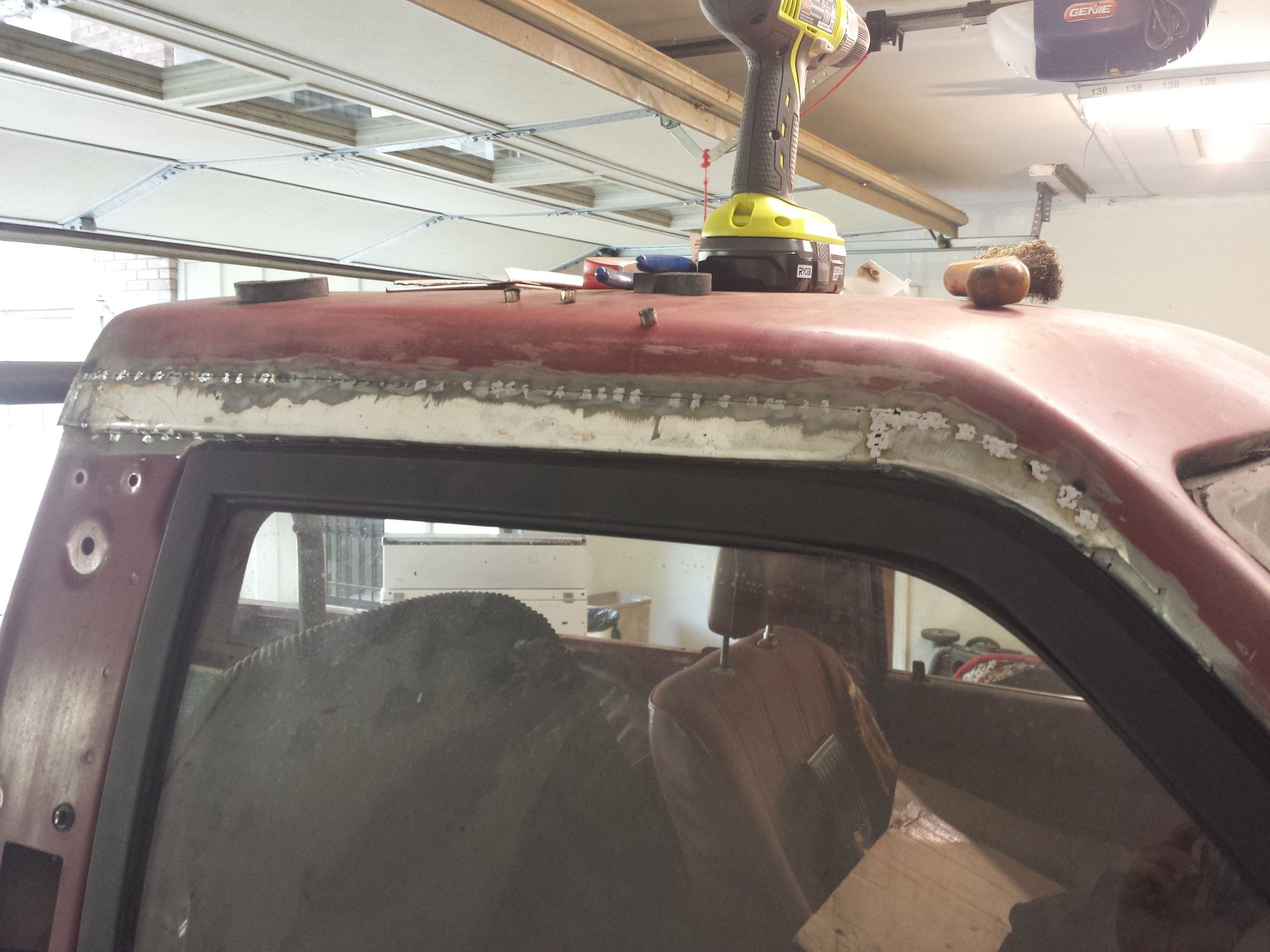

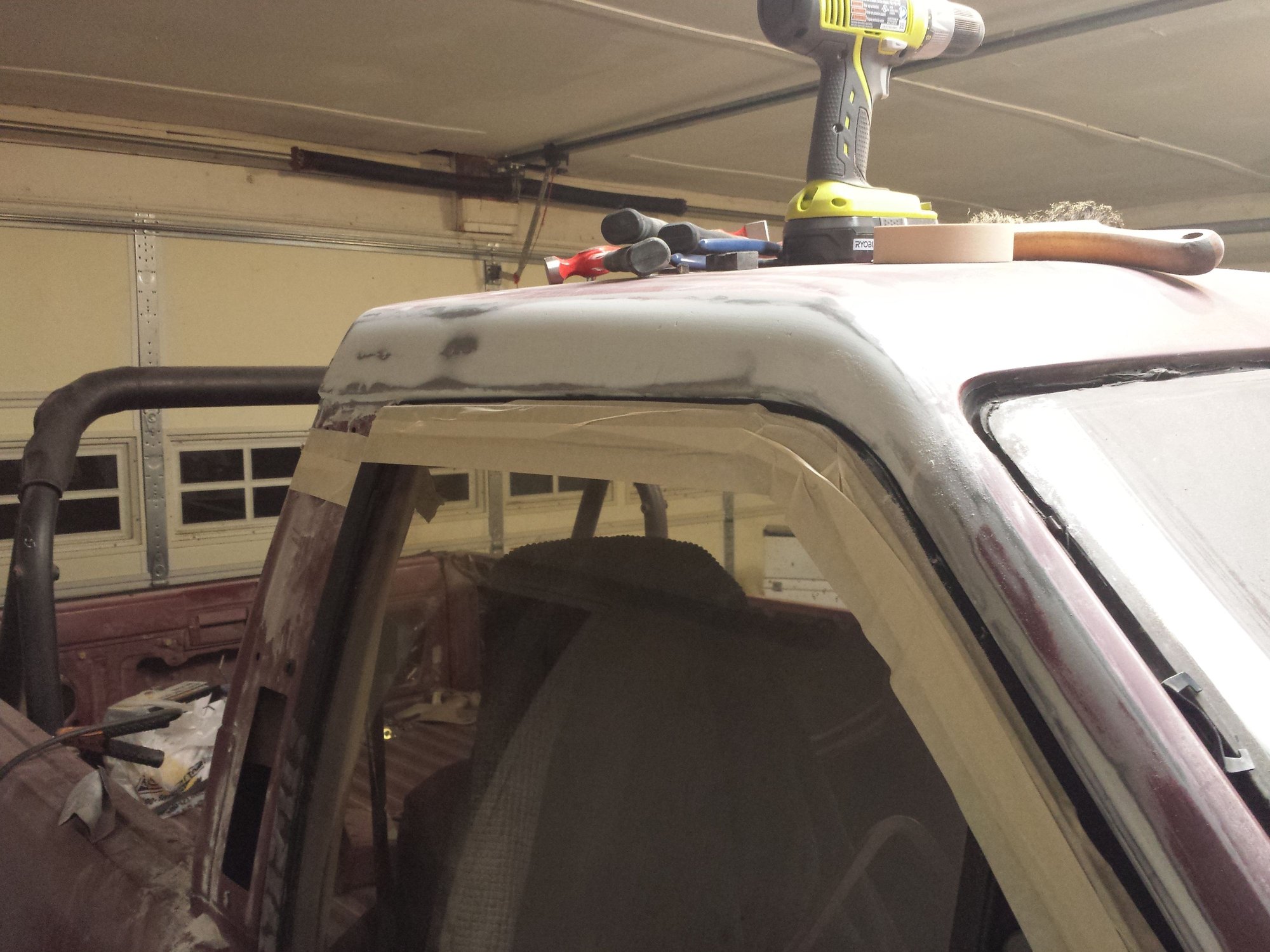

Finished the metal work on passenger side roof and started filling. First wipe, had some high spots, knocked them down and ready for wipe 2.
All weld seams filled with fiber filler.

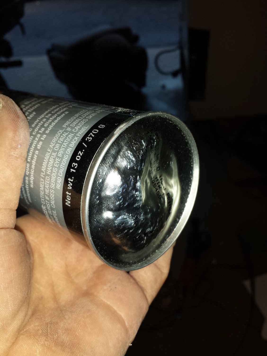

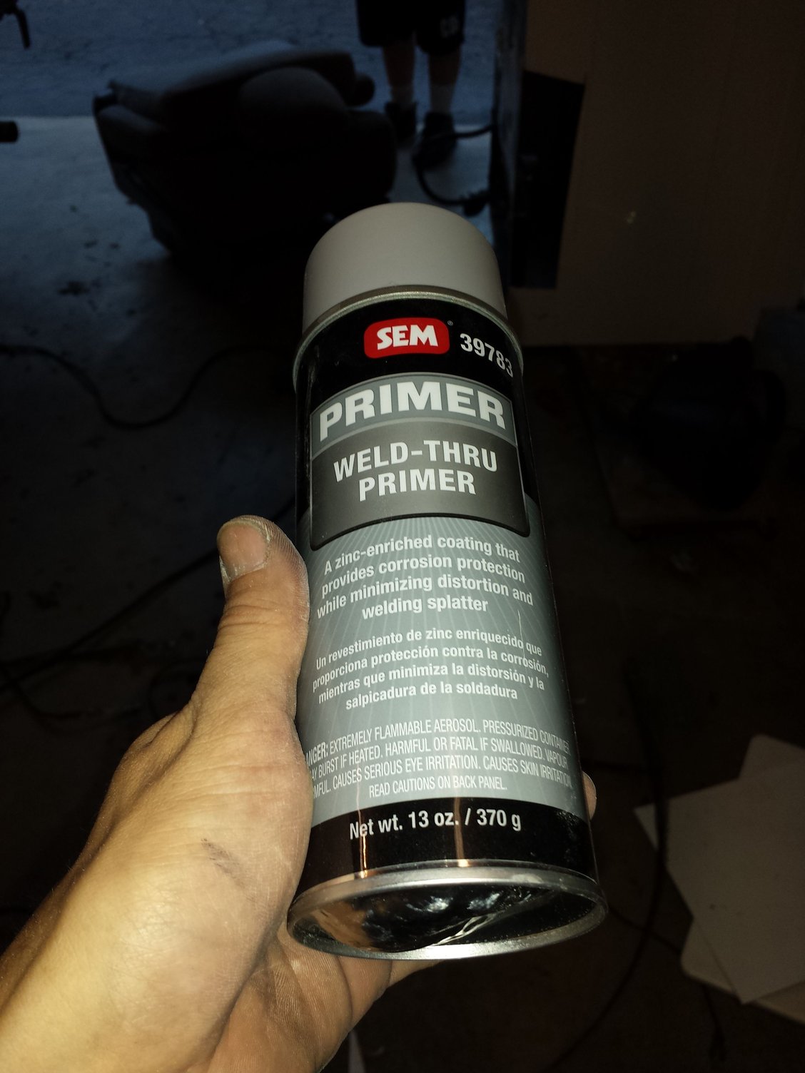

On a side note has anyone ever had a can of paint do this?
<br > <br >
It was fine then after i shook it up the bottom was bulging.
Old Jun 25, 2016 | 06:48 PM
<br > <br >
